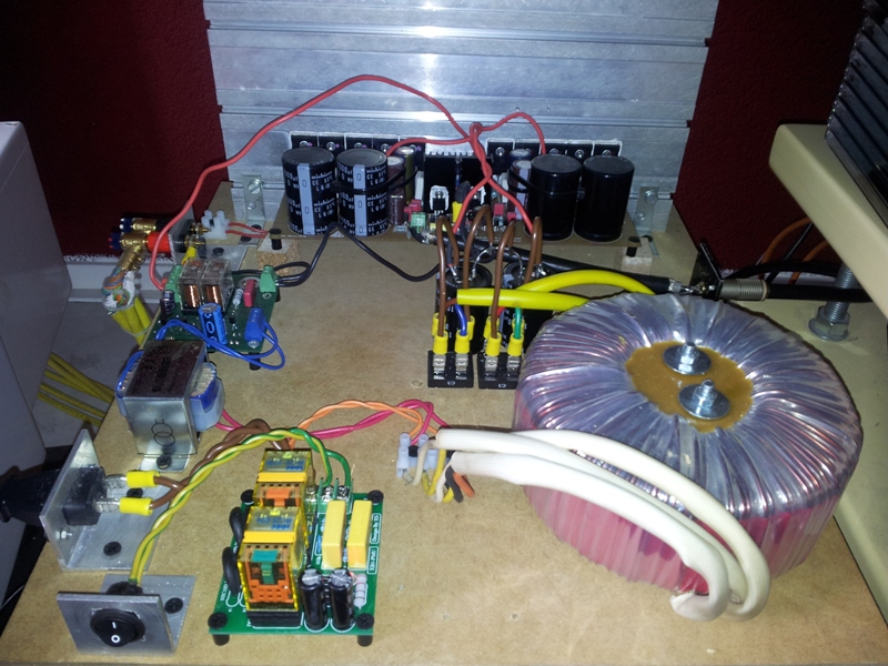

Now I know my sawguide works perfectly I can cut iron much easier, and more important, without non-straight cuts. I've started with cutting a new backplate for the boards and made the heatsinks for the MJE150033/32 a little bit shorter.
Further I've decided to move the soft start to the front side of my amplifier instead of the rear side. I have had no hum at all, but the soft start was in my opinion still a little too close to the speaker terminals when reconsidering my first lay-out. So I had to make a little plate to mount the soft start PCB to.

2uF capacitors/softstart
This is funny and maybe you can help. I have the same softstarts as Kaplaars. Yes two, as I am thinking of building two mono blocks. The little softstart PCBs are printed as 2uF but 22uFs are soldered in its place. What gives? Will it still be advisable to replace the 22uFs with 1uFs?@Fix; Cool to see you here, I would love to see another build from your hand!!! 🙂 You were a big inspiratory to me for building a KSA myself. When I saw your build journals in the other KSA thread, I thought immediately ‘I WANT ONE TOO’ 😀. By the way fix, how much difference made it for temperature when you cutted the bottom panel open for the tunnel coolers? I have the same cabinet as your, but I use slightely larger cooling tunnels. I am still thinking about making holes for the new tunnel coolers in the bottom plate too, or just using the holes that are already in the bottom plate to gain fresh air. It will be not a problem to cut the bottom plate open, but I am afraid the cabinet will be less rigid. Probably have to make reinforcements then, or will this be not a big problem?
@cfy30; Particular those little 2uF caps were up to no good (bad quality). You need to replace these caps with MKT’s or something similar. I’ve replaced them with 1uF caps instead of the original 2uF ones. I think the relays bounce initially because the transformers alone (with no load attached to them) are almost equivalent to an inductive load. Something relays in general do not like. For example, when I tested the softstart with a more resistive-like load (a big light bulb), I did not experience any bouncing of the relays. Further this circuit is very sensitive when it comes to contacting of the switch with the original caps. When the switch made contact a bit too long, it shuts inmediately down after starting. If the relay keeps bouncing there is a good possibility your fuses will blow. This can happen because the NTC’s are already warm. So when it keeps starting up and shutting down, the inrush current will not be dampened by the NTC’s. Resulting in tripping the RCD or blow the fuses. With replacing the little 2uF caps I have never experienced these problems again, even when switching rather inductive loads. To be sure I've replaced all caps on the little PCB.

I have two too (one for spare) 🙂. Indeed funny because the one that is used currently in my KSA had a 2uF MKT attached, but the other one had a normal 22uF capacitor soldered on this place. Probably they have had more problems, and tried to find a different solution. 22uF could work but probably only because a normal cap has higher ESR so switch bouncing is more dampened. I choose to lower capacity. I saw that similar like circuits using the same Ne555 are using an 1 uF capacitor too. That works for me. I have not tested the circuit with the 22uF capacitor. Have you experiented with it David? Do the relais bounce when you switch the transformers alone?

I checked both soft-starts with the 22uF caps instead of the 2uFs and I, without load, did not experience any bouncing. But I did notice that when I momentarily closed the switch wires, it turned off when it wanted to turn off. Will try later with a load of some sort.
