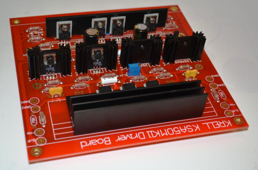

The original KSA 100 used an orange (not sure maybe ICC ) 250 VDC 0.1 uf polyester cap with 2 watt 5% 5.6 ohm dark brown resistor - not sure who made it, for the zobel mounted at the output jacks - a good film and foil polypropylene with an flame proof 2 or 3 watt metal oxide or caddock power film resistor will be a good upgrade. It was stable with Quad 63s in parallel with 4 ohm Dynaudio subs.
Amices,
Any progress made ? 🙂 I am still enjoying the KSA. Glad it is still operational. There have not occured any flaws. It is and stays solid as a rock! It is really the beast amplifier I've ever heard. Krell really is a fantastic brand 😀
I did some further experimenting concerning the optimal bias value. I've found out that 450 mV bias (when using 1 ohm emitter resistors) is the optimum value for my KSA when concerning heat, stability on the long term, noise from the fans and distortion.
Looking back I've learned that using two seperate cooling tunnels is the best solution when going full bias. There is more difference in temperature between the cooling tunnels than I had expected (about 12 degrees). This causes one part to get very, very hot (70+ degrees). Although the trannies would be well within their SOA, I did not feel comfortable.
If I ever would made another one, I think I would buy even larger tunnel coolers and place them upright, just like in the original design. Maybe in the future... I still have some parts left haha 😀

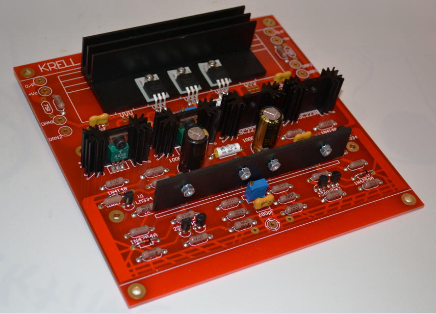

By the way David, there is another thing you have to take into account. Around the holes which are meant to attach the MJE15033/32's to, there is a conductive ring:
When you attach a non isolated / non anodised heatsink, which means your heatsink electrically is conductive, chances arise that your heatsink will make short circuit due to a connection with these holes. This holes are connected to the the collectors of all MJE15032/33 devices. Short circuit between the collectors is something you definetely don't want, because your power lines will make short circuit also (V+ and V- are attached to the collectors). So you have to isolate the heatsink from this rings aswell, or use an isolated heatsink. I took no risk, so I chose to remove the conductive layer on the surface around the holes in the front by drilling very carefully the little conductive surface away. Worked like a charm 🙂.

Hi David,
I have to say, in all honesty, that I do not share the observation Fix has made. I actually can't hear any difference when experimenting with bias values ranging from 100 mV and up. I begin to experience slight deteriation in sonic quality when I dial the bias far below 100 mV.
But I have to say, I don't listen music at very loud volumes. So the amp has not to deliver lots of power to drive my speakers. That is why, in my case, a lower bias will do just fine. When your speakers draw more power than your bias is set, and you exceed this value, then you can experience more distortion due to crossover distortion, but below it should not occur.
But cooling is very, very important. Lot's op people underestimate it. I for example did haha. That is why I want to add even bigger tunnel coolers because 1) I am bored haha, 2) because this way the fans have to displace even less air to get the same results and 3) because I offcourse want to go all the way ;-). After some evaluation I think it is after all beter to separate the tunnel coolers afterall, and place them upright just as fix did and the original KSA-100 has.
If I am correct the original KSA-100 uses tunnel coolers which are 12cm long. If I am not mistaken Fix is using tunnel coolers which are about the same length. Even then I think the KSA-100 runs pretty hot. So you will need probably more cooling. For my new plans I have bought these beauties (29cm long each, almost twice as heavy as the ones I use right now):
I am thinking of cutting them through at about 18CM and place them upright. Does anybody has some experiencing with cutting aluminum profiles like these?
Liquid cooling would be very verry cool David! I would love to see that. Even better, it does not produce a lot of noise. I think for me that would be a little to expensive. I think I stick to aircooling.

Due to the size of your heat sink, if you want a nice cut, try to go see a machinist. They will have the proper saw to make a nice cut. You can always use a hand held steel cutting saw, however the result will be proportional to your ability's to handle it. i.e. you might end up with an uneven cut requiring a couple of hours of filing...!
Eric
Yes the original KSA 100 used a tunnel heatsink actively fan blown.
It really wasn't big enough for the 2.5 amp bias current and baked the thermal compound under the output devices into dust over time requiring a rebuild of the output stage. It needed a bigger sink or a higher ( noiser) fan speed.
I rebuilt mine as a Borbely Millenium with Hitachi TO3 Laterals biased at 1.5 amps and it's been good for a decade.
