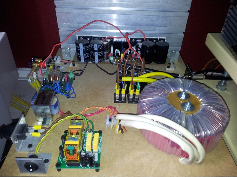

Hi friends,
Again some progress from Holland. Yes ladies and gentlemen the finish line is in sight, but I've said that earlier. Reality is that it is not finished yet 😉
It was finaly time to mount the tunnel cooler to the cabinet. I've also thought of a plan to keep this beast a bit cooler. I've stripped the cabinet and mounted two extra large fans underneath the tunnel cooler for extra cooling:
These fans have a lot of airflow. I can control fanspeed with my little fan control device.
After mounting the fans I mounted square aluminum bars underneath the tunnel cooler so I could lift it a bit higher. This way it fits perfectly above the fans and can radiate heat from below easier. Next project was to mount the tunnel cooler to the cabinet:
That turned out OK. The fans are a nice addition to keeping this beast even cooler. Next hurdle to overcome was drilling two big round holes for the fans (dont mind the mess on the floor 😀):
This was a real hurdle to me. Something I did not looked forward to. I bought a nice, high quality HSS Makita hole saw. But still, it was very hard to drill through the metal. You have to drill at very low speed, but my drill had too little power to drill at low speed. It just could not turn the holesaw. But..... after much patience, it worked. I've also mounted two airfilters to the sidepanels:
So it was time to test this beast again. Although it powered on OK, I measured a strange DC offset which dissapeared when I disconnected the rear panel from the cabinet. Also the speaker protection almost instantly intervened when I connected the cabinet to GND. Hmm, how could that be? Did I made a mistake with grounding this beast? After some futher measurements I've found the culprit; one of the AC leads (not HV, but 12VAC) from the little transformer which powers the speaker protection made short circuit with one of the spacers. STUPID. How could I have missed that. Fortunatelly I was lucky, it did not do any damage to the amplifier. After fixing this it was time to test it again and........ IT WORKED! 😀
Well guys only thing that I still have to do is mounting a D-SUB chassis part to the cabinet and wire all the fans, and then it is finally finished 😀 I also would like some nice handles in the front, and maybe some nice VU meters in the front. But that is for later. Keep you all updated 😎

Isn't it pretty 🙂 But that is not why I post this update. Today I fired the KSA-100 up. Man what a sound. It is my birthday today, yay. So it is time to play some music. But I experienced a strange phenomenom; now and then the mains transformers were buzzing randomly pretty audible, osmething I've never experienced. Also the amplifier seem to draw 0,3A extra current. Hmm, that could not be OK. I was afraid there was something wrong with my amplifier. Maybe an heavy oscillation of something. At the same moment I was printing some papers. And yes it turns out my laser printer causes a large DC component on the net. This triggers the transformers in my KSA-100 to buzzzz. I don't use a DC-blocker in my Krell. Maybe it is time to construct one. Would a DC-blocker be beneficial or are there also some disadvantages using one?
I never thought a DC component could cause so much hum. Another lesson learned 🙂

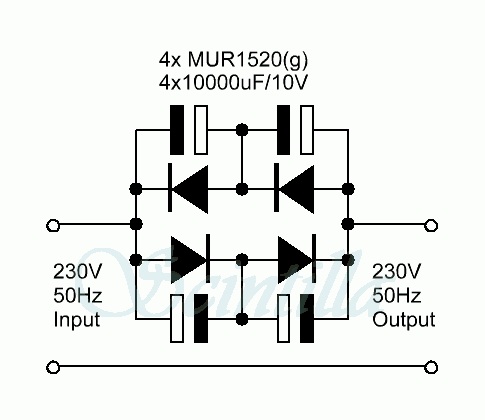

This I build for my 2 x 42v 2000Va toroidal.
More rest and depth in the sound (maybe toroidal less stress), and the main mechanical hum is gone from the Amplimo Ring core.
Just try, it is not the cost not to test.

@BMW850; Hi Rudy, thanks for your input! I will try this little circuitry. I am curious about the results. Nothing causes problems, only my laser printer. It was a cheap one, so probably it's PSU allows applying a large DC-component on the net and is not proper filtered.
