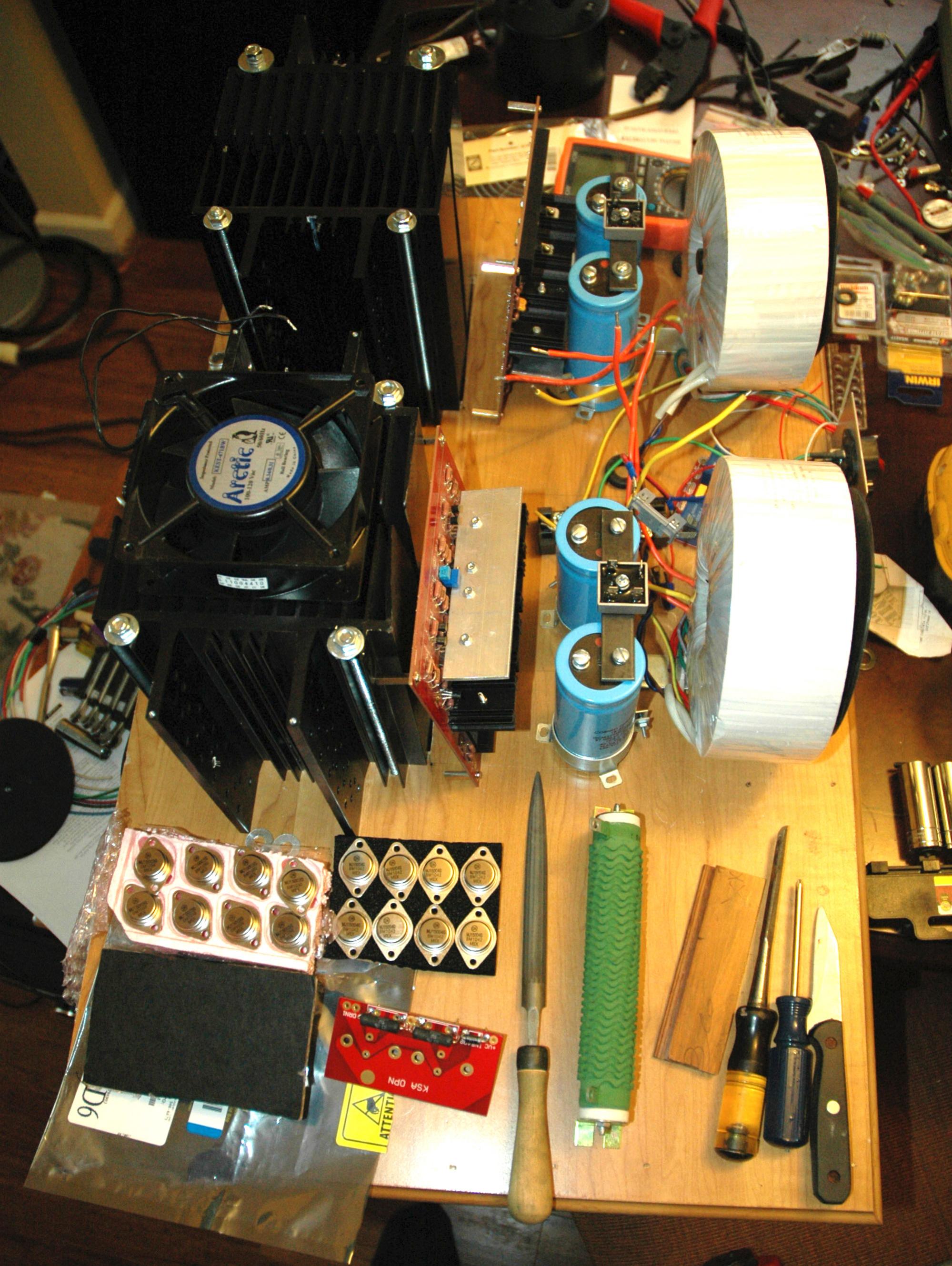

Hi David,
There are a few advantages when using multiple capacitors in parallel. In contrast to resistors, the overall capacity doubles when putting two capacitors in parallel. A capacitor has of course a capacity, but also an internal resistance (ESR= equivalent series resistance), and behaves a little bit like a resistor (so they are not ideal). When putting a few capacitors in parallel the capacity increases, but the over all resistance decreases (just like a resistor, for example when putting lets say two resistors of 5 ohm in parallel, the over all resistance becomes 2.5 ohm). This is very favorable, because less resistance means less dissipation. Dissipation is something a capacitor does not like, because dissipation means heat, thus the internal fluids (dielectricum) will boil out faster because of higher internal temperatures. Therefore the dielectrical layer becomes thinner, and is more likely to go down. The capacitor will 'pop', because the electric layer becomes to thin. Therefore measuring capacitance at capacitors is not always a good indicator of it's condition. When the dielectric layer becomes thinner, the capacity will get higher. So one could think a capacitor is okay, while it is actually dying. A few posts back I've posted some info about measuring leakage current when I've started up my capacitors. This is a great test. If the leakage current is too large (and thus the ESR), you can throw the capacitors in the bin 😀. This process of degrading capacitors happens in a lot of 'modern' equipment like LCD tv's were manufactures save on capacitors. These inferior capacitors can't cope with high temperatures, and go down very fast. I've repaired a few TV's by just changing the capacitors 😀
Especially in switching PSU's (like the ones used in LCD's, or in modern HYPEX amps) you need capacitors with low ESR. Normal ones will go down pretty fast because they heat up to fast.
But it is not all sunshine, running multiple capacitors in parallel has also a disadvantage. Chances of failure will rise, because there are more capacitors and thus there is more chance of failure. Also the first capacitor in row gets the lionshare of current during power on. Typically this first capacitor goes down before the others (just like in my Audioanalyse). So you have to be sure you use the right fuses. In the previous pictures you can see what short circuit can do to a transformer. Yes, like Gordon Ramsay would say 'THAT ONE IS OVERCOOKED'. 😀
So when wiring the KSA pay very much attention to fuse all the wires that carry a lot of current. I fused the primary side of both transformers, and all four secondary leads of the transformers. I've also fused the little transformer that powers my speaker protection circuit.
Fuses
Where there is the student, there is a teacher. Wonderful. Slow or fast fuses?Hi David,

Hahaha 😀 Hmm what I would prefer are slow blow (SB) fuses at the primary side of the transformer (because of the large inrush current caused by the transformer) and fast blow (FB) at the secondairy side of the transformer.
By the way nice setup David! Finally the fun part can begin! 😀

Heat Sinks
