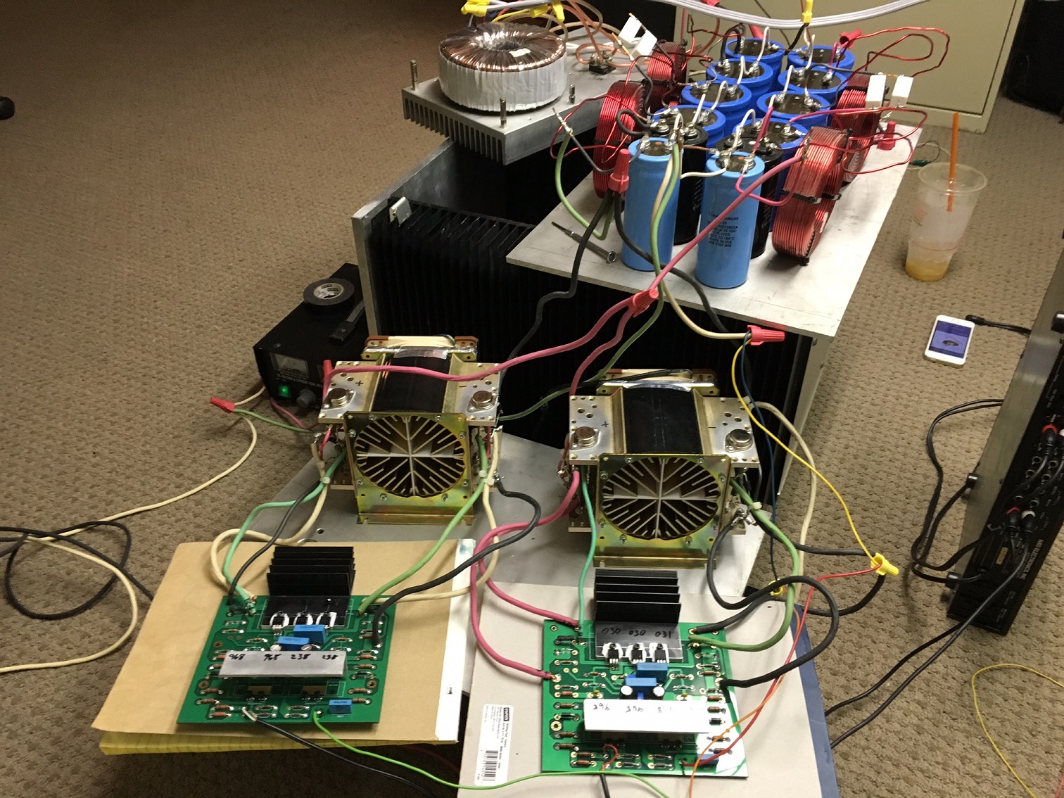

Can anyone tell me if Krell output transistors - part #'s 484081 and 484002 from a KSA-300s could be used for my KSA 100 build. I have access to quite a few of these, but I am having trouble cross referencing the unique Krell part numbers.

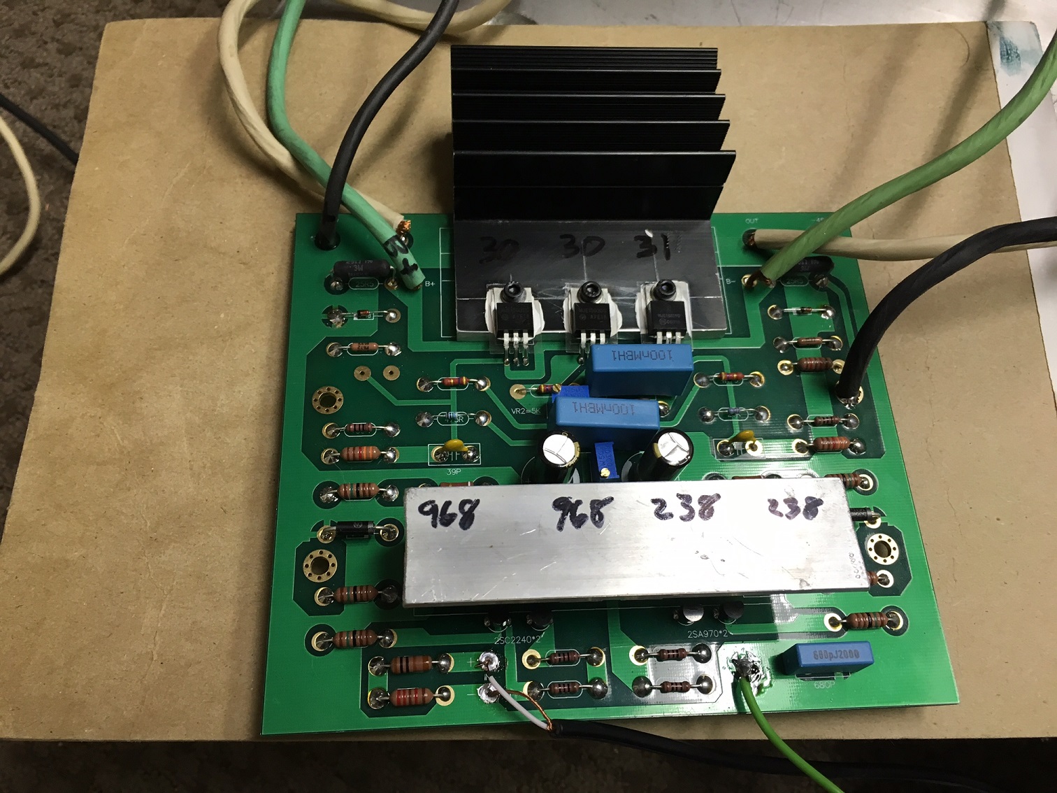

Lots of parts have arrived this week, so far I have most of the driver boards soldered, just waiting for some heat sinks to complete.
I was lucky and was able to source some VP0210N and VN0210N! I am using individual heat sinks on the VP's and VN's, I think these should do the job, together they have a bit more surface area that the aluminum bar which Krell used and I don't need to worry able electrical isolation. Fingers crossed!!
I wasn't able to source from legitimate suppliers any 2SA968 OR 2SC2238 ( I do have quite a few I've purchased from Ebay - but I have yet to determine if they are real or fakes). So I am going to substitute these with 2SC2336 and 2SA1006 that I purchased from a good source. Any thoughts?
@Bonanza; purpose of aluminum plate is to ensure equally warming of all transistors
New genuine 2sa968/2sc2238 is almost impossible to find. Everything on the net is almost likely fake, used or refurbished.
just swapped out questionably sourced 2SA968/2SC2238 for 2SA1837/2SC4793 from mouser. I can certainly tell a difference; too early to tell if they are better yet.

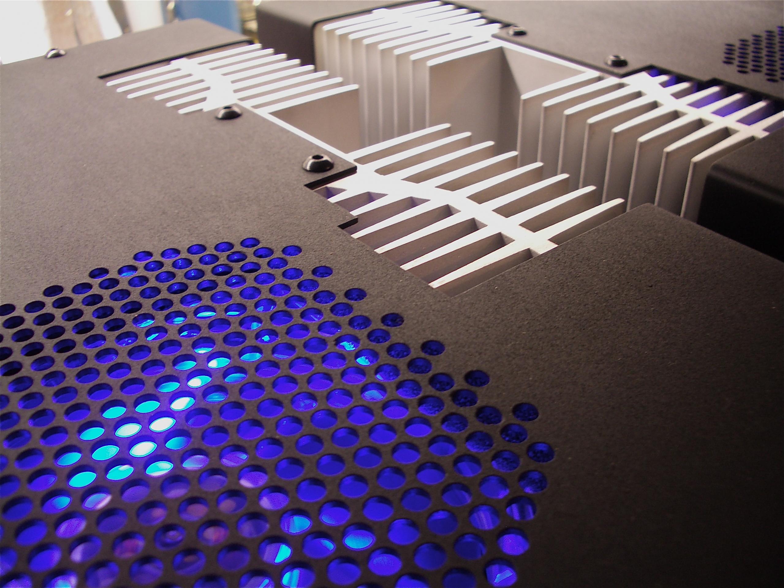

The fan only cools about 11c from the internal fin area, but its just enough to make a difference

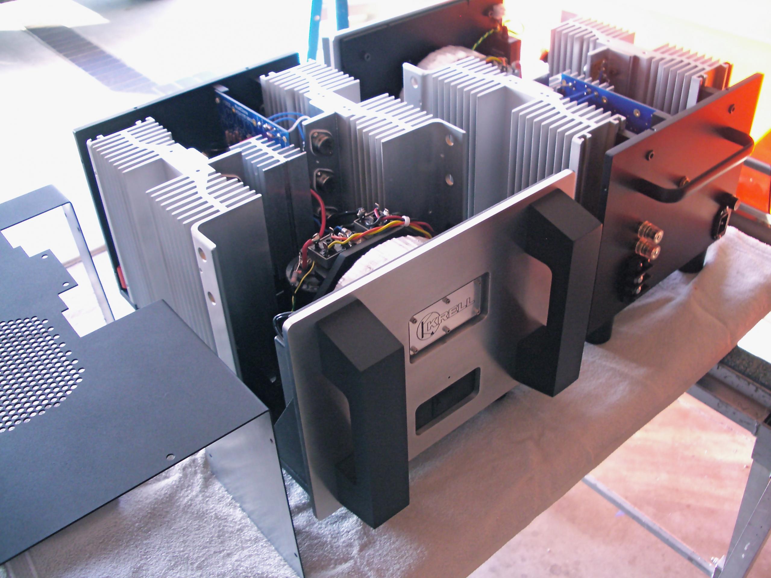

My chassis' finally arrived and I've started assembly.
Fans, softstart and contactors installed. Under the softstart is a 12v power supply for the fans,
Trial fitting the heatsinks.
Two fan speed controllers, rectifier board and trial fit driver board. The capacitor bank is below this.
I'm hoping to have the first amp wired over the weekend!
