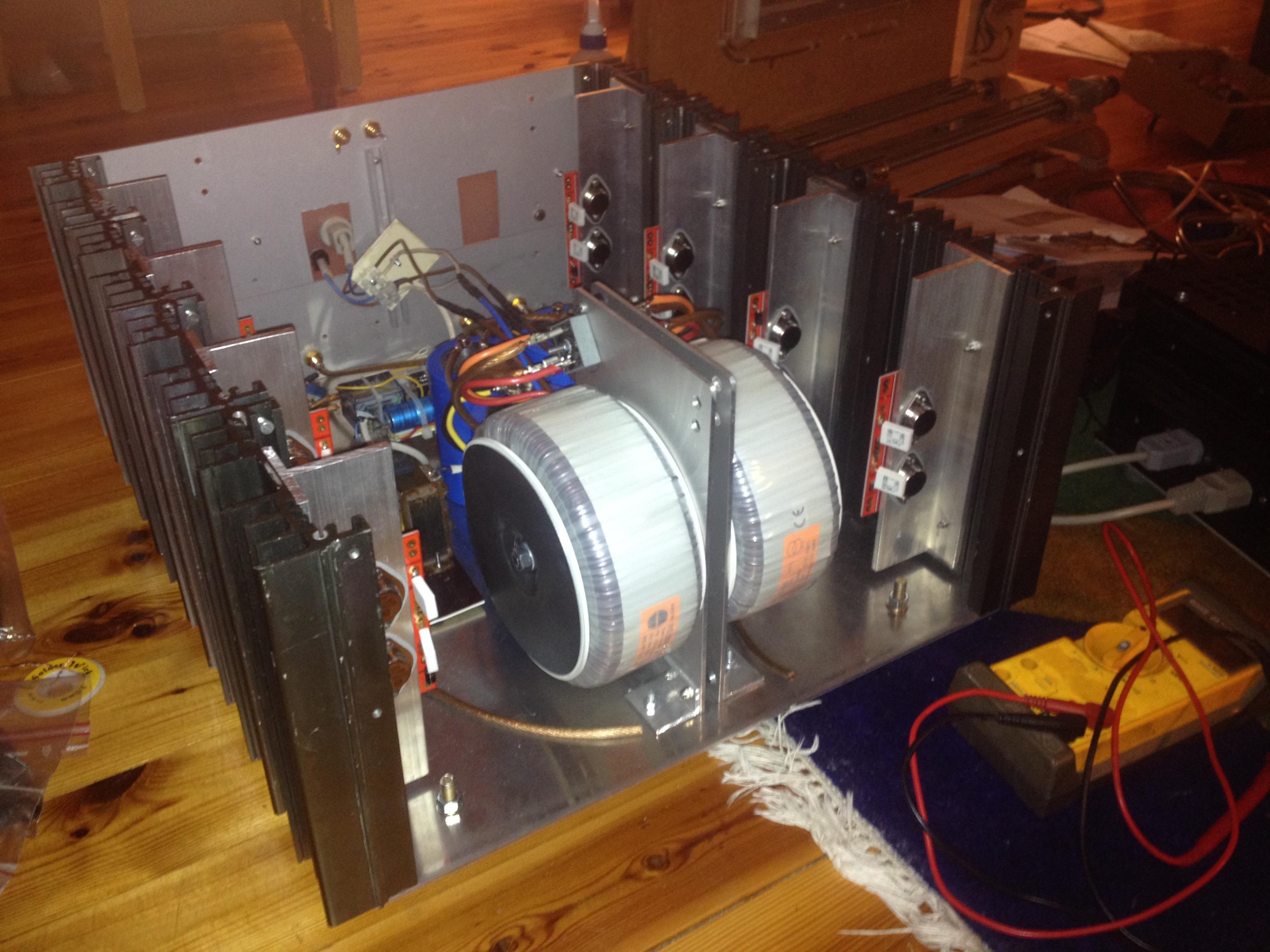

We will see how efficient this material is for heat transfer. Thermal Interface Sheet, Graphite, 1750W/m·K Should be much better than conventional heat sink paste
Not knowing if it is relevant here, but you are aware that graphite is an electrical conductor?

It is not used under the transistors. Just between the aluminium T-bar and the outer heat sink.
The layer of graphene is very good at transferring heat through itself.
Is it conformable so that the interface between the T bar and the graphene has a low thermal resistance? i.e. does it exclude air from the interface?
And is the interface thermal resistance between the graphene and the heatsink good enough?
or does the graphene need thermal goop in both the interface contacts to achieve a low thermal resistance from T bar to heatsink.
One thin layer of thermal goop does achieve low thermal resistance.

I am curious myself to how this material behave. Here is the data sheet :http://docs-europe.electrocomponents.com/webdocs/142b/0900766b8142bbc9.pdf
the in plane thermal conductivity is superb. stated as 1750W/mK
The through conductivity is stated as 11W/mK
The spec makes no mention of conformability.
Can we read that as meaning we need to add in an air excluding medium to achieve good through capability?

May be. I am a little uncertain about that. The thickness of the material was one thing I was a little worried about. The only thing I could do was to see to plain surfaces and clamping them hard together. May be the type with adhesive on one or both sides is a better choice?
Is adhesive with a defined thickness better or worse than a thin goop layer that permits metal to metal contact?
I am certainly not in the position to tell. I have to try this first and see how it goes, may be it works well. At least, well enough for this amp.
For all your work and other good parts I hope you use Ixsys low noise AC bridge rectifier not a regular one. Set bias so output device measure 50'C on their cases, because as others have said the heatsink is too small for full class A, but don't worry you'll still enjoy it.
You also need a soft start for that size of transformer and capacitors
DC protection and speaker delay is in the back there. And for current inrush (softstart), it is in place in a separate enclosure. Working fine.
Absolutely need more cooling surface. Running really hot at around 300 mV bias. Just as some of you predicted. Have a small issue with the dc offset adjustment. Can not get it under 0,5 volt so some fault finding is needed when I get some spare time.
