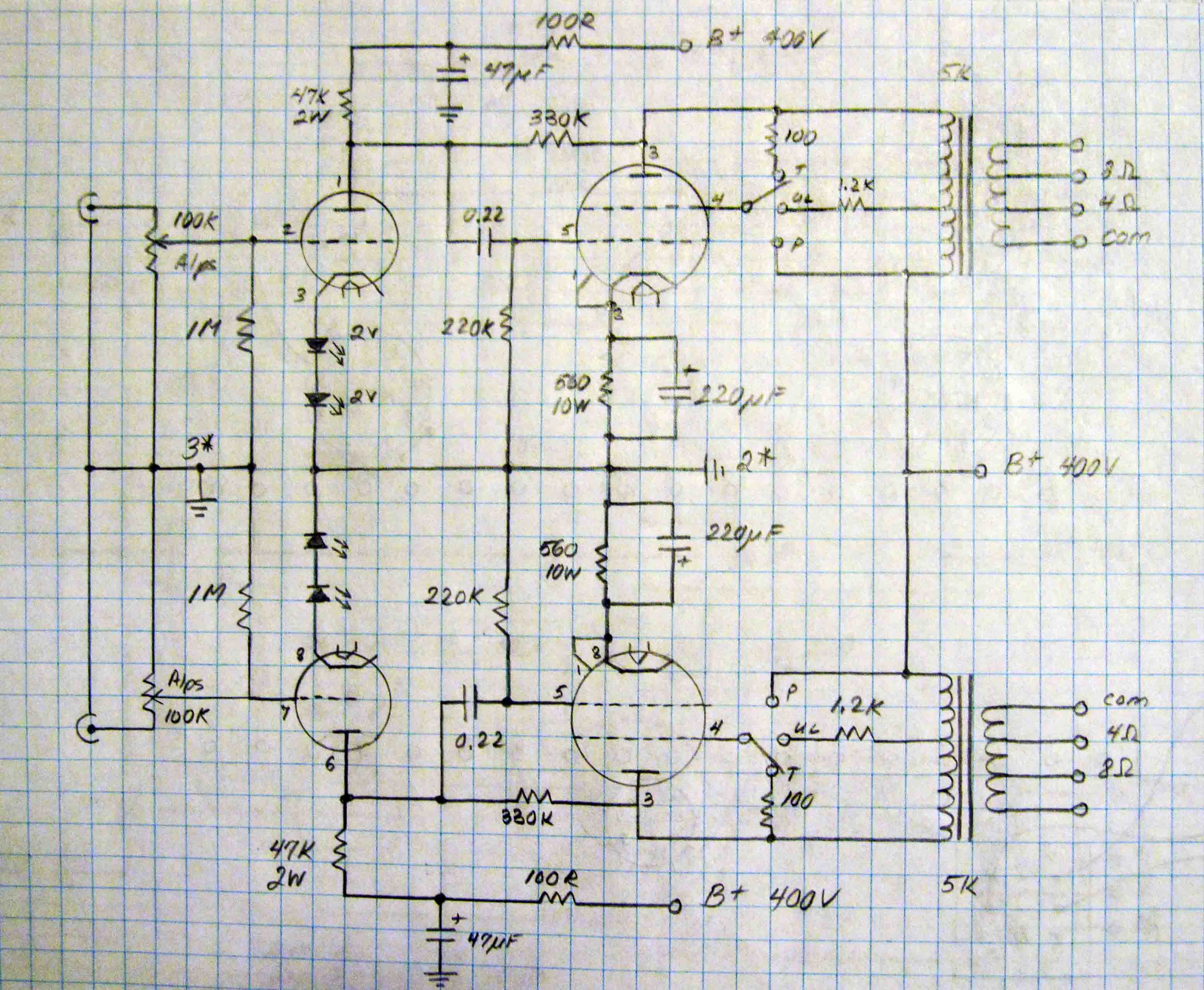

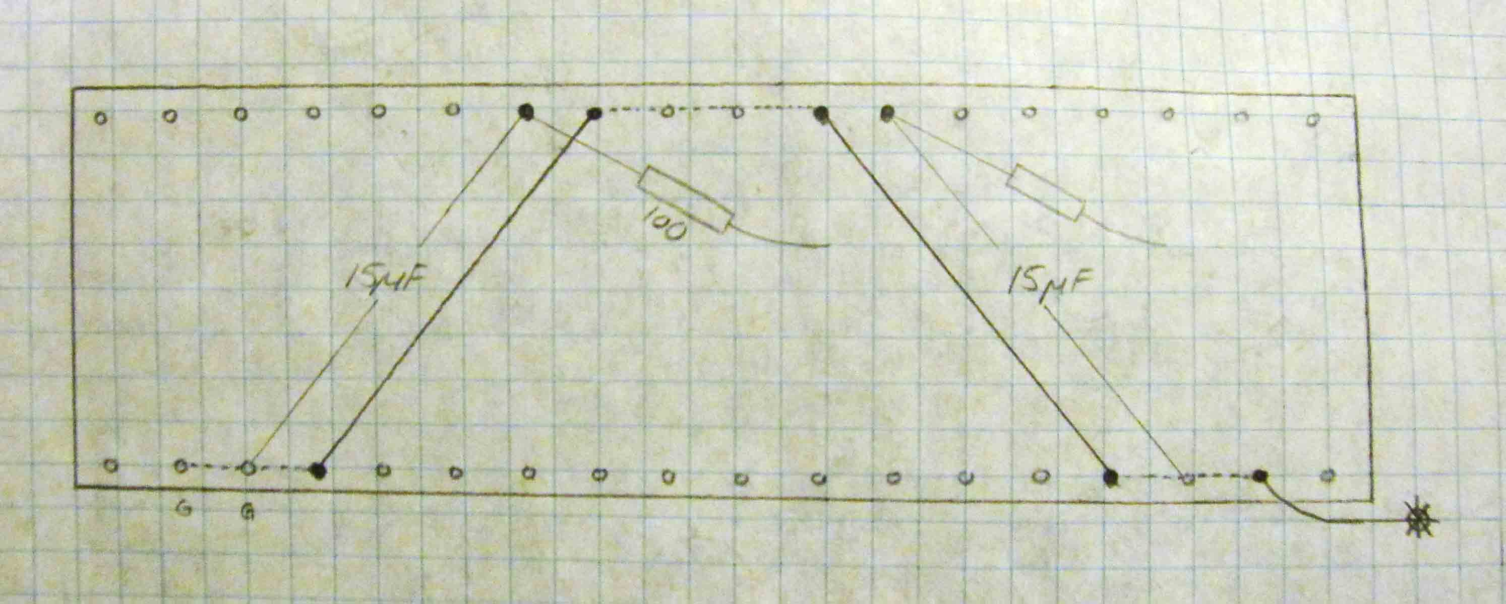

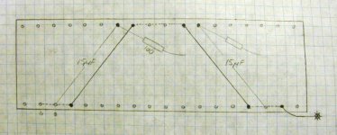

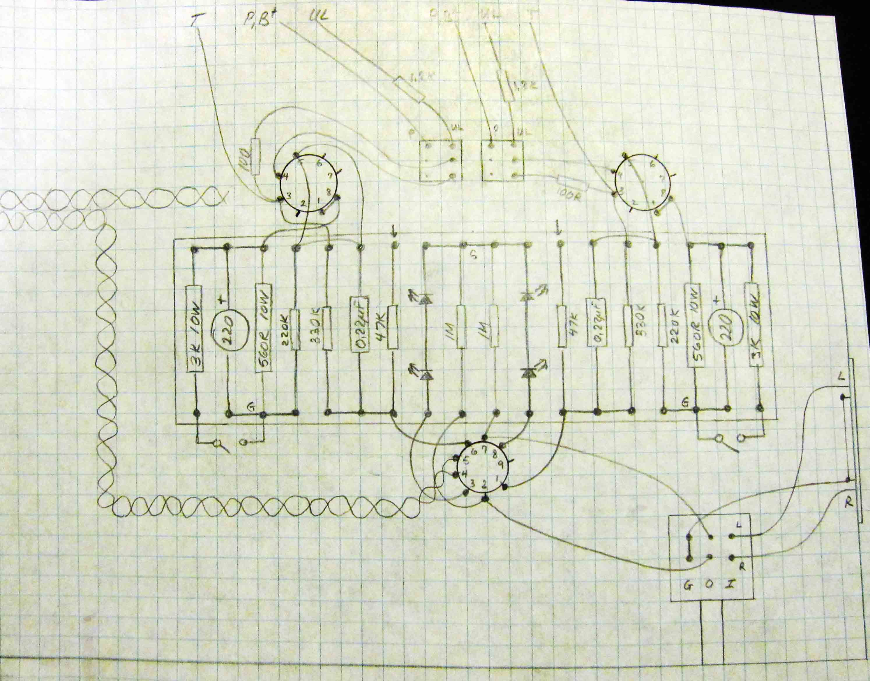

I've included my schematic and tag board layout. The schematic is a hybrid from porkchop, kegger (AK), and AlexG. Thanks a million guys, and thank you jmillerdoc too for the generous advice!
Here is my PSUD2 scenarios: (398V estimate open voltage of Hammond 375-0-375V PTX, all PSU caps ASC)
1. 375VPTX - 5U4G - 10uF - 10H - 100uF. B+ = 414V, Ripple = 0.14V
2. 375VPTX - 5U4G - 20uF - 10H - 100uF. B+ = 419V, Ripple = 0.07V
3. 375VPTX - 5U4G - 40uF - 10H - 100uF. B+ = 420V, Ripple = 0.033V
4. 375VPTX - 5U4G - 40uF - 10H - 50uF - 100R - 50uF. B+ = 402V, Ripple = 0.014V
Just a few questions:
1. How are the tag board layouts for lowest hum potential?
2. Before the 6NP1, which RC filter is better: 250R + 10uF, 100R + 15uF, or 100R + 47uF?
3. Should I use 1kR before the input grid of the KT88? If so, does the 1.2kR before OPT tap or 220k grid leak resistor change?
4. Would adding a 150-250uF cap on B+ before OPT help with dynamics and transients?
5. Is it OK to use 2 separate twisted pair of heater wires going to 6N1P and KT88 pair?
6. For the T, UL, P mode switch, would a 3A 250V minature SP3T toggle switch be OK? (BTW, the pin diagram for the switch on layout is arbitrary)
7. Whats the best value coupling cap: 0.22uF or 0.33uF?
8. Has anyone tried a 6BQ7 tube in place of the 6N1P?
9. At what clock position of the tubes guide pin do you get the most glow?... I have the tubes oriented as shown on my tag board layout. This is my first build and first tube experience so I have no idea! I am a 4 month newbie to tube circuits.
Thanks!

Mine's different but......
I built mine a little different. You have a few things on yours I omitted, I basically used the schematic at the beginning of the thread. I will try to answer the questions I think I have a grip on though...
1) I think you did the tagboard great. The driver stage, pot, and RCA inputs are all nicely seperated from your filament supply, etc...I was much more careless about this but I put DC to my filaments that was rectified and smoothed with over 9KuF. I also ran my inout wires from the back of the amp, right under the power trafo all the way to the front where the pot is and then to the driver tubes (I used 2, 1/2 of 1 for each side) on either front corner of my amp. All inout wires are silver wire and double shielded with all shielding starred at the main earth gnd. I have not noise or hum, period. Not sure if it is b/c of the DC or the shielding but I was much more careless about layout for the sake of aesthetics and it sounds perfect. I would re-consider the placing of a power resistor on either side of your 220uF....electrolytics are very sensitive to heat. I would put the cap all the way out to the edge, closest to the 3K.
2) I guess that depends on what you are after...I presume the least amount of ripple. If that is the case I would go with the 100R+47uF. I used a 30H 595 DCR choke and a 15uF cap, again...worked perfect, no motorboating.
3) I used the 1K grid series resistor, no change to the 220K leak resistor. I did not use the 1.2K you mention....works fine and is one less noisey resistor.
4) Again, mine is different but I went with this theory and put 162uF. I didn't compare it to a circuit without it so I can't be for certain it helped for dynamics (definitely helps decrease ripple). I am afraid if you add the whole 150 or 250 (mine was a total of 162 where 100 was intended) you will start having problems with exceeding the rectifiers forward current, check it in PSUD2 first.
5) why not? I did.
6) Should be fine. The voltage might be higher but the current rating of 3A should keep that in check. I used a similar rated rotary.
7) Again, best is in what your are measuring. You will pass lower frquencies with a bigger cap. 0.33uF would be "best" although 0.22 should work ok if that is what you have on hand.
8) no, not a 6BQ7. I did try the 6DJ8 with the cathode resistor set at 1K. It sounded off and I have intentions to place a switch similar to the one at the cathode of the KT88 to drop it to 500R.
9) Wife is asleep in the bedroom where the amp is, that one will have to wait till the morrow 🙂
Hope that was helpful.
Jeff

Your tagboard looks great!
I only use this type of construction because I started this hobby building guitar amps. Strange how these hi-fi amps are a lot more tricky to build 🙂
Please post some pictures when you have your build complete.

Another question: how did you do the grounding? To have flexibility I have one cable for each component (connector, driver cathode, kt88grid, kt88 cathode) plus power supply, socket earth and transformer earth.
Yesterday they were just all tied together with a screw and I could measure 6 V AC on the plate (No good)
Now I have the following configuration:
a) Socket earth and transformer earth connected together in point 1 to the plate.
b) Power supply connect to point 2 to the plate
c) All the other connected to point 3A and 3B, one for each channel.
The secondary of the OPT is not connected to anything and is isolated from the plate.
Does it make sense ?

Jeff, by the way, when your switch is in one of the null positions, you should have very similar reading like I had with the 1 M ohm resistor. That;s why it sounds horrible 🙂

I have a single point ground. All ground connections will go directly to this point, including the AC mains ground.
I do know that any loose ground connection can potentially cause varying degrees of interference problems.

I am thinking of getting rid of some of the ground wires. I tried to shorten the ground at the components location and did not hear any difference, but I will check with the oscilloscope before cutting.

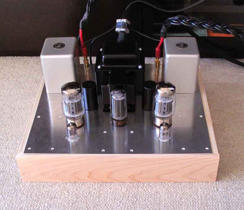

The ampli is playing now, I still have to finish some details inside, but now that it works, I feel kind of lazy.

Star ground works best for me and the simplest.
The amp turn out NICE!
Can we take a peak of the underneath?
