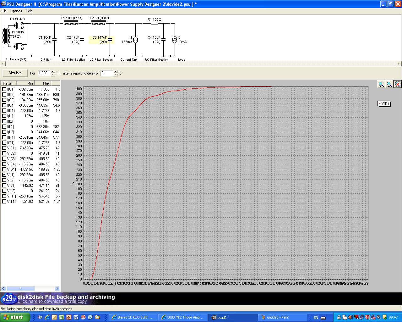

Only now I noticed that my power supply comes up like in the first picture, what do you think ? No good ? I could add a 100 uF at the second cap, and this should make it more smooth. It's too bad if I just put a 100uF unicom in parallel with the 47 uF film ?
A 100 uF film, first will cost me other 50 $, while I have the electrolitic, second is 12 * 4.5 cm, not sure I can stick it inside.

I think you modeled it wrong, you need to place the current tap before the 5H for the KT88's, you have it after the 5H choke in the model, this is not correct. Make this change, it will fix everything you see. It is a mofdeling proble, not a construction problem.
Jeff

Actually the model is exactly how I wired it? The two LC filters are before the KT88s.

You will indeed have problems with this arrangement. The B+ tap for the KT88 should come before the second LC filter. The second LC filter is for the driver tubes only. Does it work like this? I would be surprised it sounds well at all with both LC filters before the KT88s. I haven't looked closely at the voltages but they should be off the way you have it wired. If you look back at the DIYaudioprojects.com version of this schematic you will see that the second LC is shown only on the circuit and not the power supply indicating actually 2 separate second LC filters, one for each driver (although I don't think that is how he built the circuit as I recall). Try pulling the B+ for the drivers before the second LC filter and see how it sounds, I think you will find a much better sounding amp.

Why you think that the double LC filter does not work ? My goal is to reduce the ripple on both the taps. With the simulations I figured out that having CLCLC was much more effective than CLCRC. I get 397 V as my B+.
I don't really like the voltage to oscillate anytime there is a current request. but If I understood how the system works the current demand should not exceed +10mA for both channels, and a cap configuration as 10uF-47uF-147uF instead of 10uF-47uF-47uF should fix it. It makes sense, but maybe there is some effect that I am ignoring.
I have the constrain that I have 3.5 cm holes on the plate, so it means that I can fit either 100uF Electrolitic caps or 47uF film caps. I thought that adding the second choke I could fix the problem using tha caps I have.

Adding chokes does more than just reducing the ripple, it changes the power supply entirely. Changing the power supply entirely changes the amp entirely.
How does the amp sound in the current configuration?
What is the current rating of the second choke you have added to the filter?
If you went with 247uF (10u/10H/247u/B1+/......)
you would get a ripple of around 0.06v, should be enough. I am just concerned with the final result you will have by adding the second choke before the B1+. If it works than you can't argue with results.
