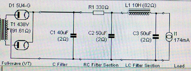

What is the DCR of your choke?
I run a simulation on PSUD2, I assumed the DCR of your choke to be 150R, with the KT88 biased at around 70ma each and the 6n1p biased at 4ma each, your B+ should be around 383VDC, this should work very well with the circuit.
HTH.

Thanks Jeff and Seel34 for the advice!
I was never taught how I should use PSUD2. I've been trying to figure it out on my own. Based on what others were getting, I quantitatively deducted that the "no load voltage" to be around 398V on a 375V PTX. I began to question myself, and decided to measure the this "no load voltage" on the actual transformer, thinking that's a direct method. Thanks, Jeff for explaining how I should be using PSUD2. I'll keep it as a 100% simulation.
I just ran the program again, and entered 375V and 0.175A, and I now realize that PSUD2 calculates the "no load voltage" at 393V. Hope that sounds right?...
By the way, I originally was simulating a CLCRC filter, then there was discussion of ripple being better in CRCLC configuration - that's why I had 2 caps before the inductor. Oh well...
I hope I did things right - here are the simulations I am getting for my PSU:
375V PTX (393V) - 5U4G - 40uF - 10H - 50uF - 50uF
V=406, Ripple=0.034V

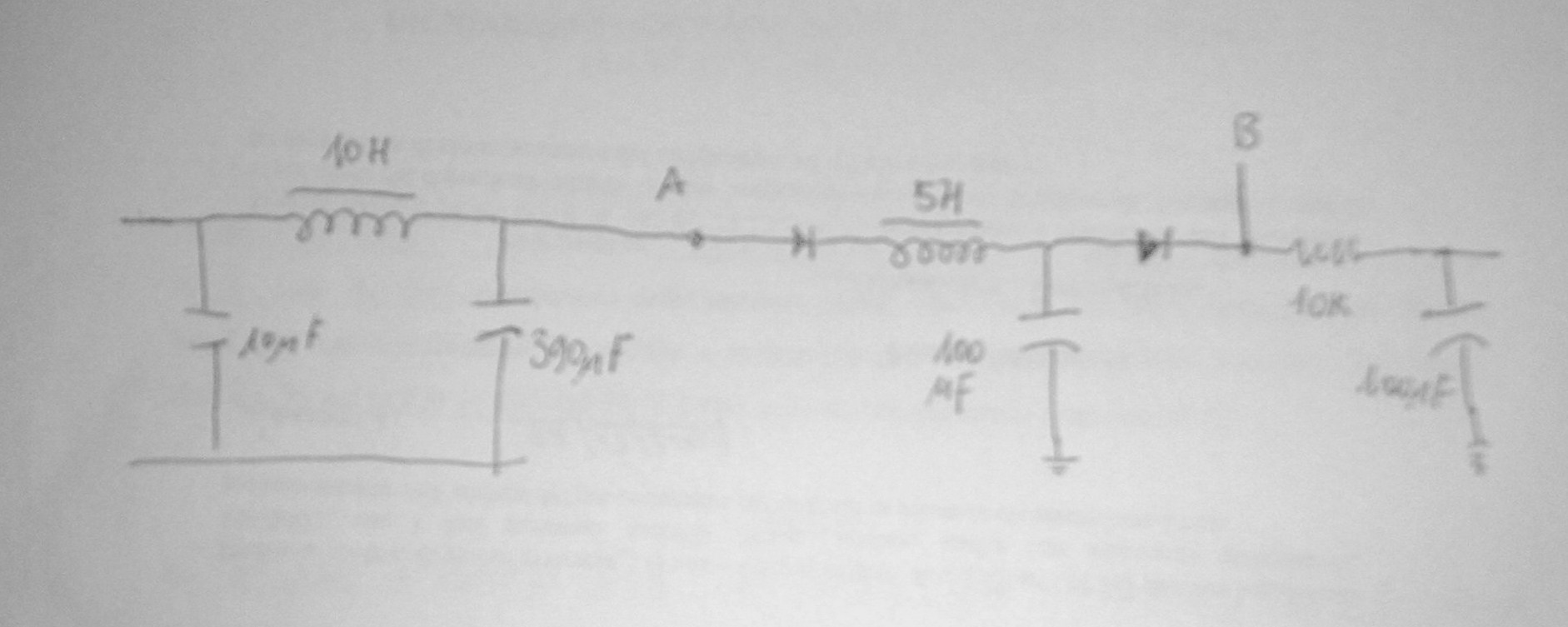

Hi all,
I built this amp 6 months ago, I'm very happy with it.
A friend suggested a lot of mod, and I tried almost all of them.
Has someone tried to divide the B+ just after the first common CRC?
Or used 2 power tranny?
I used LC and fast recovery diodes trying have a sort of separation of the 2 channel. Think is sound improving.
Happy new year
V.

Diodes
I have given some consideration to this idea but I have never actually heard of it being done. Seems to me if you place a diode on the B+ after the split that would help reduce crosstalk through the power rail......at least that is what I have theorized until now. How exactly did you place the diode? Did you also bypass the diode with a cap? I have a few fast recovery diodes laying around and was thinking to place at least 2 in parallel on each power rail after the last cap in my circuit. Is there anywhere you know of where I could read more about this approach?
Thanks,
Jeff

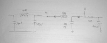

Hi Jeff,
I don't know if others have tried. As I wrote before it was a friend of mine to suggest that mod. I will ask.
If I remember right (I'm not at home to check if I'm right) the schem was that you can see in the attached file.
excuses for the quality, it's the best I can do from here
the A point is the splitting channel point. The B point is where you split B+ to go to OPT. then you have the part with the RC 10k / 100uF where you go to the driver. It was suggested to me to use schottky diodes, but I couldn't find them here.
The last 10k/100uF will soon be replaced to LC 5H/100uF to try how it sounds.
The load on the driver is now 37K, with the LC will be 47K as per original specs.
Hope you can understand my poor english,
Vincenzo
