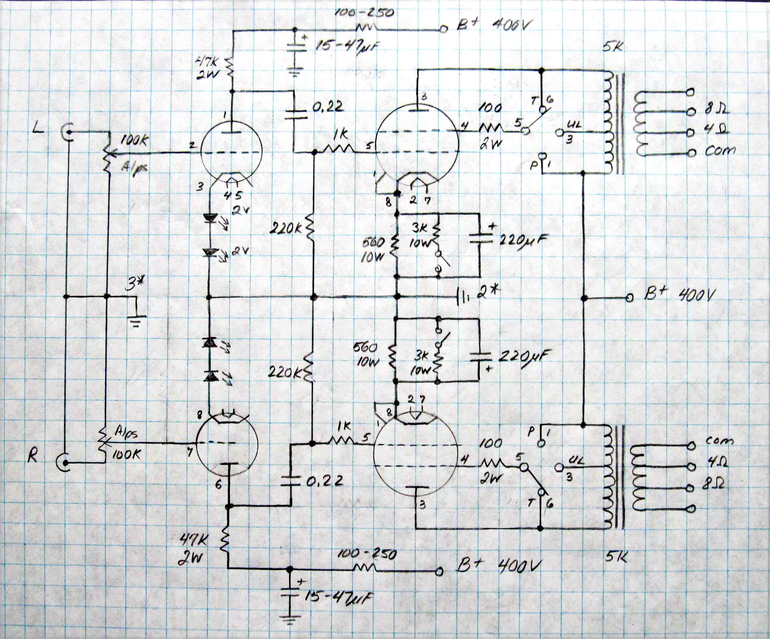

SE KT88 Amp
This is it! To keep things simple/pure (less R in signal path), I am going to use Glenn's version of the schematic with the addition of an RC filter (100R + 10-15uF) before the 6N1P plate for less ripple going to the driver. I am also going with an 2V LED cathode bias on the driver tube. I have some design and safety questions before final assembly:
1. Should the RC filter (100R + 15uF) have its own star ground or can it be shared with the tag board star ground?
2. Should the individual B+ for 6N1P and KT88's be twisted or can run parallel?
3. Can I have 1 shared RC or 2 separate RC filters going to the single 6N1P?
4. Does it matter if 5K ohm OPT primary goes to pin#3 on KT88 FIRST followed by a jumper to the mode switch?
5. Please check for safety. I am using a Tyco SP3T 3A/250V toggle switch to control T, UL, P modes for each channel. Datasheet enclosed below and it states:
-Function: ON-ON-ON for the 3 positions
-Contacts are: 5-6 (up), 5-3 (center), 5-1 (down)
-"Customer installed external jumper between terminals 2 and 4 for 1 pole 3 throw function."
Does switch terminal #5 go to pin#4 of KT88 grid?...
Does switch terminal #6 go to Triode, #3 to UL, #1 to P mode?...

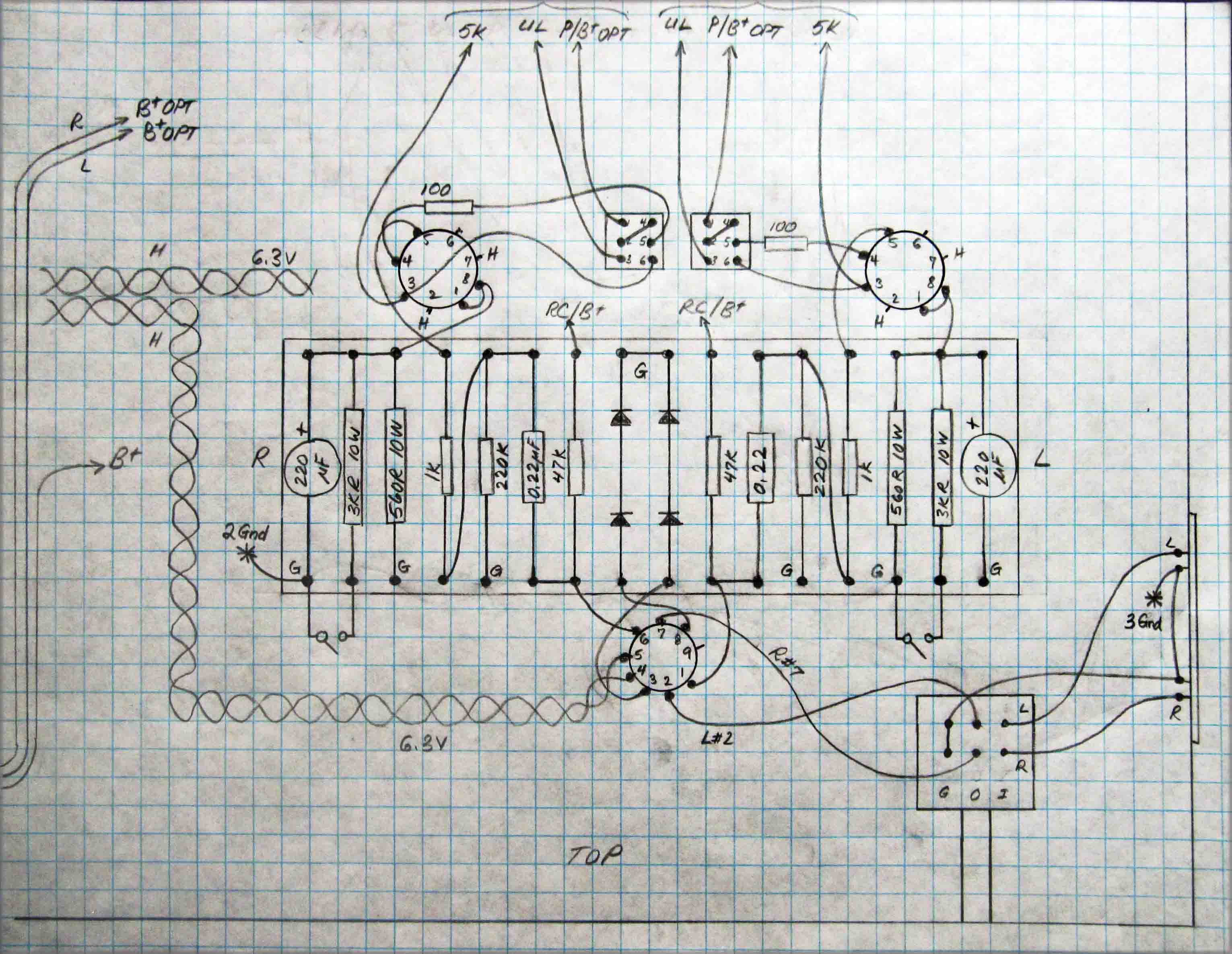

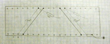

Here are my new schematics and new tag board layout.
Thanks guys!

Nikon1975, according to PSUD2, and with my values of 5U4G-40uF-10H-50uF-100R-50uF, the CRCLC has 0.013V ripple, and the CLCRC has 0.014V ripple. I am not sure if we'll be able to hear 0.001V difference, let alone 20mV...

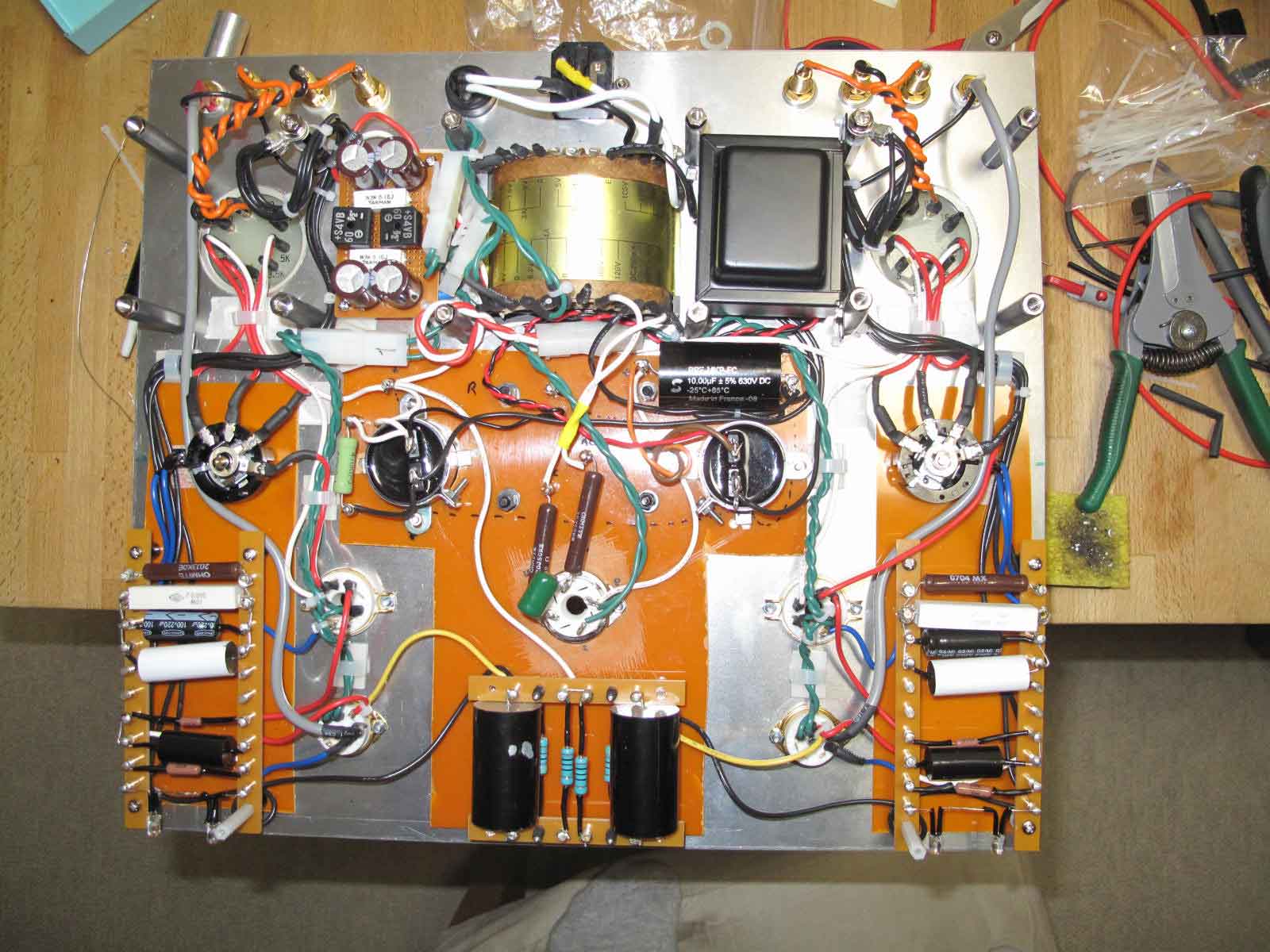

i am also loving this amp ,here some pictures of my amp ,as opt i am using american transendar trafo,s they are also suitable for 300b , got the from ebay from a very friendly seller [geat] i using a 6n1p-ev voskhod 1975 as driver,0,22uf 1000volt pio ,s, 2 old real tesla,s el34 militairie specs el34 and a jan philips 5u4gb ,find the bass more beautifull then with 5u4
i never use circuit boards in my amps ,just a 2,5 mm2 koper wire straight from the power transformer as ground ,wich makes it easy to conect the parts ,i am learning a lot on this forum ,i am a practical builder who can read schematics ,but have very less theoratical knowlege ,how things work and how to calculate ,thats what i am learning here,

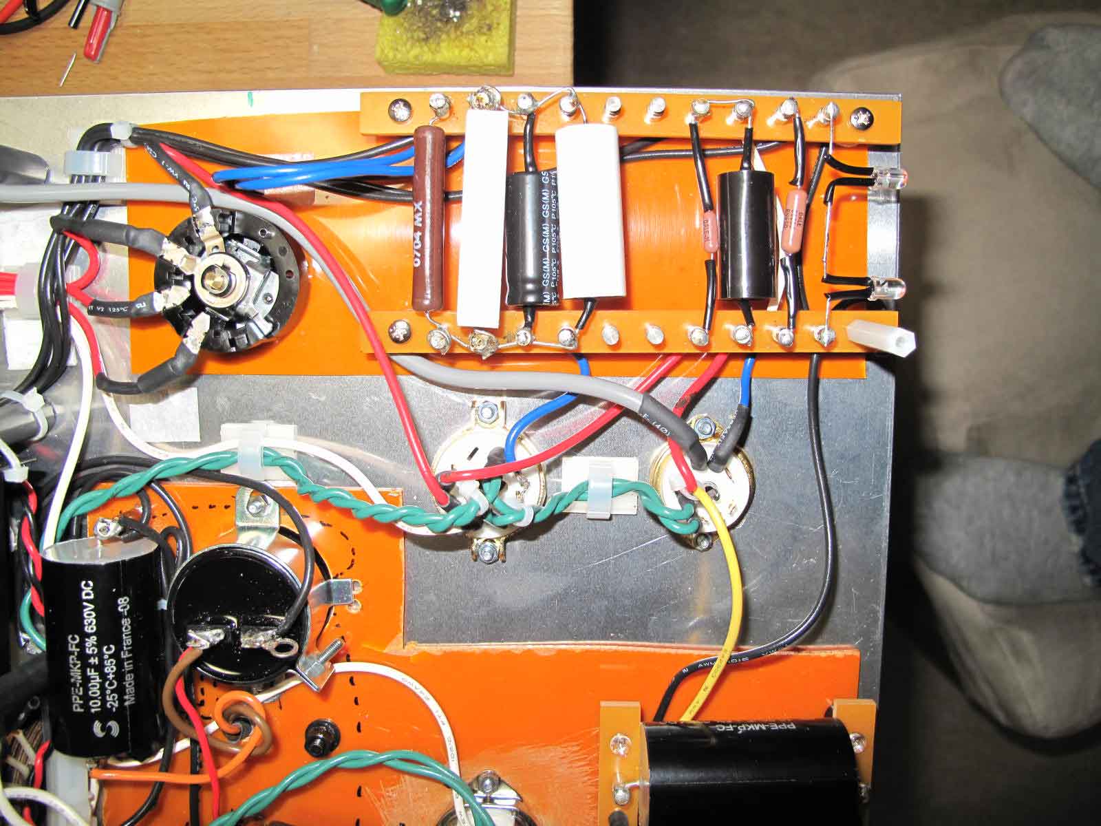

So, this is my messy cabinet inside. I put the switches out, and tried to clean a bit of mess, not very successful in the latter 🙂
Anyway in the second picture you see the audio stage of one channel. From the right you can see:
1) 6N1 Cathode leds (matched I have 3.438 V it both channels)
2) KT88 220K grid resistor
3) Coupling capacitor
4) 1K resistor to grid
5) Last block is the cathode resistor and capacitor (snubbed randomly with 1uF)
I was wondering if it's worth just to put the coupling capacitor between the two sockets, reducing signal path... I mean I don't have any noise.
Jeff, for the OPTs for the next project (300B) I think I will go for Japanese ones next project...I live in Tokyo.

So, this is my messy cabinet inside. I put the switches out, and tried to clean a bit of mess........
By the way, what tube to choose ? Any idea ?
What mess??? Looks great!
Where did you get those nice selector switches we see from the underside? I love the way they hook up.
