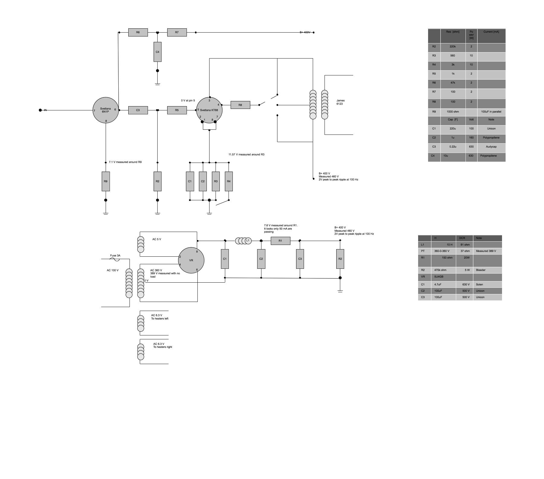

Scheme and rectifier
I think that I was not clear on my porpouse in posting my scheme, and I created some confusion.
Actually I am going to implement the amplifier following the electrical scheme of the first post. The only modifications that I would like to try are:
1) diodes on the catode of the driver
2) I catode resistor of the KT88 to 500 ohm, just because I could not find a 560 ohm 10 W one. I will try like this, if I get in trouble I will add a resistor in series.
3) I added polypropylene capacitors in parallel with the catode capacitor.
The initial reason why I send my scheme, is that I realized that was not really trivial to find a layout for the components in the cabint in order to have a bit of order inside the chassis and reduce the interferences, so I wanted some comment on the distribution of the components I drew.
How big are your chassis ? I want to mount everything on a single plate and I get fomething like 40 X 35 cm.
Also I was wondering how you do with the grounding, I am planning to have an indipendent wire for ground for each part of the circuit(driver catode, kt88 catode, k88 grid and driver plate filter) and to connect them all in a single point. This to avoid ground loops, and to have the possibility to make current measurements in an easy way.
Last thing, I found the following browsing about the rectifier:
3) If Capacitor loaded, you must have a minimum required copper resistance of the transformer winding.
This is an old design rule, obligatory for any 5U4G, EML or other brand. If capacitor loaded, the first capacitor must be chosen at or below the maximum value in this data sheet. At EML we adapted to the same values from old data sheets. So there will be no doubt about those values. The minimum resistance is specified for the complete winding. (So not measured from the center tap). In case you use a transformer with too low copper resistance, you need to add one series resistors in each HV winding connection of the transformer. Then, with those two resistors in series, you re-measure the transformer winding, and the result must be as follows:
Raa, value, for Curves 1...6: minimum 170 Ohms
Raa, value, for Curves 1...8: minimum 230 Ohms
Now I could find in the datasheets the story of the max capacitance, but not the story of the max resistance. I am using a 5U4GB, and I have 40 ohm of DCR. far below what is requested. Any additional information?
Best Regards,
Davide

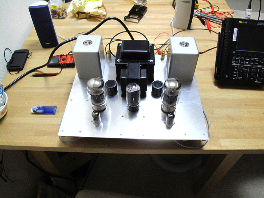

So, the good news is that I just finished my first tube amplifier (I had done the Elekit TU 879, but it's a kit, does not really count). I did not blow up anything, including myself. I just had a kindly reminder by one capacitor, about how unpleasant electricity can be...bleeder resistor for ever.
Here is how it looks like (without underwear) [IMG_1219.jpg]
Anyway there is something that is not right, and I don't manage to figure how what. On the graph you can see the voltage reading that I have (referred to ground).
I have a B+ that is higher than expected, as it looks like the tube drain less current than they should be. I have very similar readings for channel L and R. Switching between UL, triode and pentode does not change anything.
Each ground has its own wire, and now are all tied together in a single point.
I can tweak the B+ to get to 400 V, I am not sure this is the way to go. I would really appreciate some advice.
