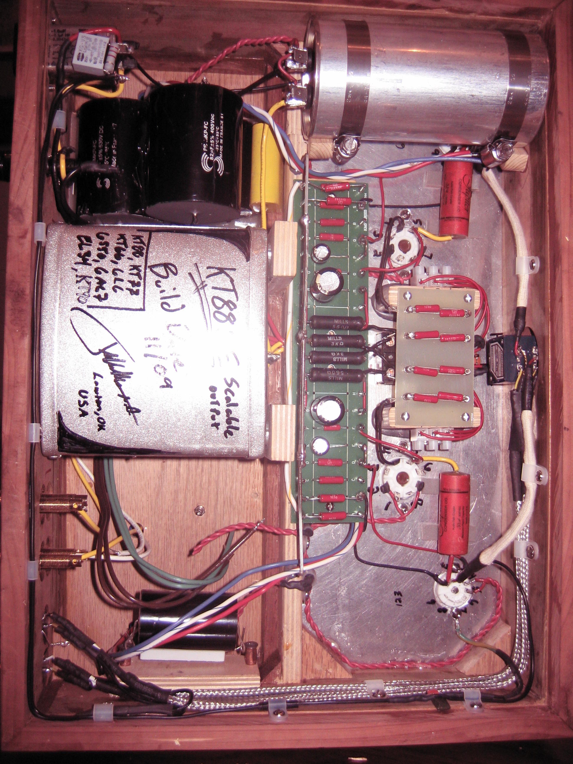

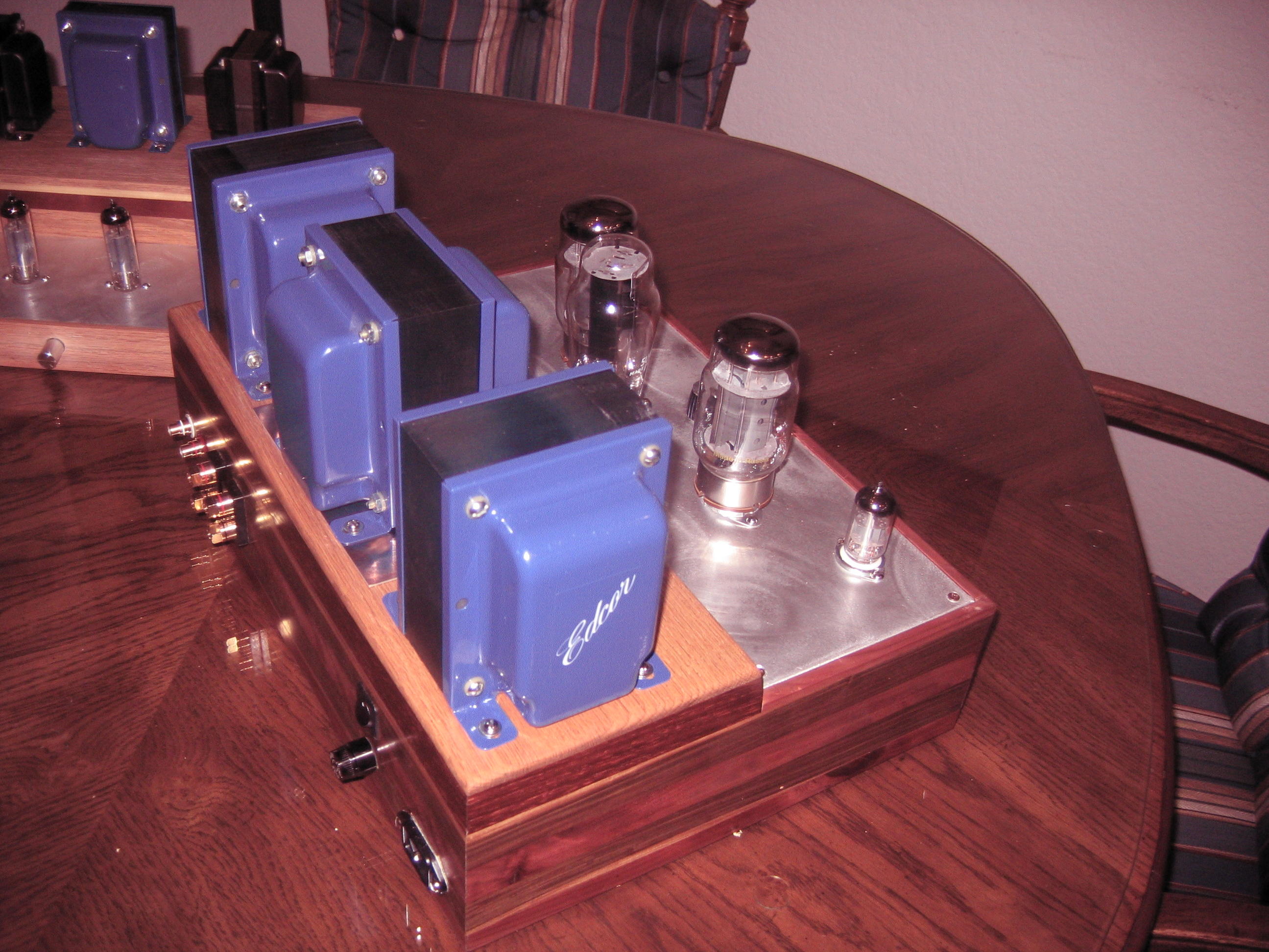

Here are a few fairly low res pics taken of my nearly completed KT88SE amp. A few things done differently is the power supply which I have modeled on PSUD2 to be right at the border of maximal operation of the 5U4-G tube. It uses a combination of Solen and ASC oil caps. The arrangement is a 25uf Solen -> 20R -> 47uF Solen -> 10H 77R DCR Wesinghouse choke -> 80uF ASC coupled parallel to an 82Uf Solen -> B+ tap -> 20R Wire wound -> 15uF Solen -> driver tap. The tube complement is a set of Mc Intosh KT88's and 6N1P Russians. The Coupling caps are 0.33 Jupiter Beeswax and tinfoil, All resistors are PRP or Mills (a couple of Xicon WW in the PSU), and Blackgate bypass caps. All wire used is silver stranded with some home built shielded cables to the RCA inputs and from a blue velvet pot to the driver tubes (white cotton covered cables). The power and OPT's are of course Edcor.

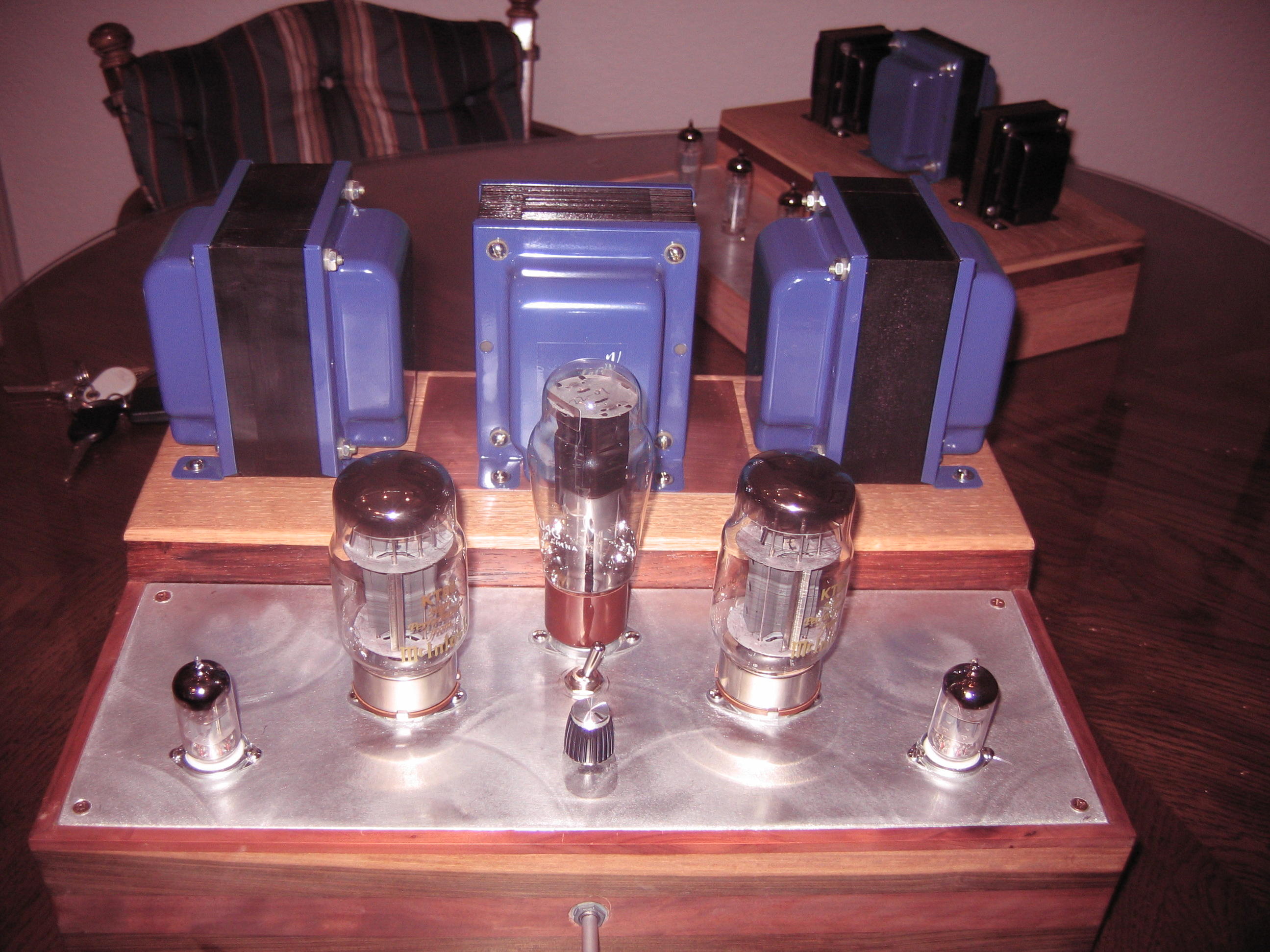

The Chassis is all hand-built from exotic woods including Rosewood, Madeira, Canary, red Cedar, and some oak. Binders and RCA's are topline Vampire's. Most of the passives were sourced from Soniccraft.com. The remainder of the parts were gathered from here and there like tubedepot.com and tubesandmore.com.
I need to finish the filament wiring which I decided to rectify and filter. I have 2 small modules with the rectifiers and filter caps not shown that will go on the opposite side of the large Westinghouse choke from the Solens seen on the right of the choke. power input is a simple filtered IEC jack bought at Jameco if I remember correctly.
I haven't powered it up yet and will likely have to make some adjustments to the power supply filter when I do. I find PSUD2 to be off every time I have used it but not by much. Once I am done I will try to supply some scope traces on it for ya.

Also, on the top of the amp, in front of the rectifier tube you will see a toggle switch and a rotary knob. The toggle switches the 3K into parallel with the 560R cathode resistors on the KT88's to change the current for the EL34 and 6L6 tubes. Also, the rotary knob switches between UL, Triode, and Pentode operations.

That is a work of art, very nice. I certainly hope it sounds as good as it looks. Now you've got me really psyched to finish mine. Can't wait to get the full report!

Jeff, don't keep us in suspense any longer - plug that baby in! Seriously, I am curious on your take on the sound. I see that your layout is different than Glen's or Alex's - but esthetically it looks balanced. I really like it!

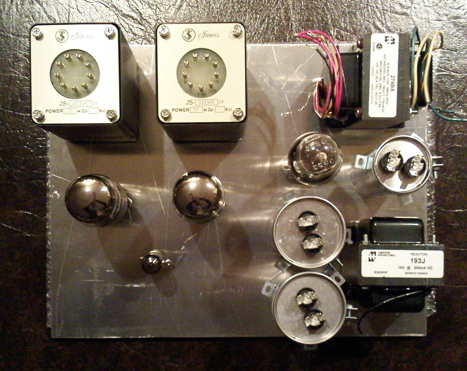

Hi Guys, how does the layout look?... I just got the T-6061 0.125in aluminum sheet 12.5x16in. I took everything out of its boxes. Here is an approximate dry fit of top panel components for a stereo set up. However, I was disappointed to see very thin leads on the Hammond iron - looks like 20ga stranded wire. I might try Edcor, or better next time...
Set Up:
PTX: Hammond 274BX 375-0-375 @175ma
OPT: James 6123HS
PSU: ASC Motor Run Caps, 440VAC
Tubes: Genelex Gold Lion MP KT88, Sovtek 6N1P, Sovtek 5U4-G
Coupling Cap: Auricap 0.22uF 450V
Bypass Cap: Black Gate 220uF
Driver Cathode bias: (2) 2V LEDs
Triode: Grid to plate 100R
Ultra-linear: Grid to OPT tap 1200R
Pentode: Grid to B+ OPT
Will Experiment With:
- 10uF, 20uF, or 40uF first cap in CLC to get output of 400-420V B+
- (2) 2V LEDs for driver cathode bias
- Siemens-Halske CCA 6922/6DJ8 with 560R + 100uF BG cathode bias
- 330k plate-to-plate resistor.
- 100R + 47uF RC filter to driver plate
- 1kR before KT88 grid
- 5U4-G, 5V4, 5AR4
- Coupling cap: Mundorf Silver Oil 0.22uF
- various speakers: Paradigm S20, S40; Klipsch La Scalas; DIY 3-way Scanspeak 218555-01/18W8545/9800 (eVeII)

Any Idea which way the laminations run in those James OPTs? Just try and make sure they are not parallel to the power trafo. I might also move the driver tube a little further forward, the farther from anything the better IMHO. The rectifier tube is awfully close to your ASC's. Some would recommend 2" if possible. I am not sure if the oil caps are as sensitive to heat as regular electrolytics but I wouldn't chance anything that might cause early failure. You might try swapping the rectifier tube with your 40uF cap, that would give you a little more distance from the caps (heat) and tubes (noise). You could even save a little surface real estate by tucking the smaller 40uF cap under the top plate (I did this with all mine). I like the split chassis design with all of the power on one side and signal on the other. Have you seen the ventilated socket plates at vt4c.com? I am placing a very large order with them this week and if you would like it wouldn't cost any extra in shipping for me to have them add 3 more to my order. I imagine it would cost a couple of dollars to ship them to you in an envelope to Boston. This offer goes for anybody watching this post at the moment, I expect to place my order in about 2-3 days. I have 10.1kg left in my order at the current shipping price I am at. I am already having to eat the cost on several items (shipping $100) so I might as well pass the savings on to any USA watchers who might be interested. This store in HK is awesome for the price/quality ratio but shipping sucks. I am buying the James OPTs for $200 here, I have priced them elsewhere for about 260-270 with an additional 20 or so bucks of shipping. so I figure it is worth it. Plus I got an additional 6% discount for my order quantity. Not too bad. So if anybody needs something from this store I am willing to front the cash to get it here to USA and you guys can pay me to ship it to ya when it gets here. My delivery time from HK is 3-6 days, I should have all this stuff in in about 2 weeks top. Let me know by private message if you need something in the next 3 days.
