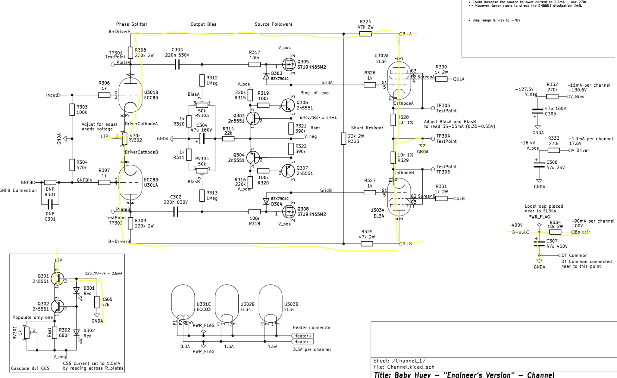

I'd be interested to know voltages/current draw without valves installed on the HT section. Then add in one channel's valves. Then swap channels. You'd expect approx the same channel to channel.
Yellow lines are the current flow on the HT for one channel. So if there's a issue somewhere, it'll be on these runs. With no valves there will be no current, basically, other than any imbalance across R323 and heater elevation. Check across R334 and R434.
Add in the preamp valves - there should be a tiny drop across R334 that your multimeter probably wouldn't measure. Check instead across R305. If OK, add in the EL34s. Check individual currents at TP303 and TP304. Make sure they are sane. Add these together and check across R334.
All I can think is there is a short somewhere that means the FET / diode is burning up. Or perhaps the board is damaged - arcing somewhere? So bypassing the ripple filter section will be telling.

Current through R334 81 mA
Current through R434 83 mA
Current through both R305 and R405 about 2.4 mA.

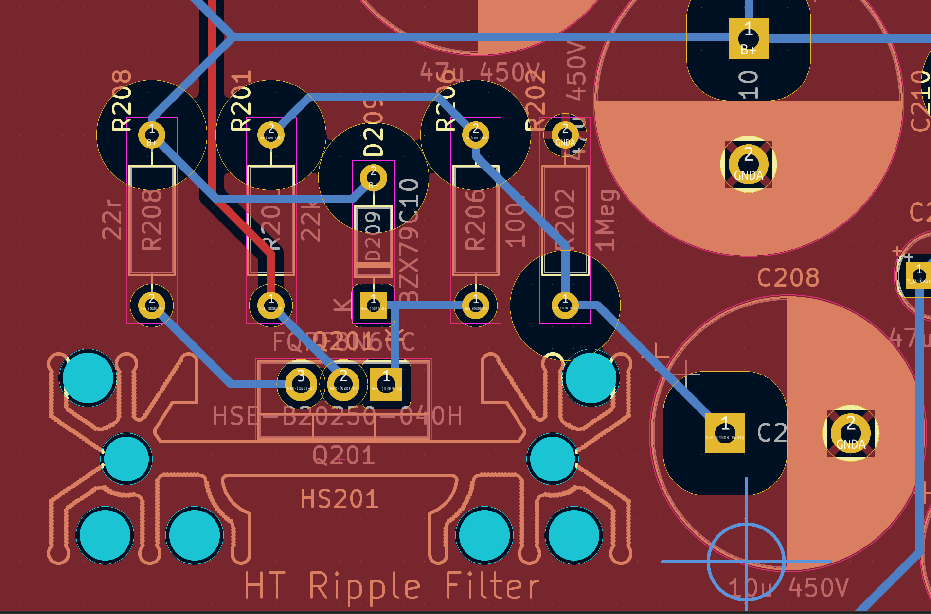

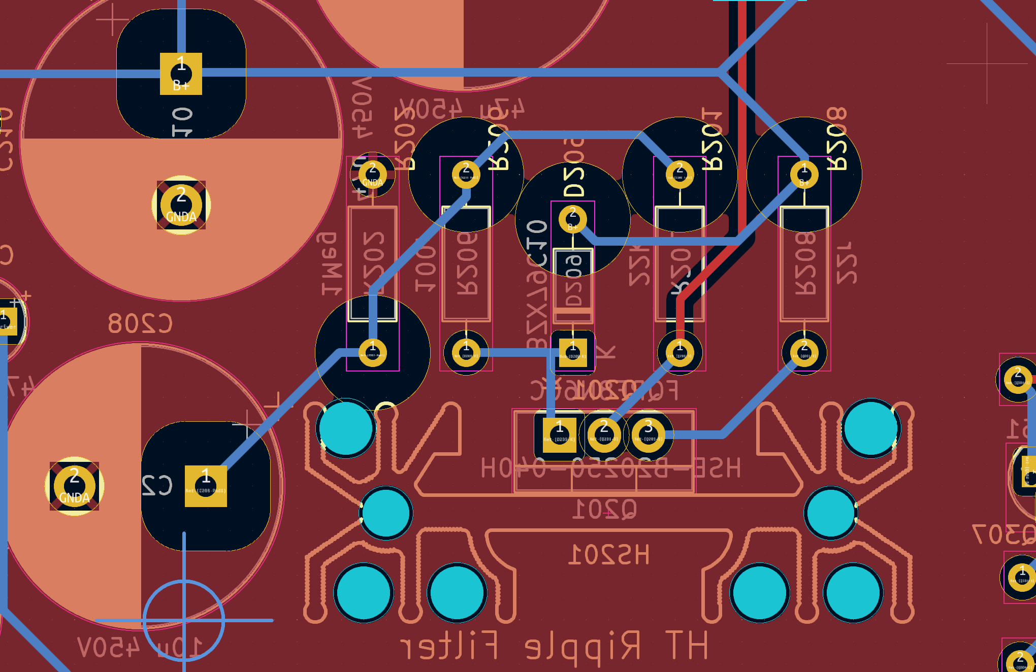

I'd go with just the 10R resistor (if you find the hum acceptable). I still don't think we should give up on the capacitor multiplier. If it's not a pain, perhaps take close-up images of both sides of the board in that region. And have a scan about for any charred areas or anything unusual. It's such a simple circuit and layout I can't see how anything could go wrong - unless there's a solder bridge or similar to cause current to flow to the level that would cause the failure...

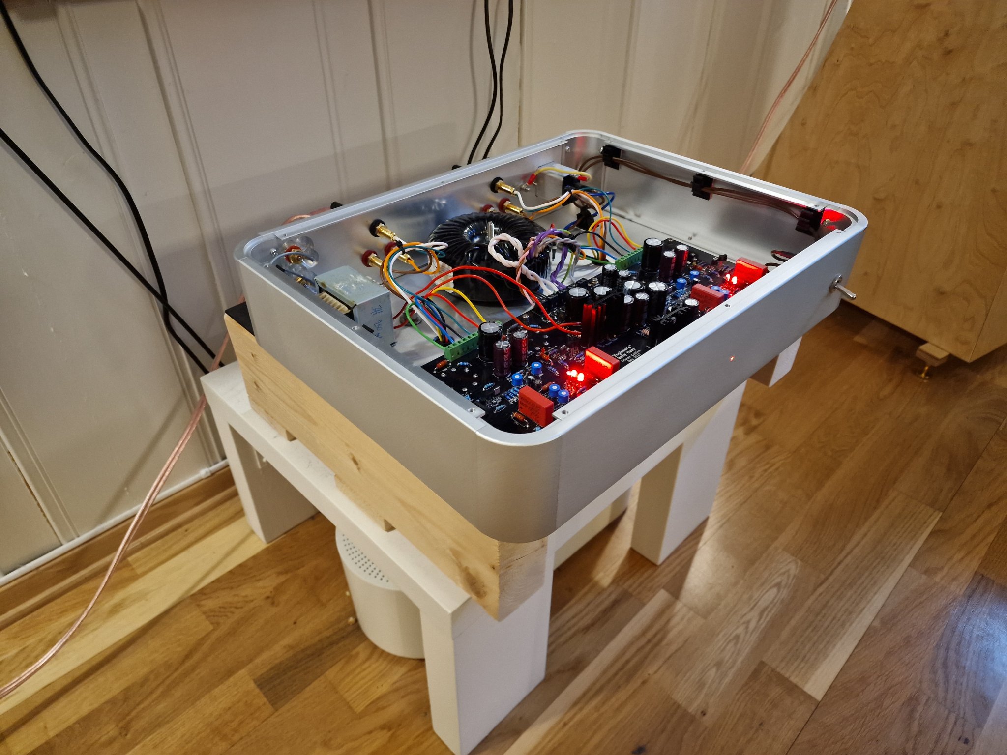

Since I had the amplifier sitting upside down in my Baby Huey maintenance cradle, I put in the choke instead of the 10R resistor just to test. Now there's no hum when turning on and also no hum with my ear close to the speaker.
Considering how well the choke works, I might install the choke permanently in the chassis, to keep it as an option if I can't figure out the transistor/diode failure problem.
I'll examine the PCB again very carefully to see if I can see anything amiss.

There is a little 100 Hz hum with the choke in place, but it's negligible.
The choke is now mounted in the chassis. There is luckily plenty of space in there. I'll leave it in there for a while. It seems to work quite well.
I couldn't see any signs of anything wrong in the relevant places on the board.

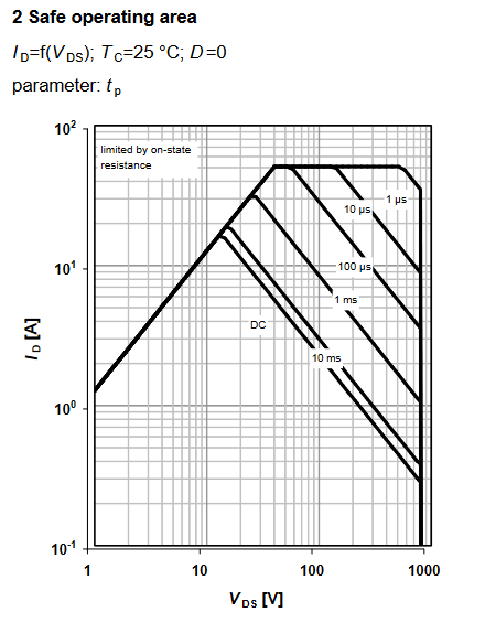

That mosfet, like many modern ones, do not show SOA for DC. I usually keep away from those, they can be a bit of a lottery.
ahh, yeah I see now… So perhaps Pete selected the original with a bit of trial and error. The alternative used here isn’t being used in its SOA, therefore self destructs.
Taking that logic, perhaps it would be worth trying one that does have a DC shown on the SOA. Perhaps this:

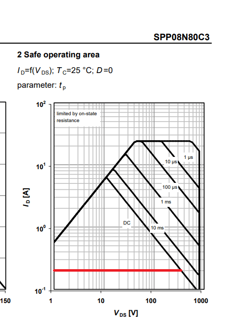

It may be even not enough. I had a similar situation a while ago with a soft start circuit. The mosfet kept blowing away, but the datasheet seemed to say that everything should be OK. The danger here is not only the current and voltage when the power supply it settled, but also the current spike at power up, while C210 is being charged. It means that the voltage across Q201 (referring to the original schematic) is high, and also the current, there is an area where both current and voltage are relatively high, creating a spike of power. It is difficult to simulate the exact conditions, because both the power transformer, the current limiting CL-140 all influence the timings. I would use a mosfet that has a lot of reserve.
Looking in mouser (or digikey/farnell/RS, those are very well respected suppliers):
https://www.mouser.co.uk/datasheet/2/196/Infineon_SPP08N80C3_DS_v02_91_en-1732195.pdf
That one seem to have a wide DC safe area, up to 200mA at ~350V drain-to-source. Should be OK, but with mosfets and high DC voltage, you never know :)
PS: I noticed the original schematic uses a 22K resistor for R201, but you use 47K. That increases the HV delay, but also increases the window where the mosfet is "suffering" the increased transient voltage across drain-source.
Remember isolating washers / thermal transfer pads if you go non-FP packaging. It would open up more possibilities - but potentially also open up thermal issues if the resistance increases between die and heat sink.
