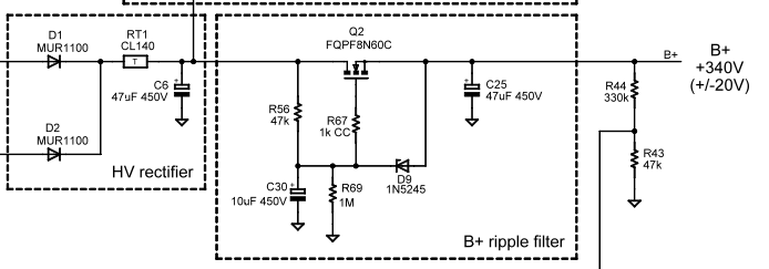

I am starting a build myself. What did you end up using for FQPF8N60C? Got it from ebay or used an equivalent?The BOM lists the transistor FQPF8N60C, which is discontinued. Is STF5N62K3 a suitable replacement?
And Mouser doesn't have FQPF7P20 in stock at the moment. What can I use instead?
I ended up using STF5N62K3 from Mouser. Seems to work OK. It does get quite hot, but I don't think it should be a problem.I am starting a build myself. What did you end up using for FQPF8N60C? Got it from ebay or used an equivalent?

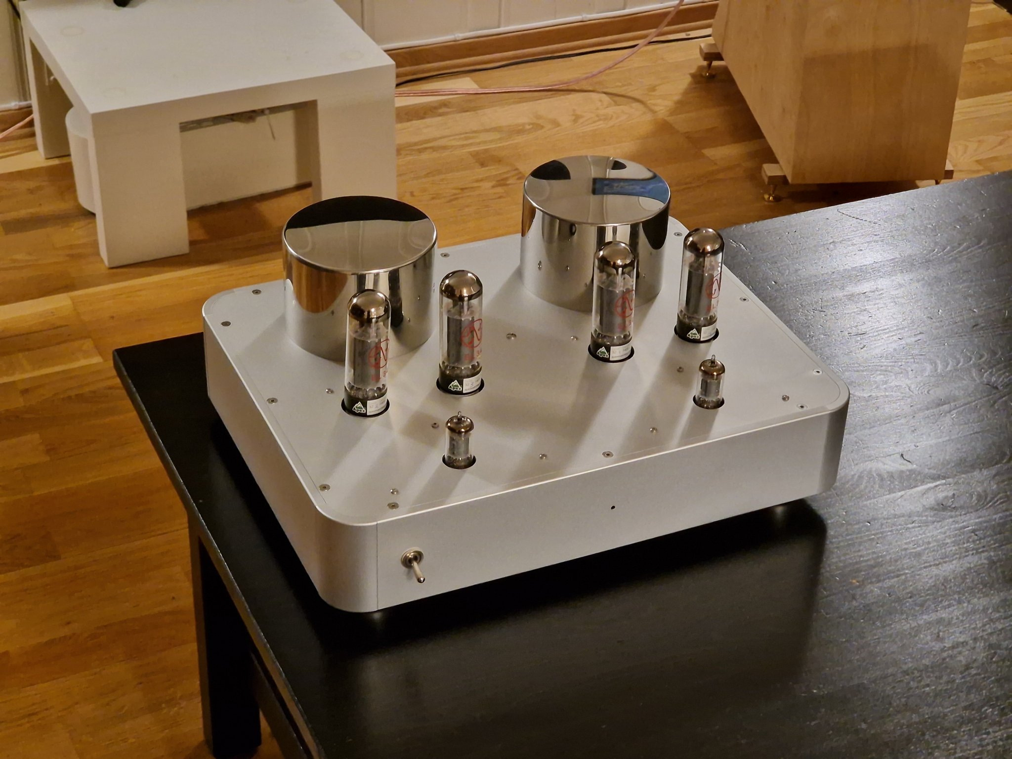

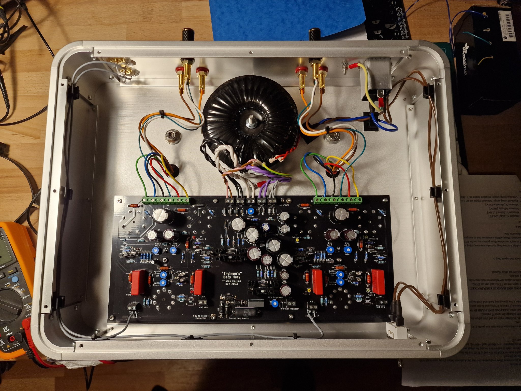

Very nice chassis, what did you use? Thank you for the answer about the obsolete MOSFET.Finished the chassis, connected everything and turned it on for the first time yesterday. No smoke and no fires! I followed tristanc's power up procedure and there was no problem adjusting the amplifier.
I have also built the previous incarnation of the EL34 Baby Huey. This version is in my opinion easier to build. Very convenient with only one PCB and there are a lot less wires to keep track of.
Connected the amplifier up today and have listened to some music. It sounds very good and smooth as expected, and it's very quiet. More quiet than my previous Baby Huey for some reason.
View attachment 1259035View attachment 1259036View attachment 1259037
Yes, it's very nice! Very high quality with 8 mm thick side panels. 3 mm top and bottom. Found it on Aliexpress. Shipping cost about as much as the chassis itself, but worth it I think. https://www.aliexpress.com/item/100....order_list.order_list_main.69.2c551802JzYgJTVery nice chassis, what did you use? Thank you for the answer about the obsolete MOSFET.
This is a great find, thank you for sharing. I got a quote from the Panel Express and for just the 4 panels the cost is around $500.

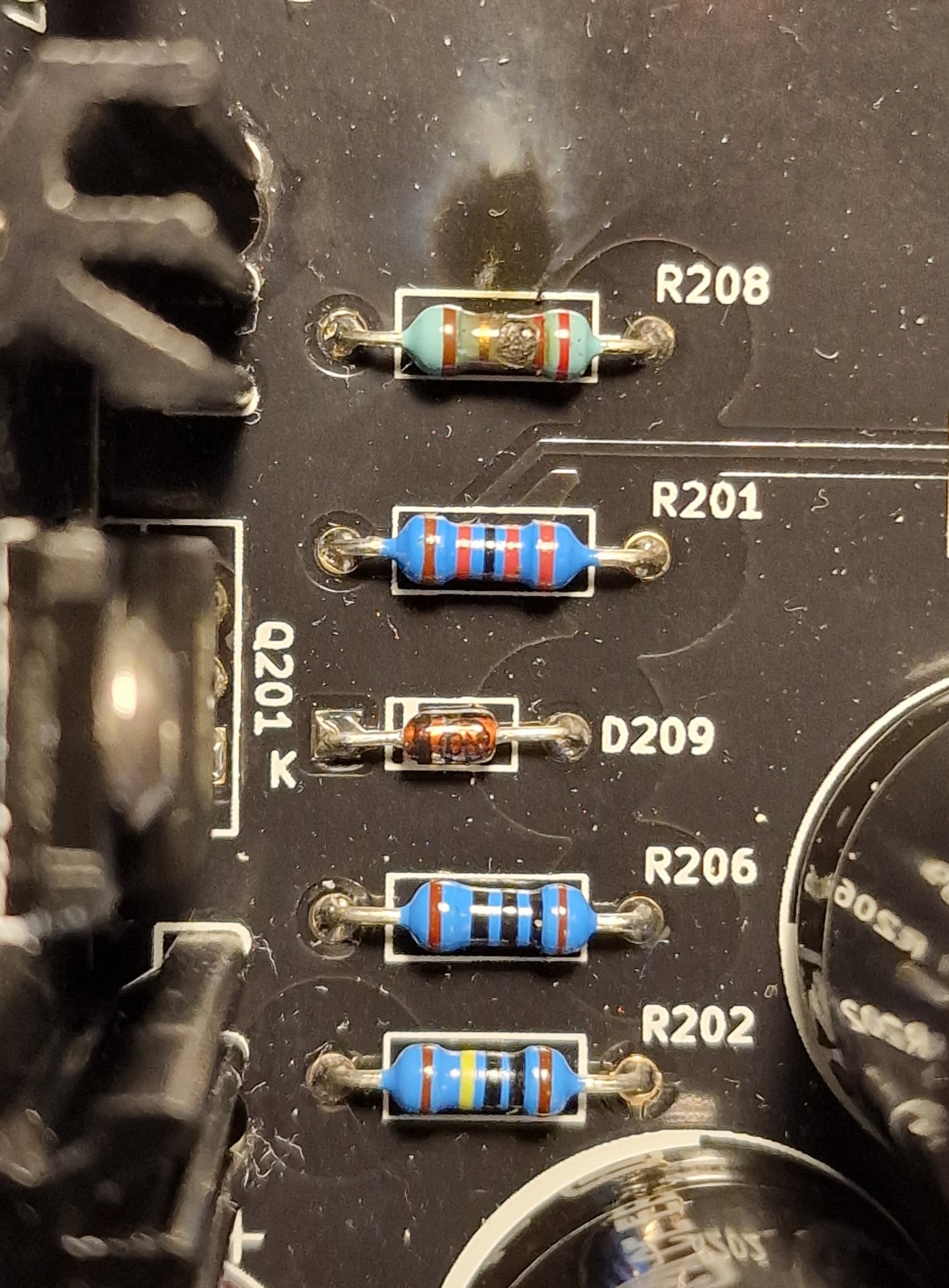

Something failed yesterday. I heard first a slight hum from the speakers and then a strange "click" sound. The amplifier is now silent. The resistor R208 is burnt. I suspect that the STF5N62K3 transistor has failed. I'll remove and test it after work today and also test the tubes. I'll report back.I ended up using STF5N62K3 from Mouser. Seems to work OK. It does get quite hot, but I don't think it should be a problem.
Eash. I'll try and check Merlin's power supply book tonight on why I chose a standard resistor there. Assuming 90mA per channel, P_diss >= 0.7W in R028 at idle. Yeah, pushing it... Perhaps I made a mistake and 2+W is needed.
You can always jumper it out. Pete didn't use one:
If it failed open the MOSFET may be fine? Perhaps the valves have settled and the bias needs adjusting - causing an increase in current etc.

Is it R208 or R028? Where is the schematic? Is it available outside GitHub?
@tristanc, Jumper out where? Pete didn’t use what? I don’t understand.
However, the acquiescent current may be 90 ma for the amps, but that does not include bleeder currrents in the power supply, and at full power the current will be more.
Is there a “GitHub Guide for Dummies” somewhere available so that I can learn how to use it. GitHub is unintuitive to me. How can one look at the schematic? I have marveled at @tristanc’s neat file organization before, but have not actually tried to open and look at the files
I'll check the condition of the transistor. It might be OK as you say. @Francois G: I've attached the schematic.
The MOSFET is dead (shorted), but I have spare of the same type. I could try installing that and jumper out R208. What do you think?
Yeah - jumper out R208 and replace the FET. From memory (and I'll try and check tonight) the function of that resistor was a current limiter (as I wrote on the schematic) and not a "fuse" but I'd also trust Pete in leaving the 'nice to have' out.
I hope this hasn't propagated further - I can't think anything else would be impacted. And I'll also, given safety as a priority, look to replace my R208 with a higher wattage part and maybe lifted off the board to allow air circulation.
Actually - surely the FET shouldn't have failed under any likely conditions it would experience. Perhaps check there wasn't any flux bridge or stray solder etc? I left as much clearance as I could around the pins and the keep-out areas were set for the voltages experienced. It's definitely encapsulated?
Just thinking through the failure mode. Resistor gets hot (but current should still be within FET spec?), resistance goes down, current should stay same as demand is still there, resistor burns through and fails open. Would the FET fail due to thermals? Sorry, just trying to work out what could have happened.
Yes, the question is what failed first. It seems unlikely that the resistor could cause the MOSFET to fail. I'll check the tubes first and examine the board as carefully as I can.
OK. My tube tester is inoperative at the moment because the computer that runs it is stuck in a Windows update ... But at least I tested the tubes for shorts. Couldn't find anything obvious on the PCB, like bits of solder and other things that could have caused a short.
Anyway, I put a jumper in place of the resistor R208 and installed a new MOSFET. Turned on and adjusted everything like before. I think possibly that the MOSFET doesn't get as hot this time. It's about 30–35 degrees C (measured with an IR thermometer). Didn't measure it the last time, but my impression is that it was much hotter. Playing music now, and another difference is that there is a bit more 100 Hz noise for some reason. Not noticeable from a listening position. Is it possible that the resistor had a function in suppressing this noise? I wonder if the MOSFET might have been faulty. Must be quite unusual?

I'm obviously no electronics expert, but I find the increased hum puzzling. The only difference now, unless something else has failed, is a jumper instead of a resistor in R208. I'll order a 2 W 22R resistor and see what happens when I solder it in.
