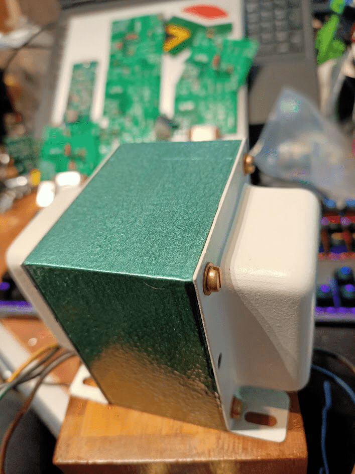

I love how you all put this in the public domain on Github. And your build looks great...Schocked by the prices by Schaeffer (loaded your topplate into the app). Only thing that baffles me is why you have not done some TLC on the output transformers...They look very much out of place with the attention to detail elsewhere in your amp.
Thanks Bas. Yes, tell me about it... And they've gone up since I last ordered. But it is lovely quality and Just Works. I tried the Hammond chassis + powder coating approach in the past and it was a disaster.I love how you all put this in the public domain on Github. And your build looks great...Schocked by the prices by Schaeffer (loaded your topplate into the app).
I see what you mean - to be honest I hadn't thought of doing anything, but I guess I could take the end bells off and prime + spray with a suitable finish. Maybe a project for over the summer.Only thing that baffles me is why you have not done some TLC on the output transformers...They look very much out of place with the attention to detail elsewhere in your amp.
Also the laminates itself are candidates for some work..... but anyway! Don't do it for me or anyone else 🙂 . It just struck me as odd.
Or just a polish. Less is more. I used to spraypaint top plates as well. I now just get a anodized aluminium top plate. Way less work. Better for the environment...and looks better as well...imo.but I guess I could take the end bells off and prime + spray with a suitable finish.
Here’s what Bas is talking about. Some day I will flatter him by blatant imitation 😃Also the laminates itself are candidates for some work..... but anyway! Don't do it for me or anyone else 🙂 . It just struck me as odd.

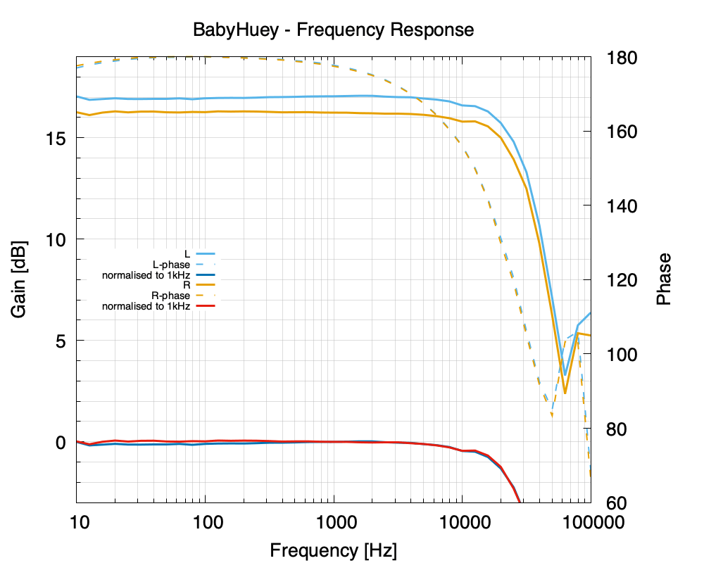

I managed to do some quick frequency sweeps.
Starting with 1kHz sine waves:
Left: 540mVpp (378mVrms) input gives 2.85Vrms in to 8ohms
Right: 560mVpp (392mVrms) input gives 2.8Vrms in to 8ohms
An FFT gave a THD of 2% (although I did that very quick so things might not have been set up right).
I then did a 10 Hz to 100 kHz sweep, 10 points per decade.
Suggests a -3dB point of ~30kHz (shown at the bottom of the plot, readings normalised to the reading taken at 1kHz)
I've clearly got a difference between channels, but when normalised the lines are pretty close. Phase is the same between channels.

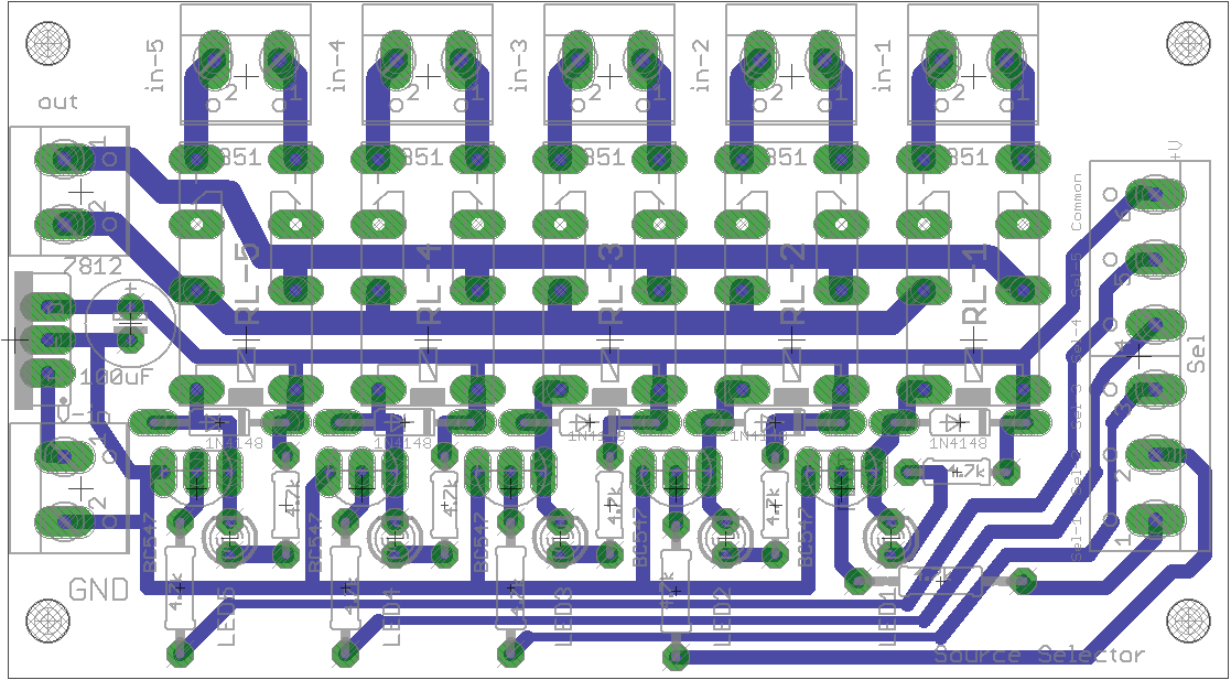

Thinking ahead, should I make a PCB for an input selector, like here https://www.diyaudio.com/community/threads/el34-baby-huey-amplifier.326920/
but how would I source 12V or maybe 5V for the relay switching, won't be using a micro controller just a 2 pole multiway switch.

Earl, feel free to use the eagle based src sel I made a long while back.
It has a 7812 regulator on board for the power to the 12V relays. You could user
a simple rotary switch to select the input. If you want, I can also post a CD4017 based control
circuit to cycle through the inputs via push button.

Thank you for the idea quadtech. I worry that I might not have space in the chassis build. However, I plan to make the top chassis of aluminium and the casing around of polished wood. So still bit of a concern as to how I get the RCA jack access to connectors from behind half inch of wood. Did you use panel mounted RCA sockets and connect these via short coax wires? Happy to see the CD based control circuit, now why did I not think of that?Earl, feel free to use the eagle based src sel I made a long while back.

If you mount the selector directly on the back of the case / wood casing, then it's an inch or two of connection
wire between the RCAs and the selector board - coax is great, but a twisted pair from an ethernet cable
works fine for me.

looks good so far, but if you decide to paint the transformer cores like Bas suggested, I would give the (in my opinion ugly) toroidal transformer a hood and paint it in the same color!
