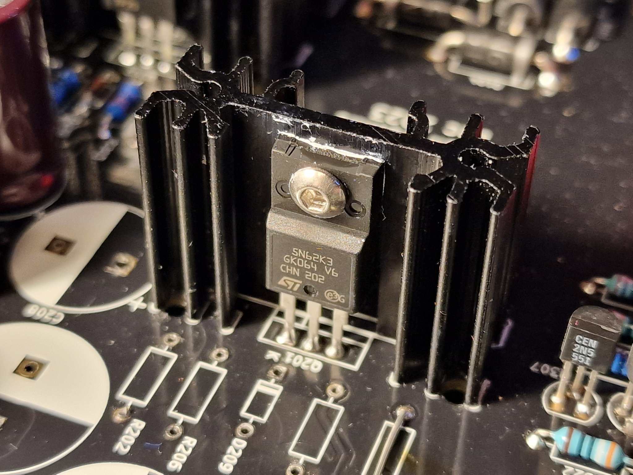

I also wonder if the MOSFET (STF5N62K3) is an appropriate replacement for the one in the schematic, which is obsolete and difficult to find. This transistor is the only difference from the BOM.
Yep - I did a very quick eyeball of the two datasheets and thought they looked pretty darn similar. We're not missing something obvious like the pins being in a different order? The original BH PCBs had something like that and people didn't notice the non-functioning filter. ie, the RCs were doing fine on their own.
Checked the datasheets and the pins are in the same order. That's something at least! Luckily I have a M2X to use while the patient is on the bench.
@tbaashus, how are you heatsinking the Mosfet?I ended up using STF5N62K3 from Mouser. Seems to work OK. It does get quite hot, but I don't think it should be a problem.
Like this:@tbaashus, how are you heatsinking the Mosfet?
It's the same heatsink as in the BOM.

It has been a while, but I think I went through the calculations for selecting a suitable heatsink.
I have been pondering the Safe Operating Area (SOA) of these Mosfets, which I believe are not primarily intended for DC, but rather pulse currents. What is the actual quiescent voltage drop over the Mosfet? Since @tristanc mentioned a 10Vdc over the Mosfet, here are my non-expert observations and thoughts.
The spec sheets (https://www.mouser.com/datasheet/2/389/std5n62k3-1850498.pdf) fig 5 shows a maximum of about 170 ma at a Vds drop of 10V, if I read it correctly. But it also states the current is for a single pulse, and interpolating from the increase in pulse duration shown on the graph, I doubt that 170 ma could be sustained as DC.
Comparing the SOA for STP11NK40ZFP it appears better than STF5N62K3 wrt this constraint, able to handle -700 ma at 10V drop (at the relevant pulse current), so it might be good at 200-300 ma DC.
The heatsink looks smaller than expected, but might be fine if calculated for adequate dissipation.
As failure mechanism, I’m not sure what failed first, the Mosfet or R208. At full power the current draw from the HV PS must >=220 ma, and that causes R208 to dissipate > 1 watt. It is interesting that R208 lasted as log as it did.
