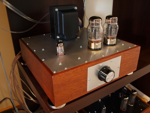

I have built three of this amp already.
One for me, and two for friends, and it is one of the best sounding amps that I ever built. I find triode strapped is better than UL.
I have plugged an Amperex 6dj8 on the 6n1p position, but I like the 6n1p sound better!
I am thinking of trying the 5670 for a driver, mu is very similar to 6n1p but I think it can have more current.
Any opinions?

I also tried a 6DJ8 and a Sylvania 6922. Both seemed to make the amp produce less bass. Overall the sound, even in the midrange didn't seem as good as with a 6N1P.
I don't have any experience with the 5670 but the current limit on a 6N1P is 25mA. Seems more than enough. I'm only running mine at about 8 or 9 mA.

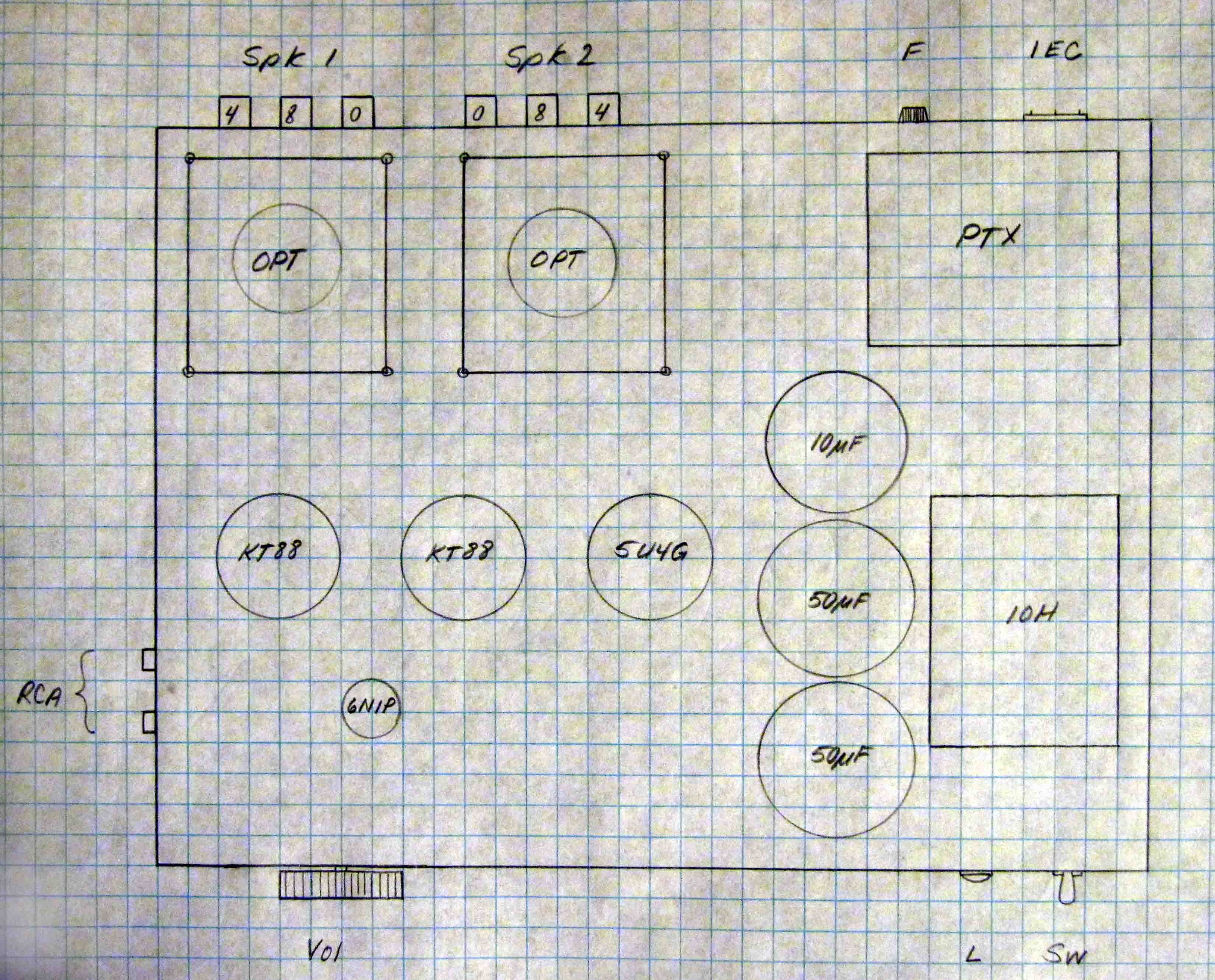

Before I cut the metal, I was wondering if the layout of the SE KT88 amp is OK?... To create symmetry with the tubes on the back row, there's a longer run of AC to supply the 5U4-G. Will this be a source of potential hum?...
Scale 1:2. Dimensions 12x16in, 0.125in T6061 aluminum top plate.
PTX and Choke: Hammond
OPT: James 6123HS
PSU caps: ASC 440VAC

I would try to get that rectifier tube farther away from your output/input tubes. Could you mount one or more of those big caps under the hood? It looks like you have a 12"x16" top plate. Is that right? The output tubes are fairly close together at 1" spacing between them.
What about moving your choke closer to the front of the chassis and shifting the caps between the PTX and the choke. Then move your rectifier tube closer to the choke. I like to get rectifier tubes as far away from the signal tubes as physically possible. I may be all wet here too though so hopefully some more experienced builders will chime in on your layout 🙂

I would space the KT88 sockets around 4" from each other, most KT88 data states that you need to space them arounmd 4", they generate a fair amount of heat.
Does he really need 4" space between the KT88's? I would think 2 1/2" would be pretty good spacing, but again I will defer to the more seasoned builders suggestions on the spacing issues.
Thank you Alexg, Curly, and mhouston! I thought, I could get by with the larger tubes in a nice straight line. I guess not. Here is another sketch, I placed the rectifier near the power supply corridor. I'll center the KT88s in front of the OPT, but space them about 2.5in apart. Is this better?...
BTW, what is the power output of this amp with B+ @ 410-420V?...
Oops. You forgot the sketch 🙂 On another note, I meant to say 2.5" between the envelopes pf the tubes, which is a little closer to 4" between the sockets, as Alex stated in his post. Sorry for the confusion!
