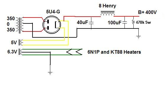

Re: PS bleed down resistor
I think that would be fine but I've found that the caps on mine discharge to zero volts in a few seconds without a bleeder. I think I would try it without the bleeder first and monitor the voltage when you turn it off. If it doesn't drop quickly by itself then put the resistor in.
Very nice work on the chassis by the way! I like the vent holes around the KT88's and 5U4-G. It takes patience to do that and have it look that professional!
porkchop61 said:Can I place a 470k 5w resistor across the last 100uF capacitor as a bleed-down resistor for safety?
Re: Re: PS bleed down resistor
Yes, that's good advice.
I'll see how it goes without the resistor to start.
Thanks for the compliment. It took a little while to hand drill all those holes, but better to do it now before I paint the chassis top.

Wiring diagram
OK, here's my wiring diagram for this amp.
I'm a little concerned about the heater wiring.
Can I get a critique from a few people as to the routing? Does it look ok as is, or do some things need to be re-routed?
Thanks in advance.
Glenn

Grounding question.
I have a ground point that includes my input jacks and the potentiometers. Then I have a ground point that includes the cathode resistors and bypass caps for all the tubes (2 kt88's and the single 6N1P).
I'm wondering if I should move the cathode resistors and bypass caps for the 6N1P from the ground thats for the KT88's, to the input jacks/pots ground? Does this make any difference?
I'm using a 1/8" aluminum top plate as the chassis, and I have 3 ground points on that chassis (power supply, tube cathode connections, and input grounds).
Maybe I should leave it as is and see how it sounds first?
Any suggestions would be appreciated.
Thanks.
Glenn

I connected the earth ground from my AC cord to the top plate. I kept my other ground points separate and not grounded to the top plate and then connected them all to the single chassis ground using heavy gauge solid copper with a separate run from each ground point. It seemed to work that way with no audible hum from the amps.
Sherman said:I connected the earth ground from my AC cord to the top plate. I kept my other ground points separate and not grounded to the top plate and then connected them all to the single chassis ground using heavy gauge solid copper with a separate run from each ground point. It seemed to work that way with no audible hum from the amps.
Yes, I've seen this done in other amps. A large copper buss wire used for grounding various stages. I myself have never used this method. I've always used localized ground points on the chassis for each section, and have never had a hum problem either.
I guess I'll keep working this way until I first get the amp running, then we'll see how it sounds and go from there.
I appreciate the information though, as I may wind-up using that method if the amp is too noisy.
