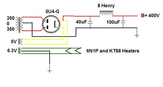

Here is the PS I use. It is very quiet and works well. I am getting about 425V on the B+ so there is sufficient voltage for an additional RC filter after the 100uF cap if desired.
My amps are set up as monoblocks but the only change needed for stereo is a beefy enough power transformer. My KT88s are biased at about 82mA and the 6N1P draws about 10mA (IIRC, its been a while since I measured it). So a power transformer capable of about 200mA would be OK.

would a 47uf cap suffice in the powersupply rather than a 40uf as i happen to have one lying around 🙂

matthew2456 said:would a 47uf cap suffice in the powersupply rather than a 40uf as i happen to have one lying around 🙂
47uF would probably be OK, most caps have quite a tolerance range. Just be careful if you are using tube rectification. I'm using 5U4G rectifiers and they are rated for a maximum of a 40uF cap in a cap input supply. When using cheap Chinese tubes I had some sparking internally. I replaced them with Sovteks which have been working fine for over a year.
If you see sparks inside your rectifier tubes change the first cap to something smaller.
My first cap is a 100uF, 10H choke, 47uF.
would it be worth remodeling the psu? Have a sovtek 5U4G.
