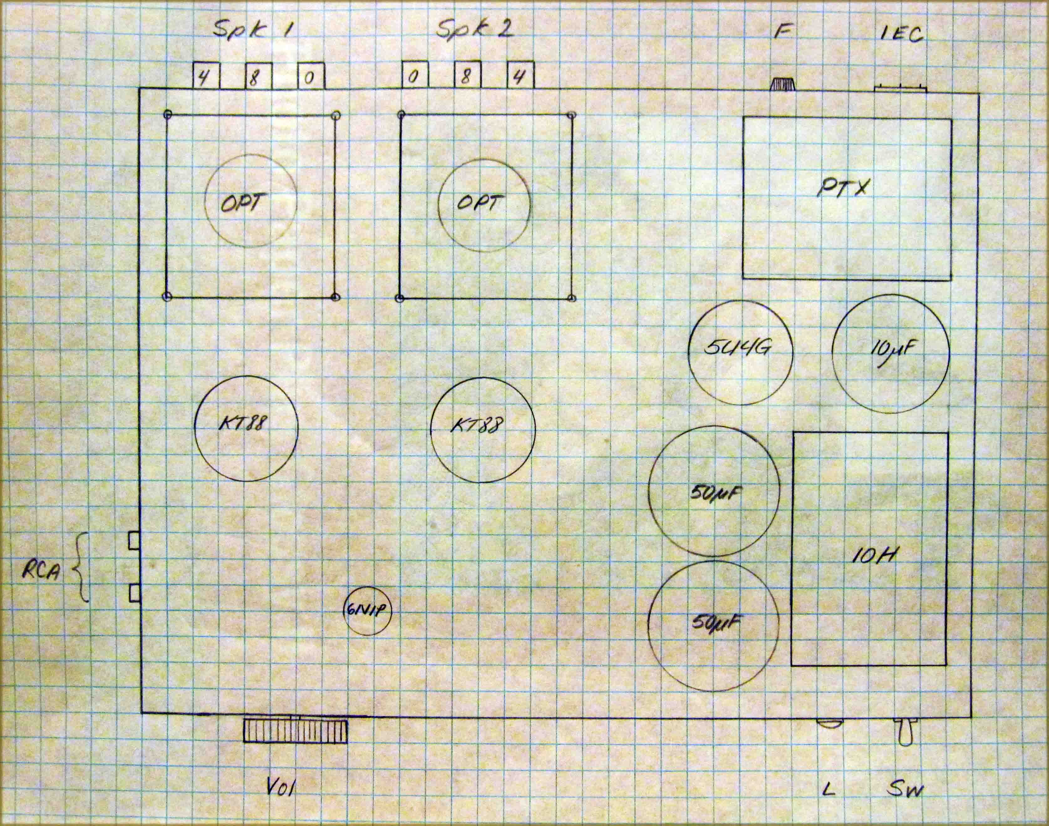

Oops. You forgot the sketch 🙂 On another note, I meant to say 2.5" between the envelopes pf the tubes, which is a little closer to 4" between the sockets, as Alex stated in his post. Sorry for the confusion!
Wouldn't get to tied down to feet and inches. Make a resonable layout and build it.

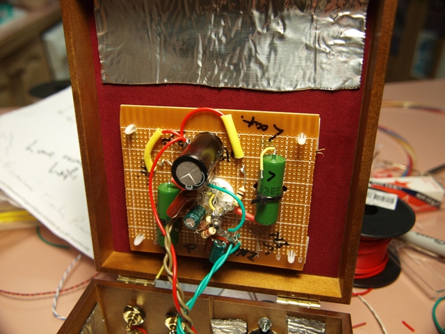

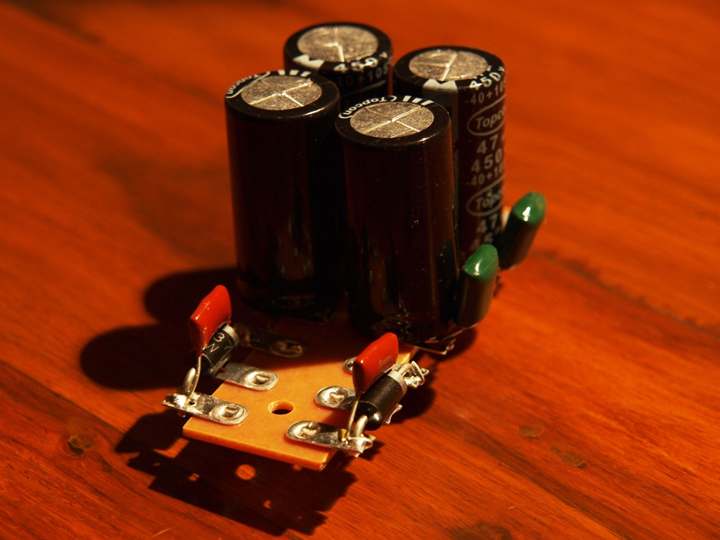

Has anyone ever used a cap-resistor-cap for power supply decoupling in the power supply of this amp?
I typically do this for all my guitar amplifiers. I usually use (2) 50uF 450V electrolytics, and a 10k 1 watt in between the caps.
If anyone has done this, what did you use for the resistor and capacitor values?
Thanks in advance.
Glenn
The best possible circuit for high voltage power supply filtering (if no semi-conductors are used or desired) is in this order: Tube Rectifier - Choke - Cap - Choke - Cap. The reason for this is the first choke actually will regulate the voltage significantly without a cap before it while the next best filtering method would follow by the Cap - Choke - Cap.
IIRC I used about a 15K resistor and a 22uF cap. I then adjusted the plate resistor on the 6N1P to around 33K.
Yes, I talked about to this R-C (15K-22uF) and R (33K) towards 6n1p, an this mod, obtain 8-9mA.

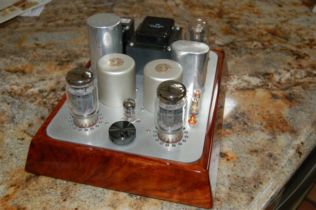

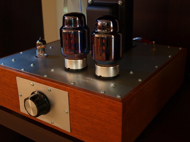

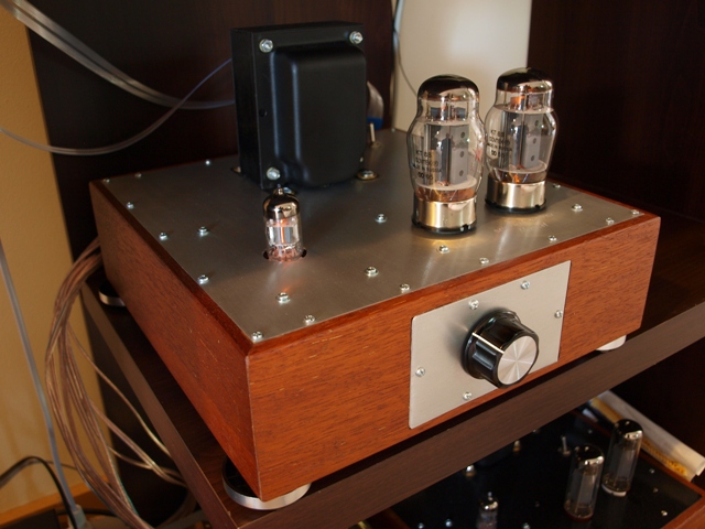

Someone asked if there were any other builders besides Sherman. This is my iteration. Sherman actually helped me a lot on this.
It is very nice sounding, won't drive anything big, but that's not my need.
Good luck with yours!
-cryo

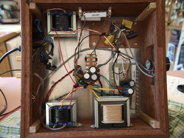

I really like the look of that amp cryo, there's a touch of class to it. The layout is well balanced (to my eyes, anyhow) and the sloped wooden sides are quite interesting. Did you machine the top panel yourself?
Any chance of a look at the underside?

Nice work! even like the pic, the granite's colores just add a nice look to it.
Thanks for the remarks. Yes, I machined the top myself. After driving myself crazy laying things out on aluminum plate, I got smart and lazy. Made CAD drawings exactly to scale of what I wanted and printed out on plain paper. Then I glued that to the plate and drilled/milled exactly to what was on the print-out. Much easier.
I have a pic of the underside somewhere. I will post it in a few days when I find it, or pop it up and take a new one.
I like the nice compact layout! I wish mine was a little smaller, and lighter🙂
Who's power transformer is that? I personally prefer the lay-down type transformers.

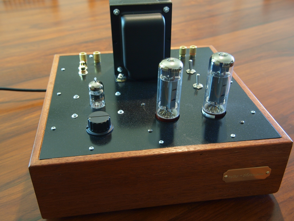

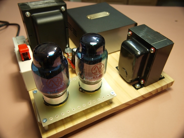

KT88 Bread Board amp with no driver stage.
I think this thread is still about SE KT88s and the like. I just built a SE amp which started with KT88 but found the Back Sable EL34s gave more power and and better frequency response. I wanted to bring back the Bread Board amp (BBAmp said Be Bamp) but wanted it to look more than a science experiment. To this end I used a highly sanded and multi-beeswaxed Australian pine board and hid the wiring. Also the ugly Edor open OPTs were canned which also provided a fixture for the RCAs and speaker binders.
In this build there is no driver stage. I hope there was enough drive from my two stage tube preamp but this failed. So after cathode current and HT+ was increased matched Black Sables EL34s replaced the JJ BLue Glass KT88s to acheive more gain. Also a high performance OPAMP preamp (Prada627) was placed between my upgraded Oppo 980H and tube pre to give sufficient gain and drive. The amp is exceptionly quiet. PS has 100uf cap-10H 200mA choke-100uf cap. The quietest amp I have ever built. No NFB of course.
Through my 91db efficient Osborn Eclipse three ways towers there is plenty of volume. The amp tested 17hz to 47Khz with a 5.6ohm resistive load (speakers are 6ohm). The sound is neutral, very transparent with exceptional blacks.

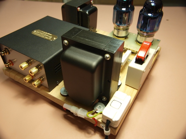

Here's a few of my latest SE UL/Triode KT88 offerings. I'm building under the retro-thermionic banner.

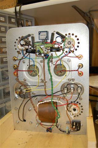

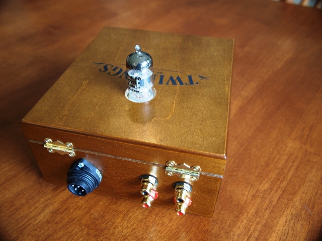

I think I have scared every one else away. Anyway I built a remote driver stage for my bread board SE UL KT88. It is the original stage Mikael used. Except in this case I upped the cathode by-pass caps to low ESR 220uf caps which are snubbed with 220nf polies. I used the Russian military caps (0.22uf) for the interstage caps added a 220 ohm grid block resistor and a 470K resistor from grid to ground.I don't use a volume control here.
I built the driver stage in a Tea Box which is lined with bitumanised Al foil. I used a 7 pin plug to carry the 400V and filament voltage. I can now build other driver stages and try them against the power stage.

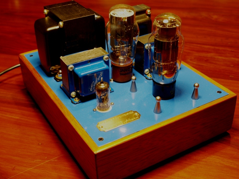

I would hate to see this thread go cold.This is my retro-thermionic Pinot "KiSharn" for which I am very proud. The best amp I have ever built. I don't think I have posted it on this site but if I have - forgive me. This is a two stage SE amp a true SET.
The amp is small and based on the 6AS7 tube for which now I have a lot of respect. The tube is also badged the 6080. The driver is a 40 year old Australian made AWA 12AX7 and the rec. tube a rare JAN CBXL-5R4GY brown base.
Once more the amp base is Mirbeu. I sprayed the top plate blue to match the Edcor OPTS. No input caps but the inter-stage caps are the same as used on my Twinnings Tea box preamp - Jensen pure copper, paper and oil.
There is two ferrite chokes on the power cord plus a complete power filter under the bonnett. The PS is tube rectified and choked. The power tube is a Svetlana "Winged C". Low ESR caps and a mix of carbon and metal oxide resistors are used.
Though only a 3W output this baby goes 12hz to 50khz on -3db points. Bass is weighty and deep and mids are detailed and heavily textured.
