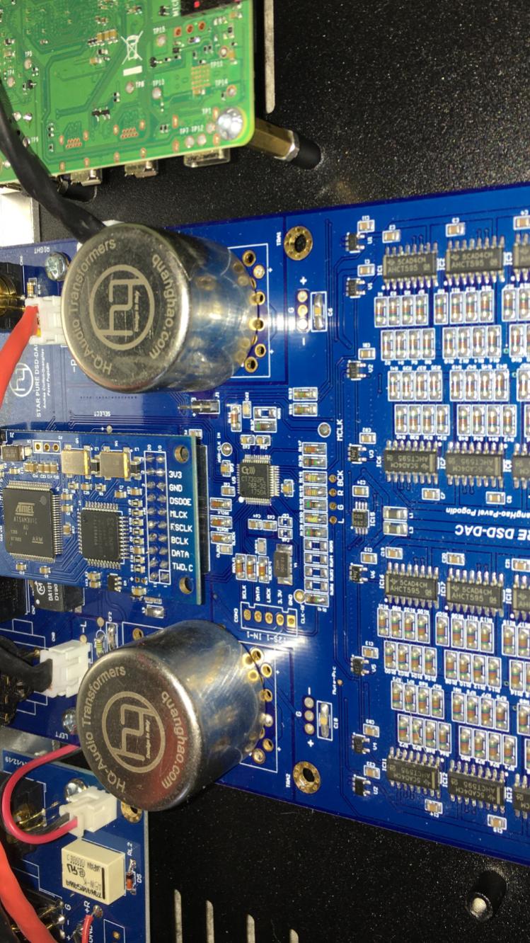

My STAR DAC does not allow to change output DSD rate. Display shows DSDx8 and I cannot setup other DSD output rate with CH+/- buttons of remote control in setting mode. In non setting mode the CH+/- buttons are working and switch input. Please advise.
BR,

The DAC uses transformers, do not know which type as the transformers are not visible due to shield can.
I have read somewhere in a forum that first Signalyst DSC1 included a transistor I/V output but the transformer output should sound better. A transformer is soundwise never 100 % transparent as you could also confirm by your experience. Would like to try transformer less version of the DAC. Anyone has a Signalyst DSD w/o transformer output and can share details?

There is no I/V stage on Soekris nor in Stardac, because those are voltage out dacs. Transfomer are used to galvanically isolate those dacs from preamp or amp and maybe as LPF.

Yes, the last firmware is lock to DSD 8x because there is no reason to set lower DSD mode

Output level is 1.5Vrms at 0dB and output impedance about 600ohm

It is not possible use the Star DAC without the output transfomers because it have a differential output stage and it is necessary an I/V like show in the DSC1 schematic.
I think is better a good output transformers than an opamp but thi si my opinion.
In the case of Soekris probably is better use no transformers on output but this is an R2R DAC very different from DSC DAC.
We have selected these output transformers after many test also comparing them with high cost transformers such as those mentioned by you.

I have a DSC2, using Pavel's V2.5.2 boards, with Lundahl LL1684 transformers and it sounds amazingly good; very organic, natural sound with no sense of a "...metallic, technical sound'. Of course, YMMV.
I agree completely with you. I also have the DSC2, but with Chinese transformers. Very organic analog sound without harshness.I have a DSC2, using Pavel's V2.5.2 boards, with Lundahl LL1684 transformers and it sounds amazingly good; very organic, natural sound with no sense of a "...metallic, technical sound'. Of course, YMMV.
