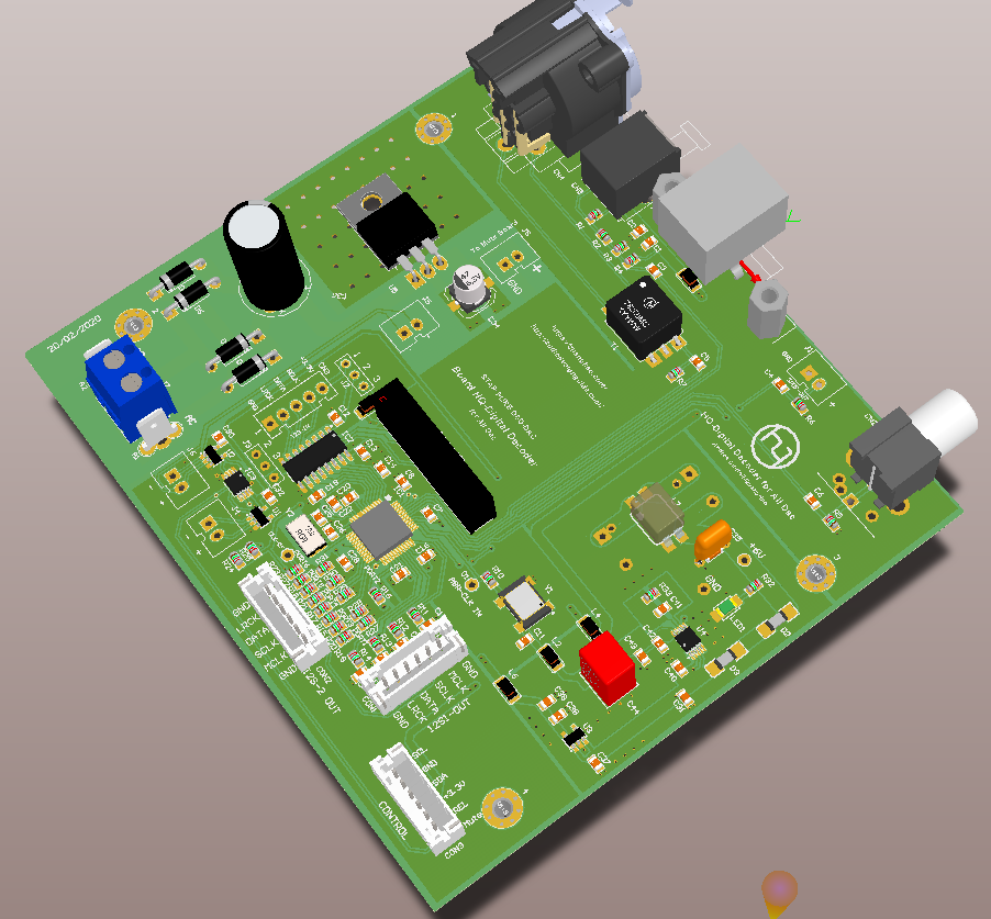

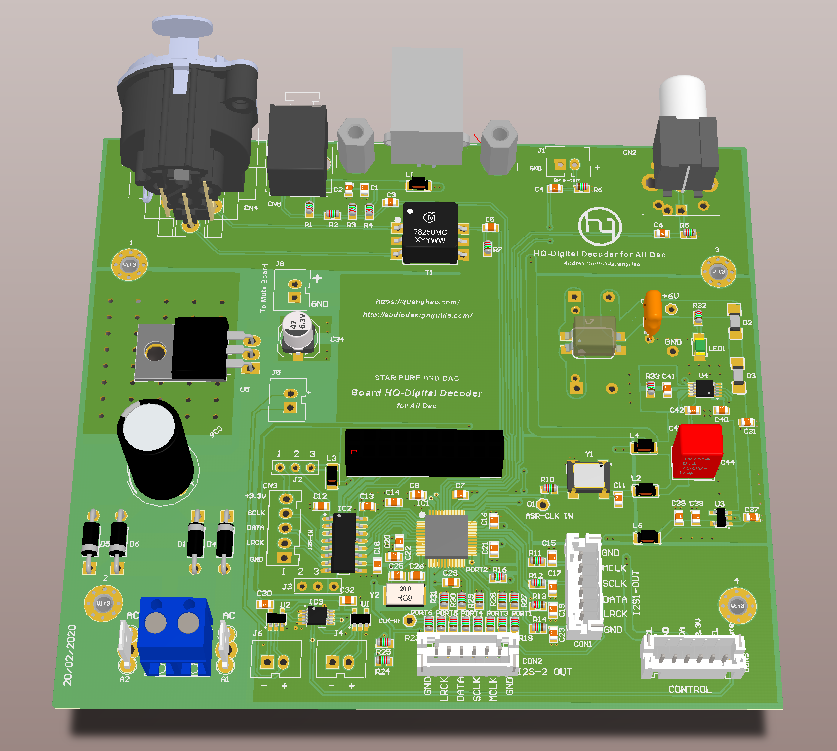

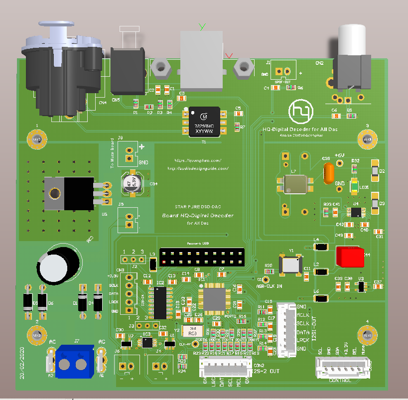

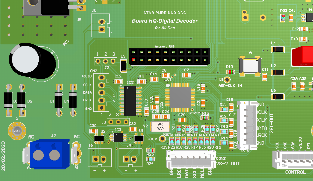

This PCB model has inputs
1-i2s
2-USB - amnero
3.AES
4-Torxl
5- RCA
Output: 2 x I2s
Chip: CT7302
Remote control!
Invite you to see the PCB picture, thanks a lot!
Quanghao

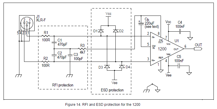

The DAC is connected balanced to a Neurochrome Parallel-86 amplifier. The Parallel-86 amplifier uses a THAT-1200 Differential input stage having an impedance of (from THAT-1200 datasheet):
Input Impedance ZIN-DIFF Differential: 48.0 kΩ
ZIN-CM Common mode with bootstrap: 60 Hz 10.0 MΩ
ZIN-CM Common mode with bootstrap: 20 kHz 3.2 MΩ
Power Bandwith of Parallel-86 Amp: 77 kHz
Are there any modifications on STAR DAC output transformer resistors required to drive above load with less possible distortion or can you suggest a transformer less output stage?
The output of CT7302 is set to 8 x DSD. Is this rate fix?

First we have to clarify if the problem you describe is a sound timbre or a real distortion.
The load of That1200 is not a problem because the ideal output load for this DSC DAC is 10Kohm or more.
Have you tried to change the interconnect cable ?
Have you set the amplification to 0dB or +6dB DSD ONLY in setup menu ?
To avoid any doubt about the distortion you could do a simple measurement with a pc sound card with line input and Arta software.
I can help you to make this test.
No, I did not try other interconnect cable yet. Its a Supra cable I have been using for years.
Amplification is not active, I am using the attenuator function of STAR DAC which I guess could cause the sound quality degeneration. Will use an passive attenuator and do some measurements next days.
