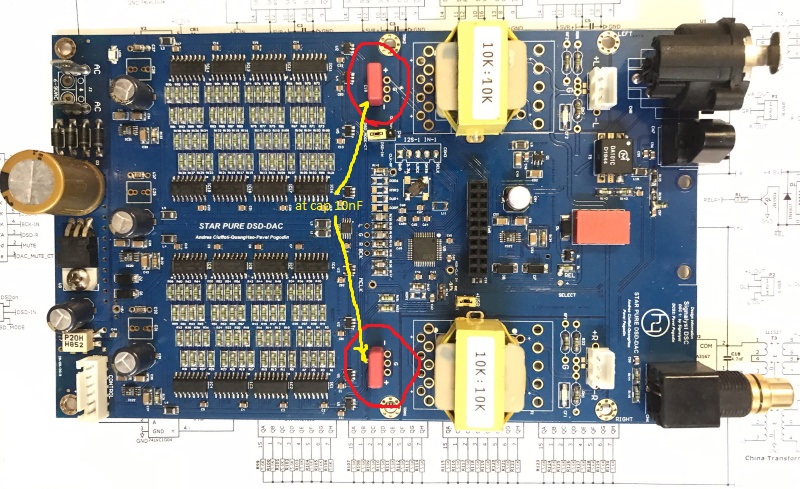

The DAC uses transformers, do not know which type as the transformers are not visible due to shield can.
I have read somewhere in a forum that first Signalyst DSC1 included a transistor I/V output but the transformer output should sound better. A transformer is soundwise never 100 % transparent as you could also confirm by your experience. Would like to try transformer less version of the DAC. Anyone has a Signalyst DSD w/o transformer output and can share details?
Hi!
I use this Transformer on board. ( the sample image under)
2- if you need the sound thick and more the sample AD1865 sound,
you can use 2 cap 10nF to 15nf to Board (see image)
thanks
quanghao

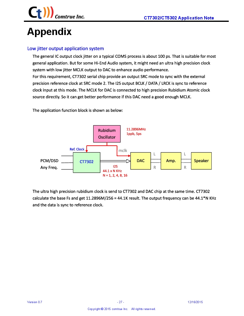

On StarDAC PCB the port 38 (ASRC_REF_CLK_IN) of CT7302 is connected to empty large solder pad. I guess the current firmware does not support external clock reference. Are there plans to support precision external clock with later firmware versions?
Yes it is possible add an external clock but after many tests I have not found benefits in using another external oscillator.
I have published some measurements.
Why do you think the manufacturer of CT7302 recommends an external reference clock when high quality reproduction is desired (as shown below from their documentation)?
Maybe they don't know what they are doing? Or maybe jitter performance was not among the measurements performed for this DAC design? As you can see I am a bit confused about the apparent contradiction 😕
This is a common application where we have a normal DAC with MCLK input so in this case a unique master clock is better.
In our case we need to remember that the DSC does not use MCLK.
