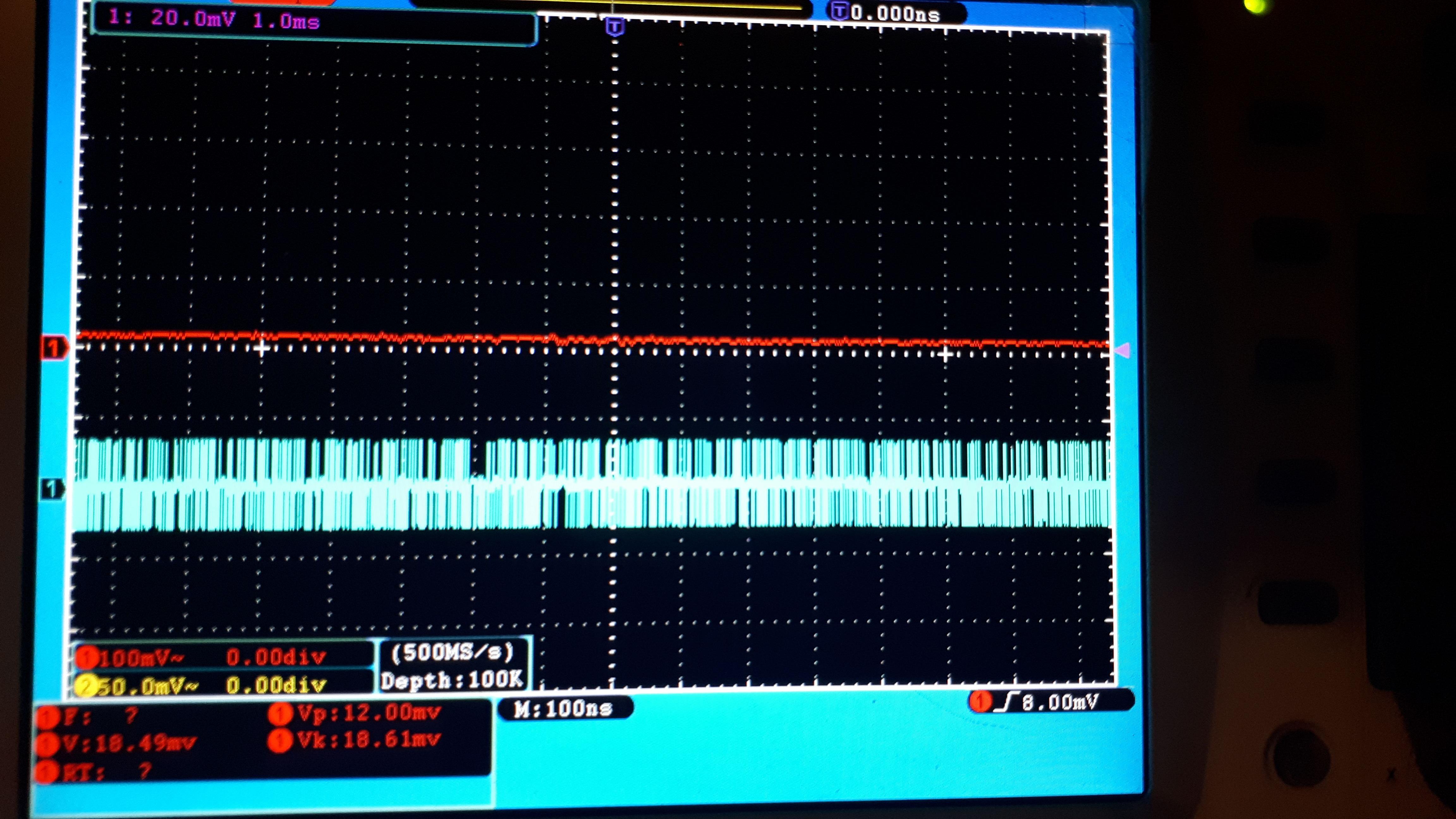

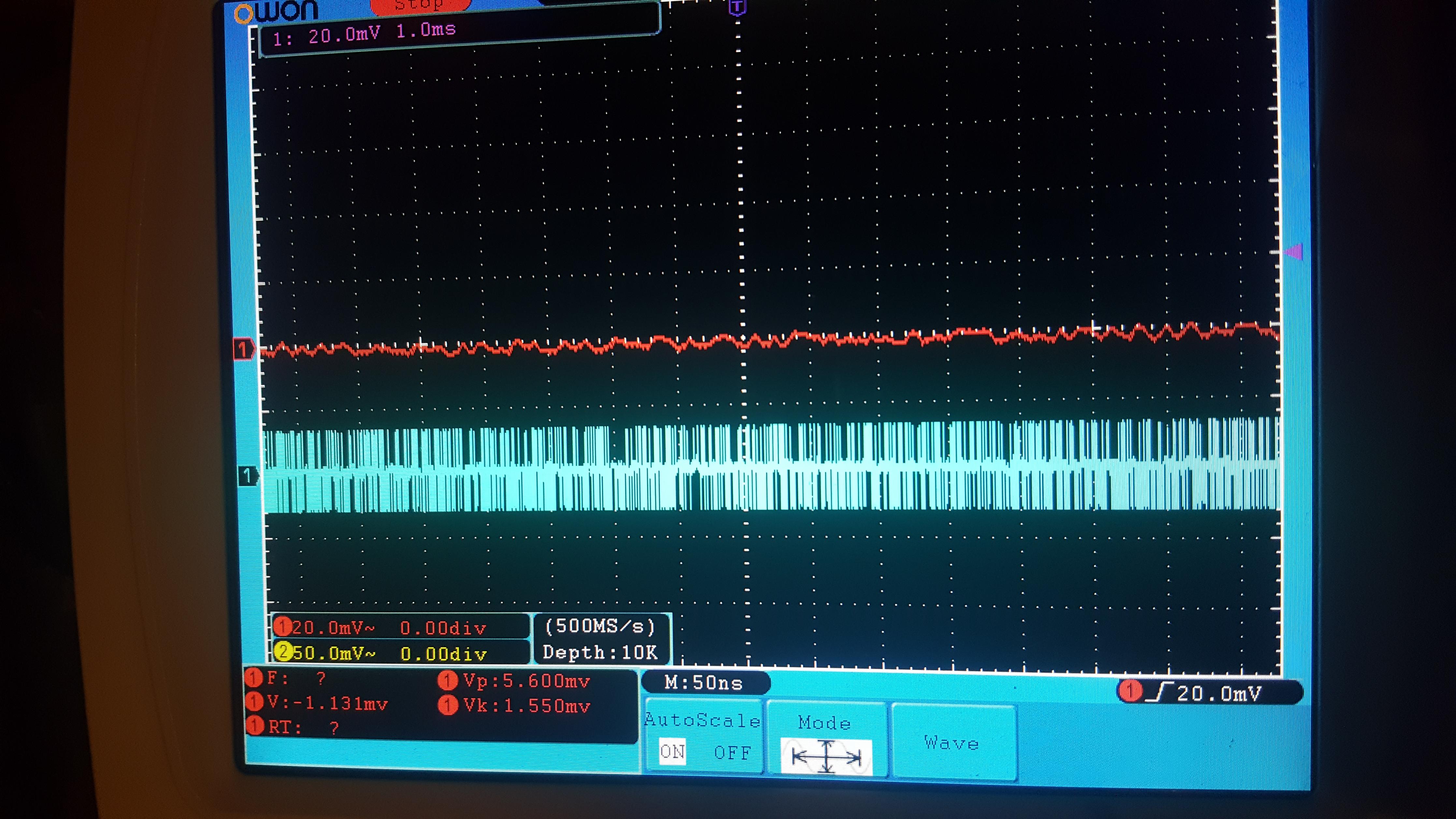

I had burnt the mosfet and now using 2x irf 9540. The result is not very good. The sound shrunk and the vp to p increased to 20mv from 2 to 3mv. Waiting for the fairchild from ebay. I cannot imagine.. Such a vast effect

The 9540 has much input capacitance so its normal for the open loop response to close in. Parts from ebay... Good luck. Are you located in Europe? If those parts will prove suspicious see in Element14 (Farnell UK).

I added a capacitor 220uf and up at the receiving end near the heater and that took care of the final ripple 2hifh is around 200mv. Below that value start to oscillate like mad 600 mv VP. Yikes. Finally settle on 1000uf. Cheapo cap. Like the sound best.
Up the reservoir cap to 10000 uf that further reduced some ripple. Just a standard smh. Since I'm going for 900 ma.
4 wire run around 30cm is better for my case. 2 wire I got those huge sine wave curve in the oscilloscope.
Didn't use pio. Too much ripple for long cable run since wire is longer . But instead use 220uf silmic in the middle and kept the rest , helps to roll off and thickened the sound some to get it more tubey sound.
Using 2x 9530 again. Waiting for fairchild. 2x 9540 did not work, unstable wave and ripple . Sound awful as well. Hope 9530 holds well and dont overheat again before the fairchild FQP3P20 arrives.
Very very huge different when the ripple is tamed. Flat sounding became huge, rounded, bodied. Bass became bottomless without being out of control. back in black when properly implemented will not sound sterile, yet musical. It could sound sterile detailed and compressed when it's not done right.
