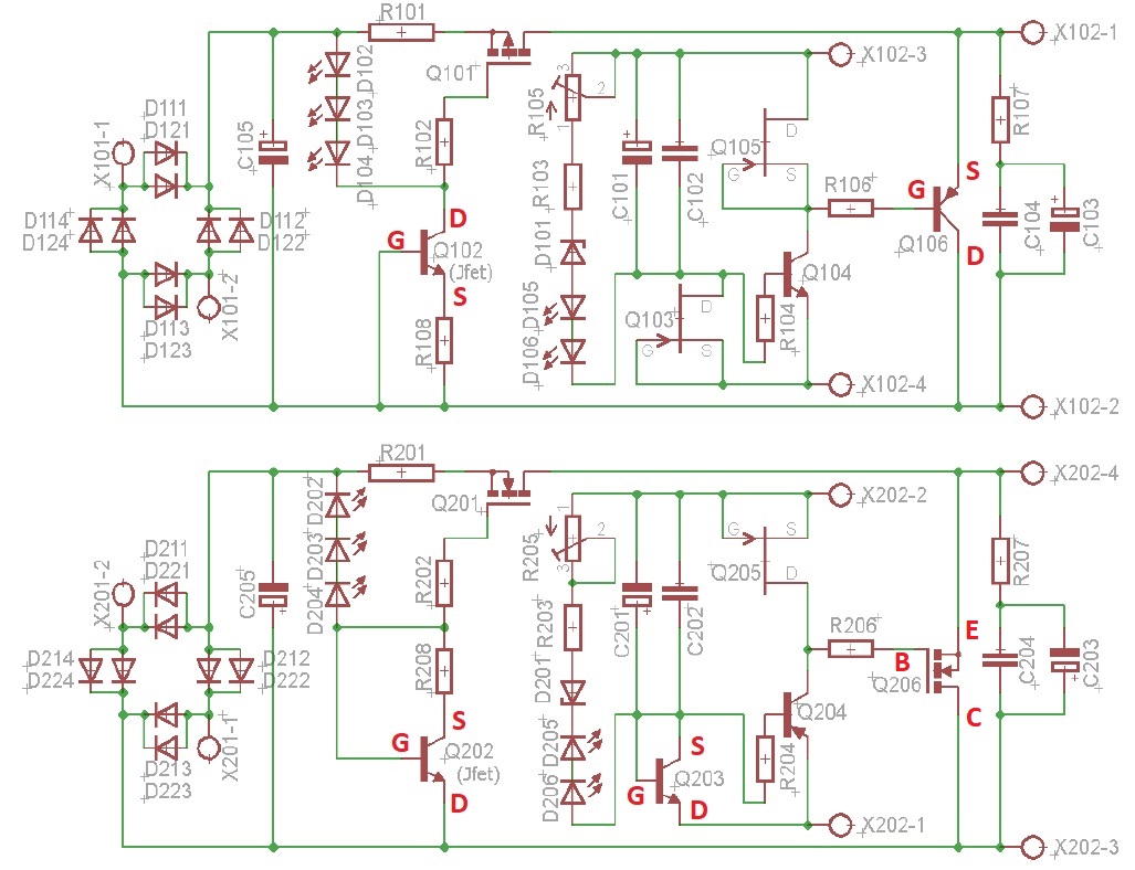

I have few quesions:
1. May I use K880GR in SSLV1.1 ? because difficult to get real K117GR now.
2. If I use K880GR, the other components value (resistors, capacitors) will remain unchanged?
3. I need +/-5V output voltage, BJT or MOSFET should I use for Q106 and Q206 ?
4. I just wanted to verify the GDS and BCE pin of Q102,Q106,Q202,Q203 and Q206. I mark the pin in the attached circuit, is that correct?

Are Q101 and Q106 both Pchannel mosFETs?Merry Christmas!

Are Q201 and Q206 both Nchannel mosFETs?
I don't understand why this sch is still using the wrong device symbols, when the correct ones are shown in some locations !

1. Yes
2. Yes
3. Either
4. Yes. (Such JFETs are behaving symmetrically for D,S anyway)
