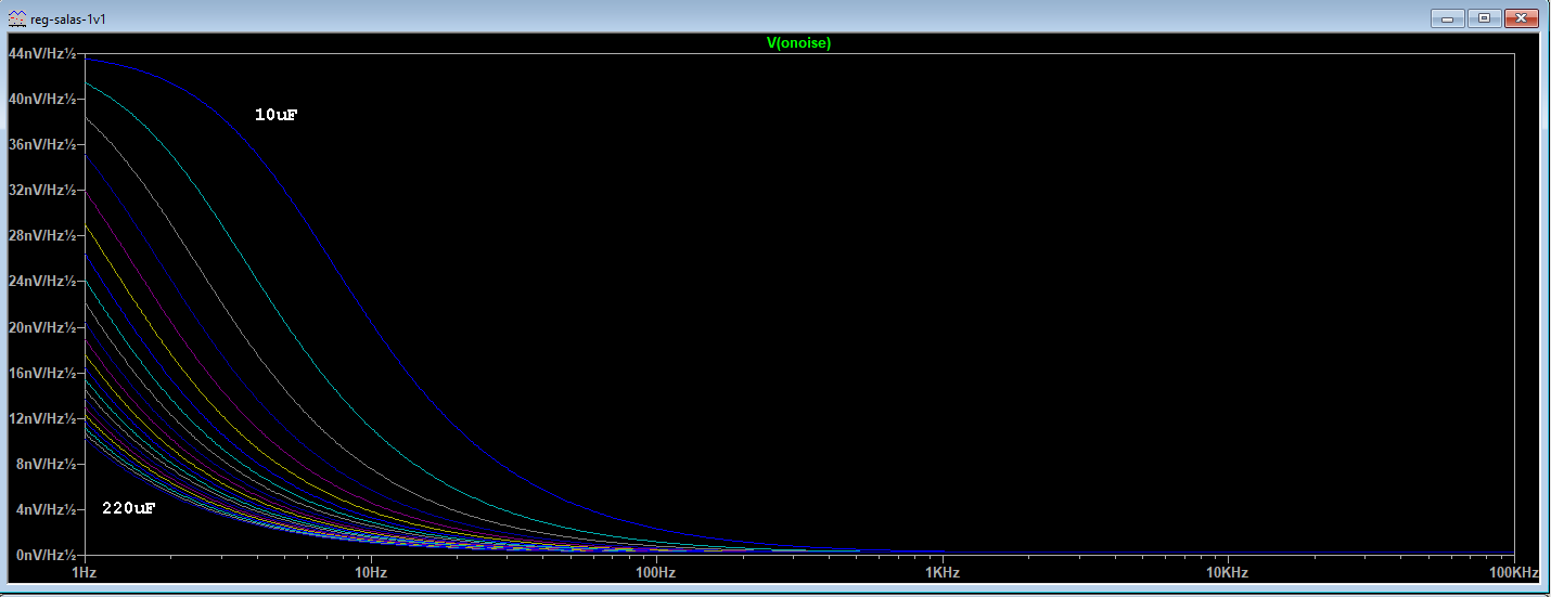

It will go faster if its not due to some other reason also, like Q103 JFET warming up by radiated heat increasing settle to IDSS. The MKP will not filter the voltage reference noise as good due to much less uF but it has better faster dielectric and a power amp's driver stage has very high signal level in comparison to residual rail noise.
So to go for this PSU's best noise result isn't critical. If it was for an MC phono preamp that the gain is very high and even more in the bass due to RIAA's shape, while the signal is very low, I would have recommended you kept the electrolytic.
Here is C101's value effect on noise. 10uF to 220uF in 10uF steps. The effect is most noticeable in lower frequencies.

I understand correctly that if you use high voltages (+ + 35V in my case), I would best use an electrolytic capacitor of 220 mkF instead of 10mkF / MKP? Or does this only apply to the phono preamplifier? I use SSLV for a pre-driver and VAS at a class A amplifier (100W). Thanks a lot for all the detailed answers and I apologize if I asked so many questions.
Higher or lower voltages isn't the matter. Sensitivity of an application to best noise from the reg or tolerance to lesser noise spec is the matter.
There is a voltage reference in the regulator circuit. Its the simplest passive there is. Its called Norton type. Its current dictated by Q103 JFET is converted to voltage by the resistance and Vf of the other components in series above Q103. Its a unity gain Vref i.e. its not a small steady voltage multiplied by a local amplifier but it creates the full Vout without its self noise being multiplied also. So its inherently lower noise in comparison to other solutions, like those active ones that have to multiply an internal low voltage Zener many times so to reach 35V.
This Vref must still be filtered to lower its impedance and its noise further. There is a gamut of capacitance you may use that progressively filters it deeper as demonstrated in the graph I posted.

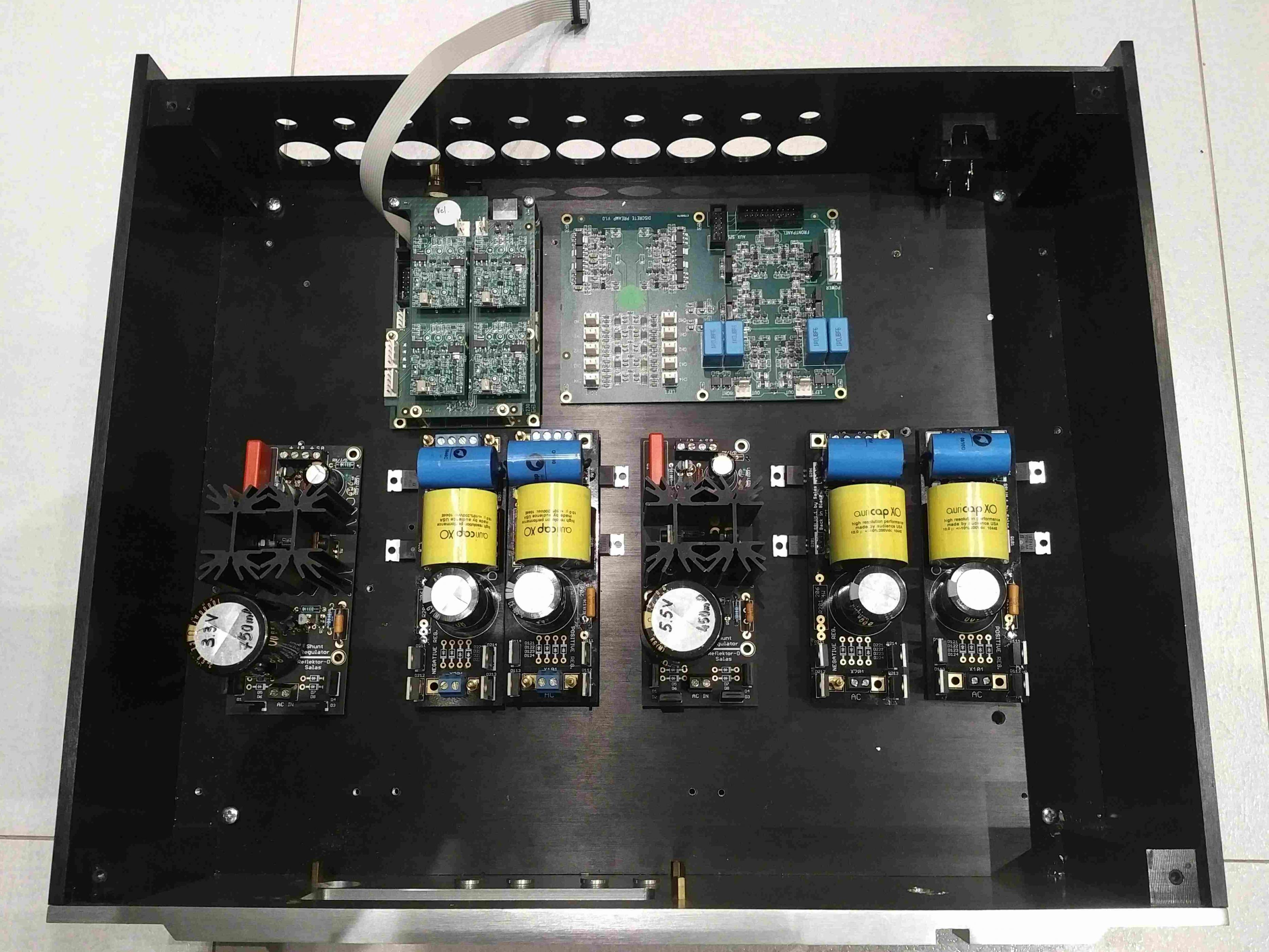

Nice. I see REF-D shunts also. Is that Sonny's 4490 DAC & dif pre? I have seen such master regs mix in some Soekris builds by members here also with very good subjective feedback.
Yes, it's Sonny's 4490 DAC + preamp, which is very-very good 🙂
With him I want to use a Renderer (NMR media renderer interface - electronic, engineering and consulting , which will use a Reflektor-D (3.3V).
Another D-Reflector-D has DAC (5.5V)
An SSLV for I / V (- | + 15V)
An SSLV for the preamp (- \ + 15V)
