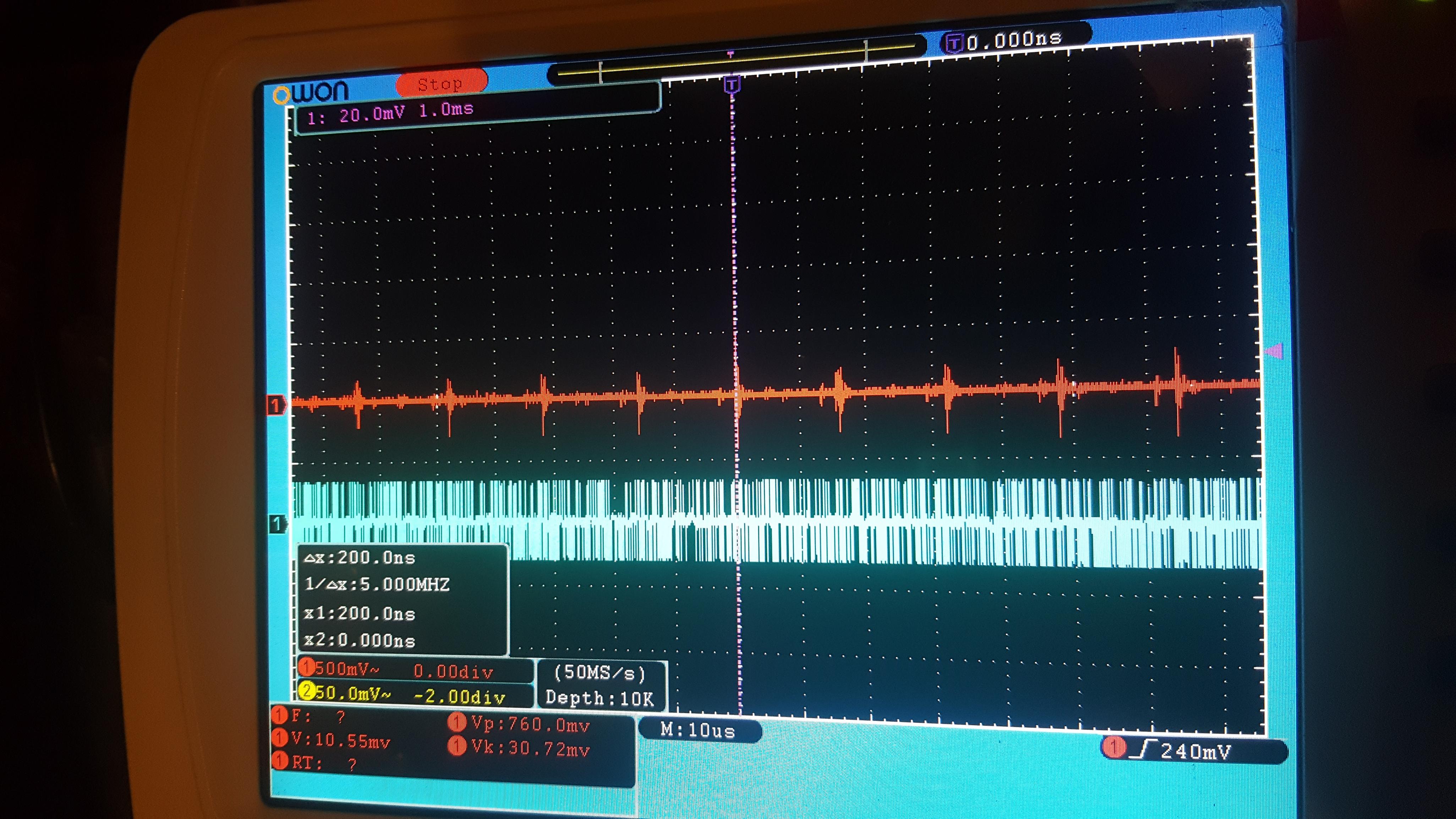

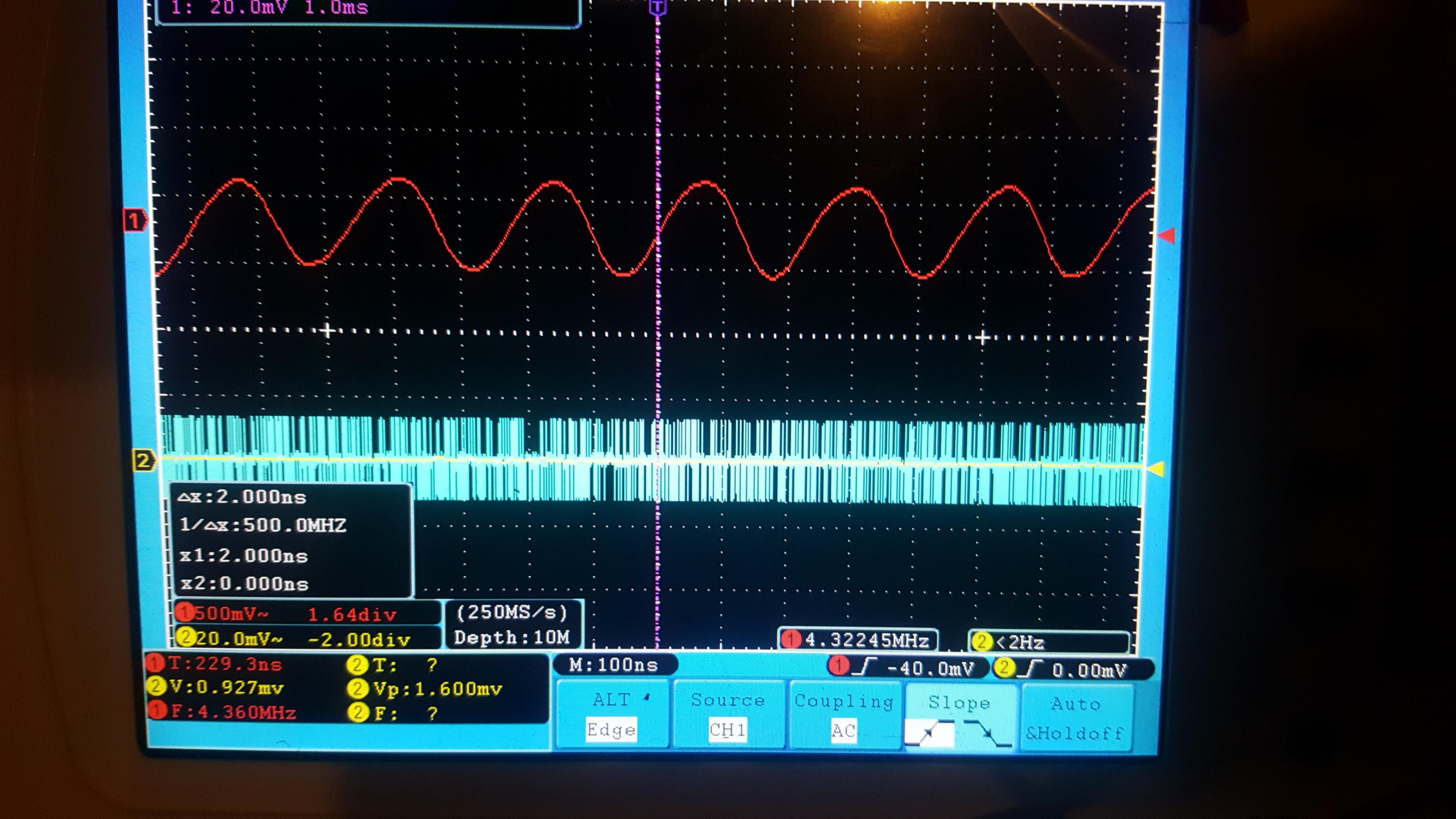

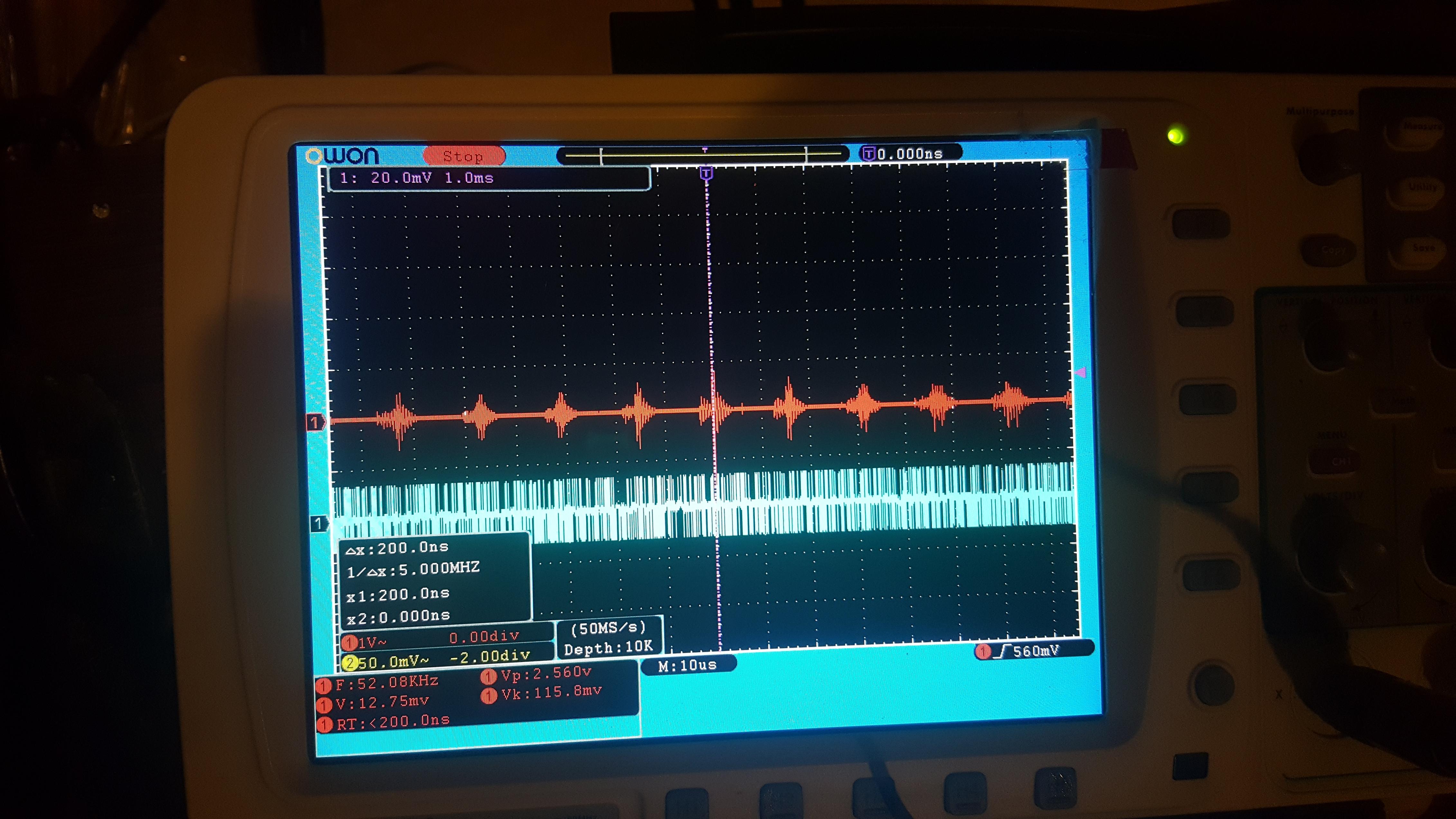

To me red looks like the signal right after the rectifier and the lytics (with a resistor or a choke between the caps) and the blue one looks like an output of a SMPS... but that is just my opinion 😎
Is the red trace showing the SMPS and the blue trace the final output?
Red channel 1 ac coupling trigger in
Yellow channel 2 ac coupling trigger out
Both measured output of the salas.
Twist your sense cables to the tube's heater and use short spring wire for probe's ground. Scan at 50uS.

Wound the probe as per instructionTwist your sense cables to the tube's heater and use short spring wire for probe's ground. Scan at 50uS.
OK this thing is auto, hope I got what you want
Ac coupling. Measured at the pcb input point of Heater supply.
