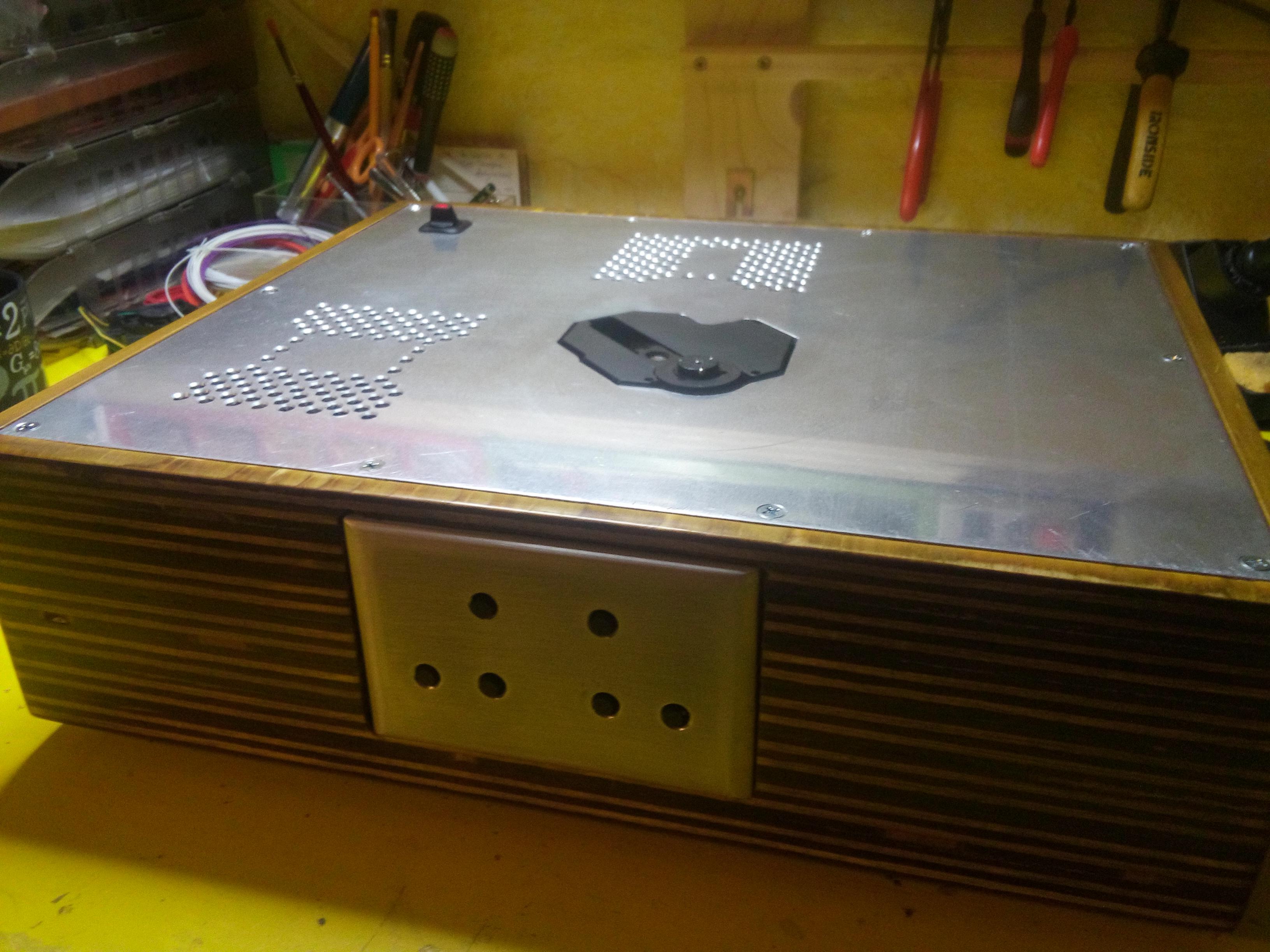

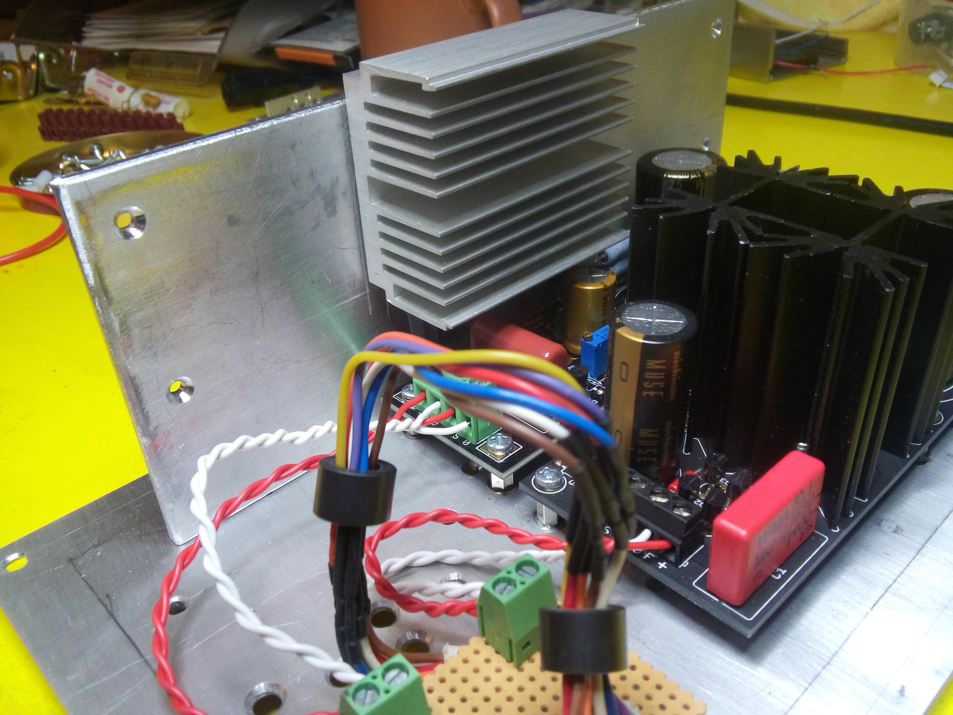

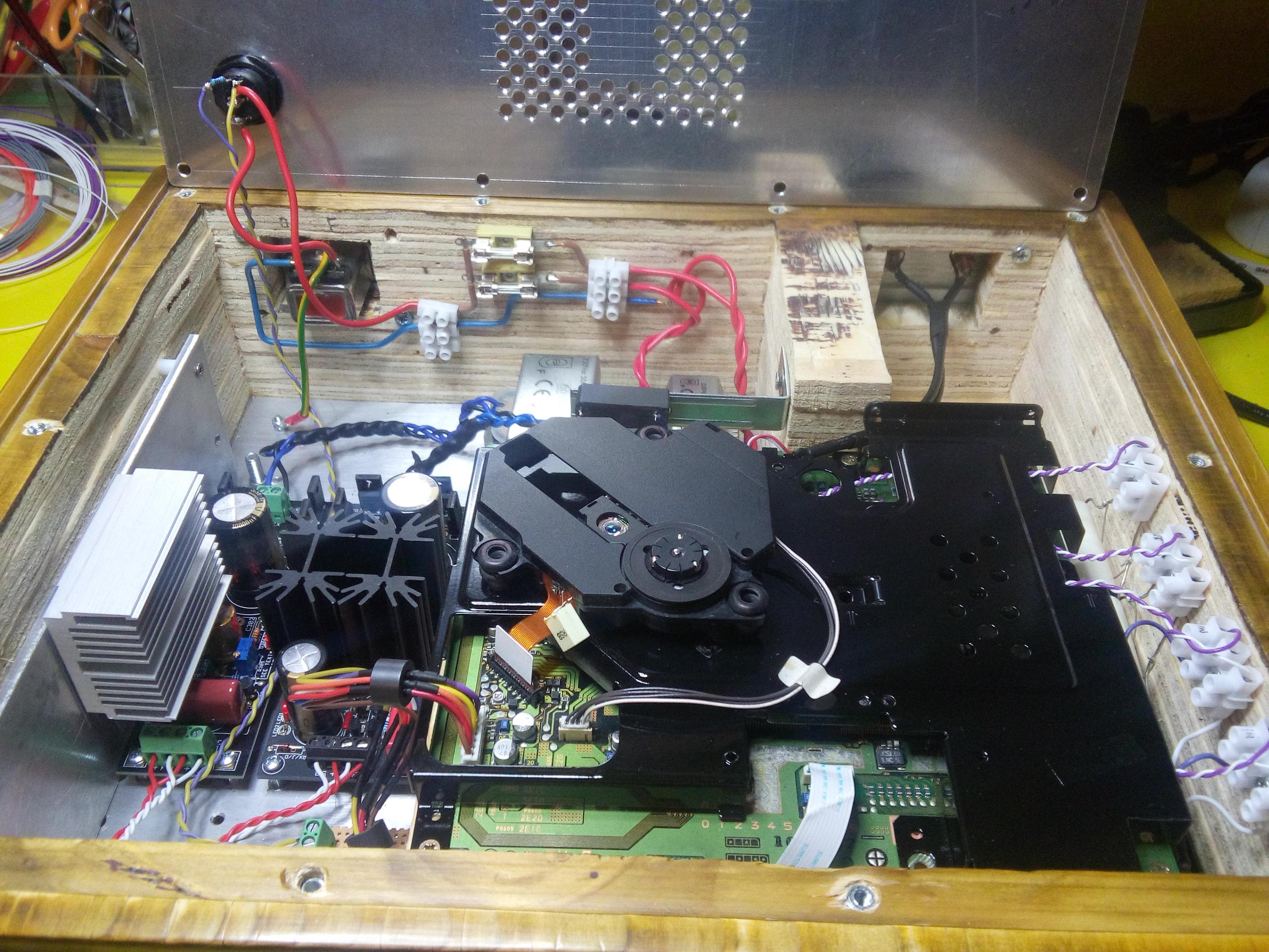

I did change the PSU in my Playstation 1 CD player and I can only say, wow!
SSLV1.1 for the drive and Reflector D for the digital part set to 7.6 volts 1 A respectively 3.6 volts and 500 mA.
Better 3D stage overall but what I am most surprised about is the bass. It is.... not fuzzy any longer! I had good clean bass before also but with the change of power supply it is even more well defined, cleaner and airy.... can't describe it better than this, you hear the wood for example in a cello, not only the tone but also how the wood itself is sounding. I can now differentiate two cellos from eachother by the instrument itself, lovely.
Over all one of the best changes I have made to anything. Thank you Salas for lovely devices

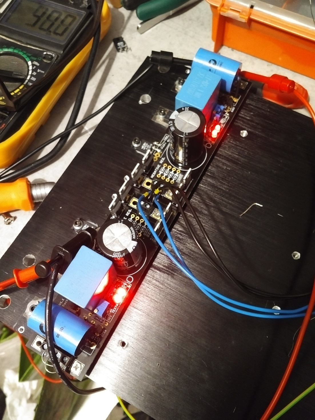

Salas, please help me with some advice. Is it normal for the R101 (4R / 30W) voltage to be unstable? It is constantly changing from 1.298V to 1.356V and back. The set voltage is + 40V.
Thank you very much.
No. The Q101's VGS can change during warm up and make that voltage to slide until hot but not going up and down. Maybe there is oscillation or interference and there is AC riding on it. See with oscilloscope across R101 or at least with a DMM on ACV mode. Really a 30W resistor? Maybe a typo and you meant 3W?
Resistor are Caddock 4R / 30W.
The problem has been solved, I forgot to keep in mind your advice to mount two 100UF capacitors on the preamp power jacks.
Now everything is stable and works perfectly.
Thank you so much for your support, Salas.
