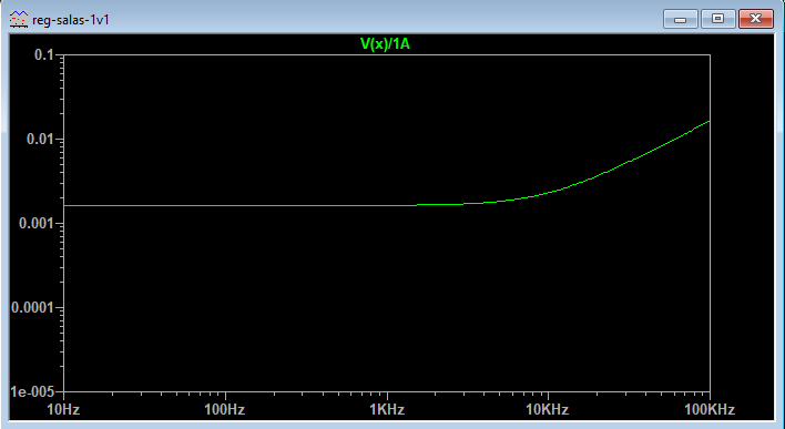

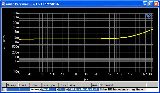

Additionally I found in my archives an older, for the BiB only, Zo graph that Jack once posted in the simplistic low voltage regulators thread.
Also here's my simulated Zo graph when the regulator's settings should have been the same as in his test. Resulting in same spare current.
Practically very close results. Except for one detail. The predicted curve has a quicker supersonic rise to 16mΩ 100kHz while Jack's measured curve has a slower rise to 8mΩ 100kHz. Spice models can sometimes be little pessimistic for intrinsic capacitance of some actual production parts to our benefit it seems 🙂
