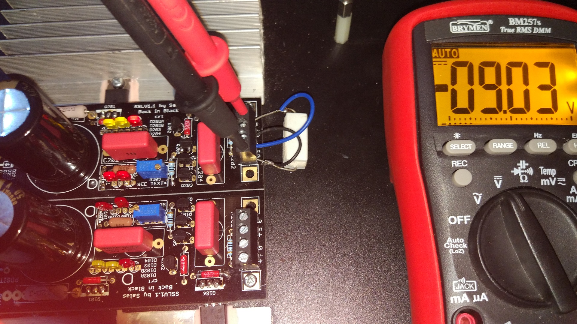

my positive rail on sslv 1.1 doesn't have any problem at all but my negative rail only able to reach 9 volts from target voltage of 12 volts. no matter where i adjust my trimmer it stays 9 v max.
for this negative rail i use 2sk117gr with 4 mA of Idss on Q203, 1.8 kohm resistor, 5 k trimmer and 2 red leds on VRef section.
1 strange thing that i found is the VGS on both shunt mosfets on positive and negative rail is zero. but one reach target voltage, the other doesn't.
fyi, the top part of both mosfets on negative rail seems to touch the heatsink, unlike the positive rail which remain isolated. does this matter ?

In both polarities Qxx1 Mosfet's drain pin connects to Qxx6 Mosfet's source pin. The tabs are drain so they should not show continuity to each other when properly isolated from the sink because they are not connected through the circuit either.

You are maybe using too low a dummy load resistor value for your CCS setting that sucks almost all available current and/or the isolation to sink isn't good and the Mosfets are shorted. Another scenario is the isolation is good but a Mosfet is internally shorted (failed). In any case on a correctly working build you should have voltage drop across each Rxx1 and VGS voltage between the first and last pin of each Mosfet.

i have changed both mosfets on negative rail, make sure there's no continuity between drain tab and heatsink also measure resistance on trimpot to confirm it's working but still the same problem exist.
the VGS on shunt mosfet on negative rail (Q206) is still zero while on positive rail turns out to be 0.2. does this mean the problem is in Vref section or there's still real possibility that Q206 is faulty?

The voltage would go up when turning the screw the other way but apart from that there's no other change when reversing a trimmer that is connected in rheostat mode.
Maybe there is a discontinuity between parts in the Vref section? Use the DMM's continuity function between them. Or some dead LED? Try to light them up one by one as they are installed with a DMM's diode mode that has enough potential or with a 9V battery. Power should be off in this test.

all LEDs are shinning like in that picture so i think there's no discontinuity at all. there's no mixed part between positive and negative rail. i have change that BC 560C (Q204) and shunt mosfet for the 2nd time but still the same problem. maybe the problem is in those 2sk117 but i only have 1 right now which i intended to use it as spare part.

To check its Jfets while already on board you can measure Ohm between their outer pins when power is off. Healthy K1117GR may show around 50-100 Ohm (depends on each sample's Idss) but not a short or a high number.
i measured on Q202 = 94 ohms, Q203 = 81 ohms, Q205 = 75 ohms. no dummy load attached. are these good ?
They are in logical range. Are they verified? There are fakes out there. Do they also have enough IDSS?
they are the real ones. i got them from tea-bag last year. IDSS : 3.3 ma on Q202, 4 ma on Q203 and 5 ma on Q205. they worked flawlessly on positive rail so i think they are genuine.
Then ok with the fets. How much voltage drop you got across R201 and what value dummy load resistor you use?
0.537 volt between R201 legs and i use 39 ohms dummy load. R201 is 2.2 ohms but i remember measured it as 2 ohms. almost forget : i remember before changing the last 2 components that i measured output voltage (F+ and F0) without dummy load at all and its value is 9 volts, the same value with dummy load attached. so as if the voltage reference doesn't exist at all.
yes, it's lower than positive rail which is almost 0.7 volt but the CCS mosfets on both rail do warm up.

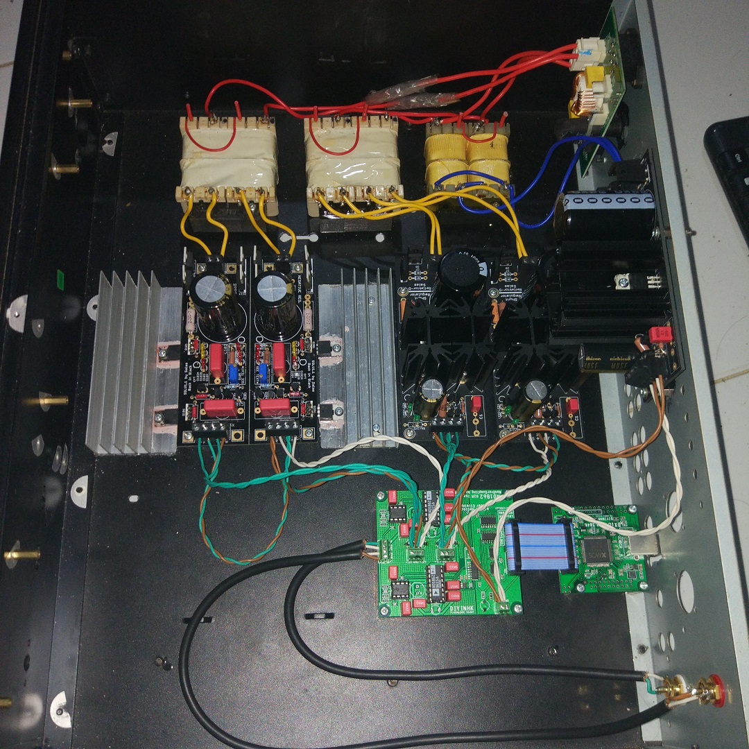

finally got the time to finish my project. it turns out this DAC can be powered with 9 volts on analog and 5 volts on digital. reducing the voltage output especially on Ref-D made CCS mosfets get really hot like my amp. but it has played for 4-5 hours without problem so i'll leave it as it is.
i know they seem to be not ideally positioned and messy but i still need room to build I/V converter in the future. although i still use cheap op-amps as I/V converter right now, it does sound very good. never been a fan of foobar, but this NOS DAC made foobar very enjoyable. i guess the naturalness of treble and more transparency balance things up. except for small mechanical hum on my transformers, it's very quite. if you see on the photos i don't use any noise reduction tantalum caps as the AD1862 datasheet suggested. i do use reservoir caps : 330 uF elna silmic 2 on analog and nichicon polymer (RNU series) on digital in the bottom side of the DAC.
overall this project is worth every penny of it. thank you Salas and Tea-Bag !

Congratulations! Nice to see that you have finished it. Great that you also like it so much. Maybe it can still play well with a little reduced CCS setting in the Ref-D? Even 10% less can make a difference for the sinks.
i don't have the correct bias resistors but i do have back up for every kind of mosfet here. so i'll be ready if any mosfet fails. maybe i like it hot 😀
