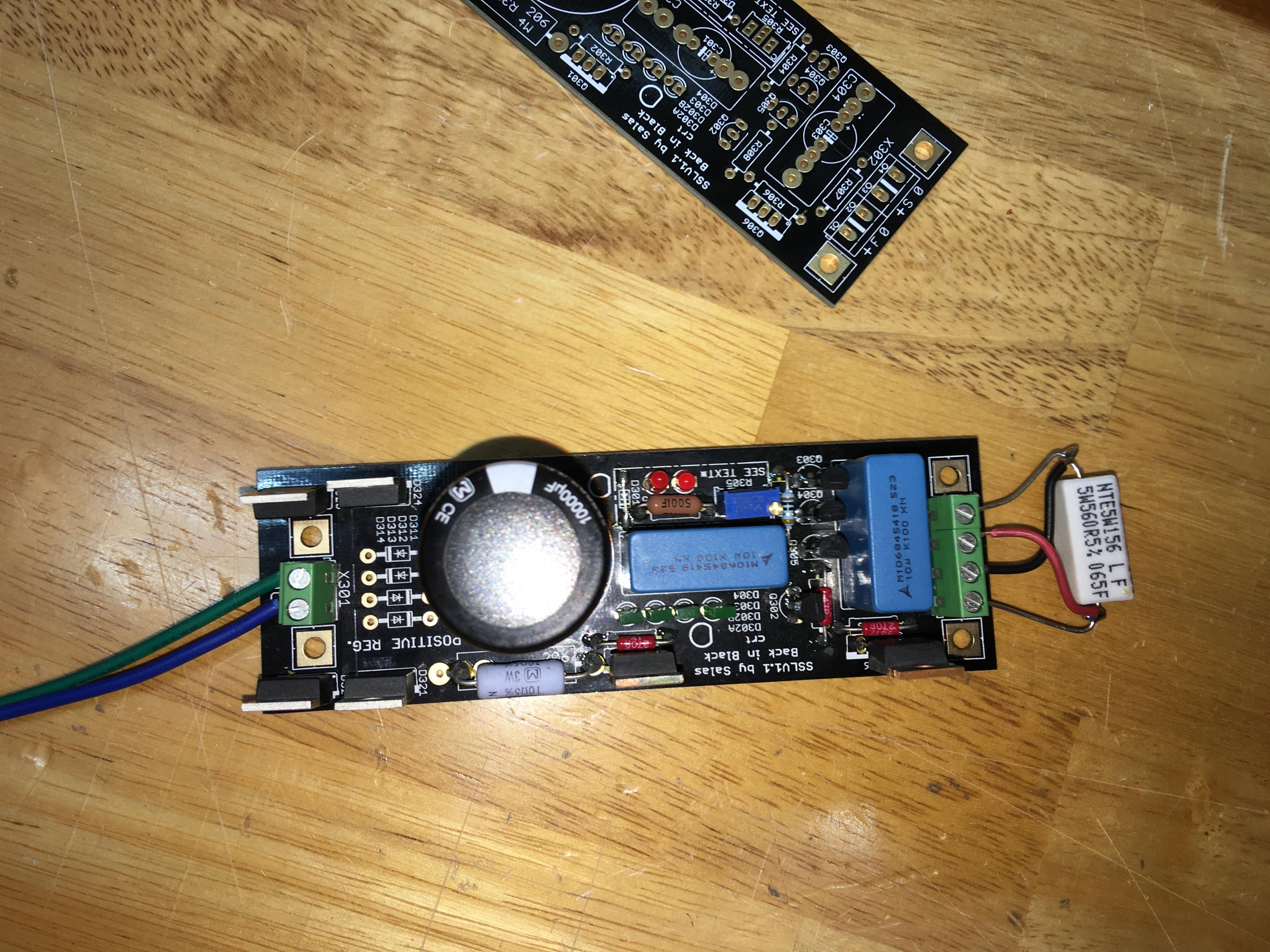

I still have two set of boards that I haven't built yet. Since I have all the parts needed to build one set of boards, I was planning to build at least one set. I will use the ultrabib boards, that I still need to collect all the parts for, for a future project. So with the extra positive board I was going to use it to power 2 analog crossover boards, the lxmini ones in the DIYaudio store. It requires +24V with 75mA load for each. So would a CCA of 275mA work fine? Would a 2x22VA antek transformer work for this? I have an extra 200VA transformer that I could use (seems a bit large for the load, may get a smaller one to put in the chasis later).
Both your CCA and transformer voltage choices are good. To save some dissipation see if the crossovers sound as good with 175mA CCA too. So calculate and have extra current set resistors for testing both CCA levels.
I was going to use the same reg to power both boards. To go double mono I would need some more parts for a matching positive regulator. I could always add it later if there is enough room in the enclosure for the extra regulator.

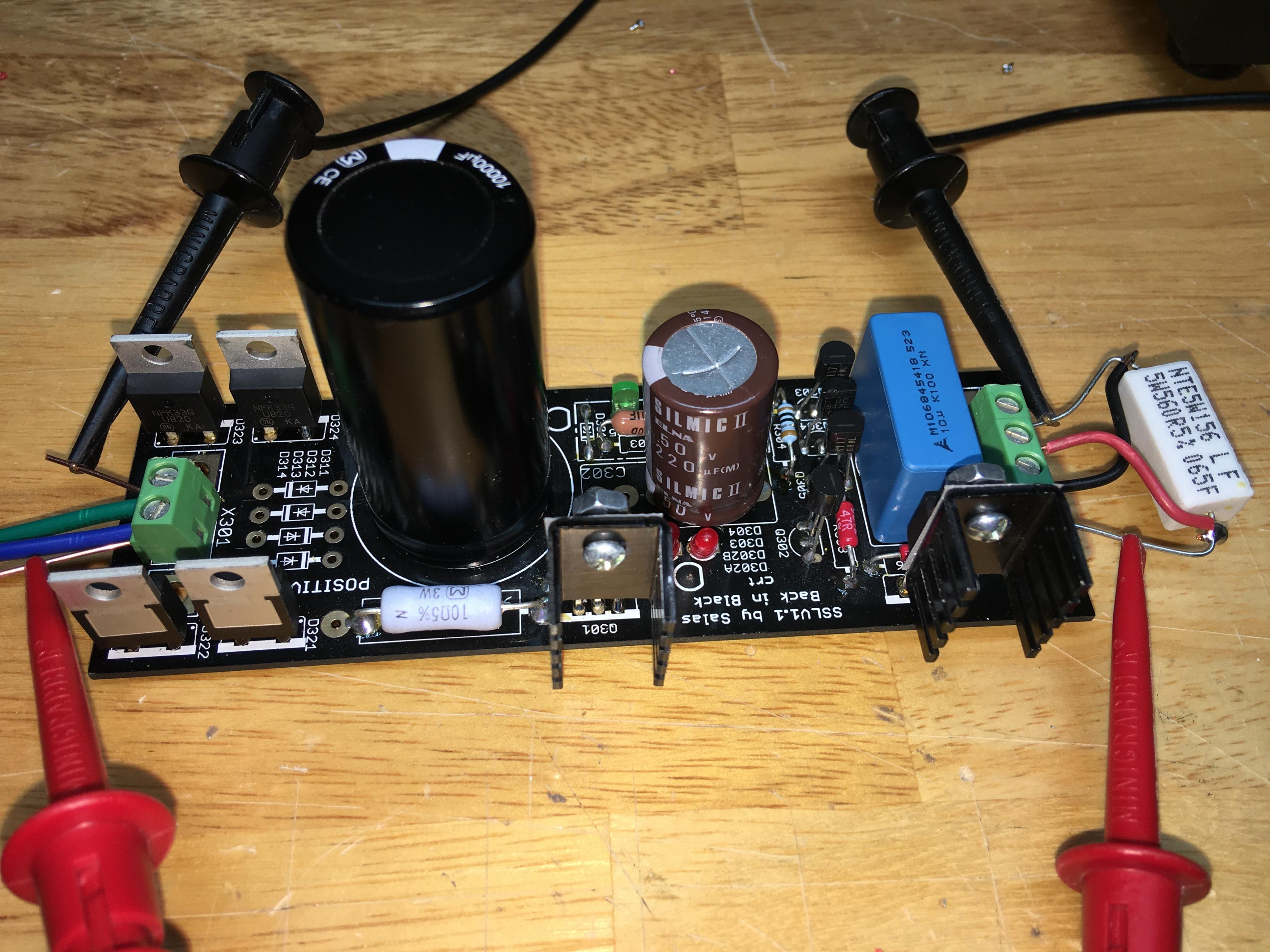

I'm using a SSLV1.1 to power a B1 with Korg Triode which draws only 60mA. Using the calculator it looks like 20Ω resistor in the R101/301 position would be appropriate. I don't have a 20Ω on hand, but I do have 10Ω. Is there a disadvantage to using the 10Ω?
Only disadvantage will be more heat on the PSU's sinks. High spare current is actually advantageous in this version both technically and subjectively.
