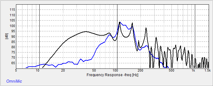

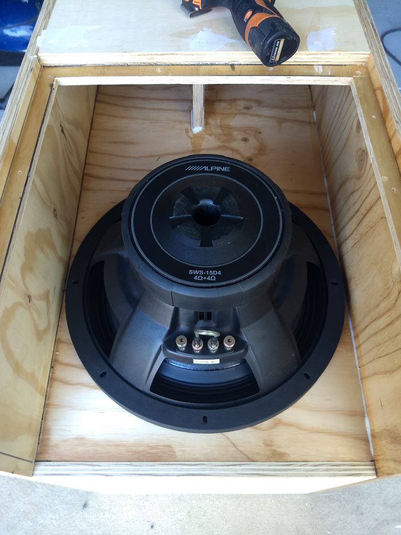

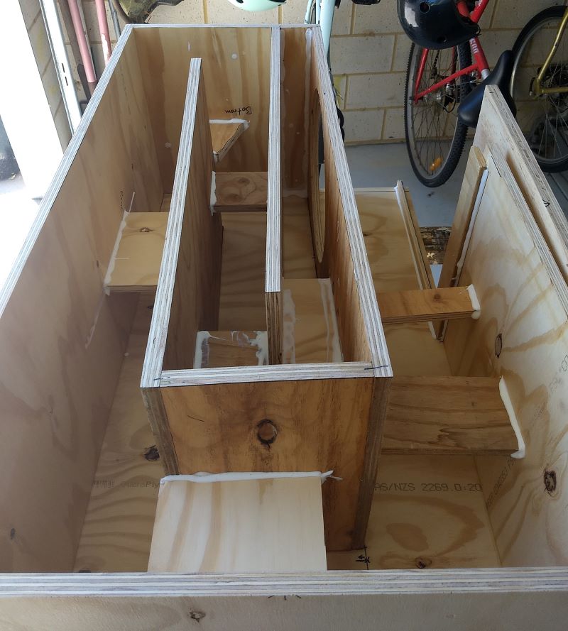

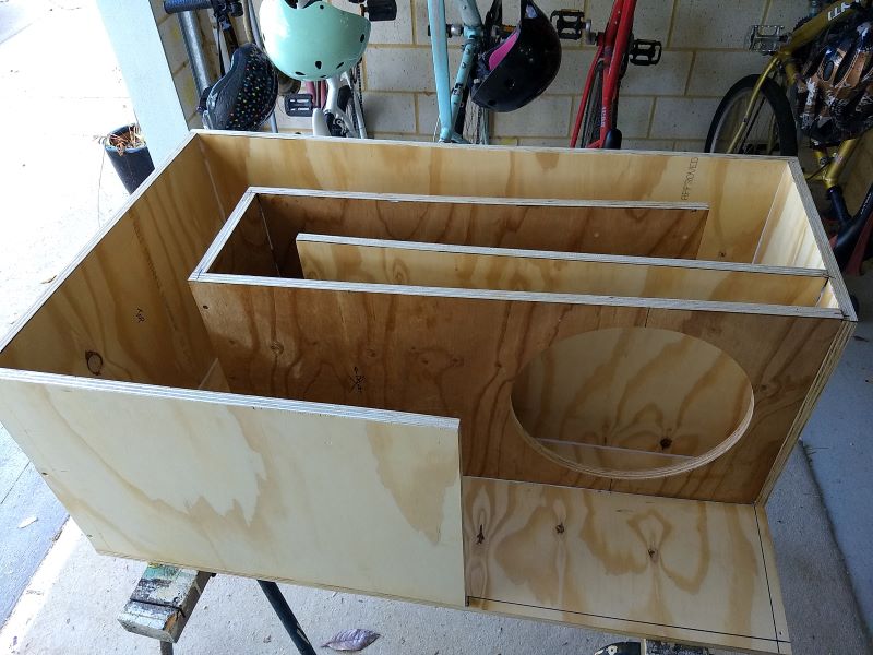

I modelled up and built my first Box Plan MTH over the last few months.
I finished the build today but I'm disappointed to report that the build doesn't match the model. Black is modelled, blue is measured....
I have two nice drivers that I measured the Semi Le for and used this for my HornResp parameters. I've triple checked all my HornResp parameters and these look fine.

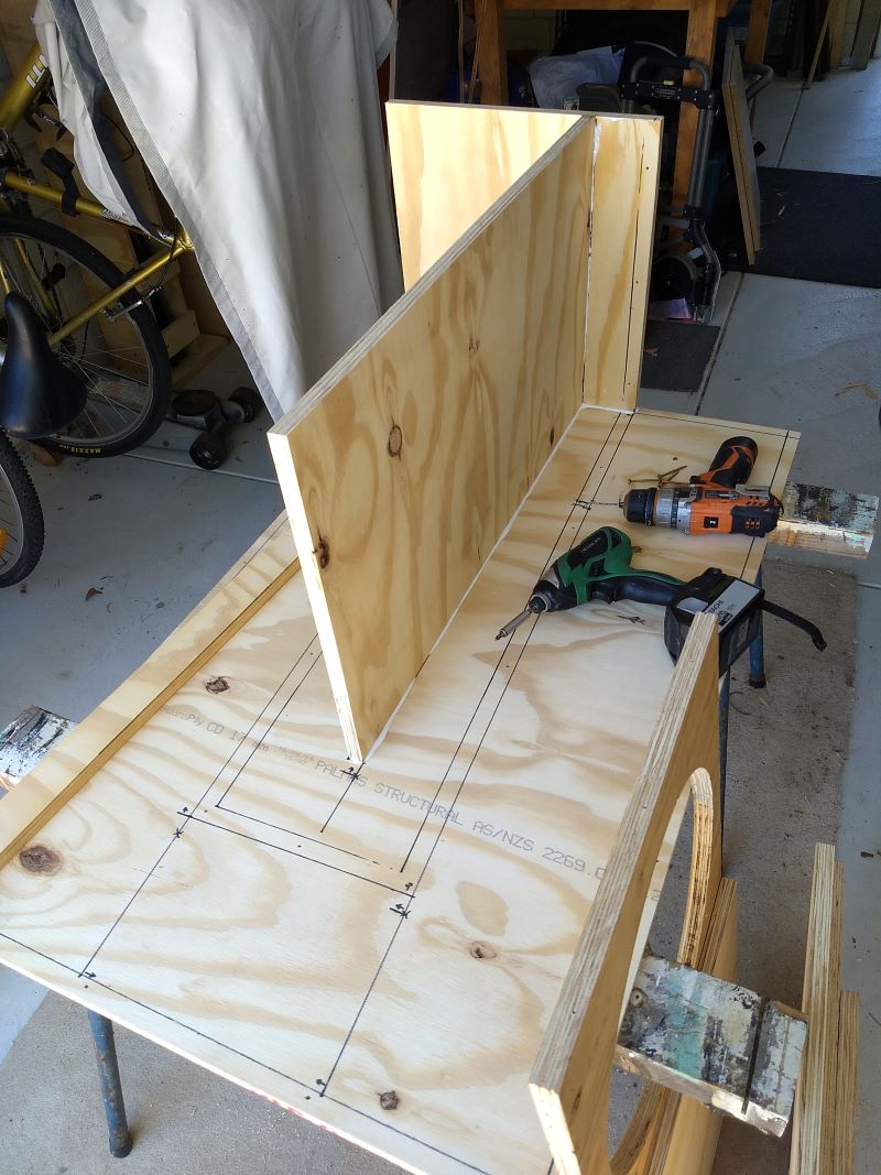

This is my fourth tapped horn build, my first with Box Plan. I used your terrific Box Plan MTH to get a box as small as possible with the target extension I'm looking for which I know will couple well with my room's natural boost.
The build was much easier with your charted layout. Picking up the coordinates for the interior horn path was a dream. This made the horn path segments really easy to cut and fit. The enclosure turned out great. I glued with PVA and screwed. It's as tight as a drum.
Some attachments on this message. I measured the impedance and overlaid this in DATS with the predicted from HornResp- Blue is modelled, green is measured. REALLY hoping for some help. PLEASE! What have I done wrong?

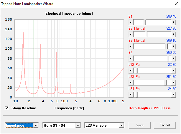

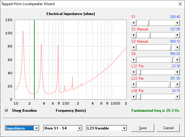

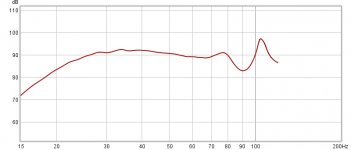

The blue graph goes way below the driver's Re of 7 ohms, so I imported the Hornresp model from the workbook and checked the impedance curve in there. It looks very different to the blue graph (see attached image). Did you modify the model after importing it?

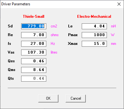

HI Brian,
The TS in the BP-MTH are the manufacturers specs. I used these initially.
I subsequently DATS the drivers and added the following TS directly into the HornResp model....
Then I did the Semi Le workbook and added these also manually directly into HornResp....

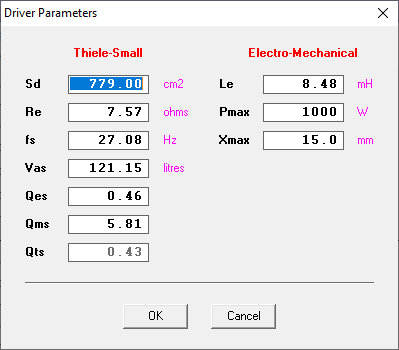

The measured Le looks very different from the published Le, while the other parameters are similar. I'd recheck that figure.

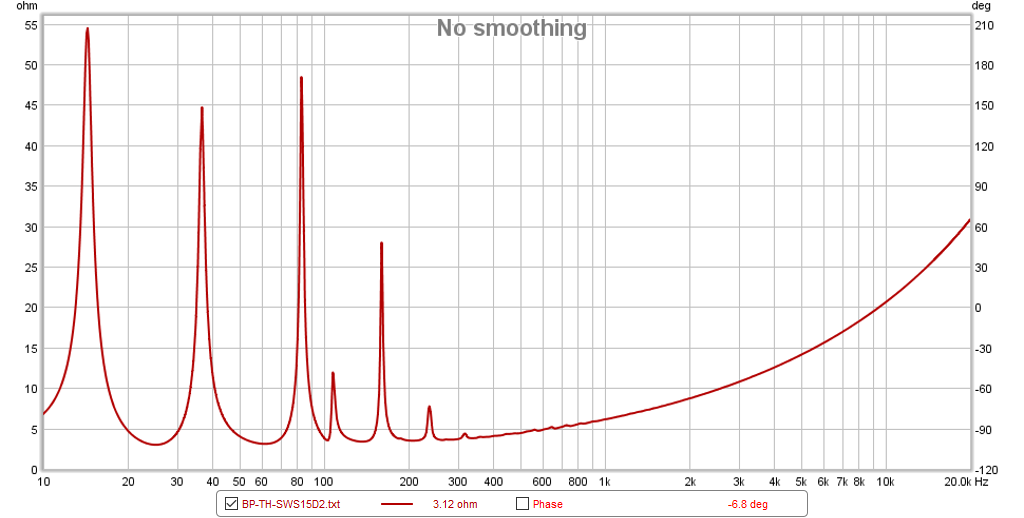

In any case, the DATS measured impedance curve shows an impedance that drops almost to 3 ohms. The impedance should never go below Re, the coil's resistance. I suggest rechecking all of the driver parameters that you used in the model. I entered the new parameters that you used, and the corresponding impedance curve still does not look like the one that you imported into DATS. The minimum impedance is much higher.

Hi Brian,
The measured impedance is with my nice old Celestion AD 15H. Apologies for mixing that in with the Alpine data.

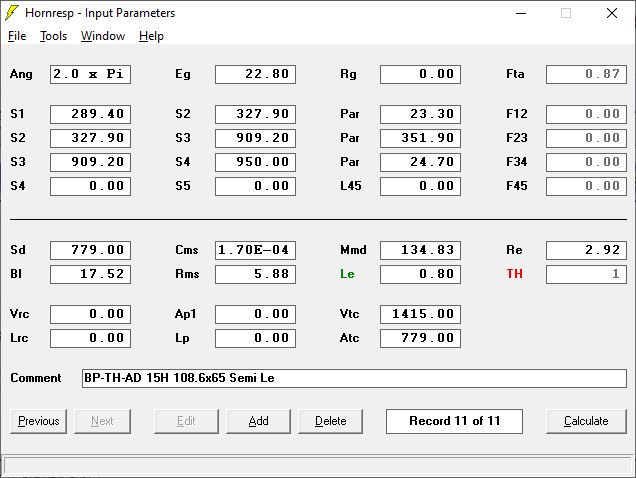

For the Celestion here's the HornResp input screen....

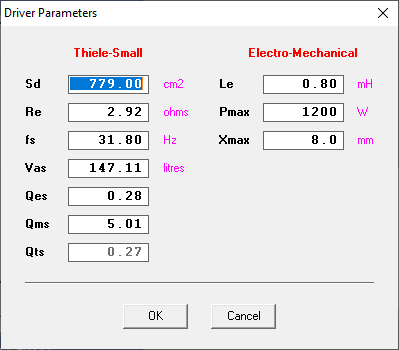

Here's the TS....
Here's the Le....

With those new driver parameters, the minimum impedance in the model is around 3.12 Ohms. Your DATS measured impedance curve suggests a minimum impedance for your build that's less than that. Measured minimum impedance should always be more than the modeled minimum impedance, so something's still off.

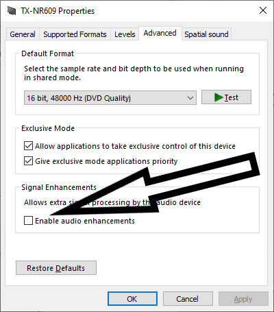

Unless there are some serious leaks in the box or the driver is broken, you should get SOME Bass out of this, even if the model isn`t optimal... How does it sound? Is there a highpass in the signal by accident?
Brian, my fried, you are a dead-set genius!
So you were right about a high pass.
When I was measuring I was thinking there has to be a high pass on here. All my signal chain checked out for full range tho.
Just now when you mentioned a high pass I had a flash back to some of my first measurement headaches with Win10.....
The dreaded Signal Enhancements check box = a very nasty high pass! Switch this off and Eureka!
Now we look like this with the SWS....
Sincere apologes for the inconvenience. I truly appreciate your time and help with this.
Tapped horn happiness! Thunder downunder, here we come

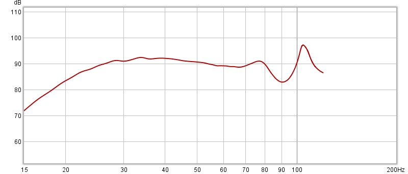

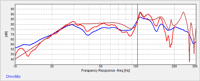

Looks like there's pretty good agreement now between the model and the measured results.

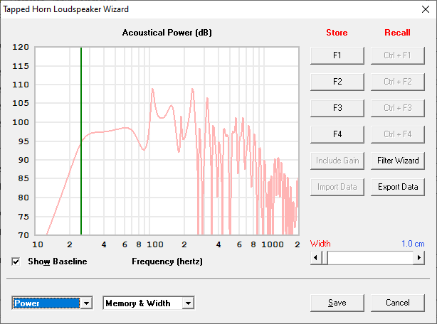

Modelled vs measured impedance for Alpine SWS15D4 and Celestion AD 15H looking good to me per attached.

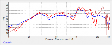

With the Celestion loaded measured ground plane @ 1m:
- Brown = modelled
- Black = Omnimic suite measurement
- Red = Omnimic + cal file in REW....
