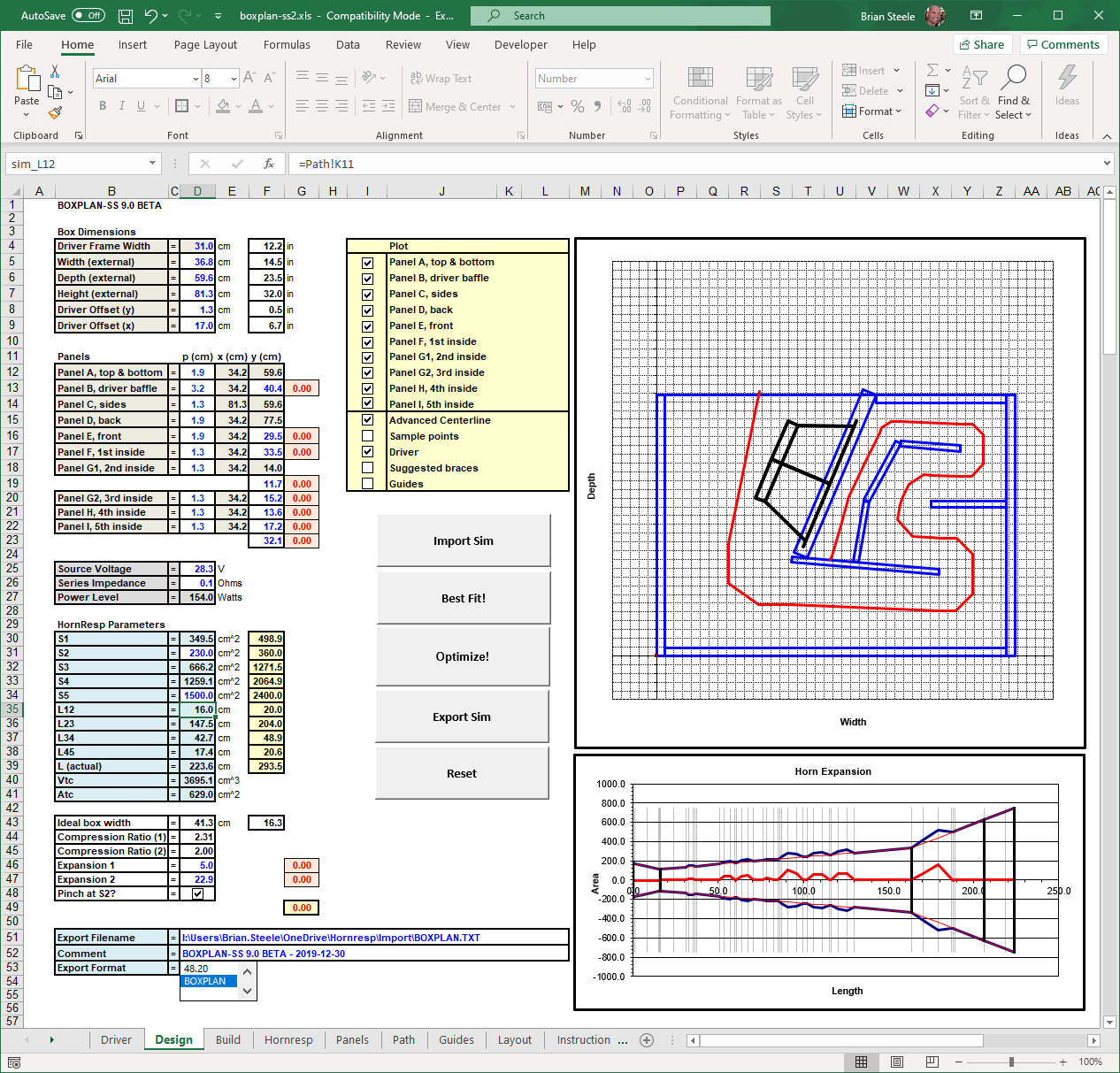

Just experimenting with a different layout for the "Design" spreadsheets in the "Boxplan" workbooks. I've also updated the "SS" Boxplan workbook to allow a "pinch" at S2, just in case anyone wants to experiment with that.
I've been working on the workbook for the past few days and I'm not sure that I've got all the bugs out yet. If you come across any, please let me know.
Brian I think it would be great to have a separate table for driver dimensions like some of the other BP workbooks do. It's great to be able to visually check how much physical space the driver frame and motor takes up in the horn path.
If the reset button does what I think it does this will be great when the folds get messed up by making very large changes to the overall box dimensions.
Having the compression ratio auto calc'ed is a major boon thank you.
I've moved all the driver info such as the dimensions to a separate "Driver" sheet, as that information doesn't change very often when you're adjusting a sim. The "Driver" sheet also allows you to store and recall driver information in the Hornresp database, including the dimensions, so you only have to enter them once.
The RESET button actually just resets the target sim data (assuming that you've imported a Hornresp sim), but you've given me an idea - to add an option to store and recall BOXPLAN settings just in case the optimization routine goes awry, which can happen sometimes.

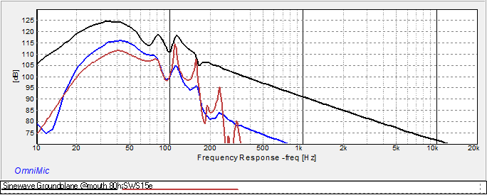

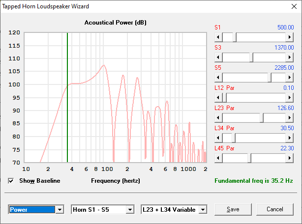

BP-MTH-266 with SWS-15D4
Have been enjoying this system in my HT for a few weeks with the Celestion AD15H loaded.
Just had a chance to install and measure the SWS-15D4 in the 266 litre BP MTH in my garage.
Note I changed the exit to the side so I can stand the enclosure on end and reduce floor space foot print so the horn length is likely a bit shorter than the HR predicted response.
I had the 80hz low pass switched on in the Onkyo TX-NR609 receiver I use for a preamp. Too noisy for the neighbours otherwise. No high pass filter engaged here.

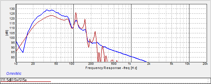

The first graph below shows measured at mouth in Blue, HR predicted in RED (with LP 80hz 12 db applied). At 20v my little Biema W220II was beginning to light the clip indicator. The SWS seemed relaxed at this input voltage.
The second graph shows the HR simmed response in Red compared to Omnimics Pseudo noise in Black and Sine Sweep in Blue measurements - intrigued about the difference there.
Tapped horn fun!
Thanks again Brian.

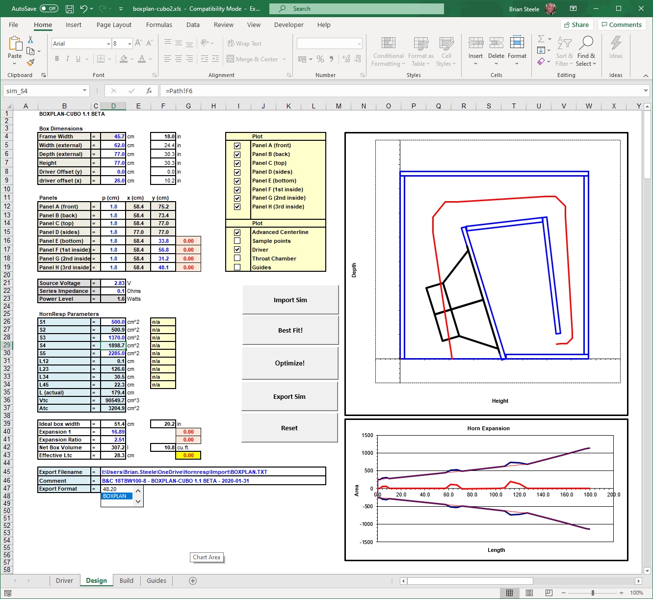

Newest addition to the BOXPLAN family - "Cubo" type subs.
As usual, the BOXPLAN workbook can be downloaded from my Horn Folding page at The Subwoofer DIY Page - Horn Folding

Looking good! I'm still familiarizing myself with using your spreadsheets but I've already found them useful and intuitive. Thank you for providing them and the work you put in to maintain them.
