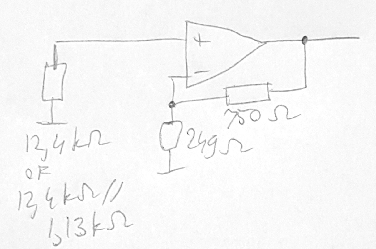

Actually the noise data in the OPA210/OPA2210 datasheet are inconsistent. Either someone made a big mistake making figure 7-2 of the OPA210/OPA2210 datasheet, or TI tries to pull one of the oldest spec tricks for op-amps with base current compensation.
Manufacturers of op-amps with bipolar input stages with base current compensation often specify the equivalent input noise current with exactly equal impedances driving the positive and negative inputs. No-one ever uses them like that in a real-life application, but it results in nice, low datasheet numbers. That's because the noise of the part of the base current compensation circuit that is common to the positive and negative inputs cancels when the impedances driving the positive and negative inputs are equal.
A typical example is the LT1028: its equivalent input noise current is 1 pA/sqrt(Hz) according to a table in the datasheet, but when you read all the small print and the typical performance graphs, you see it is actually closer to 3.25 pA/sqrt(Hz) under realistic conditions. Hans once measured it and even found 3.4 pA/sqrt(Hz), which is also the value one can calculate by adding up all the major shot noise sources in the schematic diagram at the end of the datasheet.
Now the OPA210/OPA2210. The table in section 6.6 of https://www.ti.com/lit/ds/symlink/opa210.pdf specifies 400 fA/sqrt(Hz) = 0.4 pA/sqrt(Hz) as the equivalent input noise current. That would make it outperform the NE5534A, as the NE5534A also has 0.4 pA/sqrt(Hz) of noise current and a higher noise voltage.
The measuring conditions for the OPA210's 0.4 pA/sqrt(Hz) are not clear. It has an NPN input stage and an input bias current that can be positive and negative, implying that there must be base current compensation.
Section 8.1.1 about noise calculations indicates that that 0.4 pA/sqrt(Hz) applies with and without matched impedances driving the positive and negative inputs. However, Figure 7-2 doesn't. Assuming that the unit for the vertical axis is nV/sqrt(Hz), it indicates a noise level of about 1.6 uV/sqrt(Hz) for a voltage follower driven from a 1 Mohm source resistance. That corresponds to almost 1.6 pA/sqrt(Hz) rather than 0.4 pA/sqrt(Hz)!
If it is really 1.6 pA/sqrt(Hz), then it is not very suitable for moving-magnet amplifiers. Besides, a noise measurement I did a few weeks ago on a voltage reference involving OPA2210's is then all wrong. I'll do some more measurements to find out what is true.
I just did some noise measurements on this circuit
and the results are consistent with 0.4 pA/sqrt(Hz). Apparently figure 7-2 of the datasheet is wrong. Regarding noise, the OPA2210 is a good choice for MM then.
To be precise, I measured the RMS noise over the bandwidth of a Fostex FR2-LE recorder with 96 kHz sample rate, presumably a few Hz to about 44 kHz, with 12.4 kohm or 12.4 kohm//1.13 kohm at the input of the op-amp. There were two 47 ohm resistors and two 47 uF bipolar electrolytic capacitors between the circuit and the microphone input of the Fostex. Correcting for the measured noise of the Fostex itself (including 47 ohm resistors and bipolar capacitors), I found these ratios between the RMS noise levels:
Measured: 0.33048
Calculated, assuming 0.4 pA/sqrt(Hz): 0.32616
Calculated, assuming 1.6 pA/sqrt(Hz): 0.21176
All in all, with very different impedances at the positive and negative inputs, the 0.4 pA/sqrt(Hz) is spot on.

You are right, figure 7-2 does indeed indicate a noise current of around 1.6 pA/sqrt(Hz).
For some reason the OPA1612 seems to have a very similar noise voltage with a 1 Mohm source resistance, but in this case the current noise is specified as 1.7 pA/sqrt(Hz), which fits better with the curve. With the OPA1612 there is also a bias current, which can be either polarity, implying that also in this case base current compensation is used. In this case the bias currents are much higher than with the OPA210 though (+/-60 nA typical versus +/-0.3 nA typical).
I just saw your latest post. Great to get a confirmation of the low value and an apparent error in the datasheet. Thanks.
I filled in TI's documentation feedback form and emphasized that this mistake makes their op-amp seem worse than it is. Hopefully they will correct it.
The text along the graph in question mentions “Votlage noise” instead of “Voltage noise” and as you already mentioned it should be in nV/rtHz instead of Vrms.I filled in TI's documentation feedback form and emphasized that this mistake makes their op-amp seem worse than it is. Hopefully they will correct it.
Added to the misleading graph itself, one might wonder why they are being so inaccurate.
Good that you had a OPA2210 at hand to measure.
This dual amp is a worthy successor of the single NE5534A.
Hans
