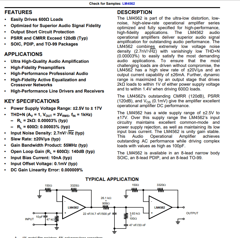

I've just came across this very interesting comprehensive write up on audio op-amps. Maybe you have all read this before, maybe some of you haven't. Seems like the lm4562 IS one of the best so hopefully I can get my phono pre-amp to work without the popping/ rustling noise but I need to see what happens when I fit the new 5532s. https://nwavguy.blogspot.com/2011/08/op-amp-measurements.html
Browsing through it, I see that it is stated several times that it is not applicable to phono amplifiers. I guess the impedance levels are much lower, so input current noise doesn't matter much.
I just took a look at the NJM2068 https://docs.rs-online.com/8cc9/0900766b80e6f63c.pdf
Itsquite an impressive opamp for the money. With 20k Rsource, the total input referred noise is 1.5 uV which with typical MM cart is good for about 70 dB SNR (5mV)

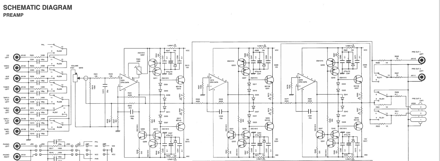

Hi All. I have just received the NE5532s but it struck me that maybe I will need a DC blocking capacitor at the output of the RIAA phono stage? I have a NAD S100 preamp which, from the schematic, shows no coupling capacitors on the input or on the output. Just to take this question further, perhaps I should have had a dc blocking/coupling capacitor on it anyway even for the the LM4562 as the spec sheet shows 0.1mV input offset? OR is this op-amp factory trimmed to produce no DC offset? I'm pretty sure the NE5532 does produce a DC offset...Very much obliged for guidance with this aspect. Thanks.
You are right, your preamp starts with a pot, and DC on a pot should be prevented at all time.Hi All. I have just received the NE5532s but it struck me that maybe I will need a DC blocking capacitor at the output of the RIAA phono stage? I have a NAD S100 preamp which, from the schematic, shows no coupling capacitors on the input or on the output. Just to take this question further, perhaps I should have had a dc blocking/coupling capacitor on it anyway even for the the LM4562 as the spec sheet shows 0.1mV input offset? OR is this op-amp factory trimmed to produce no DC offset? I'm pretty sure the NE5532 does produce a DC offset...Very much obliged for guidance with this aspect. Thanks.
So, you will need a cap plus termination resistor to block DC entering your preamp.

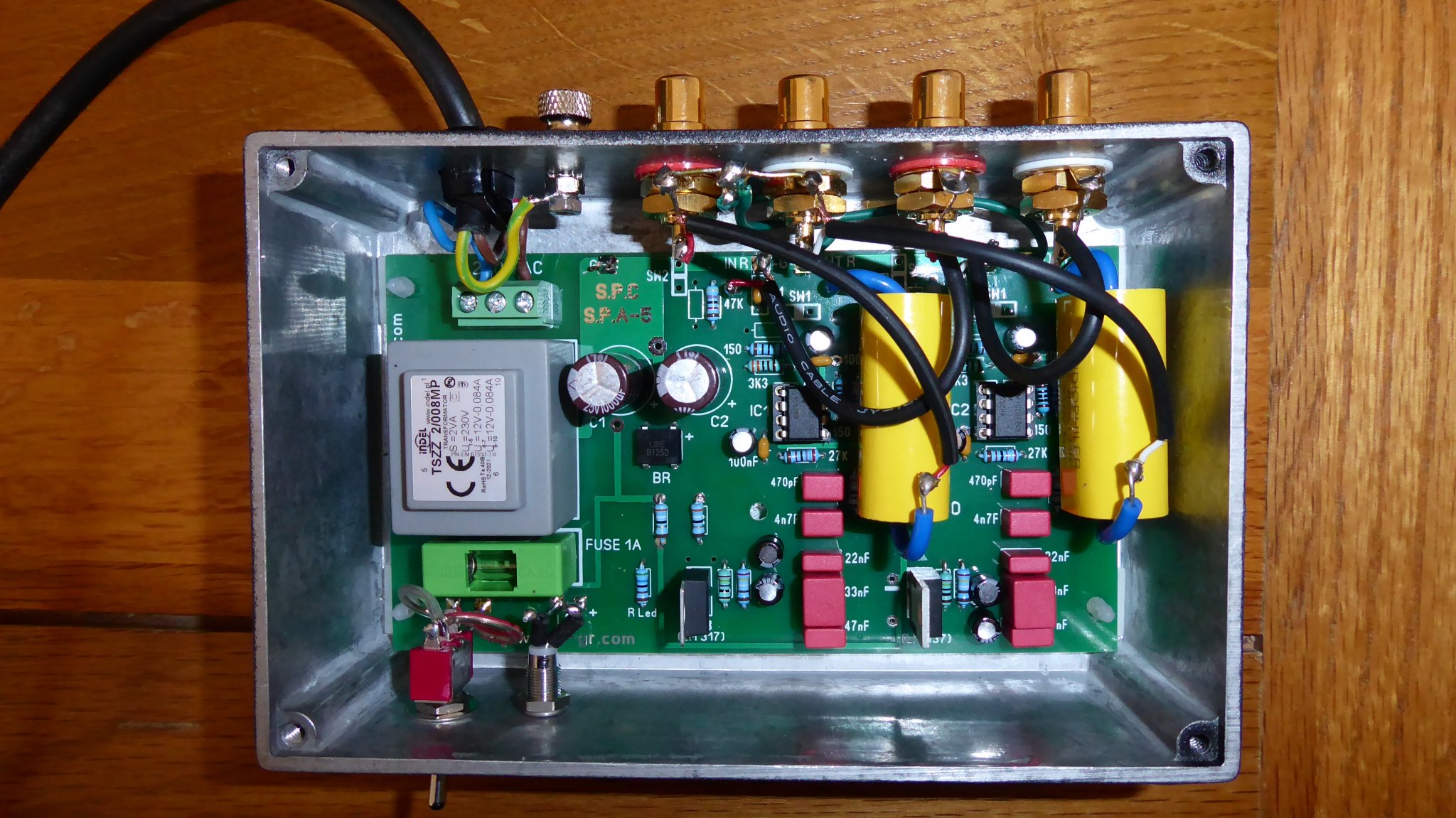

Just to say I fitted the outputs with polypropylene caps to block the DC which is approx. 0.5V each channel. Sounds pretty good now but I would like to know how flat the response is and will do some measuring with an OPTI-Mike set up playing a test record of white noise when I get the chance ...will post here when I do.
Using Pink noise giving a 10dB/oct downward slope might be better. Anyhow, looking forward to see the resultsJust to say I fitted the outputs with polypropylene caps to block the DC which is approx. 0.5V each channel. Sounds pretty good now but I would like to know how flat the response is and will do some measuring with an OPTI-Mike set up playing a test record of white noise when I get the chance ...will post here when I do.

Didn't read last few pages as kind of tired always reading those absurd discussions about noise in riaas.
What is totaly wrong at first look, for me:
1. LM4562's input bias current! Totaly not suitable for cartridge input stage! Not only kills any dinamic, also magnetizes cartridje to almost unrecoverable levels, and, forever.
2. Even if MM friendly op amp is used, input load is fixed and wrong.
Last riaa i built was with OPA1642. Custom build interconnect with aprox 30pF. No additional cap at the input. Load resistor 90k!!!!! Optimized for AT-VM95. By memory, calculating back, total input capacitance was 67pF and input RCL group being flat up tp 23 or 27kHz. If this 'small' detail (input RCL) is wrong, ewerything after it is neaningless.
