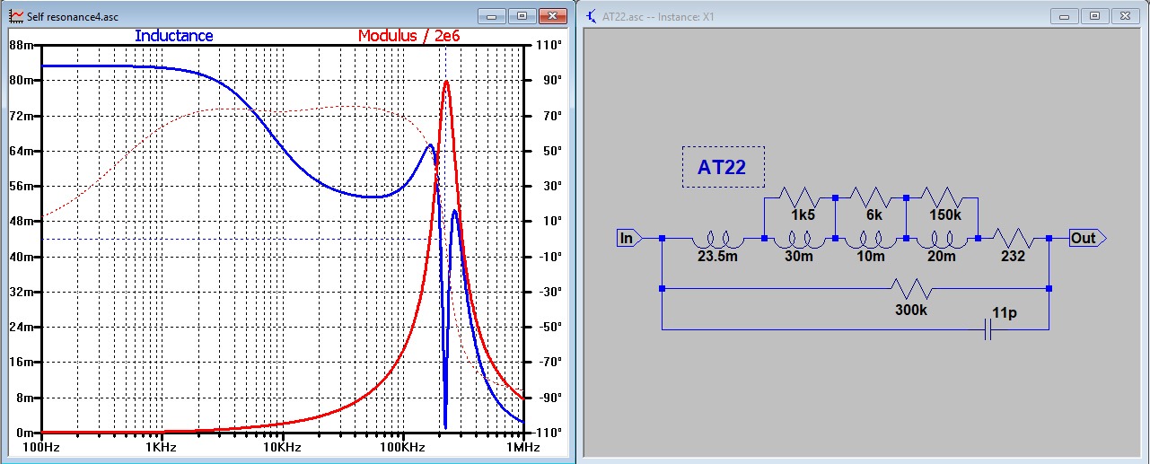

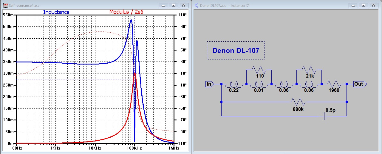

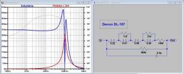

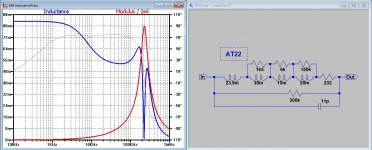

Better test equipment is always nice to have, but be aware that a MM Cart is more than just a Resistor and a Coil.Inspiring. Marcel, your post #84 made me disassemble my Dual sled to measure the cart, the 550mh seemed high for me too (intuitively, no maths involved). I may have to Buy Better Test Equipment 🙂.
See examples below showing the replacement diagrams for two different carts.
As you can see, measured inductance will be highly dependent on frequency.
Hans
What equation do you use for the inductance? I would expect it to go negative after self-resonance.
Of course, It does go negative, but displaying the absolute value keeps the vertical axis as detailed as possible. That’s why many VNA’s display it this way.What equation do you use for the inductance? I would expect it to go negative after self-resonance.

Yes, I wondered about the @1khz spec. Thanks for explaining 🙂. I am very much beginner. Funny, I have both carts in your examples in the house. The omega coiled AT22 measures 67/215, and its identical siblings AT24 is 67/238 and Signet TK9/10 are 67/238 and 73/240 (spec for all is 85mh/240R). The silver wire coiled TK100 measure 67mh/177ohm. So I'm not sure if AT dropped inductance on purpose, or my meter is wrong. It's this one https://www.ebay.com/itm/222235430386 .Better test equipment is always nice to have, but be aware that a MM Cart is more than just a Resistor and a Coil.
Hans
The Denon I haven't measured, - yet. It's packed to travel, but I suppose I could unpack it since it seems to be in no hurry. I have some of it's siblings too, the DL-109 and the DL-202 (which has been restored/modified and measures 20mH/100ohm on my meter).
I really miss is a good vinyl source to measure actual FR too, so suggestions are welcome 🙂.
Hans
So you took abs(Im(Z)/(2 pi f))? It's obviously simulated, so I don't understand what vector network analysers have to do with it.
Several curves are measured with a VNA.So you took abs(Im(Z)/(2 pi f))? It's obviously simulated, so I don't understand what vector network analysers have to do with it.
In LTSpice while inserting components and adjusting their values, I continue until I get exactly the same curves as recorded with the VNA.
That’s how the replacement diagrams came to life.
Hans
