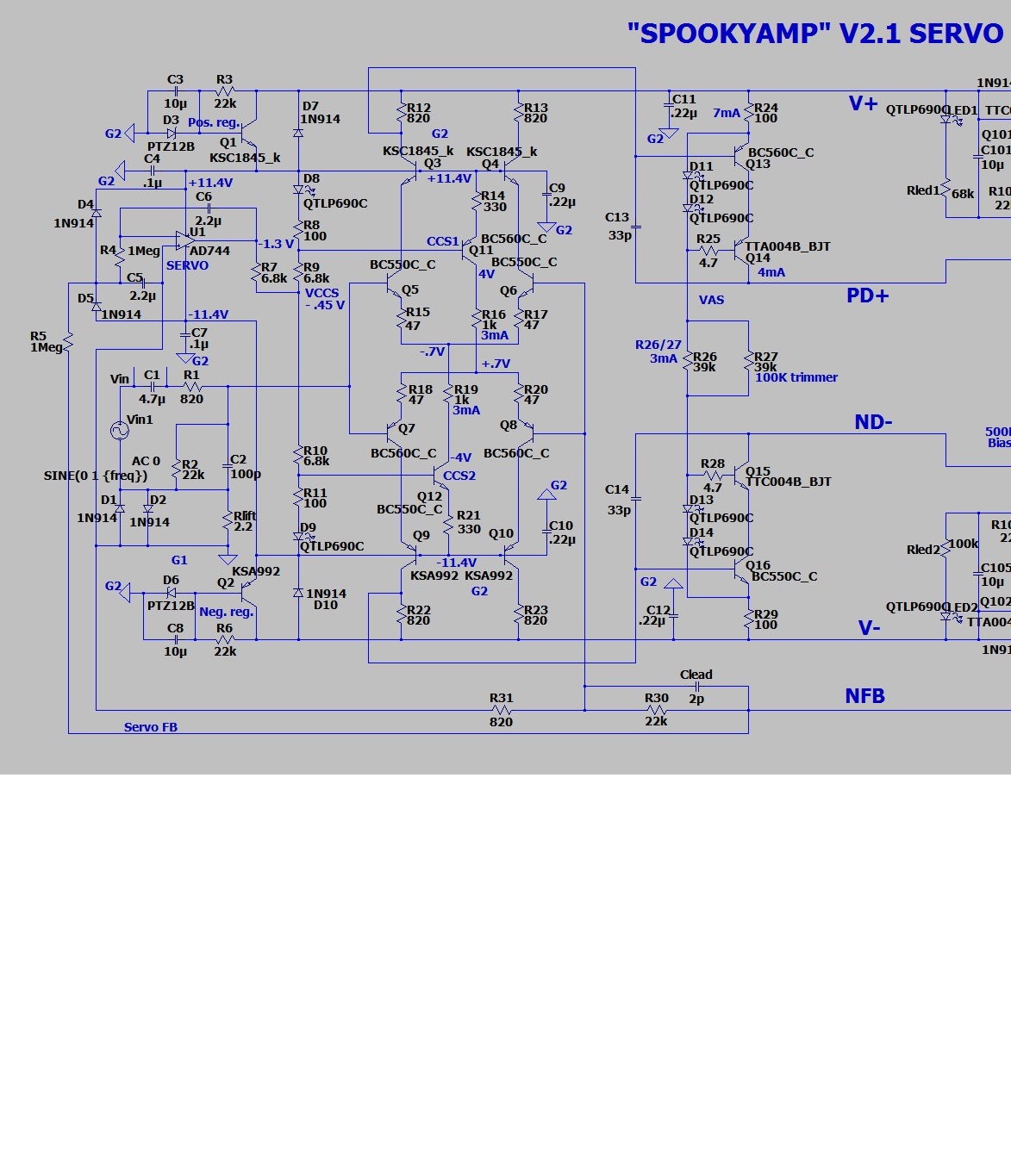

I rethought the SERVO grounding. On the spooky , unused op-amp ground does not matter. Positive input of the inverting servo op-amp needs
to reference the speaker ground , since it is the speakers DC that you want to cancel. If you used the Rlift ground , a ground fault would screw up that
reference. BTW - direct "G1" is the ideal reference.
On my sub Spooky , I can nearly get to 1hz , the input cap and the servo Fc attenuates below that.
The "VCCS" servo , as well as having diode limiting - just slightly shifts the Vf of the two red led's. Feed +11.4V into "VCCS" and the amp will be at about
-2V at the output. Kind of overkill for worst case conditions.
I've already had 8 years of success with this servo , the Hellraiser should be the same (same "VCCS").
PS - I even attenuate the possible 90V p-p signal to uV through (1 meg) R5 before routing it back to the input stage and servo.
Don't want that "hot wire" passing across my tender circuitry.

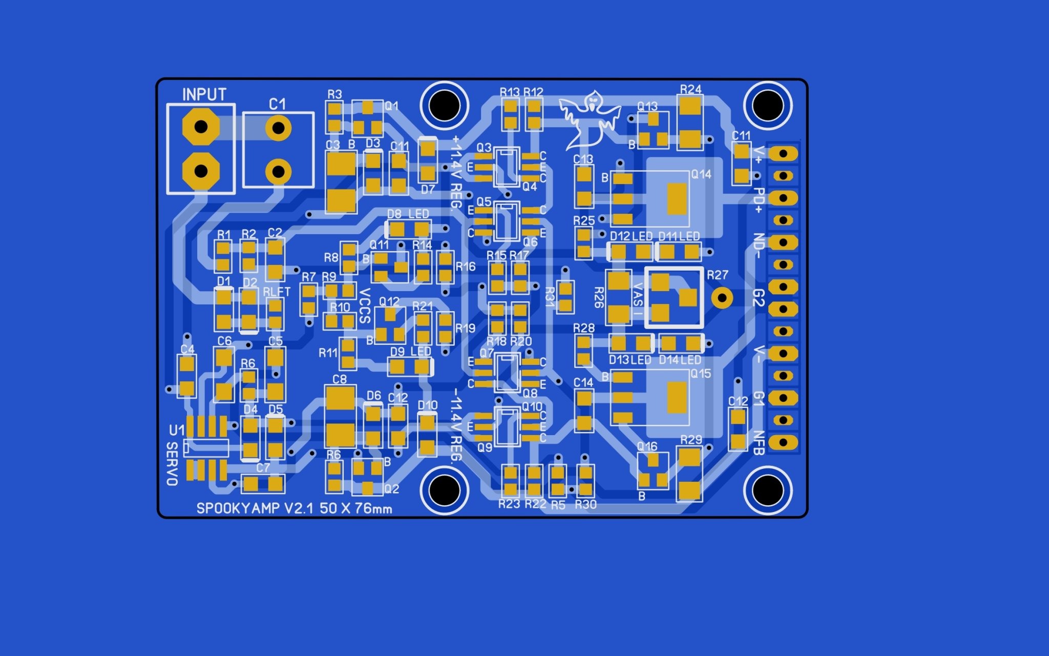

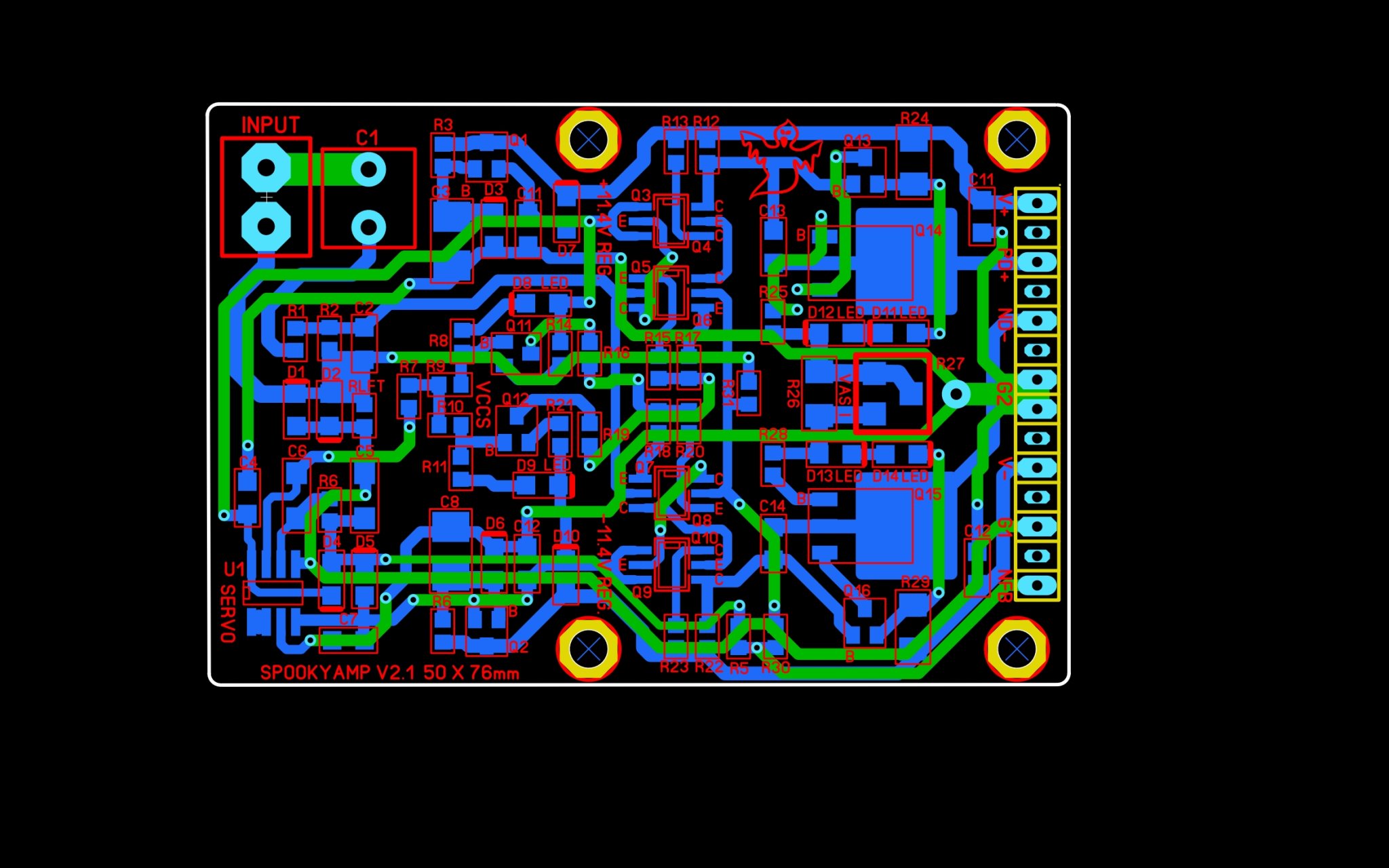

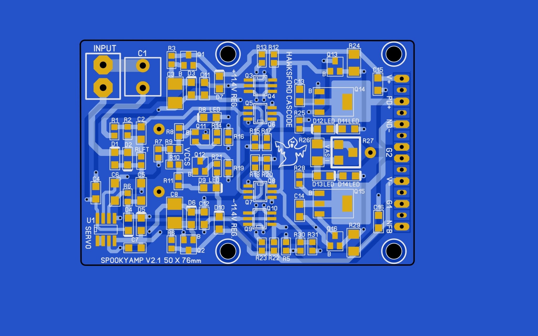

C1, the 4.7 uF MKP from the input filter, where will it physically reside?
C1 through-hole pad is on this board (and both IPS's) . I considered it possible to jump it if you want a SMD only unit.
If you want that big Audiophile cap , mount it right at the input ... it's as big as the whole LTP/CCS stage.

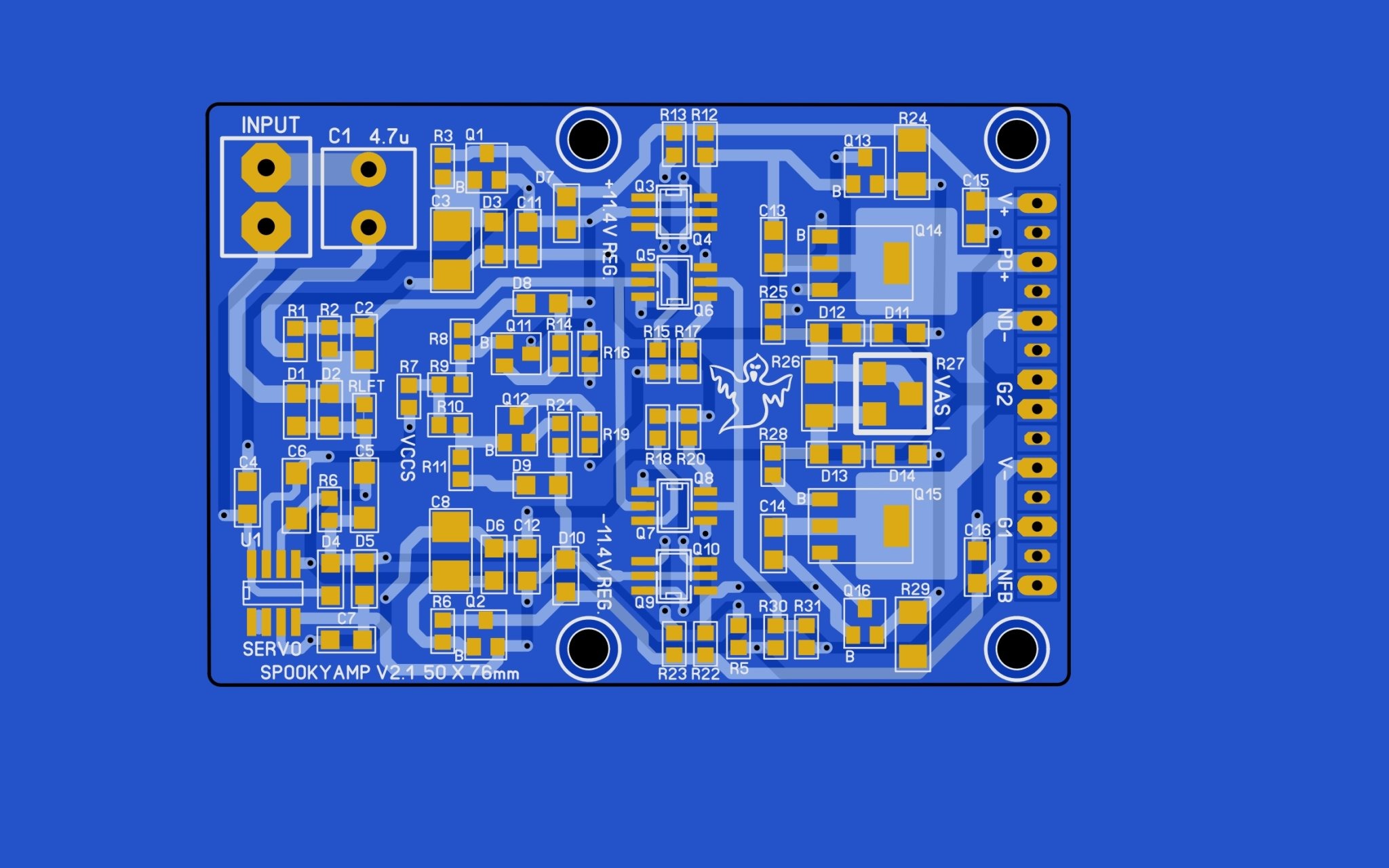

I glad I looked again last night .... ERRORS.
- redundant (R15/16) rail decoupling caps, made them C11/12 and removed 2 more. C4/7 + C9/10 might seem redundant but two are needed
close to the op-amp supply pins.
-I messed up Q7/8 - 9/10 , now all the SOP-6's are facing the same direction. Most SOP-6 packages have a slightly confusing BEC (216-543) clockwise pinout.
some (10%) are made for differentials , I chose what 90% of available common SOT-6's are.
I'm still checking traces from "spooky fixed" . Did creepage , marked all diode/led cathodes , and streamlined traces. Spooky schema is also updated.
OS

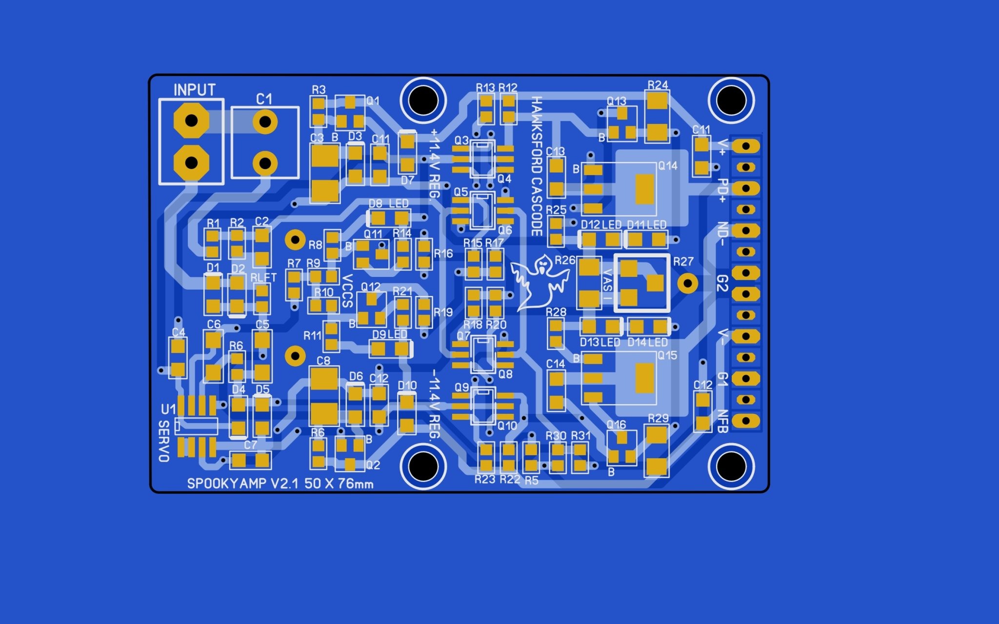

Good read , I think me and my builder went further and powered a Slewmaster big EF3 with it. Looks like they went through the same OLG/margin
spread as I did. I used a 3 device fancy current mirrror with the Hawksford , they went "basic".
This is the next IPS , will post the new "fancy" regulated version soon.
- the "EYESEE" , with the big through-hole DIP-8 sitting in the middle of a bunch of matched SMD pairs !!

Glift is exclusively for the input signal.
Given normal operation conditions, the difference between G1 and Glift will be low, there is only 2.2 ohm resistance between them.
R31 determines the fraction of the output signal used for NFB. R31 / (R31 + R32)
I thought the whole point of Rlift is to isolate ground loop noise. If the NFB takes G1 as reference, the ground loop noise on Rlift is superposed on the input signal and appears amplified on the output. If instead R31 returns to Glift, only the input signal is amplified and the ground loop noise gain is only 1. Or am I wrong?
Edit : Citation of Cordell's book, Ch.18 : "The negative feedback shunt resistor is returned to the input ground node" (Glift).
Thimios did some testing on different servo ground connections with a Spooky input if I recall correctly. I think he found a substantial improvement in distortion numbers with it connected to the lifted ground.
But that was with a normal servo. I ported my "VCCS' servo from the CFA amps. Regular servo's suck ! , as they approach F3 they degenerate FB
and make for increased LF THD. I noticed the improvement (VCCS way) on the original "hellraiser" = CFA-X.
OK , say you DID have ground issue with .65V (Rlift diode Vf). I ran ALL simulations -
1. - with servo and NFB at G1 = bad ! Output clipped with 1/2 Vcc DC at output .... ouch !
2. - with servo and NFB at Rlift = better. Output perfect and 1V DC offset . Servo can't compensate for this much DC at input.
3- with servo at G1 (speaker ground) and NFB at Rlift (.65V). Servo tries to compensate , gets down to .2V.
4 - NO servo = amp is a unity gain DC amplifier.
Simulation 3 wins for the least DC and 20hz THD (with a fault).
The Fault might never happen , but "might" still exists.
Spot on !! Unity gain for both noise and a fault.

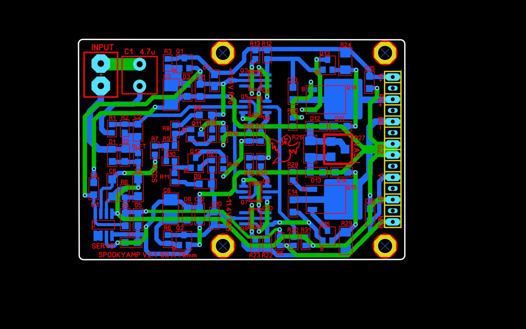

Fixed. Ran R31 through a "quiet" .6V LTP section right back to Rlift ground under the board. G1 and servo FB (R5)
also run through very "quiet" sections (under the board). FMBM5401/5551 's are the new LTP cascodes - good for 100V rails !
Creepage over 1mm in the VAS with soldermask and wide separation of the "tender" low voltage sections from NFB or VAS.
Wow ! I remember fussing over the Wolverine like this.
