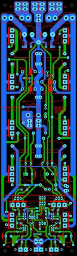

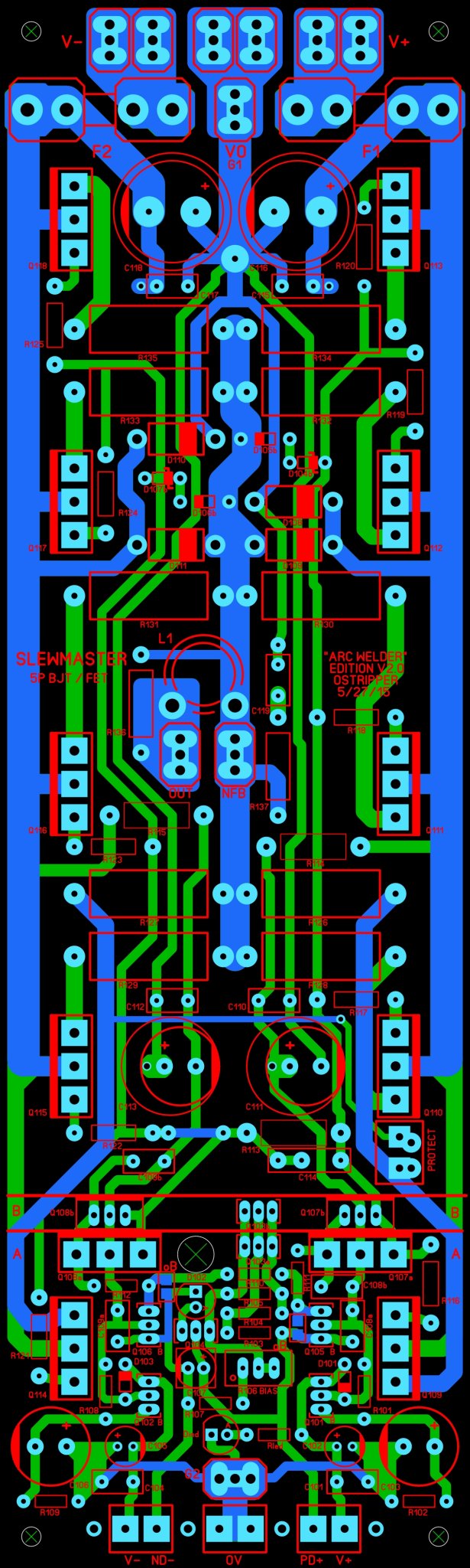

I'm going to resurrect the infamous "ARC WELDER' from slewmaster days.
6 pairs of BJT goodness !!! he he. I want a bigger amp than Fire animal'
Oh YEAH !
It will look like science fiction , with dual non-inductive thick film SMD emitter resistors and
massive cancelling rail traces.
I might make one pair of outputs to be the drivers (on the heatsink) - right in the middle ! , so 7 pair NJW0302/0281.

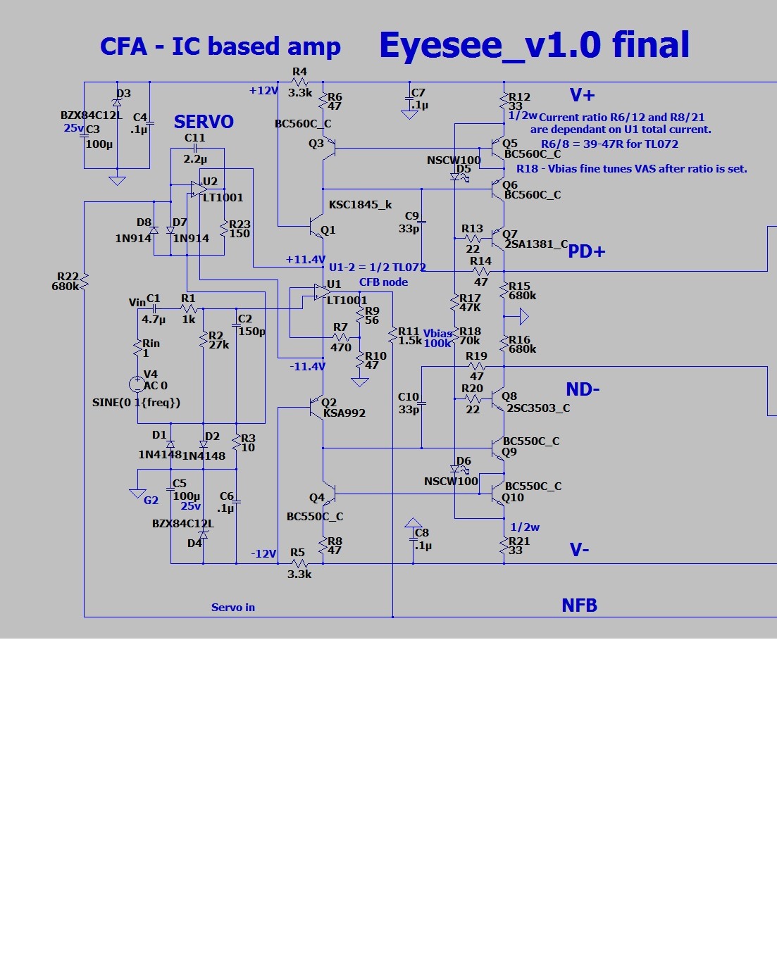

8 years ago , only one of my builders/testers made one of these input stages.
He "rolled" many a op-amp into this design. he finally tested an OPAxxx op-amp on it.
200+ V/us square waves and phenomenal sound came out - no magic smoke.
Such a strange design , adapted from some obscure corner of the internet.
I can see many refinements that I can incorporate now.
PS - he was listening to what a TL072 , NE5532 , or any other op-amp sounded like at 100 watts. crazy...
It servo's and plays audio leveraging the source/sink of a common $0 .70 cheap chip....

What's that mean ?? What if it's covered/ masked. I never did any board house business.I think if it's drawn as an uncovered via it becomes a pad.
I just want to know if I bake a dozen of these at a time if there will be any issues.

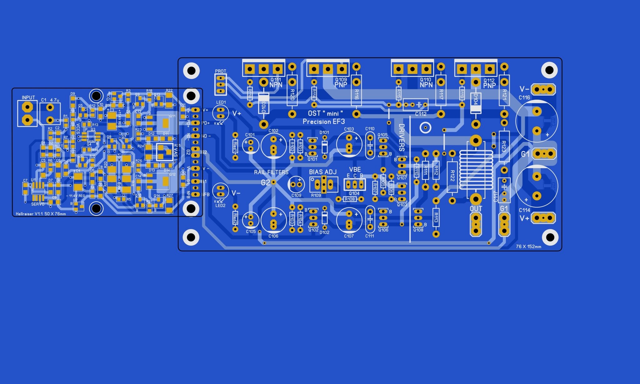

Not using a ground plane on the IPS ? you could make it 4 layer, middle layers are ground planes.Now for my "baby" - I love the spooky !!
This will be the finest artwork to date !!
Crazy , anal , symmetrical perfection. AND , I can use all matched pairs for it's "heart".
Os, I like how you design your amps, but some modesty will be nice.Now for my "baby" - I love the spooky !!

You select how you want the vias handles when you order the boards. If you select tented vias they will be covered in soldermask so they won't be an issue. Any vias drawn as uncovered are treated as pads and left uncovered. Normally the recommend keeping the vias 1mm away from pads. I've never had issues as long as they are off the pad and tented.
Ground planes aren't needed at audio frequency. 4 layer boards cost a lot more and slow down production time with no real benefit.Not using a ground plane on the IPS ? you could make it 4 layer, middle layers are ground planes.
ground planes .... I ain't designing no RF transmitter. I'll put a faraday cage around it !Not using a ground plane on the IPS ? you could make it 4 layer, middle layers are ground planes.
yes , 4 pads at the edges of the board one run to G2 star , solder a 50 X 75 mm copper plate over the whole thing.

Once you approach the middle of the audio band there is a transitioning from the path of least resistance to the path of least impedance, In fact there is very little reason not to use ground planes, its basic signal integrity 101.Ground planes aren't needed at audio frequency. 4 layer boards cost a lot more and slow down production time with no real benefit.
This is why we pay attention to positioning of ground traces. Route the feeds with returns. Keep loop area short. Power supply hum and noise is low frequency. Ground planes don't allow control of return paths of these currents. No way to steer them around sensitive parts of the circuit.Once you approach the middle of the audio band there is a transitioning from the path of least resistance to the path of least impedance, In fact there is very little reason not to use ground planes, its basic signal integrity 101.
