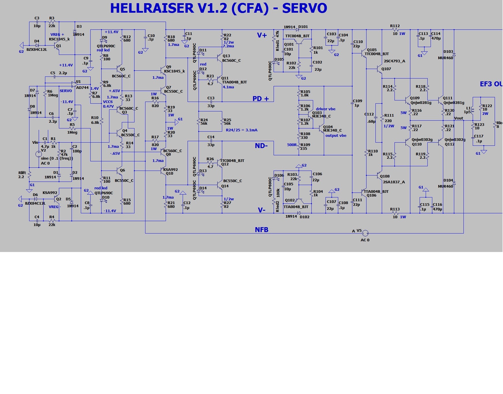

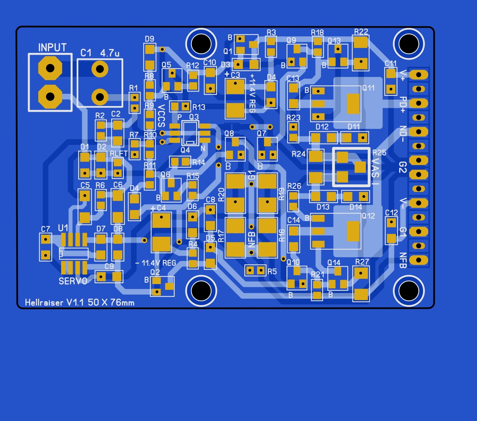

Oh , yeah . You showed that example. I see , your signal ground is my G1 and your cap ground is my G2. R9 goes to the signal gnd. and R0 is my Rlift
connecting to the cap gnd. (decoupling). your NFB takeoff point is also correct. What is your speaker ground ??
As I understand it , NFB is referenced between the takeoff point and the exact point of where the current from the loudspeaker returns to it's star path.
I have the Wolverine layout , but it is VFA.
Edit , here is the G1/G2 schema ... I added jumpers (solder bridges) to the IPS ground traces so you can connect to either "G"s.

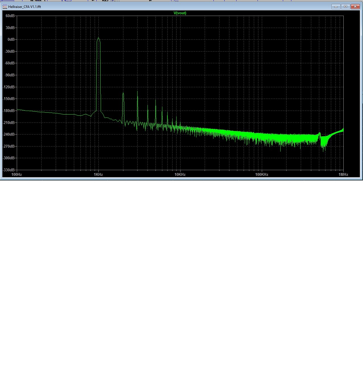

I want it to really perform as simulated ... below.
OS

I have two possible loudspeaker ground connections, one in the middle of the ground line, close to the loudspeaker output connection(by the way I do not put the output inductor on the board any more), and common power ground connection.
Have you seen my type of a compensation, I called it IOTPC, very suitable specially for CFA? Very stable.🙂
https://www.diyaudio.com/community/threads/oitpc-output-inclusive-tpc-not-tmc.317335/
I read that thread , I remember it was one of the first that sparked my interest in CFA FB. It would be rather easy to apply IOTPC to this Hellraiser.

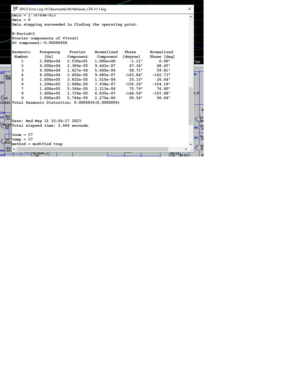

As you see , I'm not too bad without it (.0006% / 4R - 20Khz),
Next version ?? Hellraiser V2 ?
Just want to put some miles on this basic version , most would likely not notice 6PPM to .6PPM ?
Also , those SMD silver's are very expensive - would I spend +20 dollars for sub-PPM ??

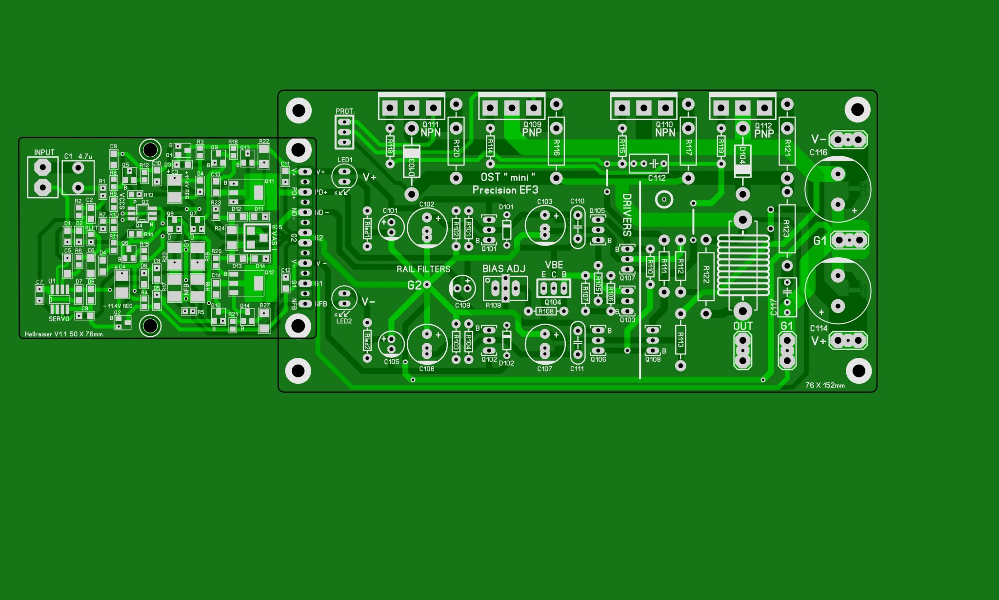

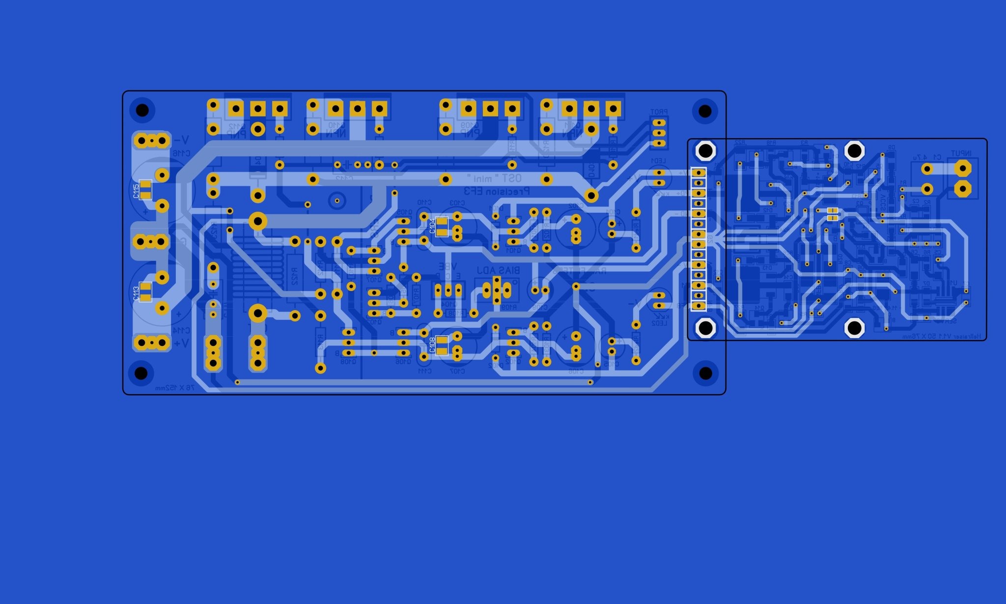

PS - next post it will be DONE ! My first SMD layout...

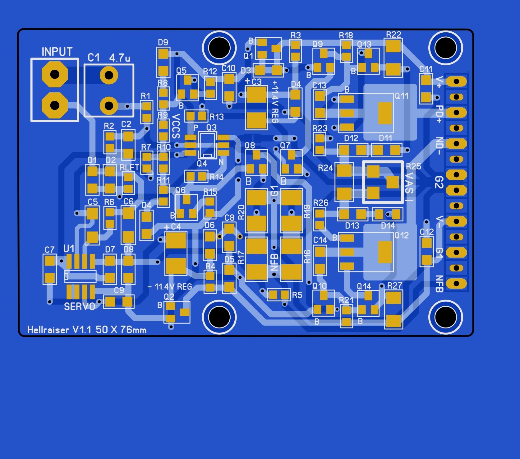

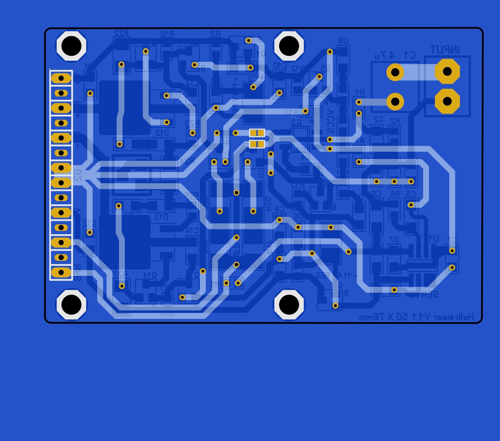

It's DONE ! Servo uses a dual (super cheap-.60c) BA4580 MSOP or SOIC-8. Ground one channel as a follower - all done .
Must OCD on the design and port the finished "blocks" to the spooky. The VAS,servo, and input is the same. The Spooky will
use 4 of those matched MSOP-6's for the cascodes/LTP's , easy.
3'nd pix is what a whole amp package will look like. 105W @ 8R and .003% worst case THD in a small package.
Power supply PCB and Spooky is next.

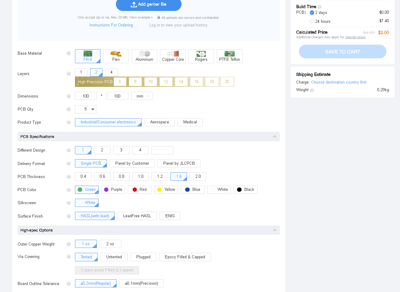

I was wondering that... thanks. Any ideas on how to get it done ?? ... you see how many I have. If I do have to relocate all them vias , how can i make them
soldermasked ??
Back to the drawing board. Wish i knew this a few days ago !!
OS
Is there a way to cover the via with soldermask ? I have seen this on PC and other SMD boards.
I assume (don't like doing that) if a board was "ovened" or wave soldered .... any via would still fill with solder even if it
was outside of a pad area..

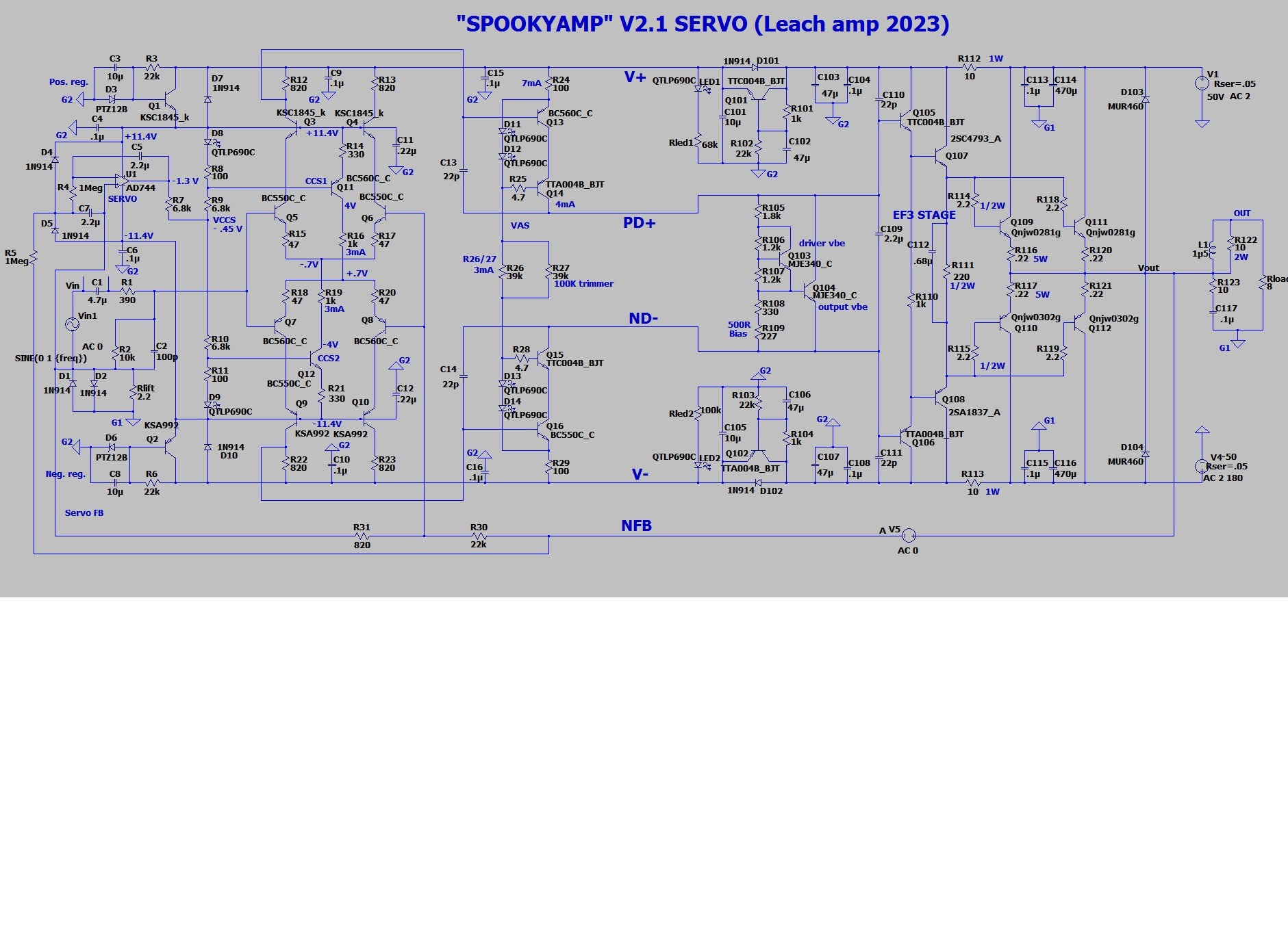

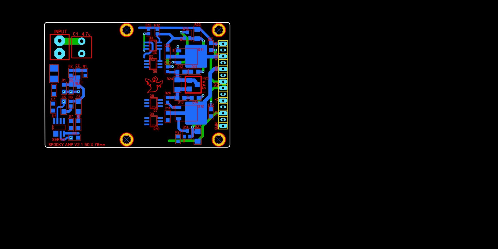

Now for my "baby" - I love the spooky !!
This will be the finest artwork to date !!
Crazy , anal , symmetrical perfection. AND , I can use all matched pairs for it's "heart".
