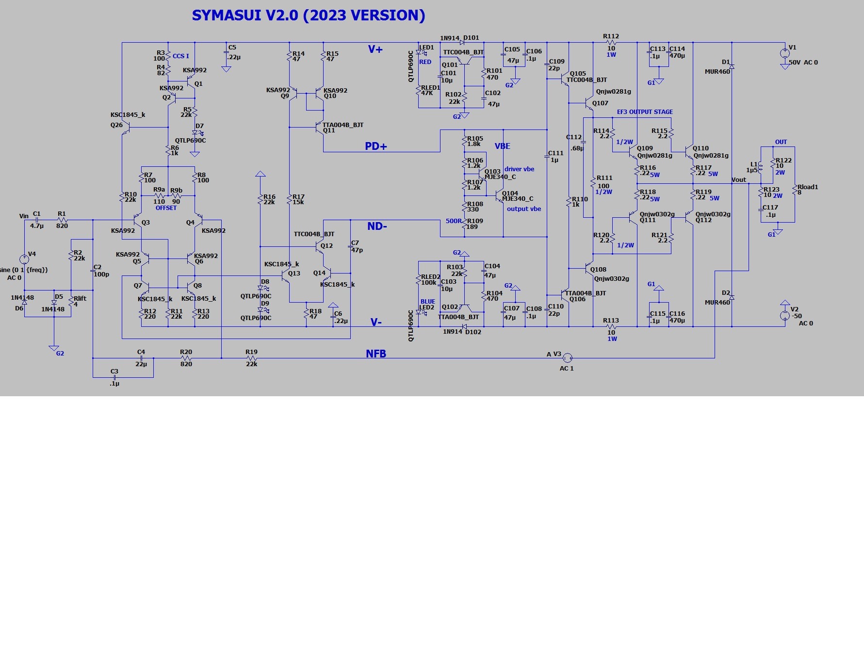

hi OS.
post 143 picture..., C7 connect to D5,
not the same with schematic and simulation from post 1
I got it ! Updated the first post Spooky schema. PCB was right , schema had C6 -7 swapped. Thanks !post 143 picture..., C7 connect to D5,
I also forgot the supply cap labels and the VAS led labels. I will also update the artwork.
I will add a ZIP file of the choice parts I used - PDF's in zip file.
1. FMBM5551/5401 SOT-6 cascodes.
2. BC807/817 dual SOT-6 LTP's
3. 2SC3649-SA1419 TO-243 SMD for VAS.
Look those packages over well , it was hard to route Q3,4,5,6 + Q7,8,9,10 !!!
OS
Can't see it on the PCB but on the schematics you decided finally to attach the servo reference to Glift instead of G1 ?
Since this servo is incapable of hugely DC'ing the amp and is not affecting either LTP input , I might make the choice of servo reference an optionCan't see it on the PCB but on the schematics you decided finally to attach the servo reference to Glift instead of G1 ?
on both boards.

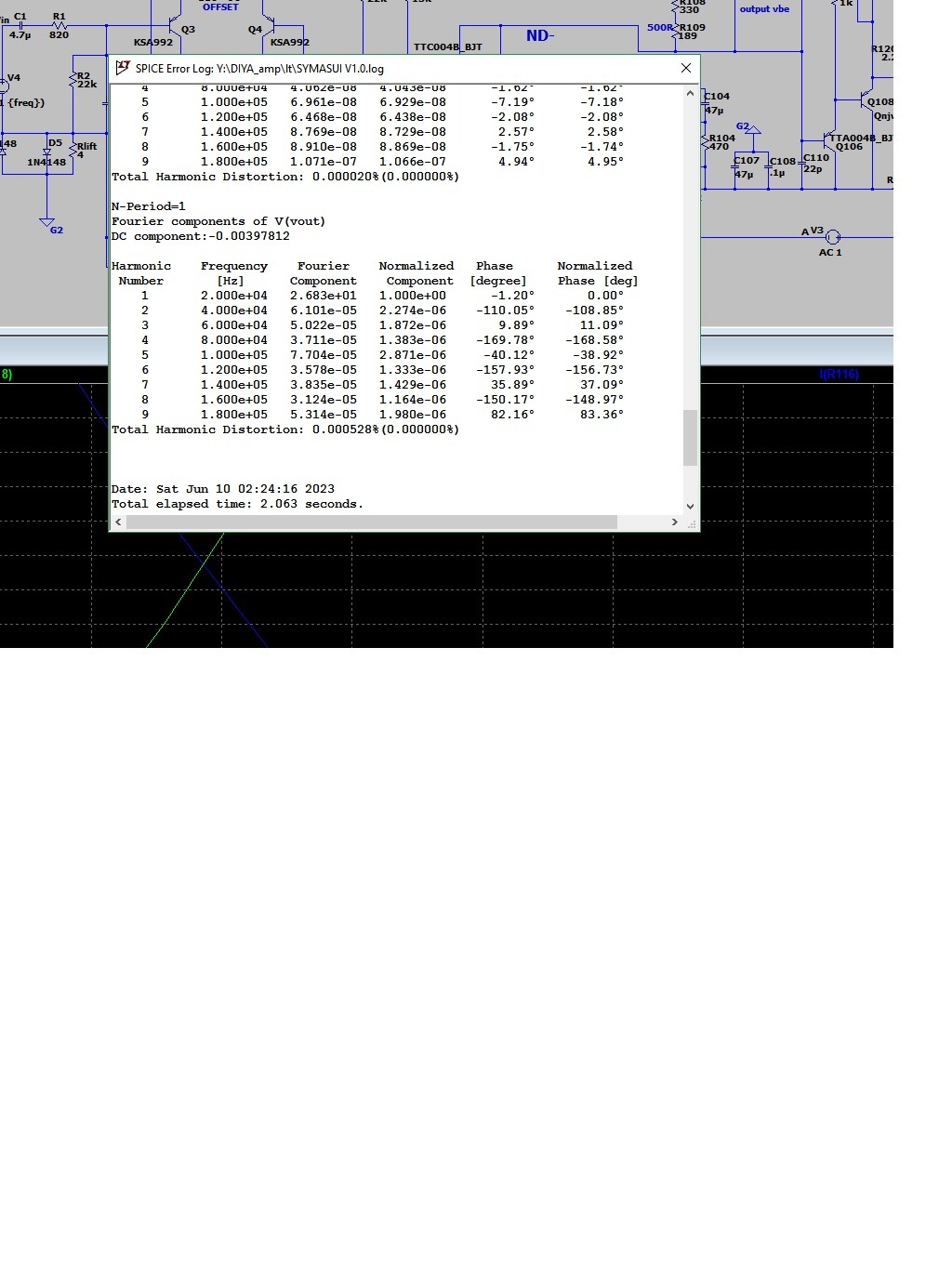

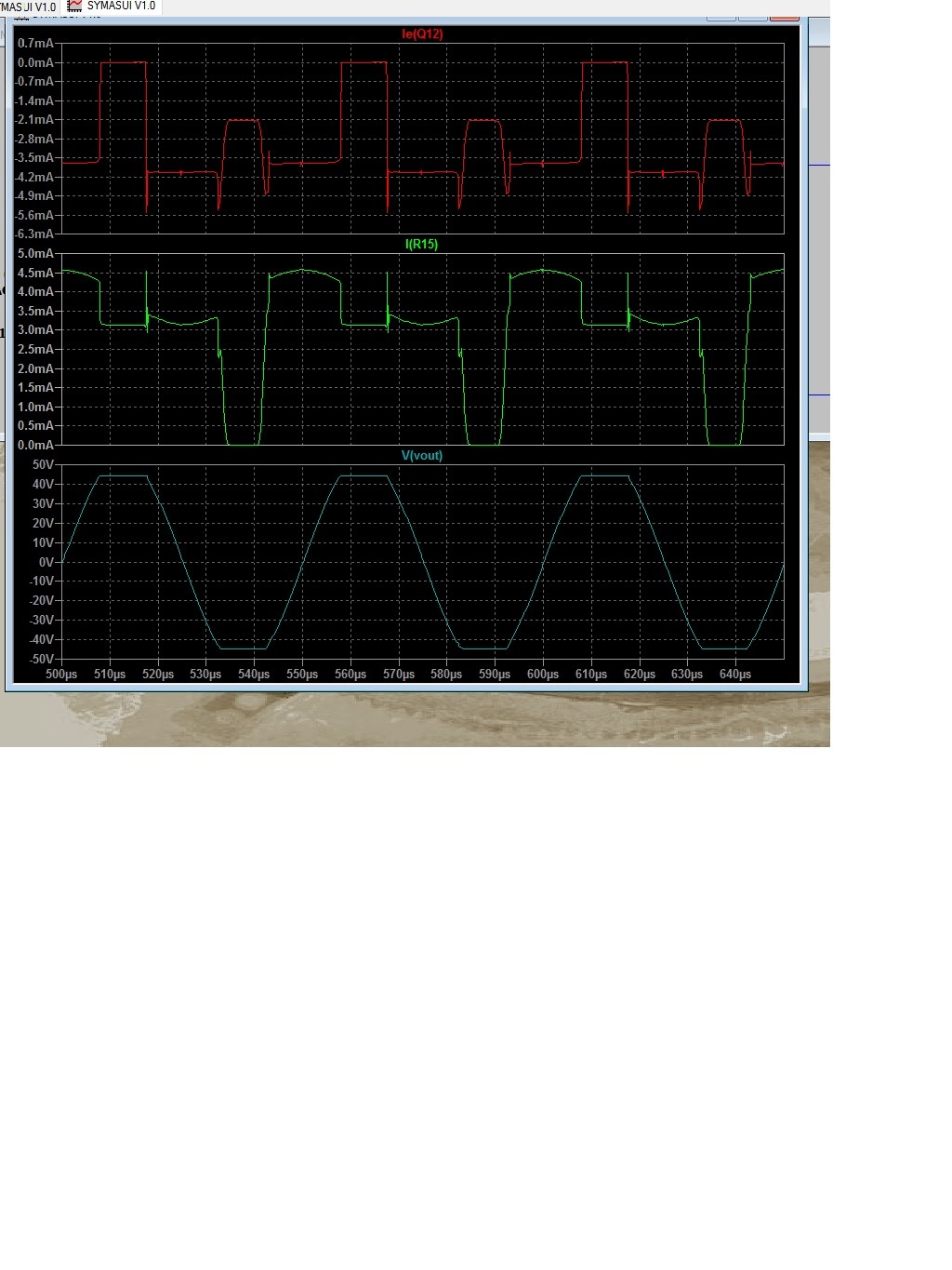

One more test , (below) .... the Symasui self clamps with no saturation at clip . 5ppm is nice , but I want "bombproof".
A tiny bit of sticking with the minimum of ringing when the the semi clamps. Does not have the Wolverine issue ,
does not need any diode in the VAS. Cascode LED's would flash on this one , too ! Easy to implement clip detection.
Matched SMD mirrors, LTP's . and cascodes should make for a snappy amp !!

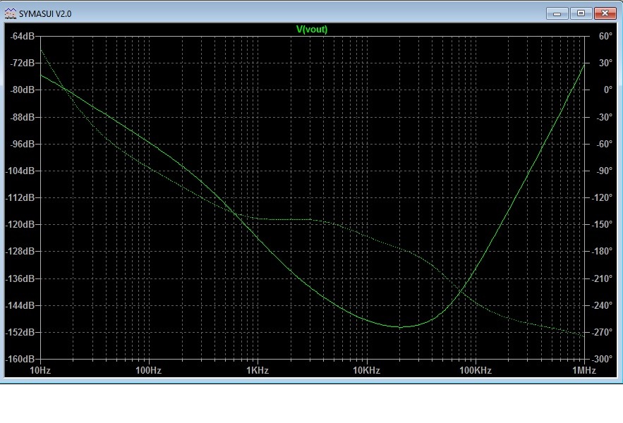

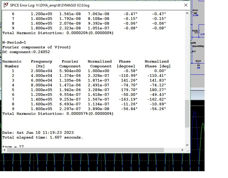

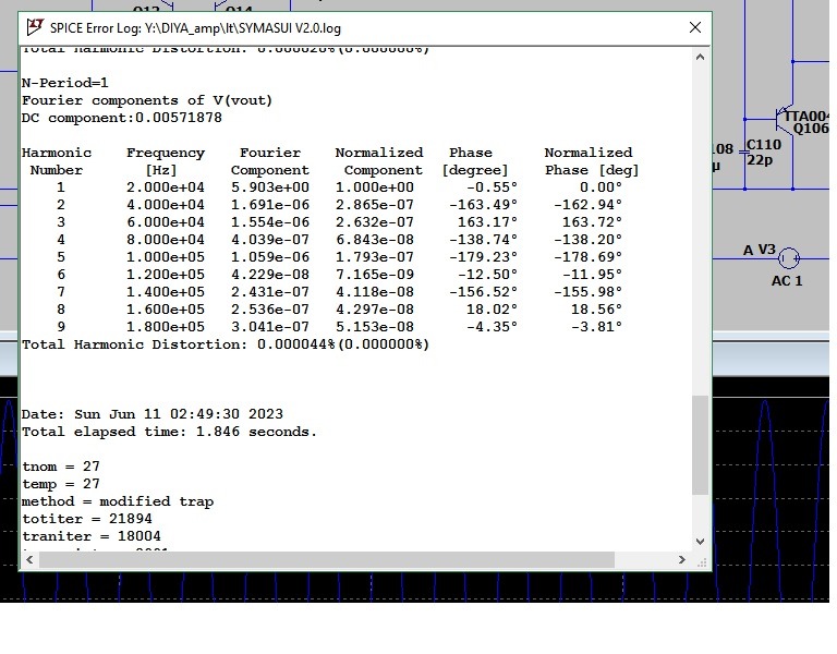

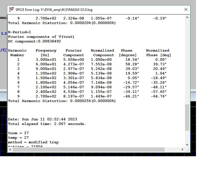

2 -pole is the way ! (below)
.2ppm Vin plus .5ppm Vout is .3ppm 20khz.
lower levels = 0 ??
Added a back-end VAS cascode for more balance. Hmmm , this amp does not have mega LF OLG but what it does have
extends out to 100K ! different bode response than my other designs.
PS - I even changed semi's (BCxxx) and loaded down to 3R , still <1ppm ... cool.

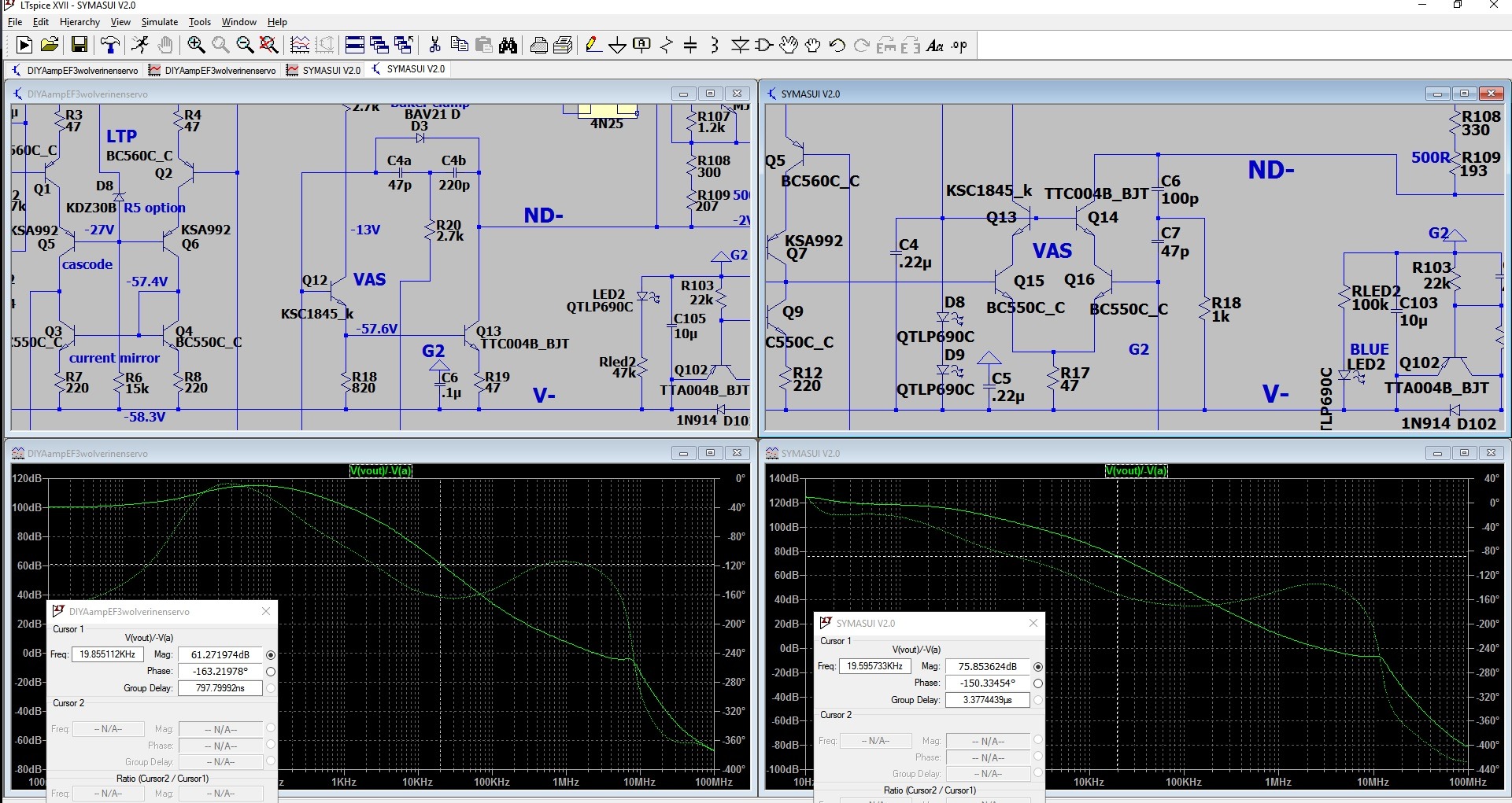

F the "Wolverine".
Pushing two pole to the edge , with lots of margin.
I get 75db gain at 20Khz vs. 61db on the wolverine.
- I still retained just 2 stages , "Catharsis" 3- stage amp gets 80-90db-20Khz , who cares.
-Simple , 1 VAS cascode ... which now also is smoothed by the backend of the single 2Q CCS - NO ground reference. PSRR should be stellar.
Ohhh ! it is above 1K , just drops out of site. Avoiding ground has it's advantages.
Yup - 4 BC807/817 SSOT duals , and 2 FMBM5401 duals SSOT , 3 single SOT23. No servo. 20 resistors. simple but powerful.
You could classify this as a Wolverine with a superior VAS = 12-15db more OLG @ 20Khz. I'll also be using better parts !!

Wow , I can get 80+ db 20Khz and .2ppm , Wolverine on steroids.
I must thank the "catharsis" poster for triggering me to resurrect this topology.
I'm floored by a design that LT shows as NO distortion ... WTF !
Is it a glitch ? Wolverine performed as simulated , even better ?
It has to be the extreme native balance of the base circuit. this one , you
are DIRECTLY listening to the primary LTP. It is so connected to the VAS - unreal.
VAS currents are nanoamp difference- a perfect VAS ,no distortion. Without a 3'rd stage.
Modern semi's can do 50k gain with just 2 stages.
Sick THD , level 3 !!

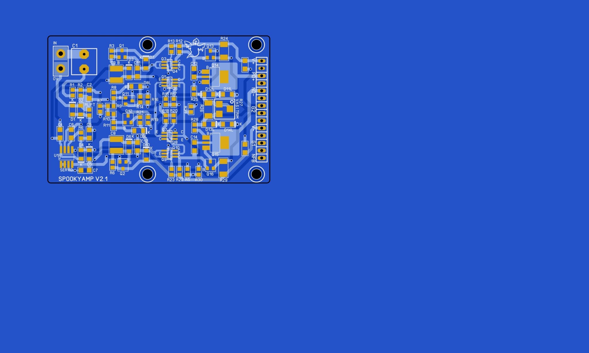

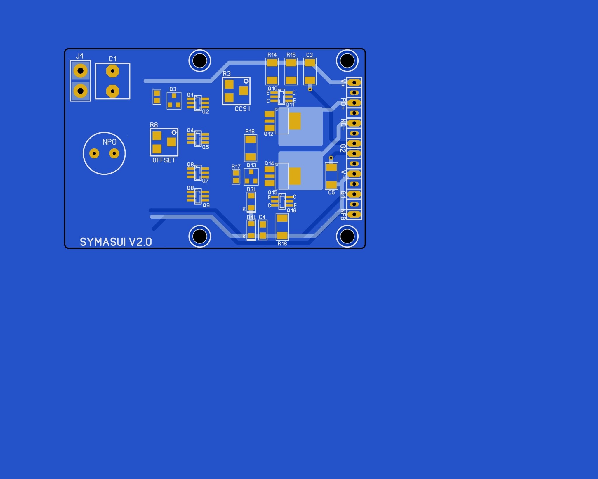

Speaking for smd Spooky.We need some advice like smd resistors,caps case style and type.
Is it someone working on a Mouser bom?
1/2W =1206 1/8w = 0805 . caps 0603 or bigger , I made monster pads for 22uF ones.Speaking for smd Spooky.We need some advice like smd resistors,caps case style and type.
OS

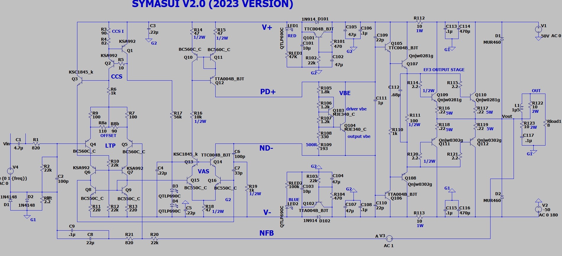

Thanks Pete,but i can't see resistors watt range at the schematic diagram.🤔
Does it mean that R21,R26=1/2W and all other resistors are 1/8W?
I'm going to further embellish the IPS schematics with the next update. Yes , 21/26 hellraiser , 24/29 spook , and 14/15/16/18 on Symasui. (below)Thanks Pete,but i can't see resistors watt range at the schematic diagram.🤔
You will see the much larger 1206 pads for them.
You built the V1.0 Symasui , can't believe I did not add the current mirror - totally different beast now.
Symasui 2.0 will be both through-hole and SMD - 2 versions. It's that good !
