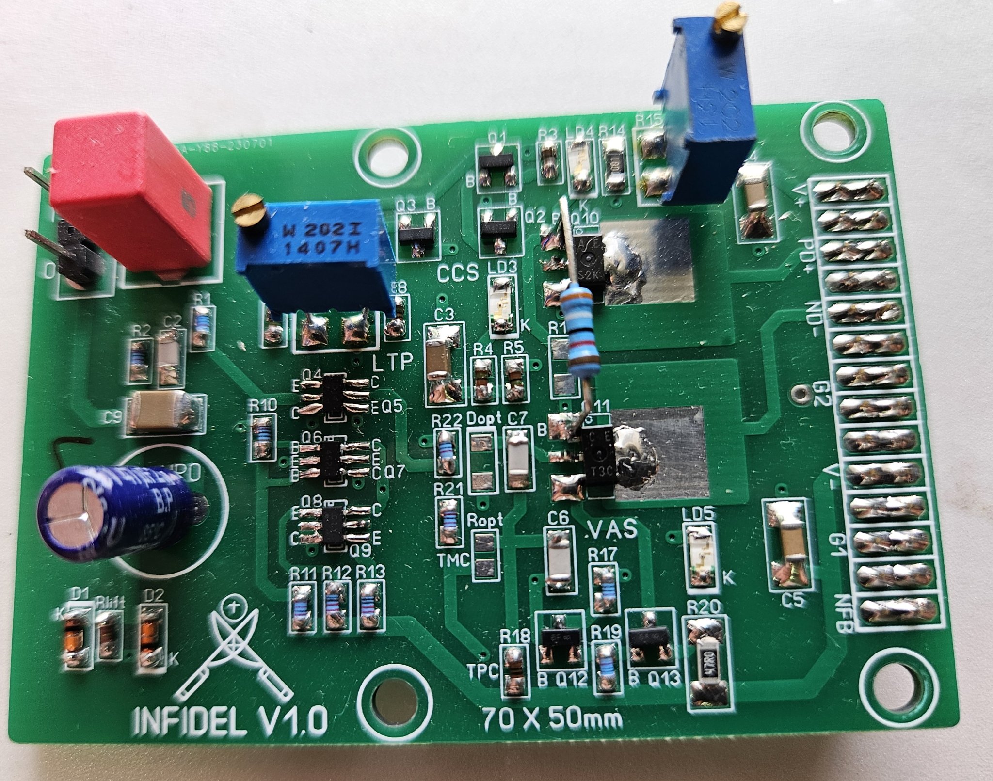

You should be fine using the spooky BOM, the transistors between the various boards are essentially the same, only the topology being different.
With no proper schematics and BOM can make it difficult for someone to gather enough information to populate the board.

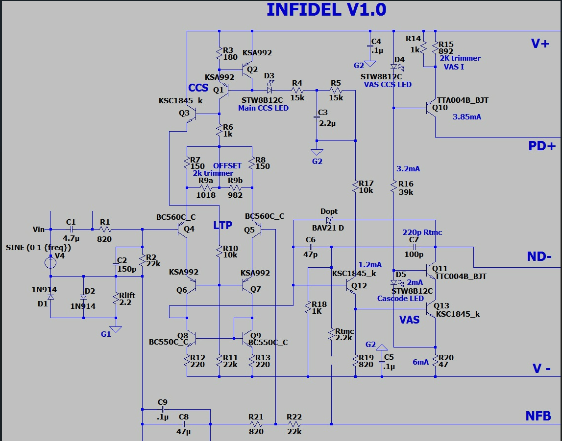

It looks like Q6/Q7 footprint is odd. Normally dual transistors have the bases on pin 2 and pin 5.
Ok I found what I used for infidel.
Q1 Q2 fjv992
Q3 Q12 Q13 fjv1845
Q4 Q5 HN1A01F dual
Q6 Q7 FMBM5401 dual
Q8 Q9 HN1C01F dual
Q10 2sa1419
Q11 2sc3649
Fmbm5401 has emiter in the middle.
There is also silk screen error r21 and r22 see post #659.

Thanks for the transistor list, extremely helpful.
As for the rest of the components caps and resistors I have a few questions,
With the capacitors I was thinking C4,C5 and C9 these https://www.mouser.co.uk/ProductDetail/KEMET/C1206C104K1RAC7867?qs=HwP6sGvP66Zs23oA/PYFtg==
Capacitor C3 this one https://www.mouser.co.uk/ProductDetail/KYOCERA-AVX/12063C225K4Z2A?qs=U/DGNQcZ28qtz%2BVpOZ%2Bu2Q==
C6 and C7 this type https://www.mouser.co.uk/ProductDetail/Vishay-Vitramon/VJ1206A101JXEAT?qs=RFK7ThnmtPvk1pY6DbPviw==
Which type would be the best to use for C2?
What wattage of resistors would be used? I've noticed the Spooky Bom specs 1/8w ones? As the pads for R20 is larger would this be higher wattage?

I bought from mouser and element14 and used whatever they have to offer.
For C
C3 C4 C5 C9 = x7r type your choices are fine.
C2 C6 C7 C0G type
For R
Small pad
I use mix of 0805 thin film and 0102 MELF. 0102 MELF type has higher wattage. You can find cheaper house brand from element 14.
Big pad I use 0204 MELF you can use 1206 film type.

I builted it but didn't work. I am not going to blame PCB just yet because I don't have time to debug it. It might be my fault somehow. I just leave it and do something else.
I'm curious if the red LEDs in the input stage are causing your issues. It looks like the current drops to about half through the input stage in simulation with red LEDs.

Infidel v1.0 gerber is on the first page. I don't think there is another version. Apart from silkscreen error, see#659, it works.
