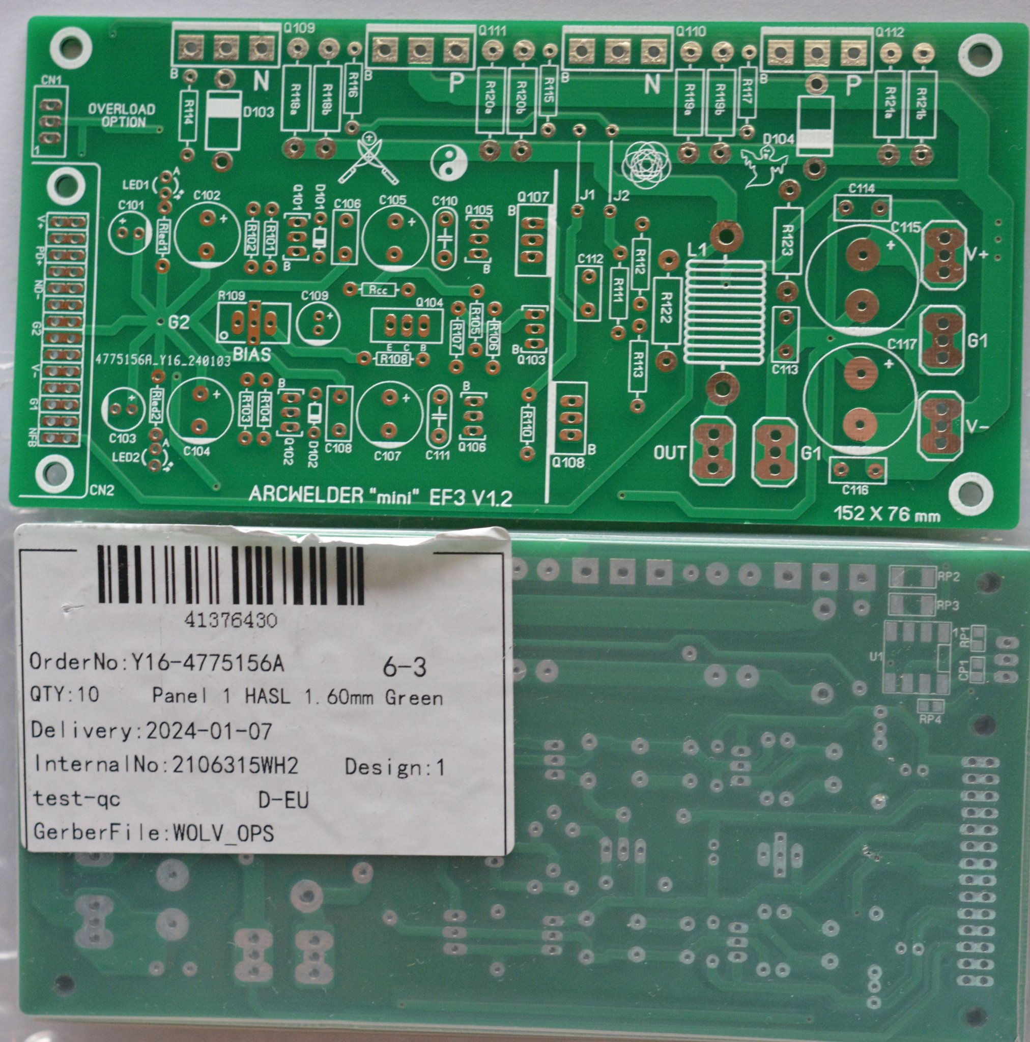

if anyone is interested i have 4 or 6 boards to resell (depending on how many will use myself) at cost of manufacturing + shipping+taxes.
arcwelder mini is HASL finish and 2oz copper; Spookyamp IPS is 1oz copper and ENIG finish

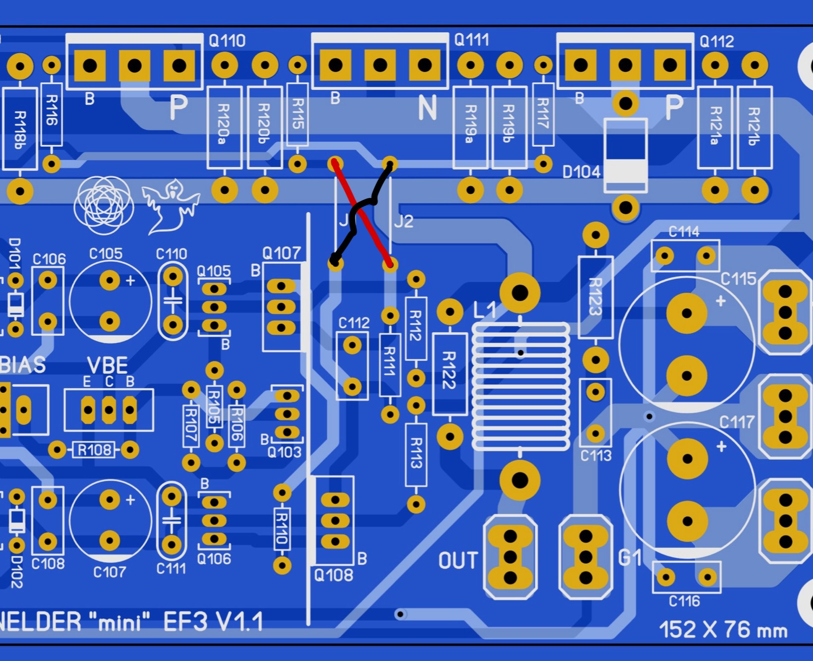

Make sure you crossover J1 and J2 , even on those "mini" boards. Those still have that embarrassing small error. Current V1.2 does not.
Since the spooks and hellraisers are relatively complicated , they should be spot on , I stared ,probed ,and triple checked them many times.

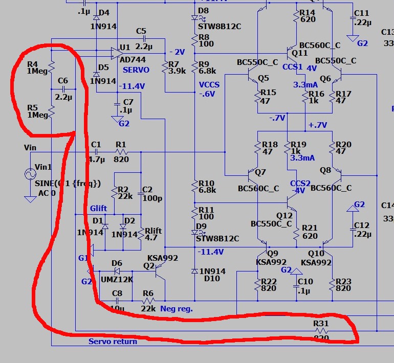

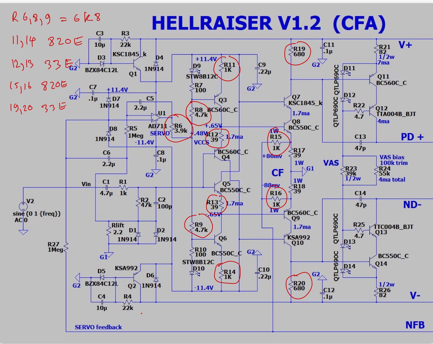

I have a questions regarding Hellraiser PCB and BOM.
There are discrepancies between BOM and Schematic, see picture, resistors in red are those that different from BOM. Should I follow BOM or schematic? (BOM itself is not complete.)

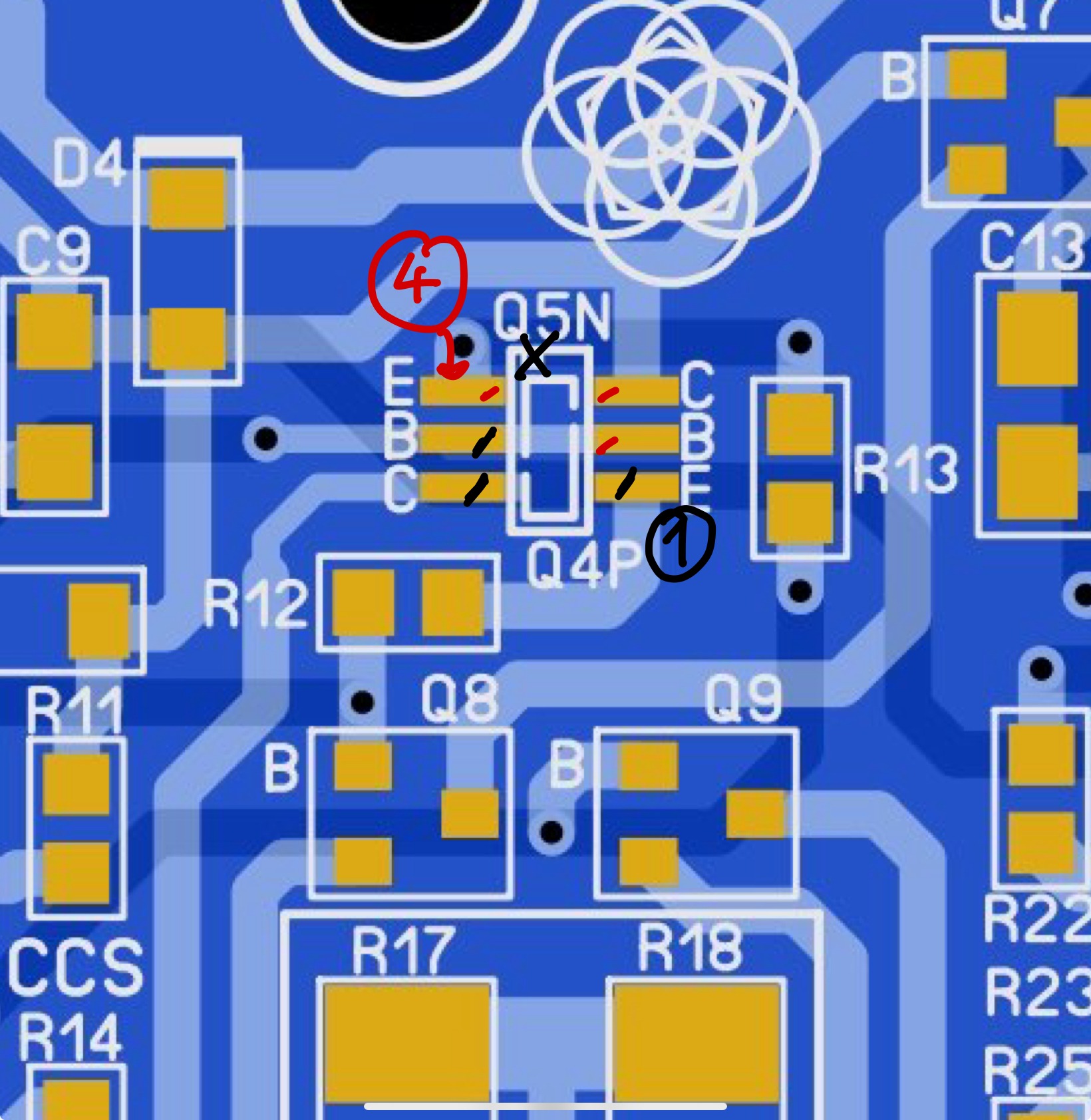

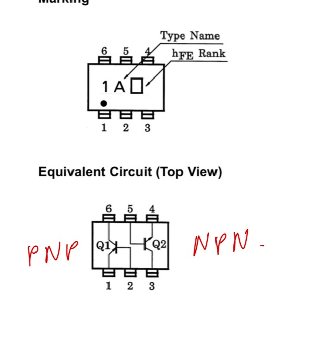

Another thing is I think there is a silkscreen error on q4 and q5. Pin 1 of HN1B01F should be rotates. See picture below.
Not bad , just flipped around. But it's still an error.
39R/1K (28.5X) determines the global gain of the amp , 33R/820R would be 26X.
R6/R8/R9 determine how hard the servo works to zero the offset. My sim uses 6.8K for all. Red LED Vf is more sensitive to voltage changes
at <1.5mA. This is better , since we are leveraging this to make the CCS's voltage controlled.
Circuit should work even with even far different values , these discrepancies just "tweak" it for perfection.
If these are built .... the SMD toshiba's might need "tweaking" ,as I use BCxxx for models...

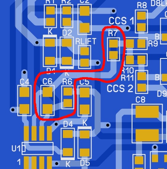

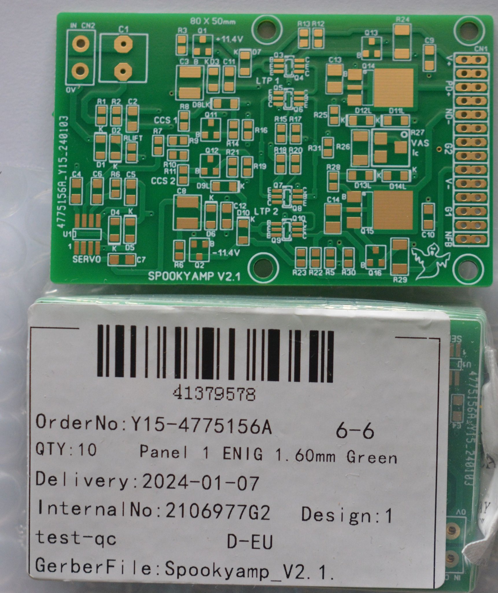

In the Spookyamp_V2.1_SMD_package the schematic and pcb do not match. For instance C6 is connected to R7 and R6 in the PCB, the schematic shows a
connection to R4/R5 and R31. Does anybody know, whats wrong here?

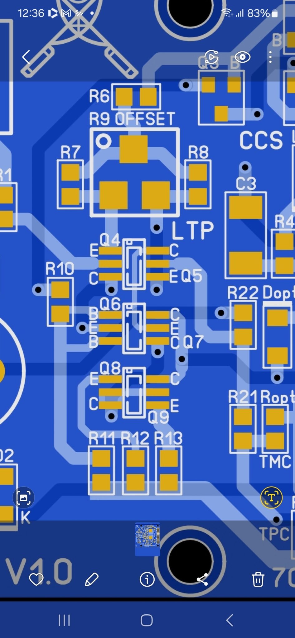

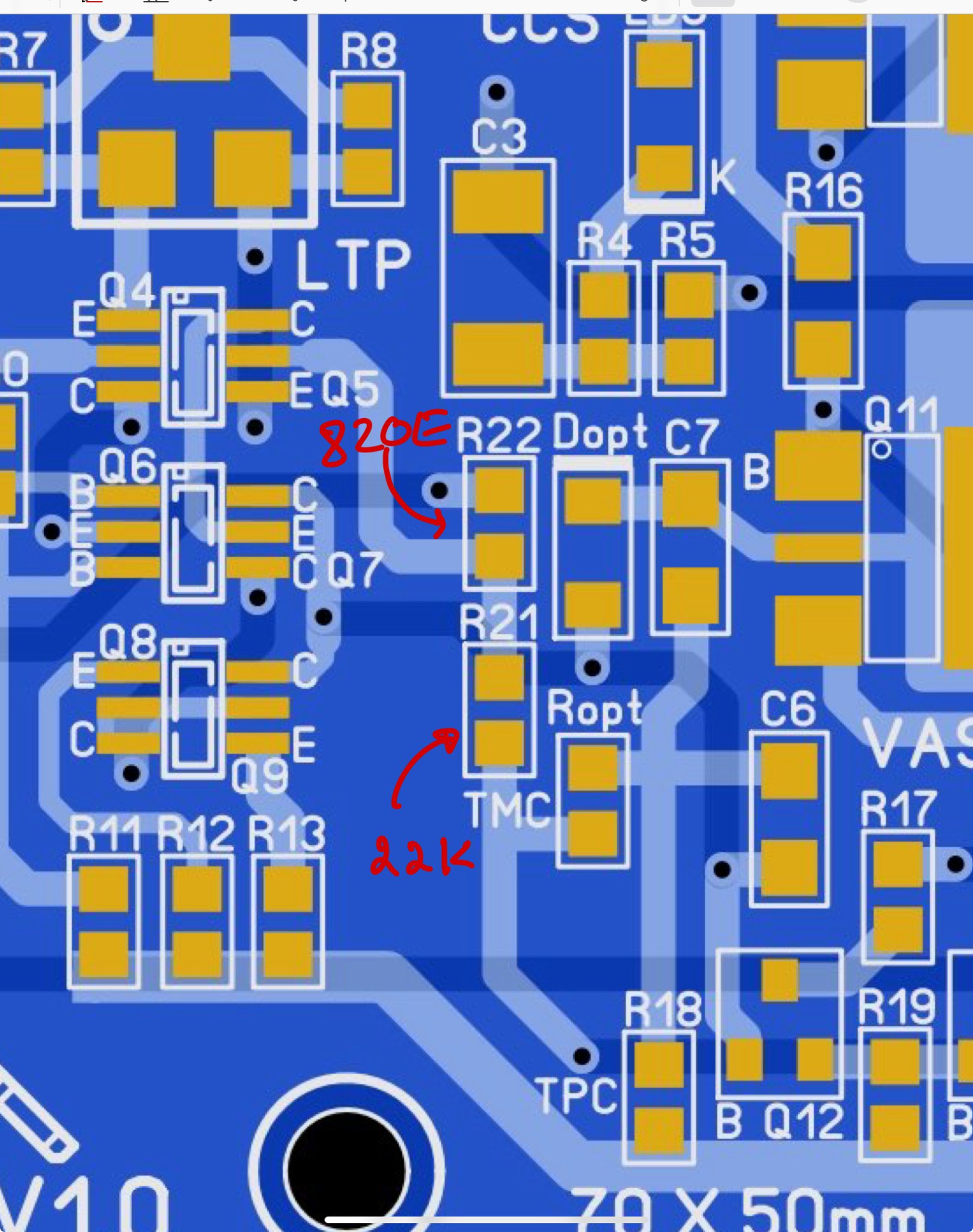

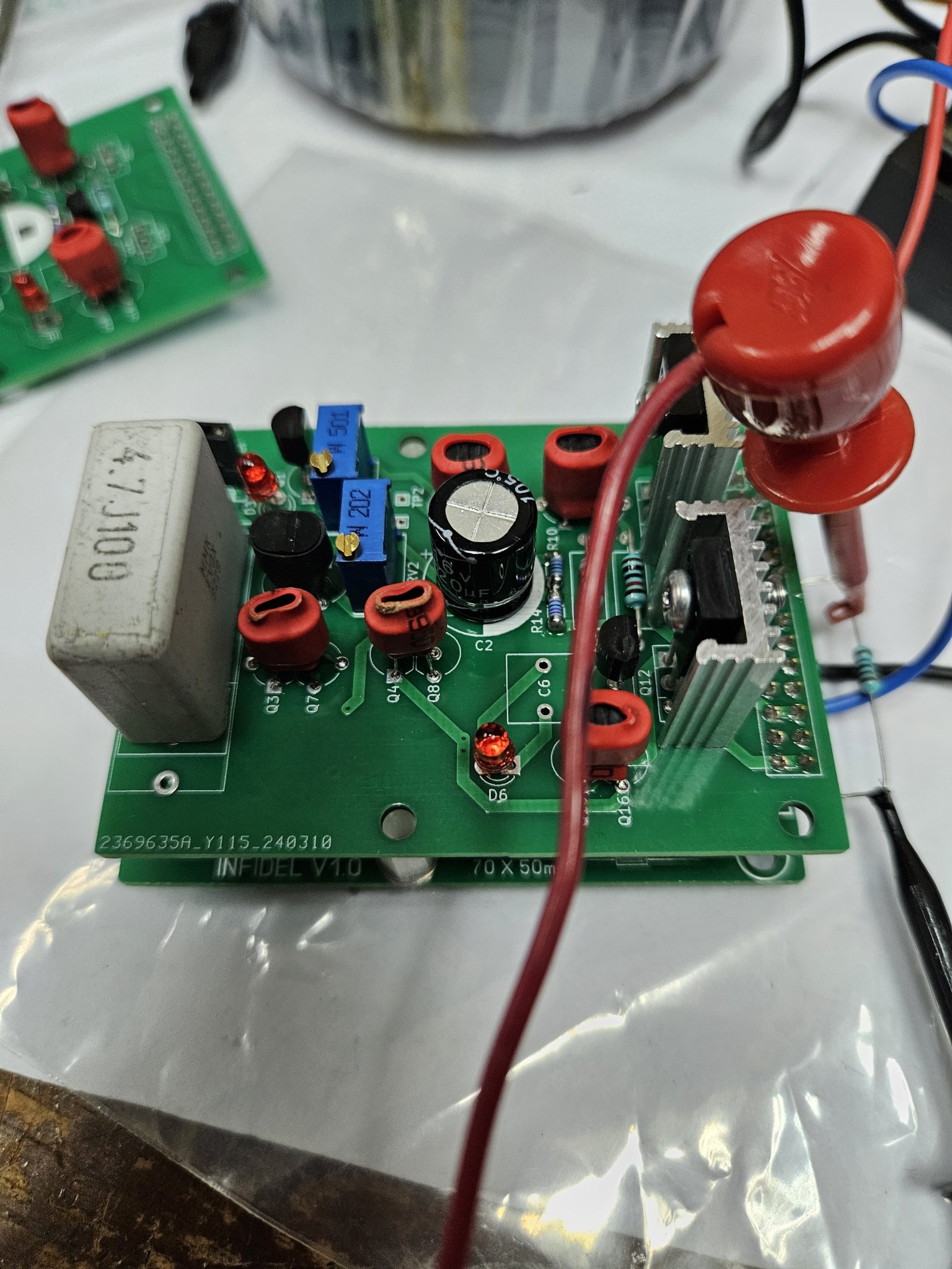

Here is my build, OPS is mini ef3 version 1.1. Schematic value except re=0E33 and output vbe is ksc2690. There is one issue with this board, you must cross between j1 and j2 see picture below.
IPS is infidel v1.0 all value follow schematic with one issue on silkscreen, at r21 use 22k and at r22 use 820E, see picture below.
Offset is rock-solid stay at almost 0mv. I have a bit of problem with mje340 as an output vbe, bias jump up sometime, change to ksc2690 solved that.
VAS current is set by dial r14. I have v=1.2v across r14//r15. I set r14 so that r14//r15 is around 320E.
SMD trimmer is expensive compare to chinese made trimmer, it’s on ips so you can easily change it later.
