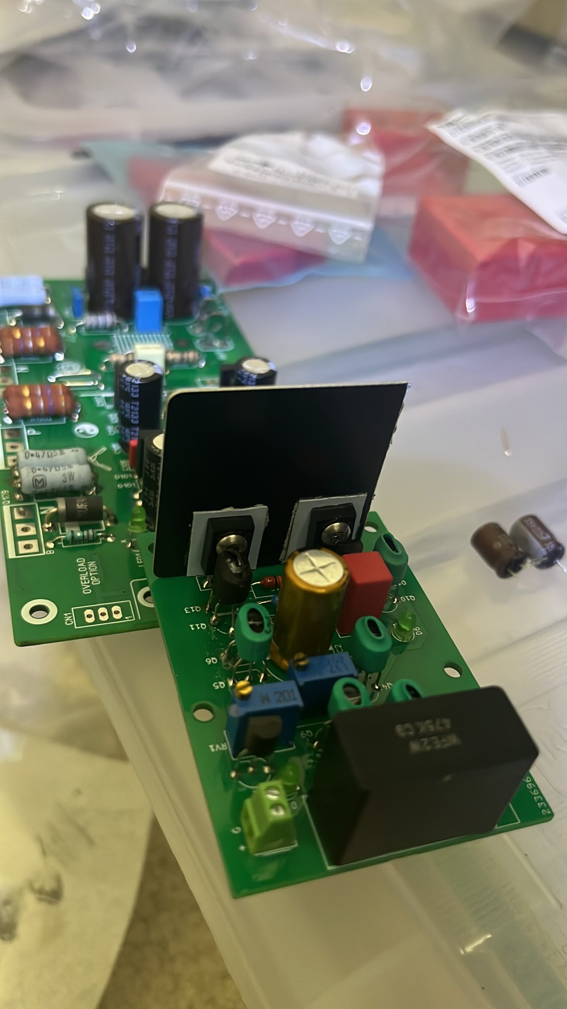

Does the Q104 transistor need to be put on a heat sink as is what I could see in one of the builds with extended wiring?View attachment 1268131

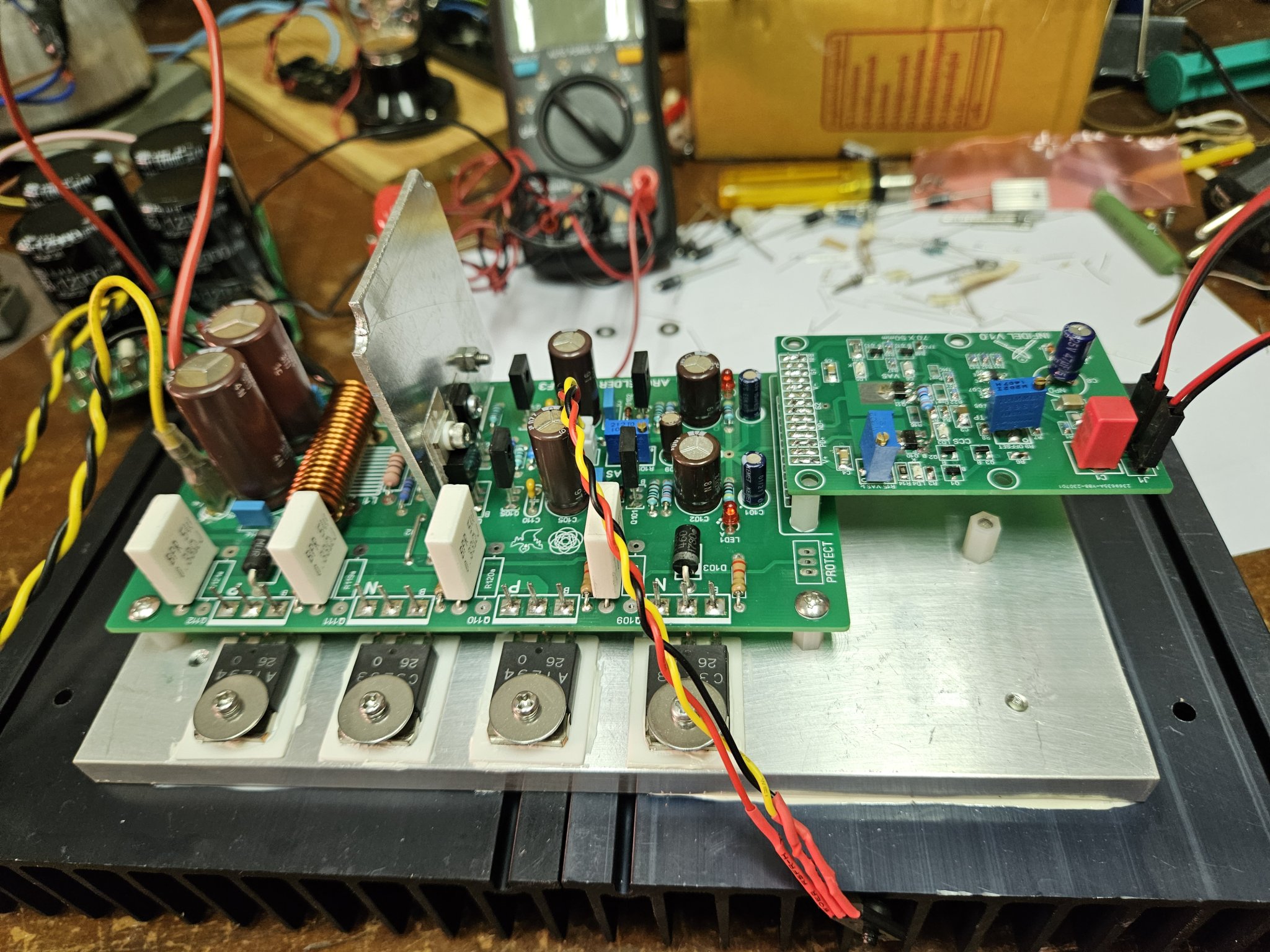

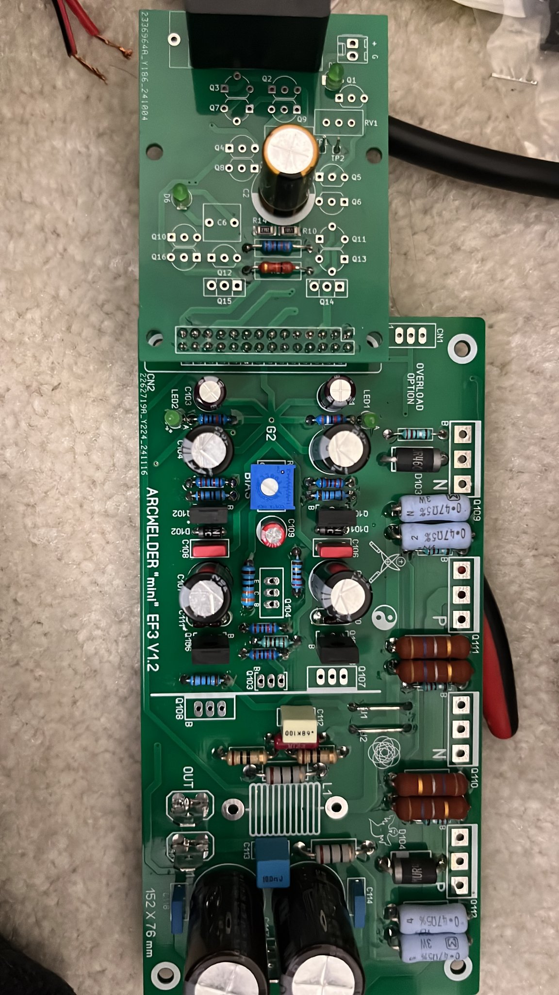

I assembly it, ips is infidel light bulb test is ok however I cannot set bias, no current flow through output transitors. Can we test ops and ips separately?
Anyone @chat72 who built this amp successfully can chime in before I finish soldering my boards. Also I am planning to use MJL3281A and MJL1302 transistors as I have few spares with me instead of the TTC/TTA from the BOM.Does the Q104 transistor need to be put on a heat sink as is what I could see in one of the builds with extended wiring?
Thanks @jwilhelm for the confirmation, any idea about the usage of MJL transistors?Q104 does need to be mounted on the main heatsink.

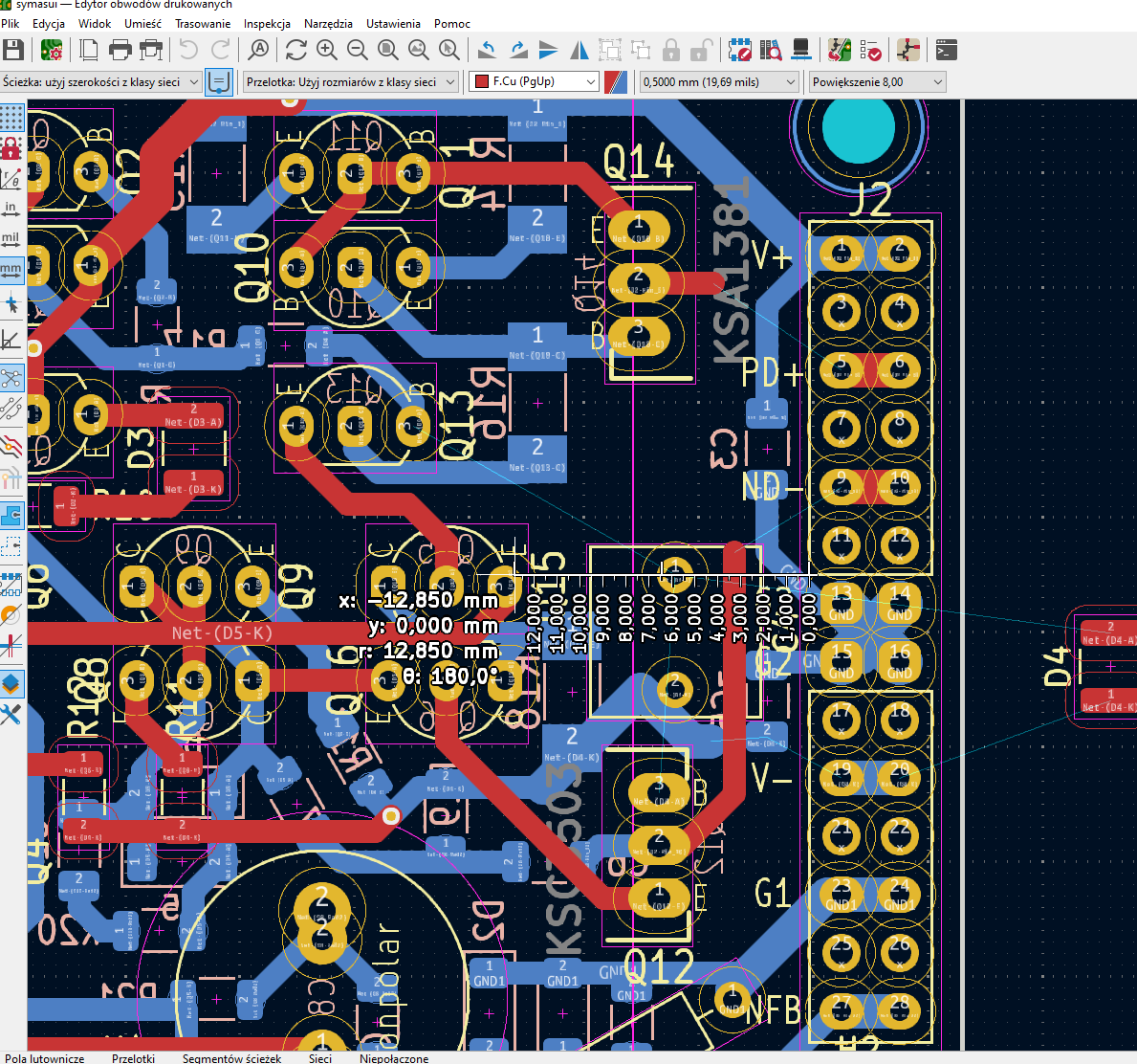

I have a request for symasui PCB which I made it myself using schematic in post 590, here is zip file containing Kicad and Gerber. I build it and test it, it runs OK with no problem but I did not use oscilloscope to probe it.

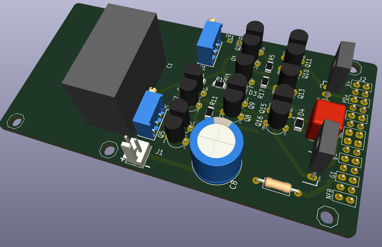

below is "my iteration" of SYMASUY layout. it's based on chat72 work. i've added BOM and made new layout (for my liking).
i'll be ordering PCBs soon, so i you spot any issues pls let me know;
not sure about C6/C7/C10 capacitors, i'm using c0g type, but shouldn't i use MIKA ones? for C4 PET type, maybe x7r would be better option?
track width is another story ... but will see what you think about that 🙂
holes layout allows mounting on Wolverine OPS boards
