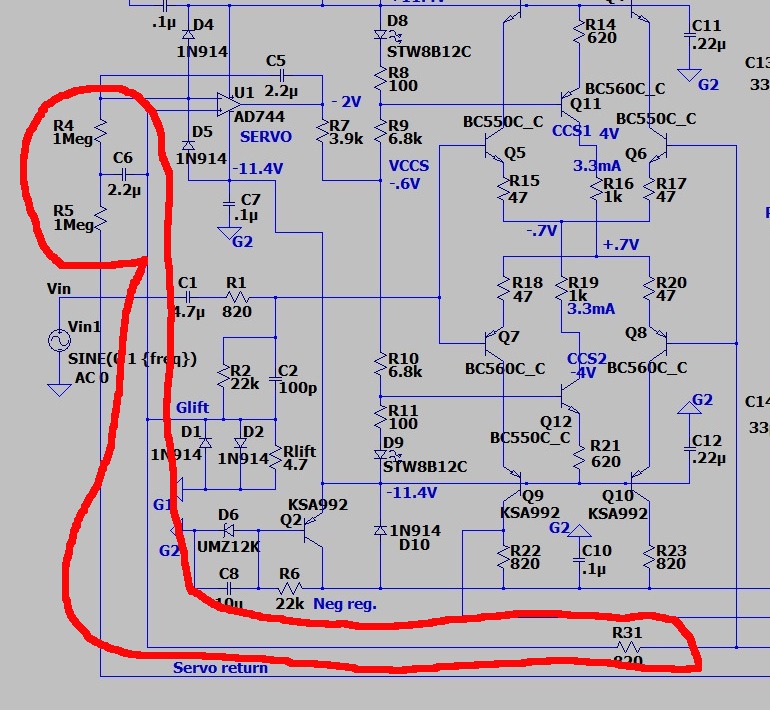

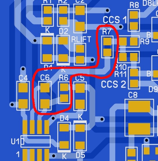

So far only one messsage about an non sucessfully build of the Hellraiser🙁.
In the Spookyamp_V2.1_SMD_package the schematic and pcb do not match. For instance C6 is connected to R7 and R6 in the PCB, the schematic shows a
connection to R4/R5 and R31. Does anybody know, whats wrong here?
View attachment 1326449View attachment 1326446
hi,
did anyone tested spook? schematics seems to be not in line with gerbers,
f.e. D4/D5 should not be connected with R6 (is it R4 actually?) but also shouldn't be connected with R5
R7 is not connected with C5
TLP062 has output on pin7
probably we have wrong revision of schematics 🙂

Question on Spooky BOM: R7 is shown with 6.8k parts in BOM, but is a 3.9k on schematic? R14/R21 on the BOM are 390r, but schematic shows 620r parts? R24/R29 are 100r 1/8w in BOM, but 82r and 1/2w on schematic, not as concerned with the value as the wattage. Finally R26 is a 1/8w on BOM, but a 1/2w on schematic anyone know which is correct so it doesn't burn?
R7 should be 3.9K, 6.8K increases the output in the opamp which increases the power dissipation in Q1/Q2.
R14/R21 value should be 390R, this sets the current in the CCS to approx 3-3.3mA through R16/R19.
R24/R29 should be 82R, wattage not that critical as its only dissipating 5mW, so 1/4W is okay.
R26 should be 1/2 Watt.
In addition to this, Spooky has a few design quirks:
- Q1/Q2 will run quiet hot if using a +/-50Vdc power supply (+/-45Vdc at IPS via Output stage). This limits to using the Mini EF3 OPS at max 50Vdc Rails. Running the power supply beyond 50Vdc will most likely cause Q1/Q2 to prematurely fail due to excessive temperatures, this was pointed out at post #329
- The 100K Pot for the VAS current adjustment is exceeding its specifications (max 1mA). If R26 is 47K then the current through the pot is 2.2mA for a VAS current of 4mA. See post #129. The Pot may prematurely fail. Bourns stipulate max 1.5mA for a 100K pot rated at 250mW
- Excessive DC offset may cause the opamp to work a little harder and cause either Q1 or Q2 to become hotter than usual.

Excellent eyes @bullitstang! You were correct R11 was indeed supposed to be 22k, not 220R. Also be advised the actual board is mislabeled on R21 and R22, they should be swapped. Look at @chat72 posts, he is the only one I know of that has completed a build and got it to work.
