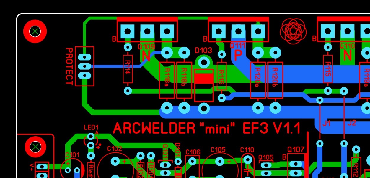

I'm sure they can do 1mm. I have the creepage of an 80V rail to consider. For everything , coated (masked) is .4mm min at 180V.
I'm 2 or more for any rail to rail and 1mm for any single rail. It's only the protect(Re sense) jack , I like overkill.

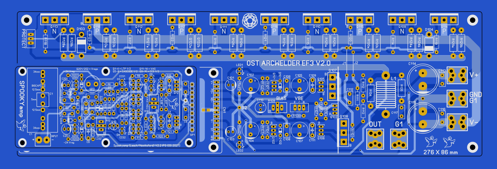

The EF3 boards are final , I uploaded them 3 days ago.
-Mini and full OPS = Standardized everything. This and the big Arcwelder all have 30mm output spacings. One will fit the drillings
of the other.

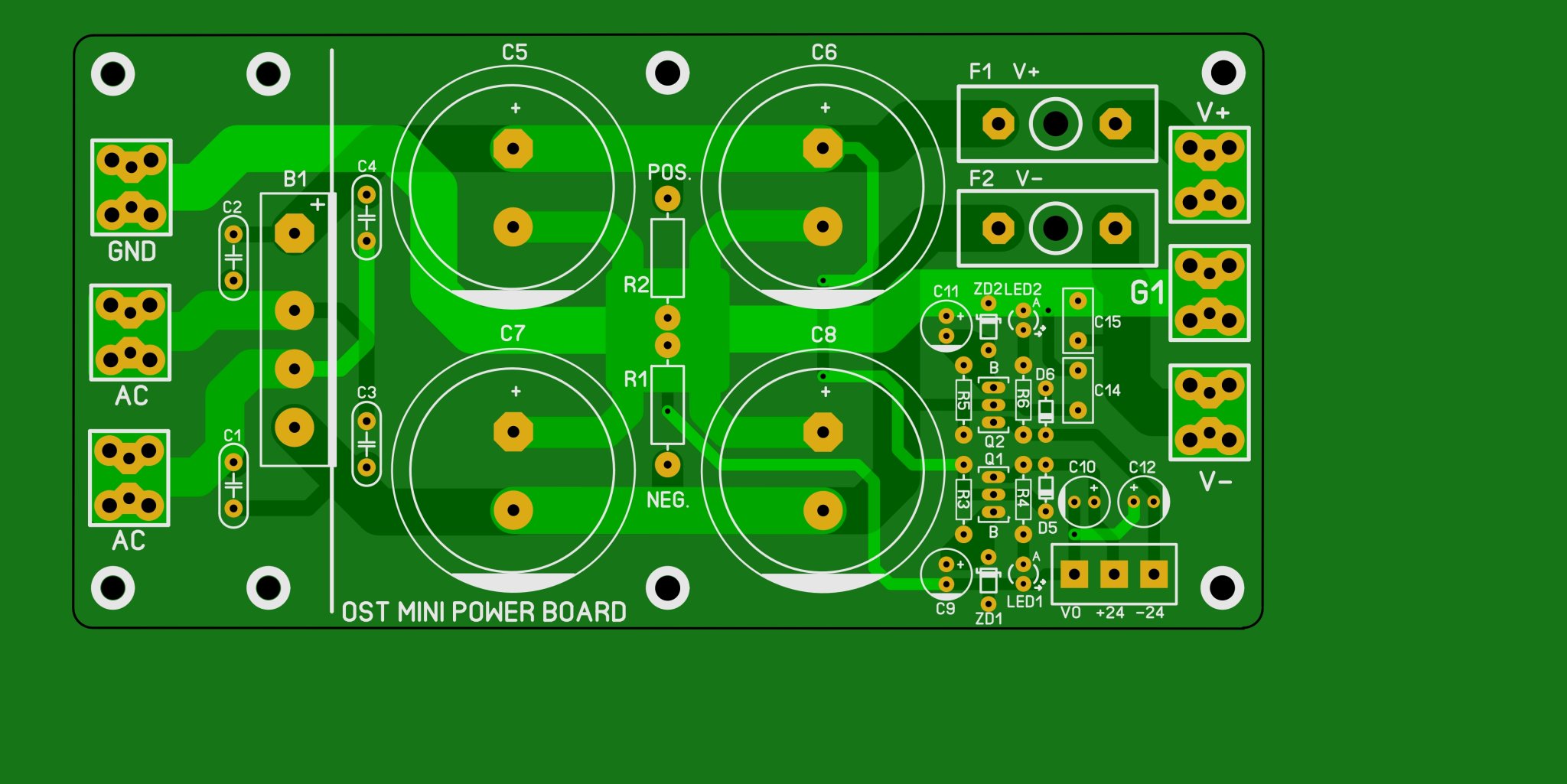

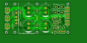

Power board - 15A bridges are SO !! cheap $1.50 - 3$ .... why bother with anything else ? They all have similar lead spacings and pinouts -
(below).

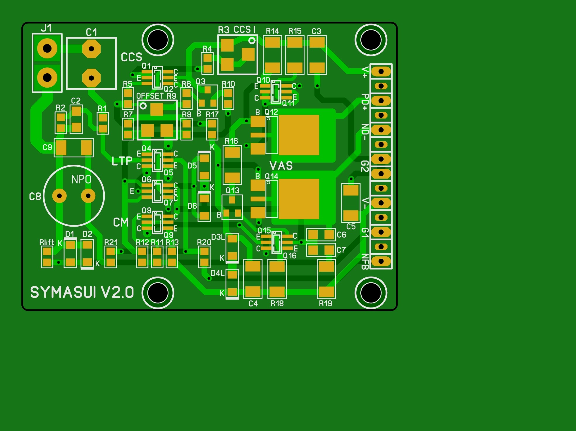

I will upload the power board , SYMASUI (below) and INFIDEL soon.
4 IPS's should be enough diversity to satisfy any audiophile. And the 2 output boards should take care of any speaker system.
My 2.1 will be 2 "mini's and a full Arcwelder in one 400mm X 3U "dissipante" DIYA chassis. Anyone purchase that chassis ?? I'm about
to spend 220$ for one ??
My speakers are waiting !! (below-last)

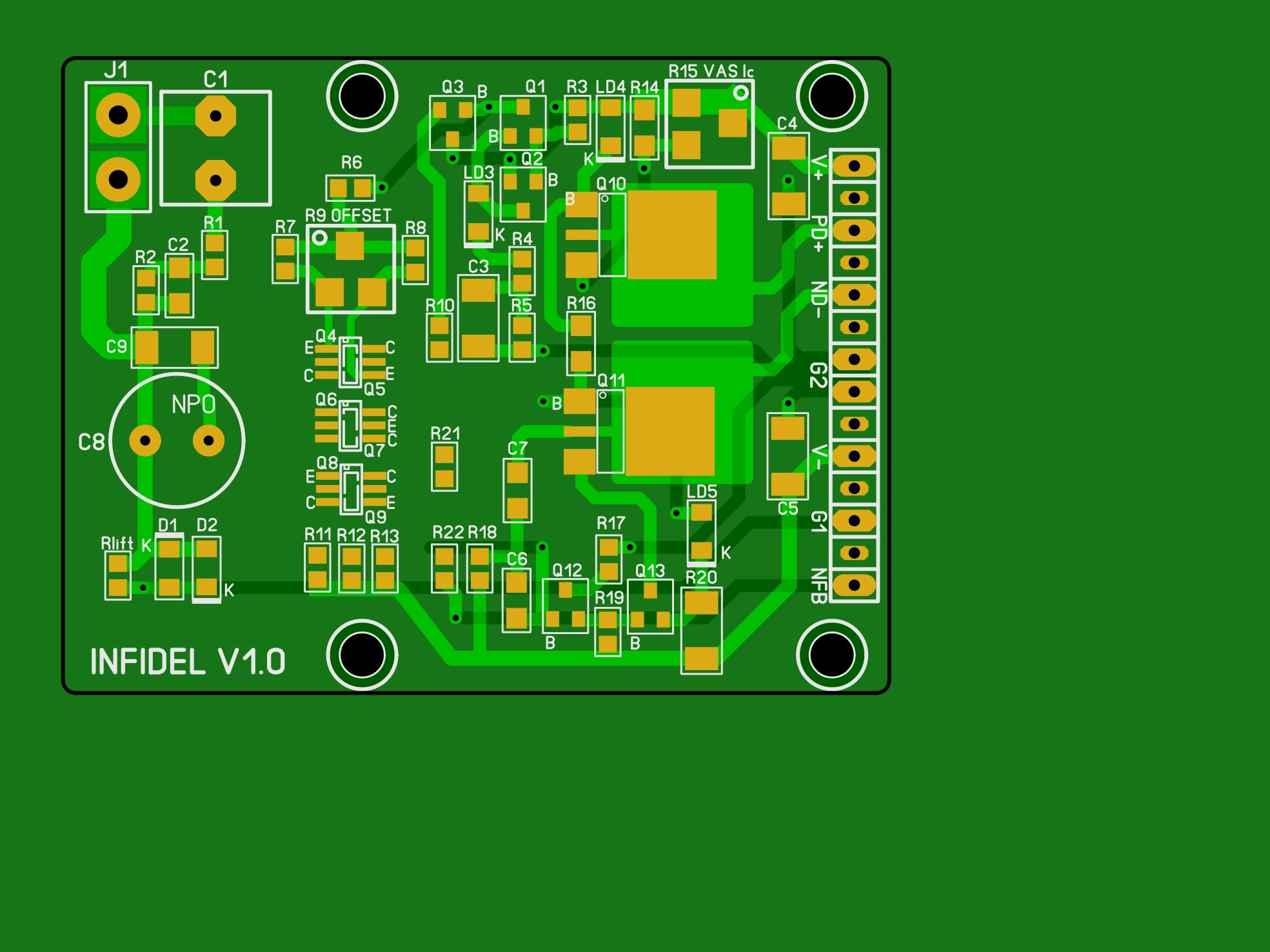

That dual footprint on the PS pcb used for Ac in, dc out, uses I assume either a quick connect spade or keystone 6-32 screw (7775) for binding a solder lug? the footprint for the 7775 needs a hole in the middle, I used 145mil, look at the detail in the keystone catalog

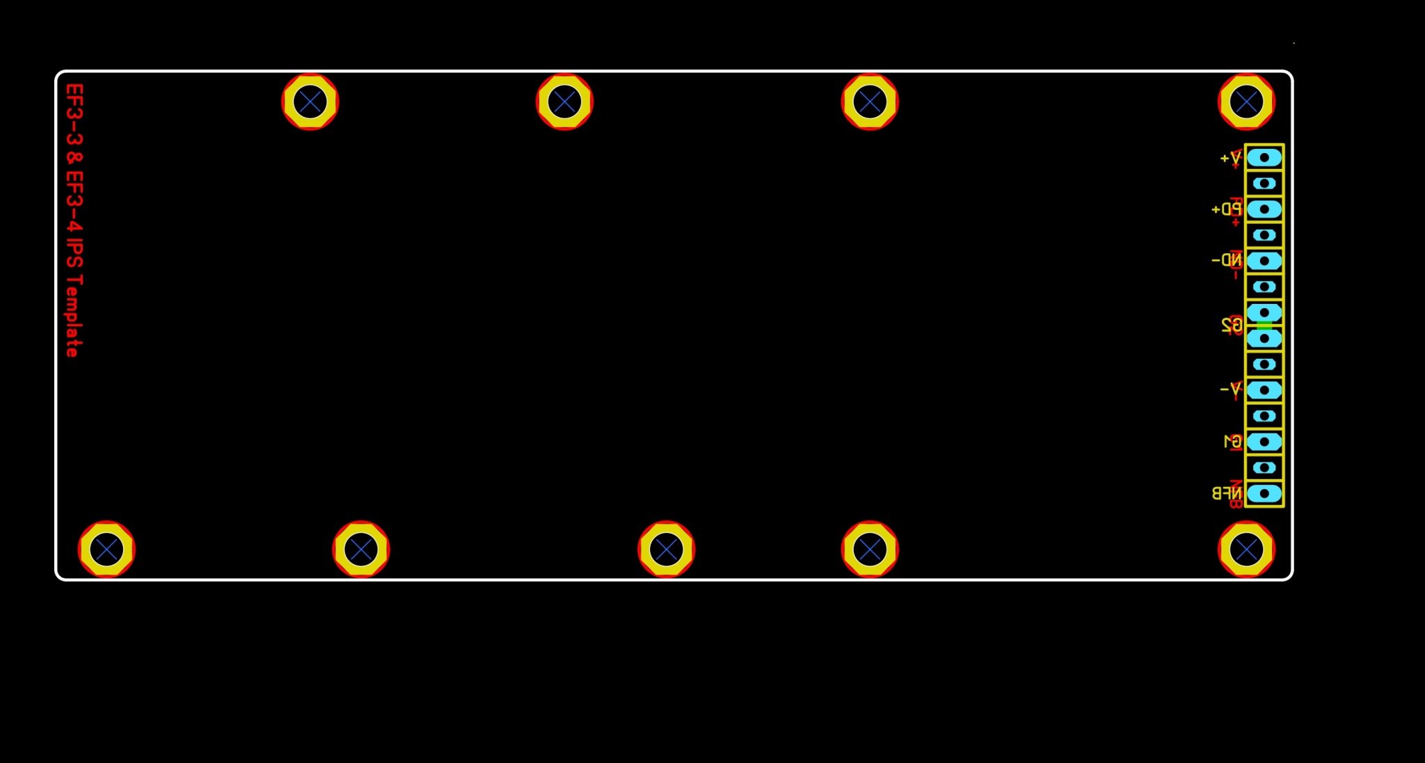

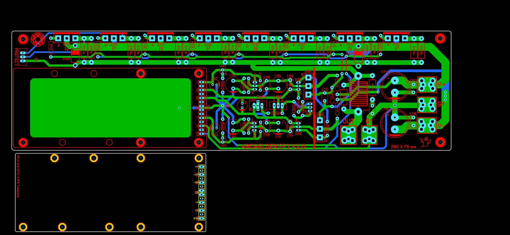

Wolverine template fits my small SMD boards , but the full size is now 122mm , with different holes.
Sucks having to change my big board to make it "wolverine compatible". I originally designed and set the standard template.
It was changed in my absence. Look at all those holes !!! (below).
I'm not going to make through-hole IPS's (except for the spook) ... I already had that artwork done 3 years ago.
hello otripper, can i do this? , I like this like this
I did "backport" the 5 pair Arcwelder to a 4 pair 76mm tall version , that is what is posted now. If you like the 5 pair , I don't support it.
I went with the 76mm 4 pair , as it will do a 3U heatsink and has standard 30mm output spacing. Mini" has 30mm spacing ... one could
upgrade from a mini to the full without messed up holes.
BTW , the 5 pair is the same as the mini or 4 pair in every way.

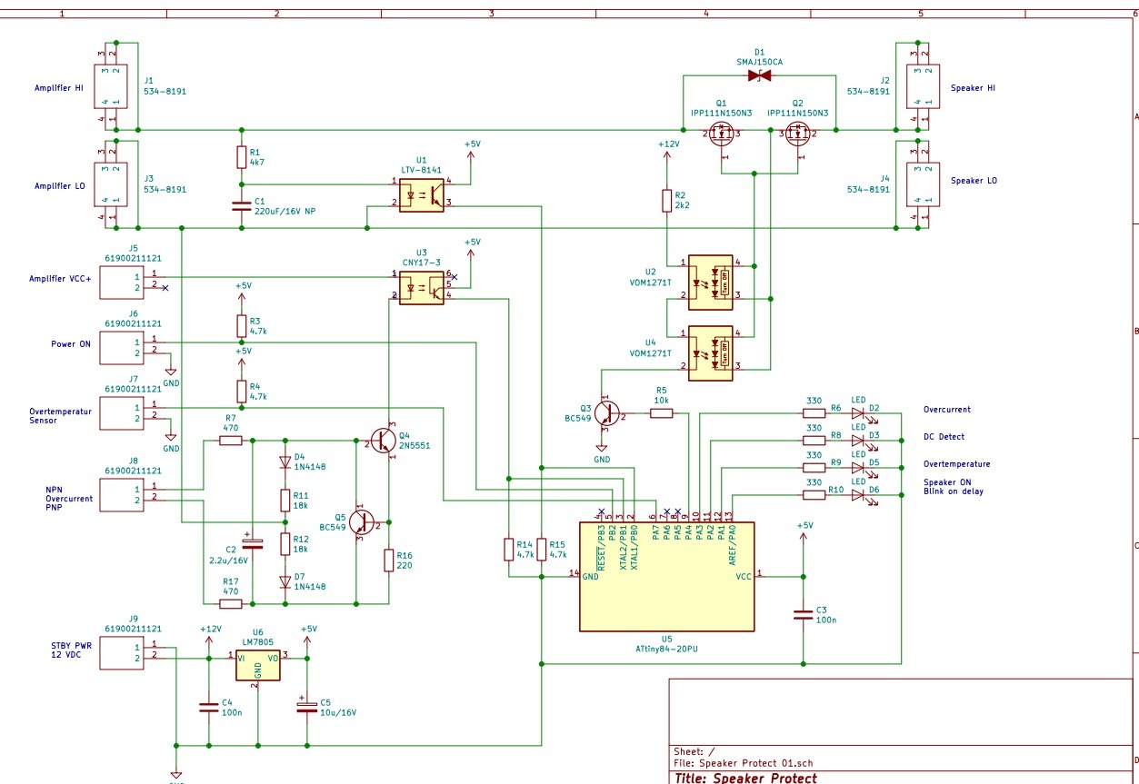

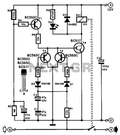

Here , (below) .... I will also offer a SMD protection board. Someone on the Wolverine thread uses this. I DO see one weakness with the simple
DC detect - it won't detect a negative DC fault (R1 + C1 ... below 1). Too slow , no negative , cap too big.
(below 2 - would be a better trigger) . Smaller caps , will do +/- faults , Can run through the same opto.
Lot's of options with a MCU controlling the amp , such as adjustable turnon .... even crowbarring the PS.
The rest of the circuit appears quite good , the Wolverine builder even ported it to match the "protect" jack on the OPS and
he triggers his SMPS into fault mode with it. Real easy and cheap to do in SMD form.

The mini OPS was perfect , now the big 4 pair one will take a wolverine board. I will stick with the 8191 standoff , it seems to of been
chosen because it is soooo common , Digikey has 131K in stock !
Below is the wolverine template for the big boards . I left pilot holes for all the weird holes and the main PCB corner hole is the far
left hole to support a 122mm (weird) size. All my SMD IPS's fit in the 4 right holes and the mini just aligns the first 2 right holes.

There is a few points of attention with the mentioned design.
  • It does not provide a procedure for a toroidal transformer soft start.
  • DC protect is not handled by an interrupt.
  • It uses the Delay() Function, which will render the ATtiny unresponsive to anything else until the delay is finished.
  • It cant be updated in circuit.
I agree , it is too simple. Needs a lot of work. Might not use it.
Or just use parts of it.
I think he just used it for his SMPS , custom designed it just for his purposes.
I'd rather have a circuit that uses a full ESPxxxx (with wi-fi).
As far as soft-start , there are mini MOV boards .... or resistive delay circuits that can take care of this.
The "mini" and it's smaller PS most likely won't need a soft start. The Big OPS's will.
