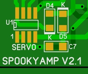

The op-amp pinouts look like its for a dual op-amp, but the spooky ltspice schematic shows a single type. Is this correct ?
Standard dual servo op-amp , much more common pinout. One op-amp is hooked to G2 ground , the other is setup as a invertingThe op-amp pinouts look like its for a dual op-amp, but the spooky ltspice schematic shows a single type. Is this correct ?
servo. The way this works , any cheap op-amp will work to control the 2 CCS's.

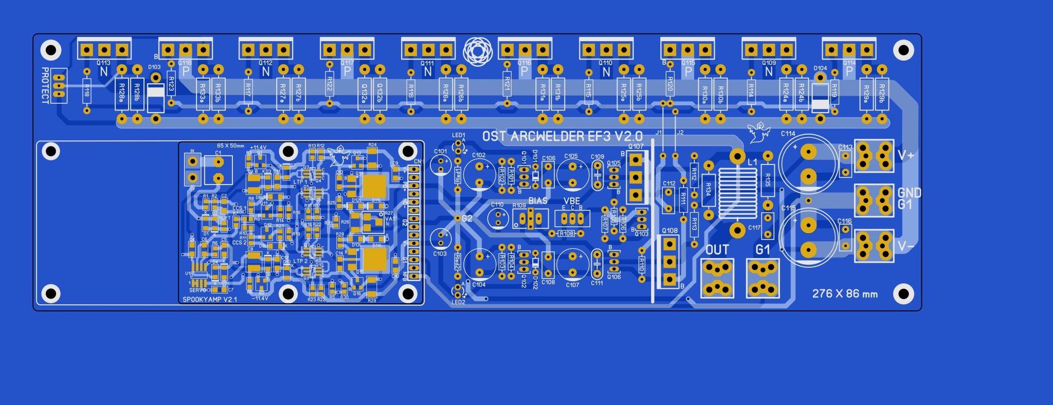

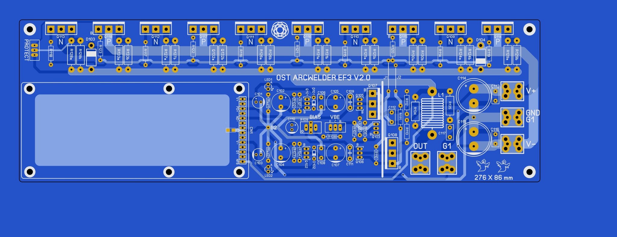

To clarify these amp ratings -
OST mini = either 60 or 100W depending on whether you use 2 or 4 NJWxxxx's - 50V rails.
Arkwelder = 300W/8R or up to 500W/4R with lower rail voltages (SOA dependent). 60-65V rails would be optimum.160V SMD and
TTA/C BJT's would limit safe operation to 70V supplies. SMD VAS BJT choices are slim >160V. I'd rather drive lower Z speakers
with lower rails and better SOA. At least none of my designs depend on obsolete components !

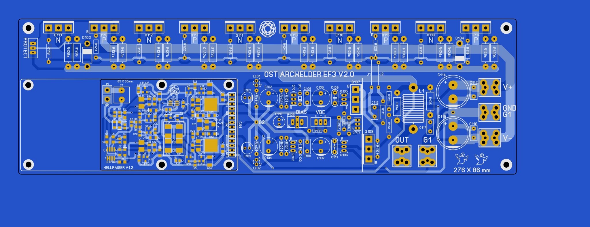

There also is it's VERY big brother - I just finished it ! (below) I'm using it's full (Spooky + Arkwelder) layout to choose the BOM BJT's.Hi OS,

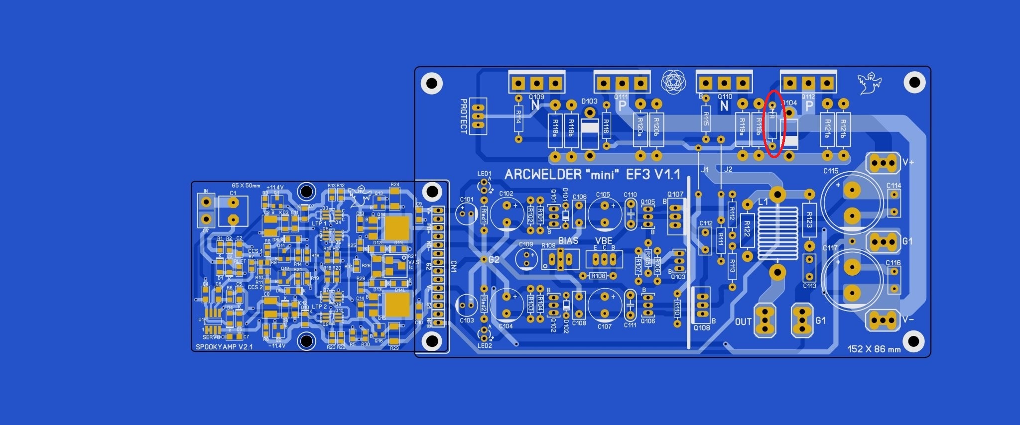

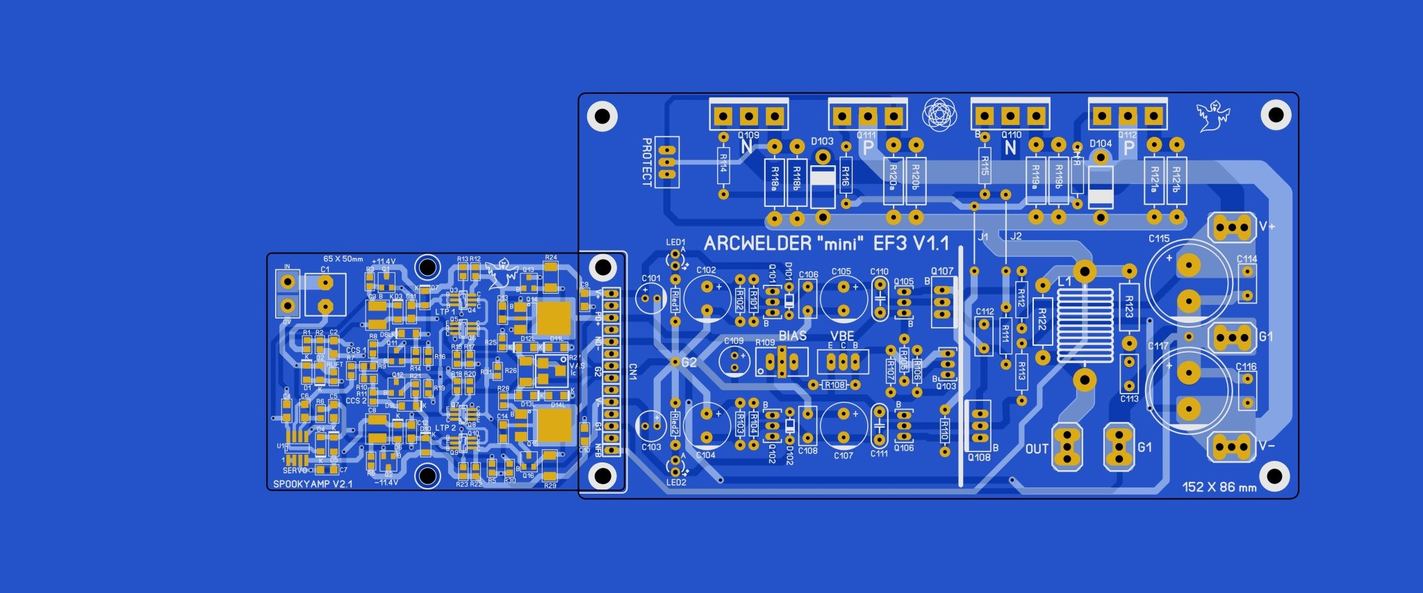

Output stages GALORE ! Arcwelder layout is superior , ported it back to a mini version. Both PCB's have common layout , part #'s ,
tweaked the IPS integration and driver spacing.
Arcwelder -"mini" is 4 output/60-100W , uses TO-220 drivers
Thanks JW ! I caught that one late night.
I was thinking of Slewmaster days to finish the big one (below).
Now both are at first post.
A very snotty amp !! Hellraiser would swing full rail to rail in 1/2 uS.
I will add the BOM's right in the package with their corresponding artwork/gerbers.

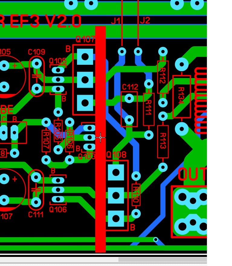

I have been looking at the Wolverine builds .....
I see they use big fat 4mm aluminum heatsinks on the PCB for the drivers, predrivers ... even the VAS !
Don't need that ?? Even the drivers , like on the original HK680 - have no heatsinking.
(below) is standard T651 aluminum ... 2,5mm, spaced the TO-220's and the bigger TO-3p's . Screenprint is 2.5mm
for spacing the heatsink , not the final artwork. On both boards - Q107,103. and Q108 are opposed , heatsink should be sturdy.
Ripple eaters (and predrivers) also need NO heatsinking. Only reason for any heatsinking is to thermally connect Q103 (Vbe 2).

I don't use excellion files, not sure what that offset is.
The drivers in the Slewmasters actually ran pretty hot on the sheet metal heat sinks if the rail voltage was high.

Uploading Spookyamp_V2.1_package.zip @ jlcpcb.com gives me the following error:
Unable to identify the layers due to the non-standard filename
How do I fix this?
How do I fix this?
Use standard Gerbers and a .drl file for drilling. You may need to rename the Gerber files to match what they are looking for.
