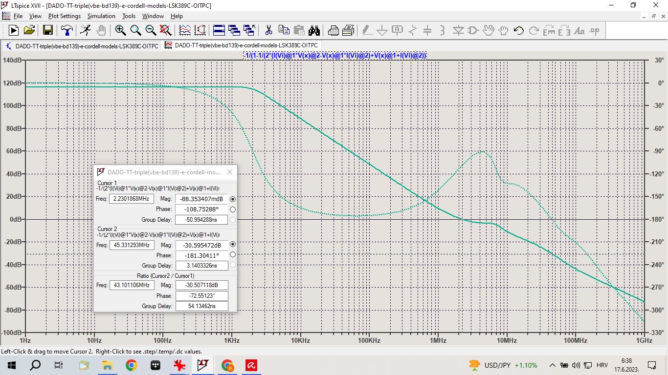

Explain C6/5 ,R25/R30 , C23/C22 ?This is mine VFA from 2014 (or around ) with LSK389 and TT output transistors and with simulated THD below ppm level at all frequences and output power.

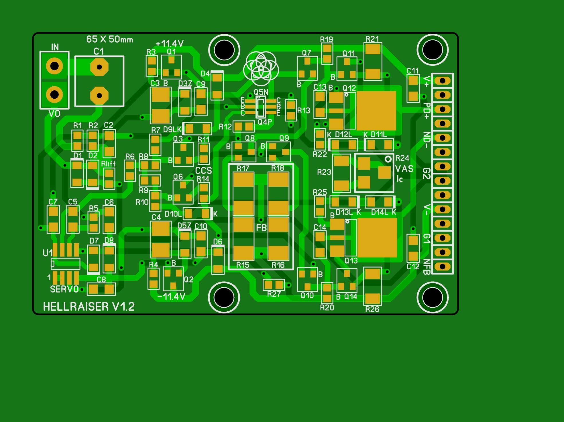

OK , I'm going to upload all 4 boards (with gerbers).
I wish y'all would look for errors. I have more time , I would not order my boards till after June .
Power board and OPS are surely perfect , The 2 IPS's ... still have a doubt.
I will upoad all 4 packages within a couple hours.
OS

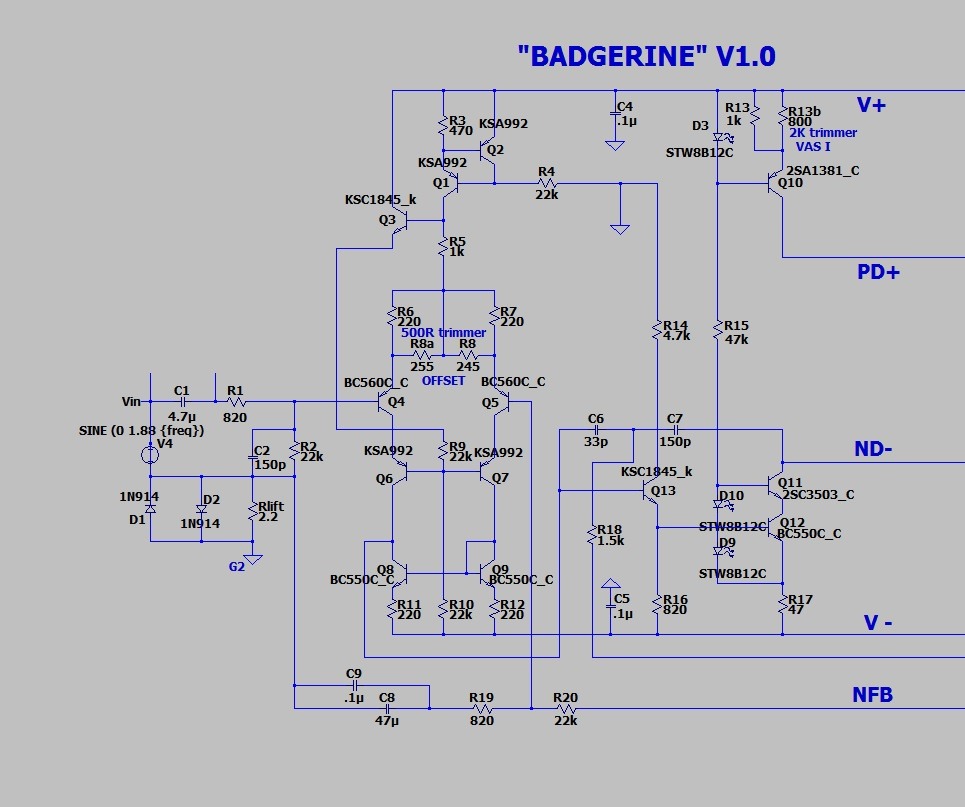

C6/C5/R30 - TPC, C22 -Cherry cap, C23 smoots the hump in TPC compensation, R25( not strictly necessary) improve phase margin. All that is what I called OITPC.Explain C6/5 ,R25/R30 , C23/C22 ?

You can play with LTspice with added zip file.

Your OITPC is straitforward. Thank you . Easier than Printnik's compensation method .... which even uses first stage "Resonant tank" plusC6/C5/R30 - TPC, C22 -Cherry cap, C23 smoots the hump in TPC compensation, R25( not strictly necessary) improve phase margin. All that is what I called OITPC.
lag/lead. I have about 6 different Symasui type Japanese input stages , all 6 use different combinations of these compensation "tricks".

maybe we give symasui a chance. easy addition of the second R-C.
I like the 2-pole margin better than the TMC one.

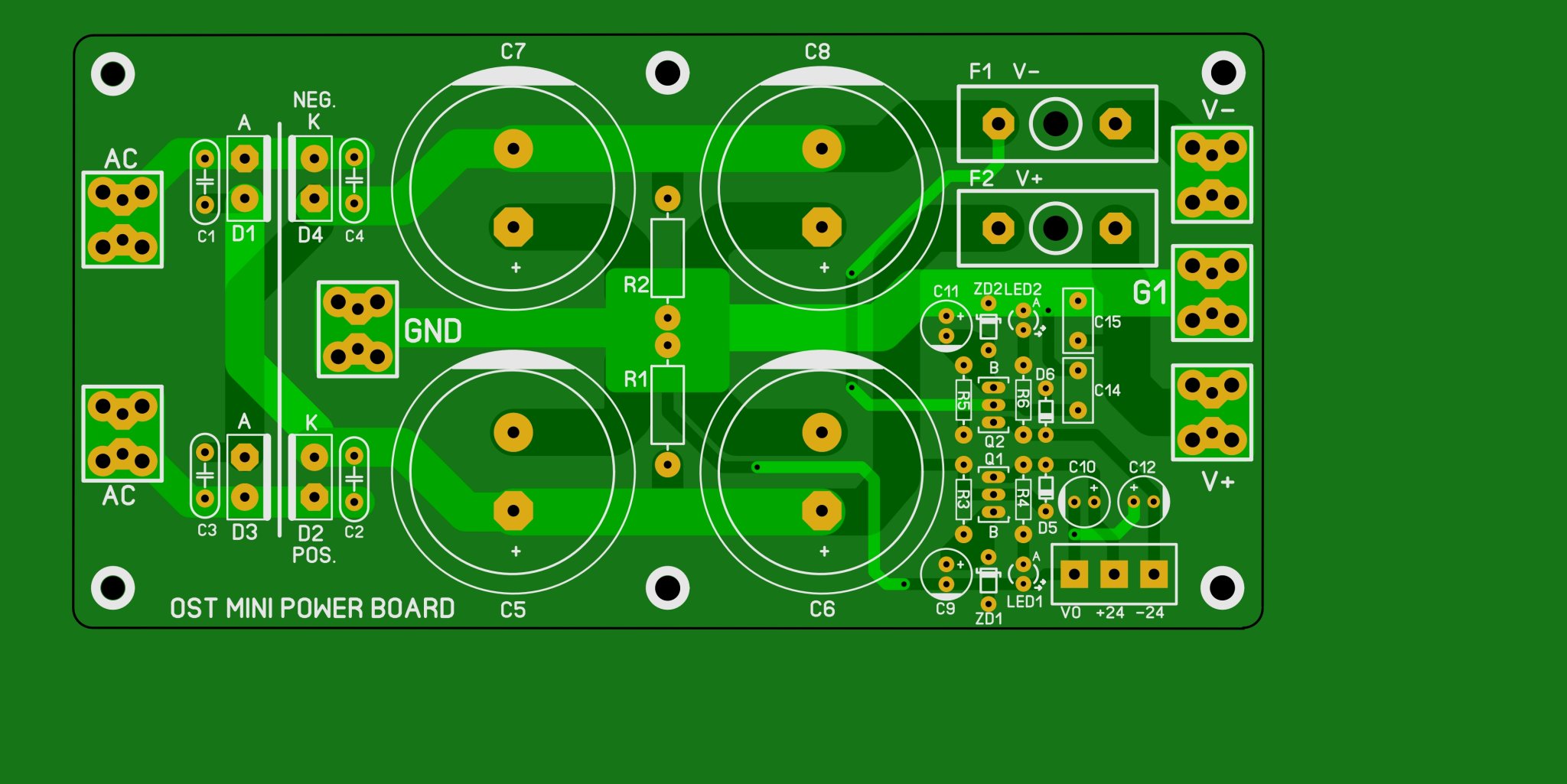

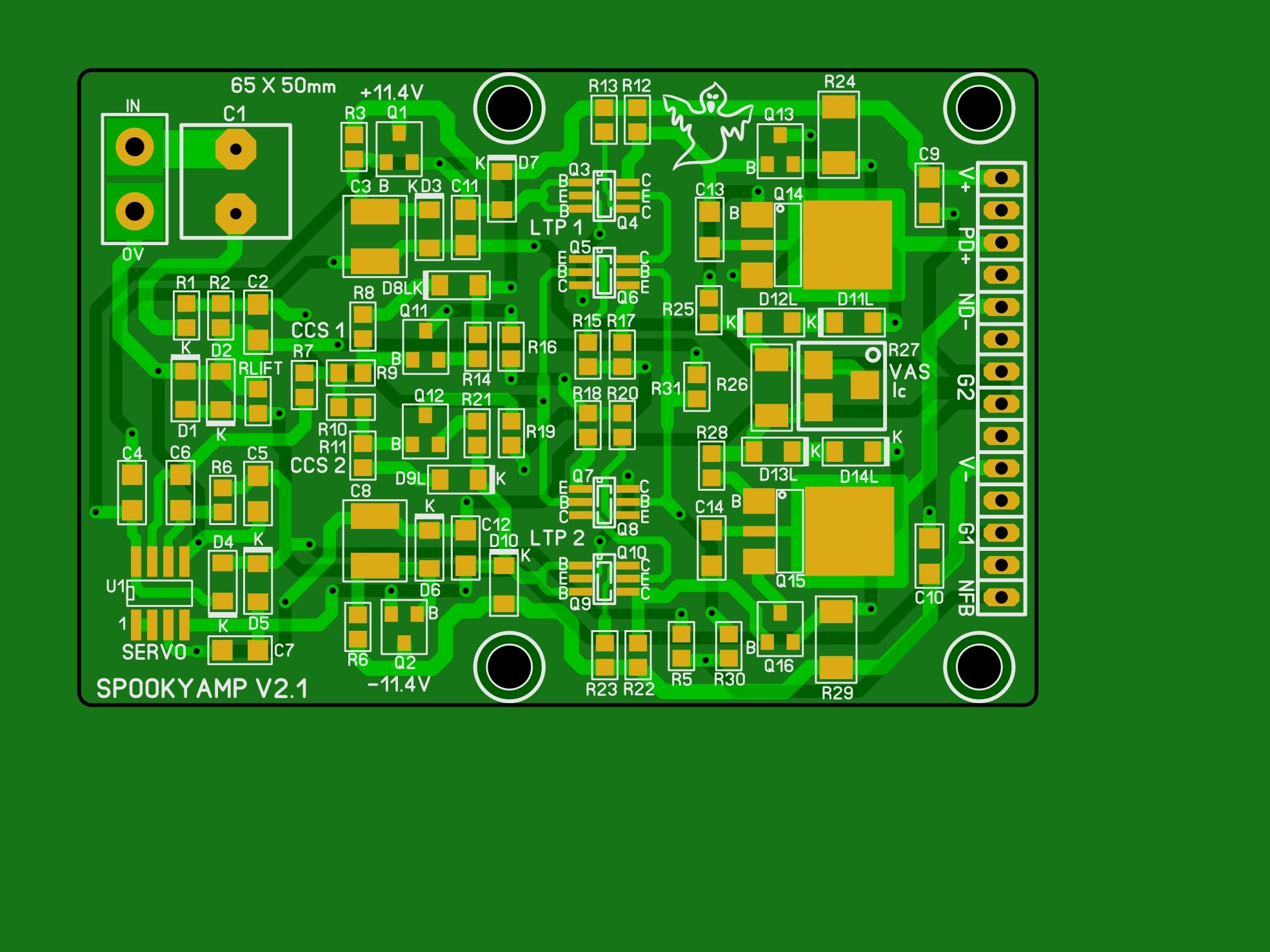

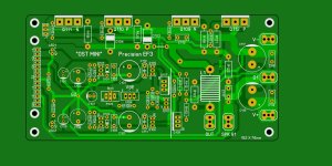

FINAL OUTPUT. (most likely) 😉 All in "package" zip's at my first post. All you need for product.
- Hellraiser V1.2 - perfect !
- OST "mini" power , Set for 1 or 2 (stereo) uses 4 X 8200uF @ 63-80V (25-30mm) caps. (Optional) 24V regulators for bluetooth , protection,
use IC 12V/5V on any accessory board.

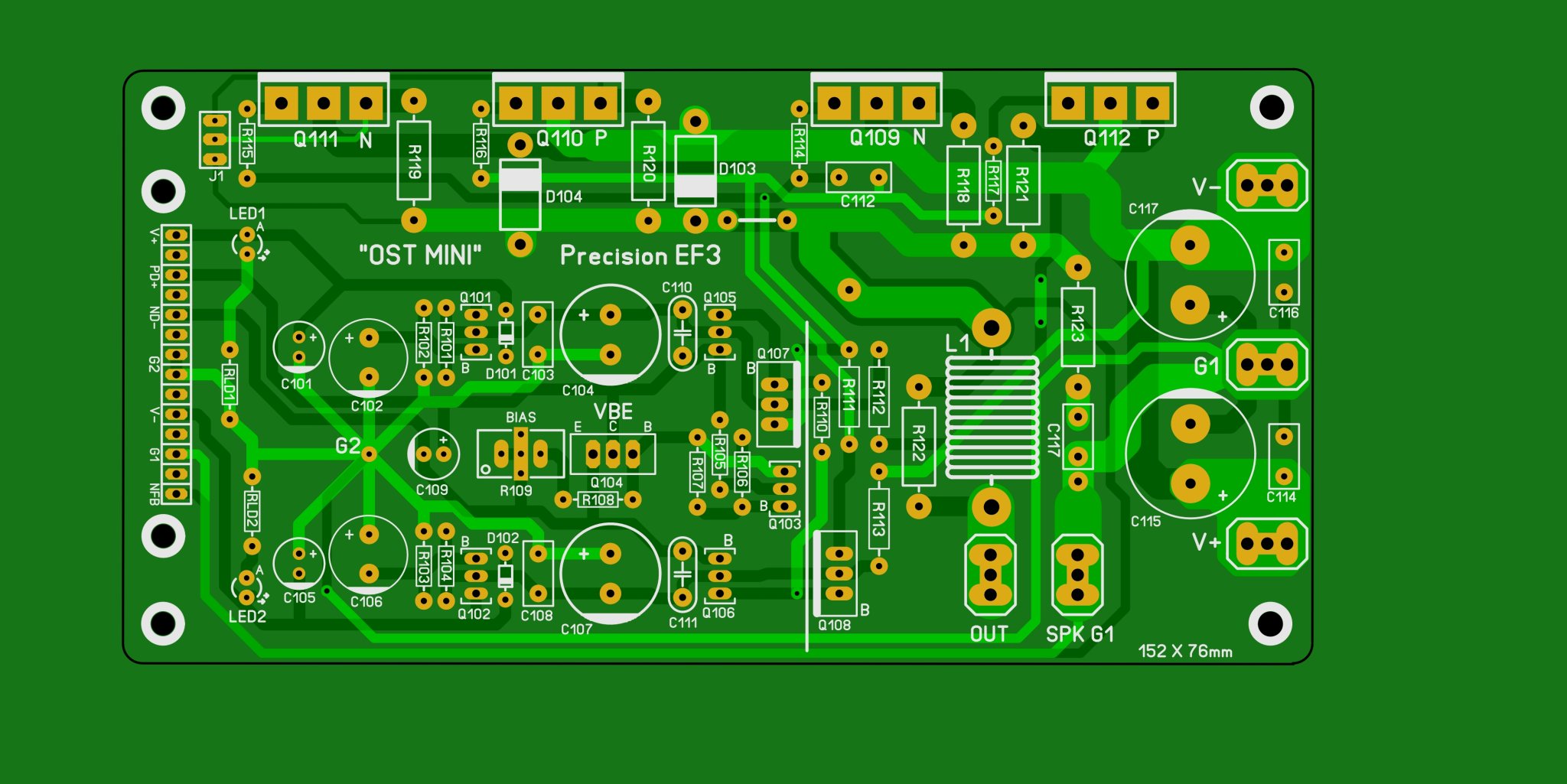

- OST "mini" EF3 , 100W of goodness. HK680 EF3 with tweaks and ripple eaters.

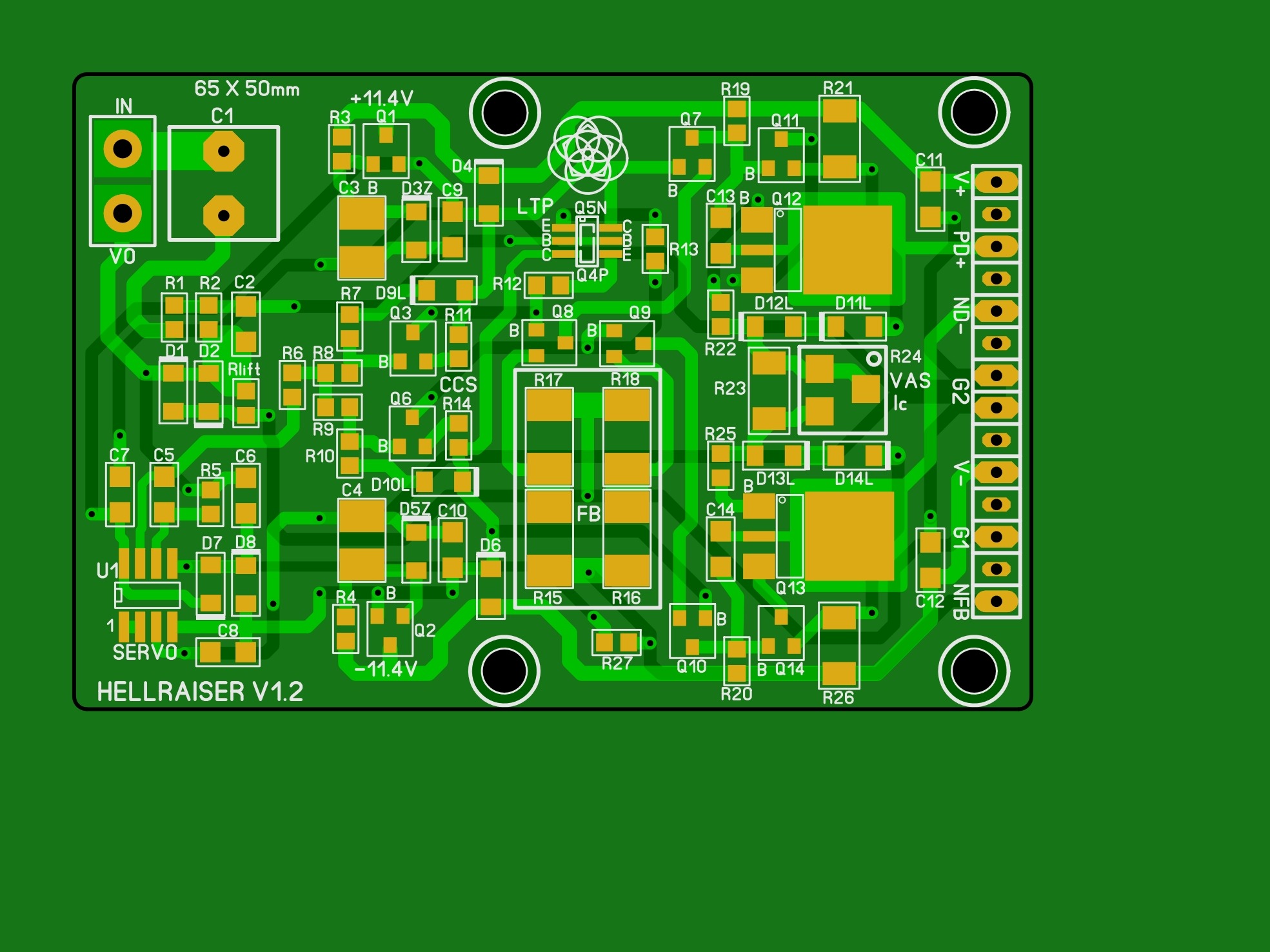

- Spookyamp V2.1 .... Hardest of the artwork and my favorite IPS.

I'll do BOM's and build guides next. Not much , all the parts are standard fare ! Any special stuff is in the "SMD parts" zip.
Most resistors are 0805 tiny ... just some VAS and CFA are the bigun's (2010/2512).
I included the pinouts of my select dual BJT's , they are listed also in "SMD parts" Zip.
Here is the standard resistor capacitor pad guide - https://www.vishay.com/docs/31545/soldpaddims.pdf
So you know what to get , most of these parts are in multiple packages (many !!).
OS

For complete disclosure - "LT_ALL_IPS.zip" is also in the first post.

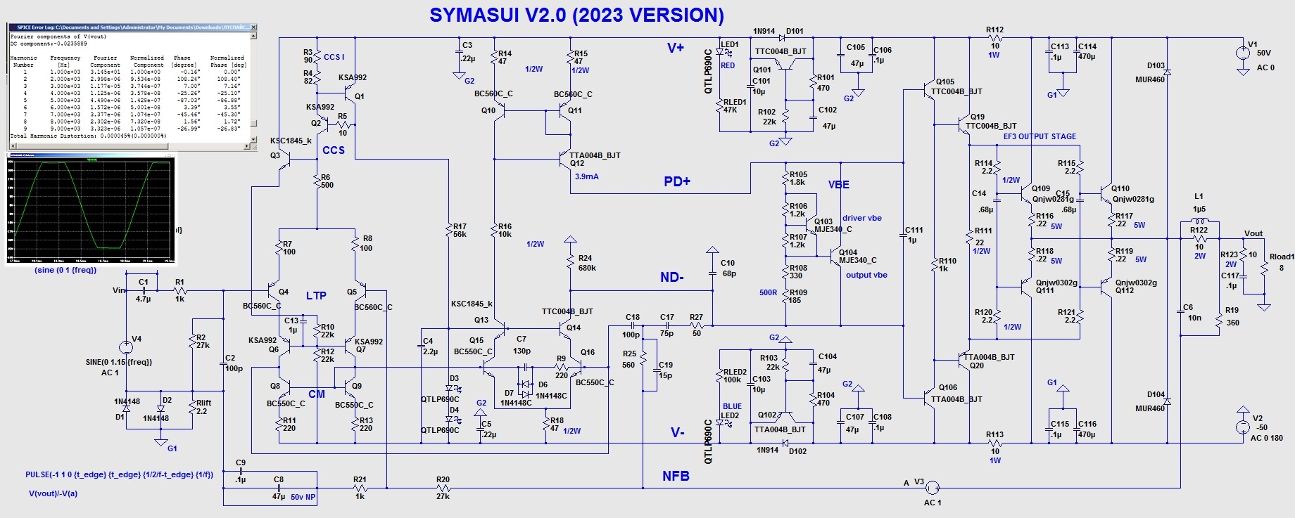

@ 10Khz/ 1V /8R ... with 72mA OPS bias , the Ranking is ....
1 - "BADGERINE" = .3PPM (my take on the wolverine which is no longer mine)
2 - Symasui = 1PPM
3 - Hellraiser = 3PPM
4 - Spookyamp = 5PPM
Most likely , as was the case with the Wolverine .... the layout and sourcing can produce even better results.
Oh , here is the "Badgerine" (Below) - different .... with the saturation issue solved = cascoded LED VAS + a simple LED VAS CCS.
Badgerine and Symasui will be next. I just have to add Printnik's (smart Russian) compensation tweaks to Symasui - done.

Heck of alot of work, cheers to you, now comes the proof in the pudding, building, testing, listening.
First issue I see before even loading the gerber layers in the viewer, is that there is no drill file(s) in the "OST-mini_EF3_gerber" folder
File names can be changed and then zipped up for upload to fab like jlcpcb, which have an on line file viewer so its and extra checking step.
does not matter, what's (same as) the gerber outputted in? needs to be in excellon format, file name extension is irrelevant, needs to be changed anyways.
Usually the ecad tool creates a drill schedule table showing symbols for the fab drawing, locations, tolerances, notes etc, its more historical than a necessicity because drill hole tolerances are part of the fab process.%
