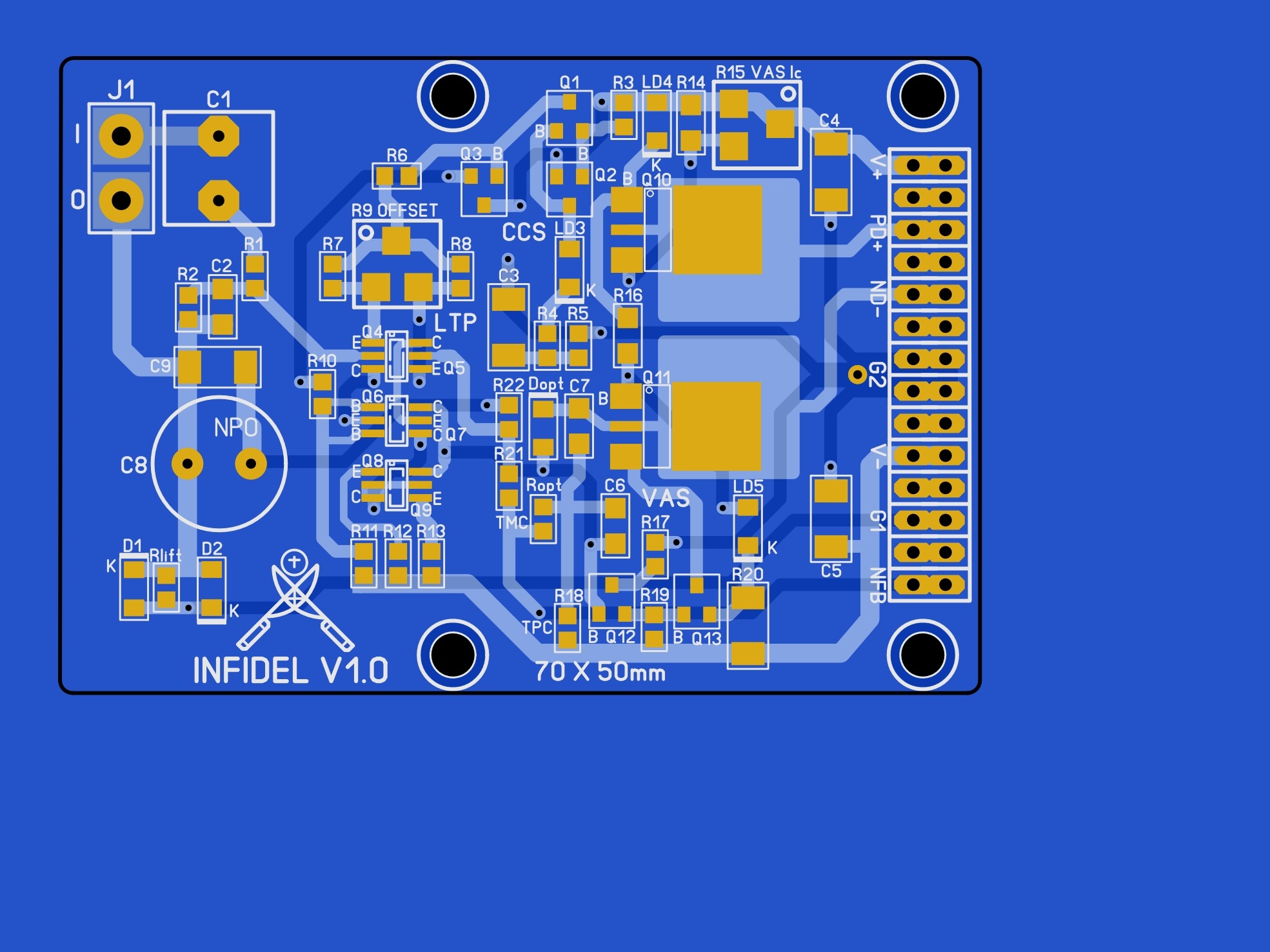

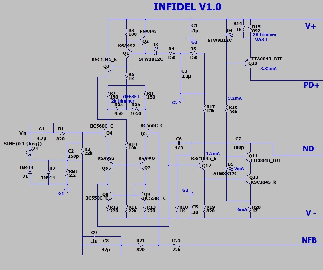

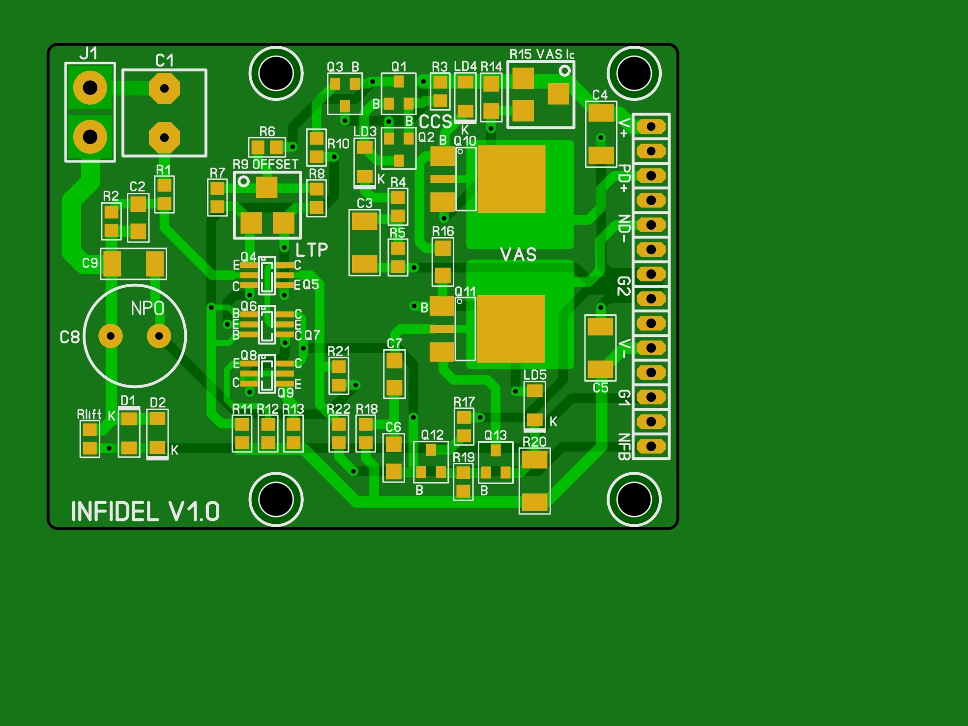

"INFIDEL V1" is done (below). Very simple "Blameless" type design , similar to the Badger/Wolverine. In SMD , with matched
dual semi's - it could possibly outperform those IPS's. It will run cooler , I've dialed the main CCS current down to 3mA with no
THD degradation.

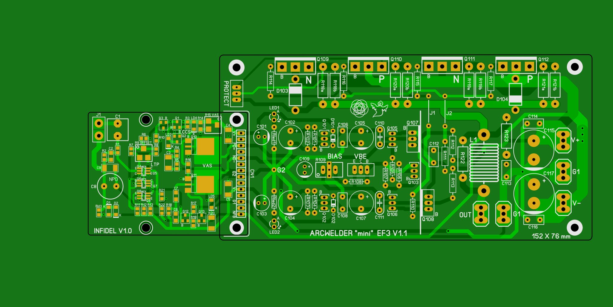

2 row would also be easy on the SMD IPS's , just extend the connector end of the PCB out 5mm , add the 2 row.
And , everything would still fit a Wolverine EF3 PCB.

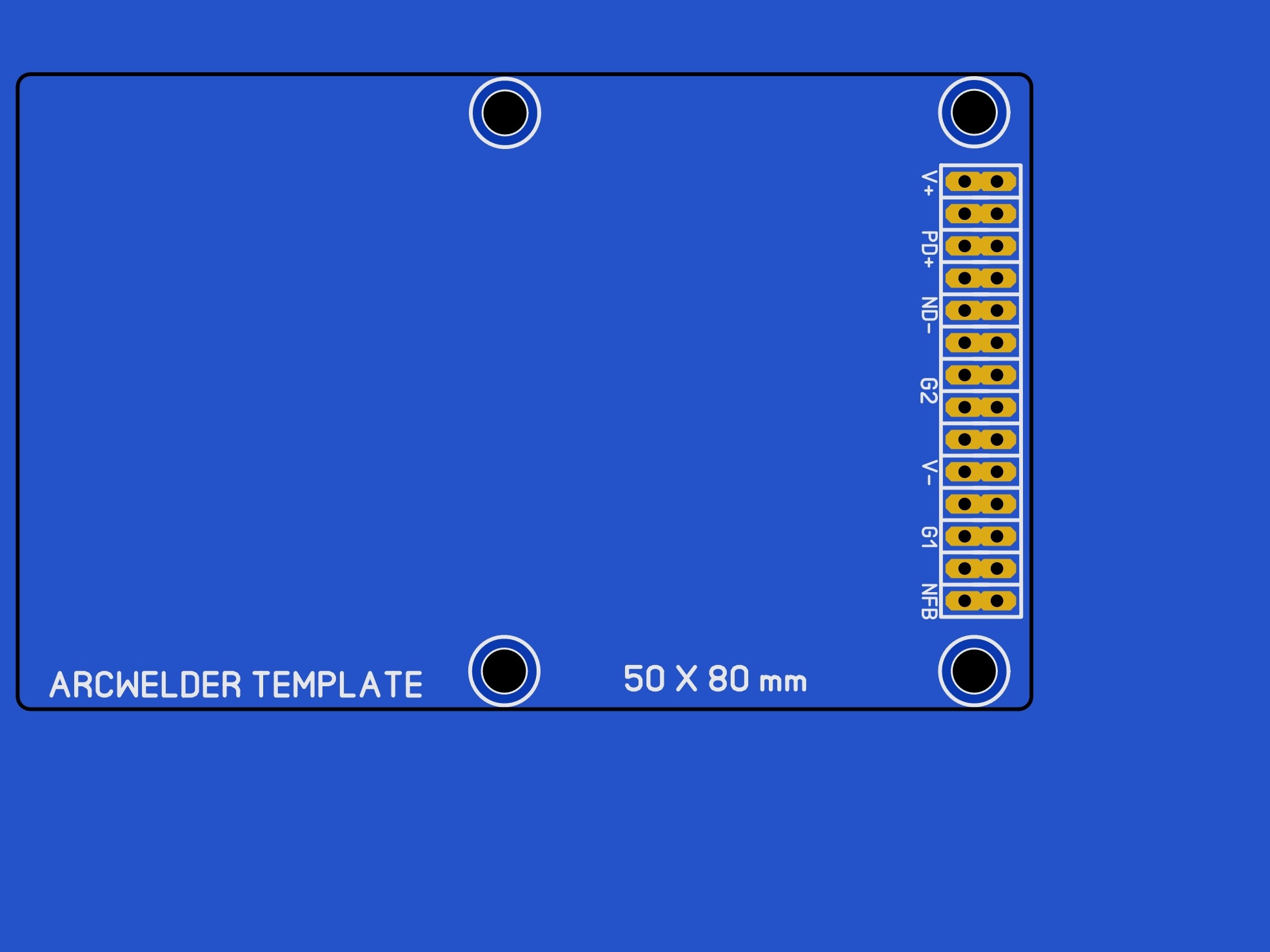

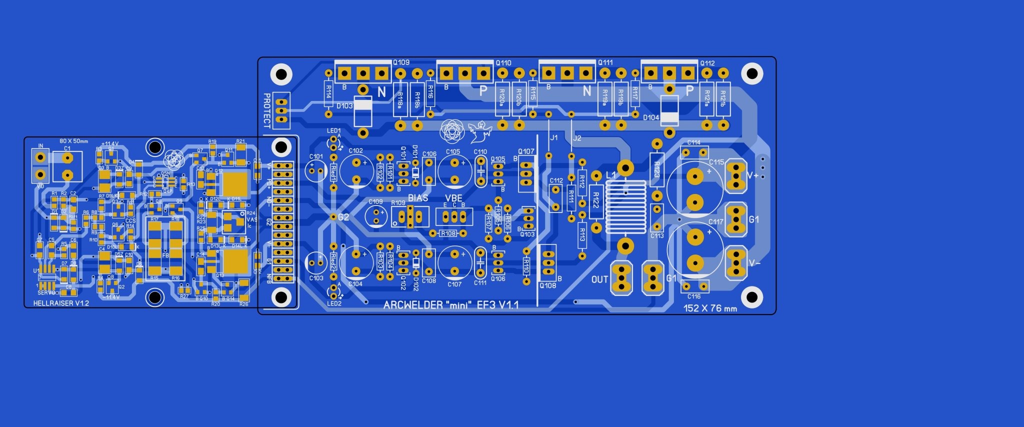

Two row it is. IPS's enlarged to 50 X 80mm , but that is still 5mm short of a standard credit card (55 X 83 ?).
For the mini OPS , this allows a sturdy direct plug-in .... even at 90 degrees to the OPS.
Plug in a male 2-ended header , and you could connect to one of these with a old computer peripheral flat ribbon cable.
My new template will be a dual row 14 position , and be backwards compatible with any SIP (wolverine) hardware.

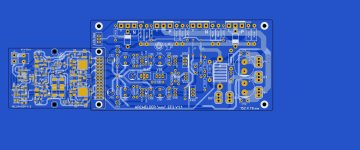

New , perfect Hellraiser and Infidel (with logo) is at first post. Absolute perfection !
I would actually say I have 101% confidence in both these 2 designs (and layouts).
On the infidel , (below 2) .... I have TPC (2 -pole) , TMC , and jumpering C6 and omitting Ropt + R18
will give you plain Miller compensation. Dopt is the optional Baker clamp. Baker clamp is not critical , as on
the Wolverine.
D3L will show operation of the main LTP current source , any color you want. D5L is the VAS cascode reference , any LED >2V (any color)
gives proper operation. If it lights up - it works ! D4L (VAS CCS)should be any orange/red led at 2V Vf. My LED's are not "eye candy" , they are integrated
components that both set operating points and indicate proper operation.

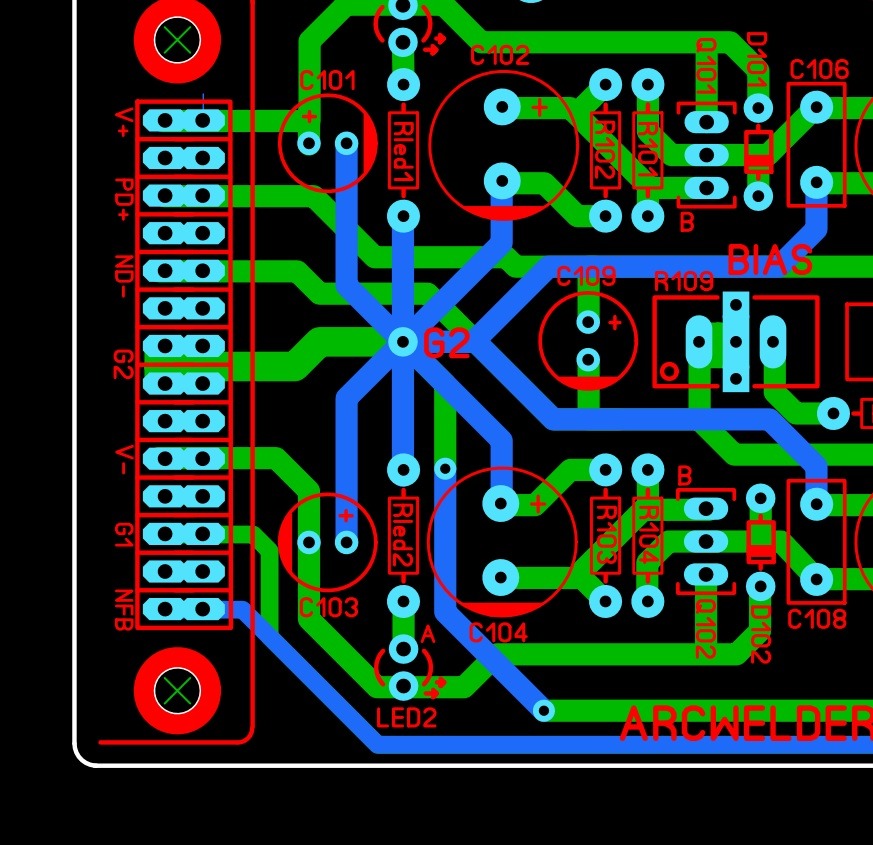

The G2 pad can be soldered on a copper sheet (with proper cutouts for leds and trimmers) to give this "credit card IPS' a faraday cage....

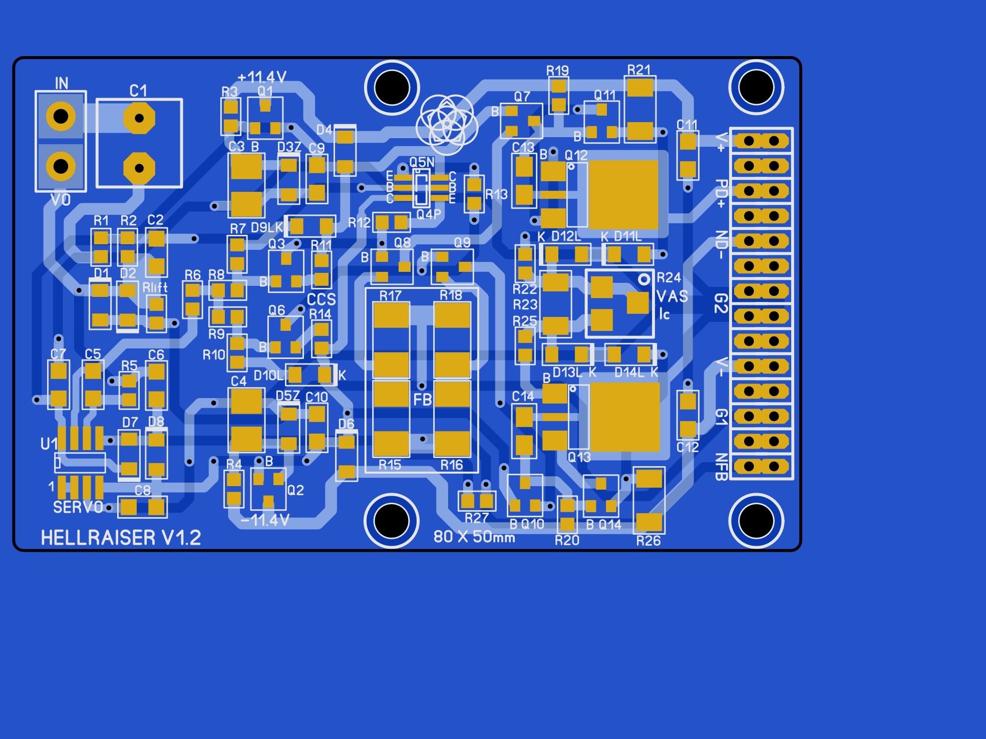

The new Hellraiser is absolutely compatible with the last posted one , just the dual row card connector and some fine tuning of the layout.
The Hellraiser diamond buffer input stage was so "finicky" when I built the "Slewmaster Kypton" (V1.0 hellraiser). Just a tiny current source difference
, thermal or mismatch would create offset. then I servo'ed it ! Perfect. Using the BC-817DPN (TSOP-6) should take care of the matching issue and
on the Spook I use with the same servo .... microvolt offsets.
I only ran the Kypton/hellraiser for a few days , but it had the HF ace'ed . Super crystal clear bell-trees ,brushes , it's imaging was quite noticeable.
CFA does have a tradeoff - warm (R15-R18-1W) resistors for killer highs !
OS
