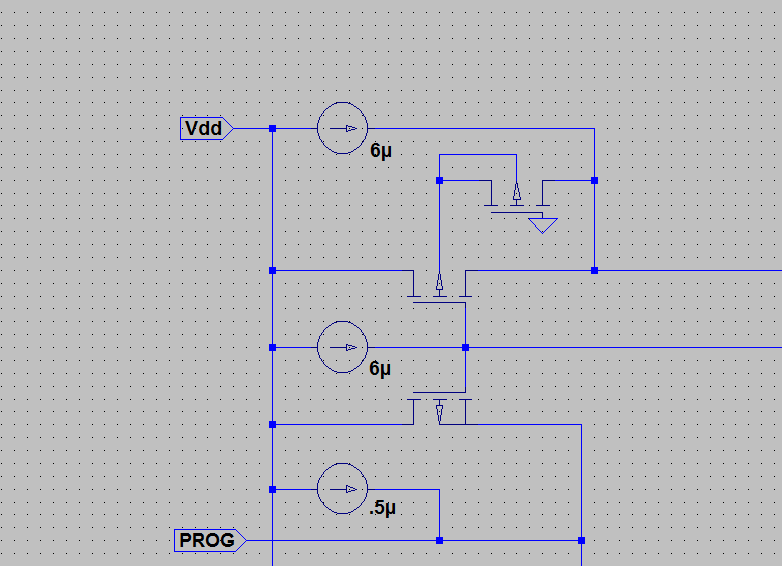

Perhaps the little gig up there where the mystery box is may be interesting.

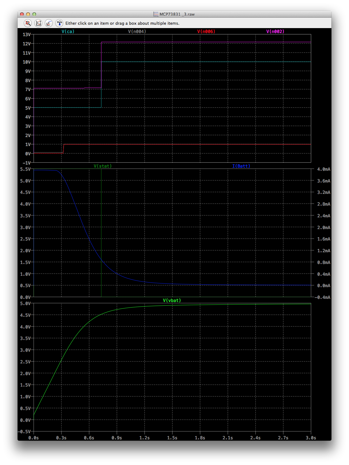

I ran some sims and found my idea of using a big cap as an R/C setup as a battery not so good, so I tried something else, with a voltage source with a delay to turn on followed by a ramp up to fake a charging battery. But then there is no real way of telling if the behavior is only due to that or if the IC decides things.
The screenshot does show one thing that seems consistent, the voltage source used to simulate the battery goes up to 3.6V, which would be the max voltage of a fully charged battery, but the Vbat does rise to about 4.1V.
This seems to be consistent with having the chip variant pre-configured for 4.1V max charge voltage, which is a factory set parameter.
This brings me to think that the datasheet's schematic is showing the resistor values for that variant configuration of the chip. I'm sure those values change depending on the factory configuration chosen for the variant.
I use a pulse with a delay before voltage is applied on Vdd, to simulate the arrival of power some time after the actual start of the simulation, so there is supposed to be no power for the chip, however we do have current sources there, and resistors, causing voltage drops from that flowing current, so the circuit does show voltages before anything is actually applied to Vdd.

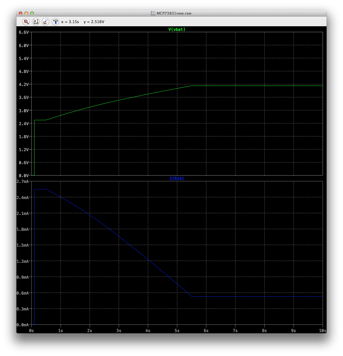

Using the Linear method to fake out a battery and the "startup" option for the tran statement, I changed back the Vdd power supply source to a normal DC instead of pulse.
A few tweaks and got it to behave somewhat like a charging circuit, although it's not yet behaving quite like the specs dictate.
For one thing the stat output doesn't work, and the resistor on prog has no effect.
There is no trickle charge phase that I can see for a deeply deplete battery. I used 0.2V for the battery starting voltage, so I assume this should make it have a pre-conditioning trickle phase before entering the constant current one, but it's not exhibiting that behavior.
However it does show a 1st phase for the constant current, although not at the current value that is supposed to be determined by the res value on prog. That res on prog has no effect.
The value of 67k should bring the constant charging current at 14.5mA per spec, and 10k should bring it to 100mA. Instead it's staying at 2.7mA regardless of the res value on prog.
More work to do on that.
The max charging voltage is different from what I observed earlier, which was 4.1V. Now it's 4.4V, even though no res values have changed in the circuit. That's odd. But it's still coherent in accordance with the specs which states 4 possible factory settings of 4.2 4.35 4.4 and 4.5V.
Maybe a few more tweaks can bring it to behave more in line with the specs.

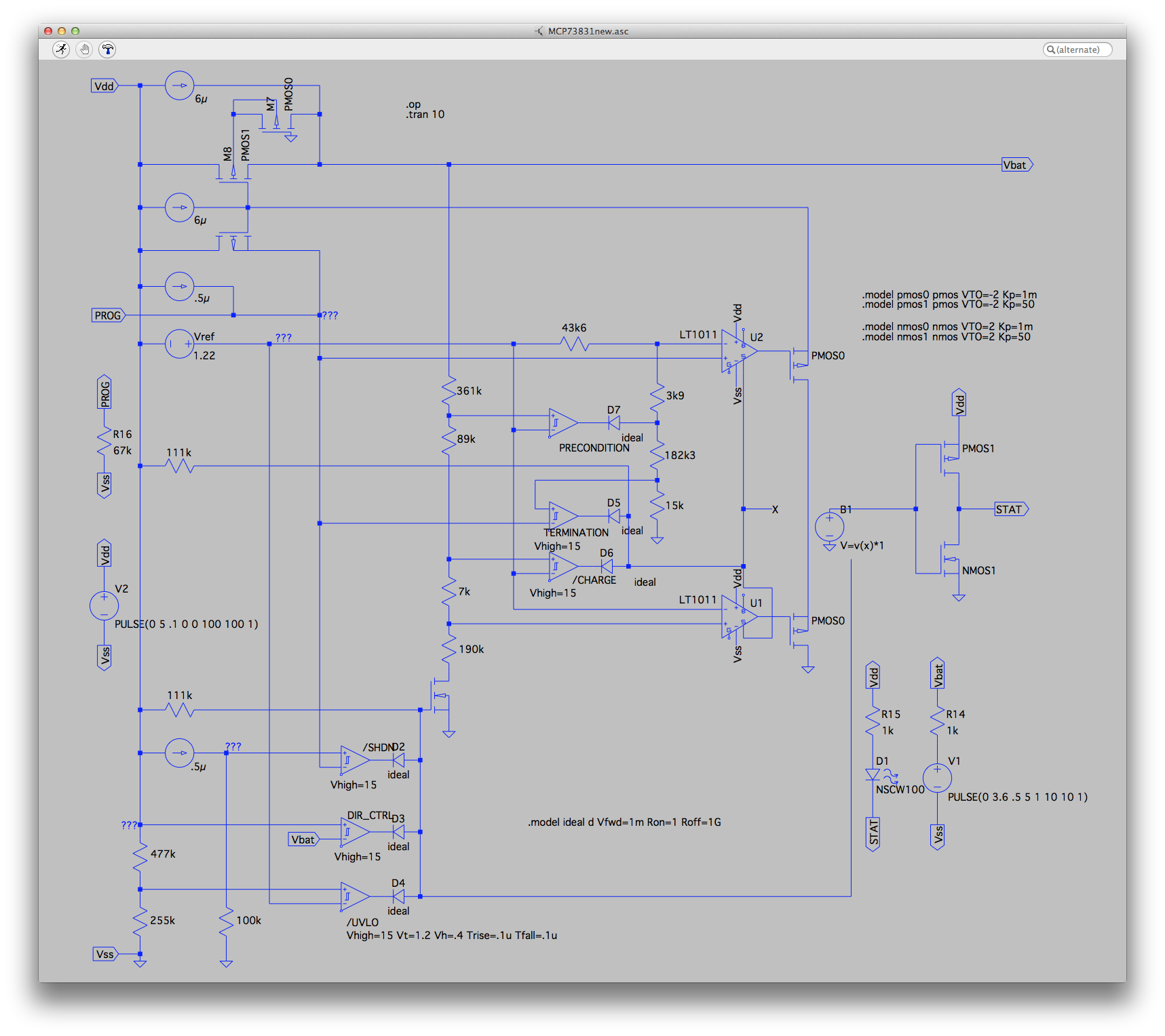

Bit hard to figure out what you have done there. The FET's look odd, one has four individual connections.
Yes, for me too, as I didn't come up with this. It's from someone on the ltspice newsgroup, and he's also the one who made most of the changes, like inserting those ideal diodes, changing how the X signal is made, etc...
Replacing the battery with a resistive load shows that little current is available. Unless I'm going cross-eyed they look to be reverse biased as well.
Right now I am trying to figure out the thresholds for the schmitt triggers, as none were properly setup to begin with.
As I go along, I see how un-configured triggers can interfere with the rest, so at the moment I "lifted" the output diode from one of them, and that made the X signal responsive, but I'm not even sure how it's supposed to respond, so I'm flying blind here.
I'm attaching my latest work in progress.

This bit doesn't look right me. P channel FET's should be biased with the source as the most positive with respect to the drain.
You're probably right, and I'm wrestling with it without much success yet.
I didn't come up with this, and I couldn't come up with something like it anyway, so I'm just trying out suggestions. Hopefully something will come out that does work.
The other thing is the Vgs of the devices your using. Have you enough voltage available to turn them on.
I don't know. Those mosfets are the generic ones from the library and I don't know if we can override their characteristics.
Now I'm getting serious doubts about that contraption with those mosfets at the top where the mystery box is. I just can't figure out how this works and how it's supposed to work.
In most places it's probably not too critical because they're triggered by the outputs from those comparators, and those are all or nothing, so we have 5V to trigger those mosfets.

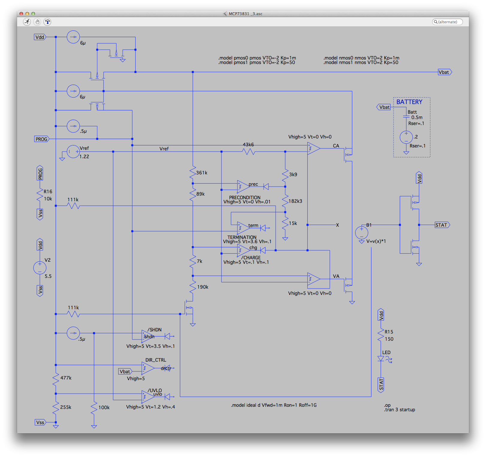

I have been trying to isolate most functions by disconnecting many parts and tweaked to get some of the functions behaving closer to needed. I have all of the bottom left comparators disconnected and the important ones in the middle for the pre-con, term and charge connecting as a go along. That is how I found out I was not understanding well enough how those schmitt triggers actually work, and that the lt1011 just didn't work at all.
Replacing the lt1011 by the same schmitt triggered comparators as already in there, and giving those a Vt=0 and Vh=0 makes them behave like normal comparators, and since the strobing is built-in those, it's ready to use and doesn't require power supplied, so no issues with the single supply.
Doing this allowed me to get a couple of them to finally activate and the VA/CA signals now do change state.
And this also allowed the stat signal to do something as well, but it's not yet quite right, because as I saw in the datasheet, the stat signal should be activated during all stages of charge, even the pre-con, which isn't happening in my current sim. But at least the stat signal now activates when the charge signal activate, which would be the constant current phase.
However, although that signal does now activate, the actual current going to the battery isn't the constant charge one, instead it drops progressively.
So there is definitely something wrong with all that mosfet setup that commands the Vbat.
It is so odd that when the VA/CA signal steps up, because of that current source above, the voltage there steps well above the Vdd, which just isn't right.

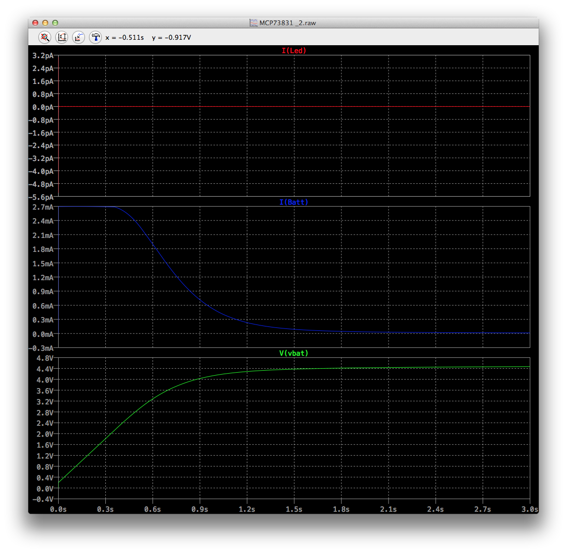

Take a look at my screenshots. This is the latest. V(n002) is the signal from the 2 mosfets VA/CA going up to the current source and 2 other mosfets up there. More than 12V isn't quite right from a Vdd at 5.5.
V(n006) is the pre-con signal take after the diode, going between that resistor ladder. And V(n004) is just the one above that 3k9 resistor, going to the - input on the CA comparator.
It's obviously acting but not doing what's expected.
Having disconnected all of the extra stuff from below, which is just the safety stuff in case of special situations like over/under voltage or lack of Vdd, now it's down to only the 3 comparators dealing with the 3 charge phases.
And I can see now that the mosfets that should be doing the regulation are not doing it, and when I raised the Vdd from 5 to 5.5, I found out the Vbat maxed out higher than the 4.4, so that voltage isn't obtained from the regulation but from some drop out from Vdd and current flowing somewhere in a resistive path.
A lot more to do for sure.
I couldn't figure the regulation out either. The comparator outputs to the FET's are either on or off (that's what comparator's do, they do not operate in a linear mode) and so it looks like that part of the puzzle is missing to. There would need to be some feedback mechanism to regulate the voltage and the FET's would need to be operating in a linear fashion, not just on or off.
Definitely! And I don't see how I can make this work as is.
