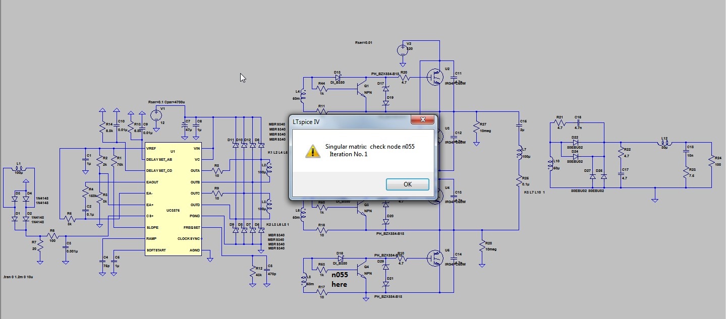

I try to simulate a smps with LTspice but get errors I can not remove.
what it does see pictures and the schematic to try yourself.
Also when using coils, like transformers how to put it the induction for it? it needs calculation first? I read about induction proportional to windings, so the outcome of a transformer calculation can not put in LTspice directly?

I have found after some research that I have to play with resistors and caps, but also change things to let it work, very high value resistors do work fine, ltspice likes gnd.
And I have did make a mistake with the full bridge, it is happely not real, then a big boom will end it, that is why i like ltspiceing.

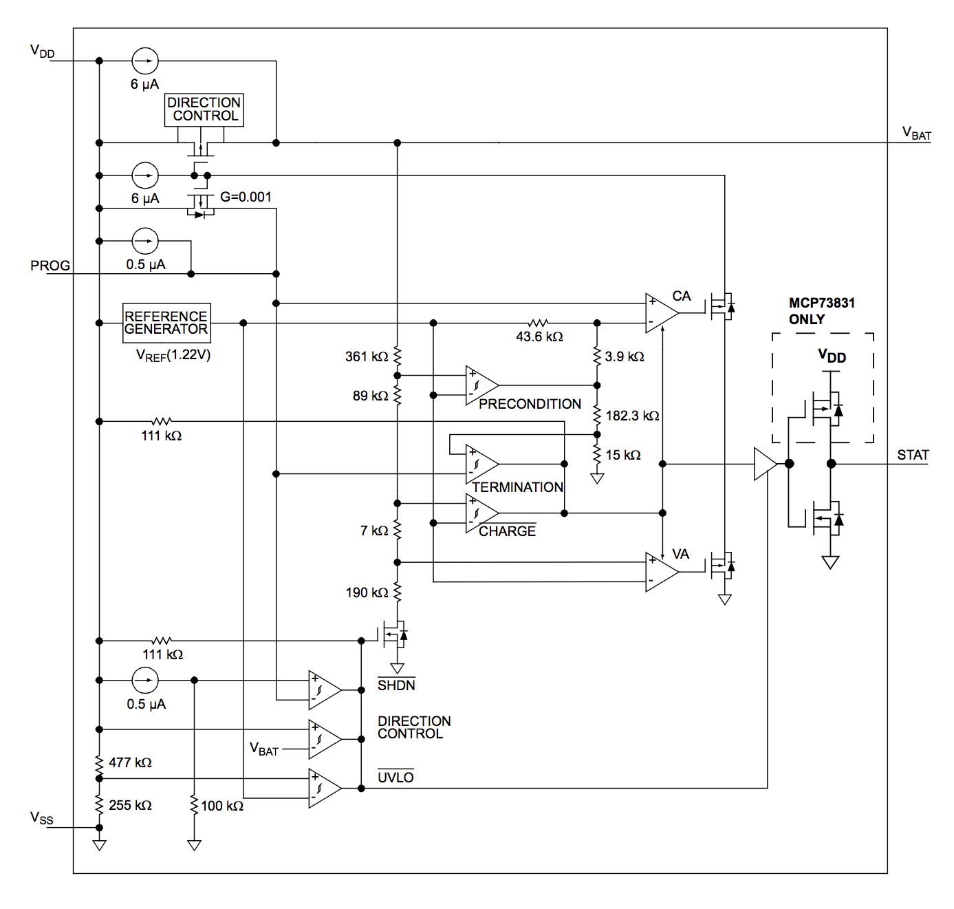

Has anyone tried making a model for an IC like the MCP73831 or similar?
I haven't been able to find any model and perhaps it's not very easy to make a real one.
But perhaps a facsimile of this could be made. One that "emulates" the behavior, although it may not be a full model with all of the pure theory behind it.
I need this in a new design with a battery and more stuff, and as long as a model can make it act like the real thing, more or less, it would be sufficient.
Anyone?

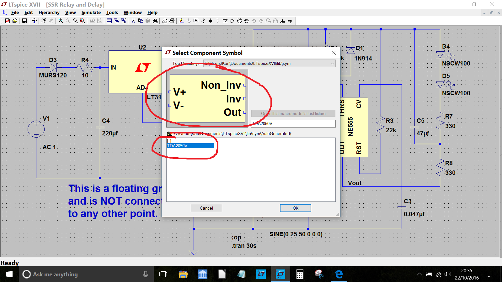

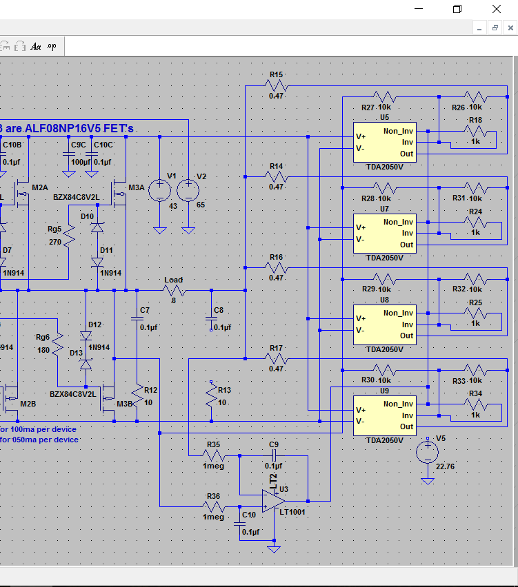

By the way, is it possible with ltspice to make a "normal" simulation, with various parts and sources etc... , and then use that like a subcircuit to make it as if it was a single part/model? to use this in an other simulation, perhaps even more than once, in the same sim.

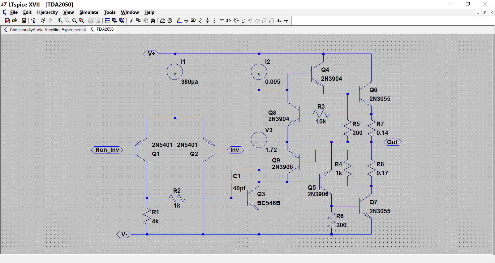

I made my own TDA2050 model which basically consists of making the device work in the kind of circuit you expect, then taking out all external parts used to prove the circuit and naming the nodes.
A bit of juggling and the model is added to LT's library to be called up as and when.
Is that what you mean ?

That's exactly what I was thinking.
If we can make up a normal simulation with a bunch of parts and turn that into a model by itself to include as is in other sims, then it should be somewhat feasible to emulate those types of parts like those battery chargers.
I was just looking at this earlier, the innards of that MCP7381 or similar, should give enough details about its internals to make up something that works kinda like the real one.
At least this isn't a microcontroller with software that can't be simulated by analog spice.
I was about to attempt putting one together, but there are some details that are rather blurry and I'm not sure how to handle those.
I attached the internal schematics of that 73831/2. One part I'm not sure how to handle is that CA/VA stuff, that is triggered by the termination/charge stage.
Most of those opamps look to me like schmitt trigger comparators, and those CA/VA that command those mosfets I'm not exactly sure. Maybe just comparators, but what about that extra input???
This should be interesting. I've been wondering for quite some time if we could put a full circuit into its own model. I guess we can do that. So I want to attempt this.

You've certainly got your work cut out with something like that but it could be doable.
CA/VA could be some kind of comparator with an enable/disable input or strobe (like the LM311) that the termination and charge comparators are able to override. Must be something in the standard parts library similar to that.
Well, since I need to simulate something using that IC, I need it, so I'm trying to do this. And if it works, I'm sure others can benefit from it.
The lm311 is in the library, so I put that in those spots, and I figured the no-name buffer thingy that follows and commands the output mosfets for the stat signal must be something somewhat similar, so I used the behavioral buffer, non inverting (I hope) from the library.
Not sure how this will work, but it's a start.

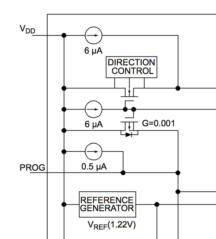

I used ordinary mosfets from the library that I kindof hijacked to suit the purpose, but they're giving me an issue by not allowing editing. When I try editing, it says the symbol has been programmed to be not editable. I looked in the subckt and asy and can't figure out what in there would make it not editable.
I'm attaching a snapshot of what I've done so far, but one piece is missing: the direction control block on the top mosfet (attached). I don't know what could be in there.
At least I figured the reference generator would be a simple dc voltage source, but that block I have no idea what to make of it.

Could it be some kind of bi-directional FET assembly like a solid state relay ? Two N channel FET's back to back and in series.
I think there are some logic level FET's in the library that have a very low Rds. Maybe rig up a little sim to test them all and see what Vgs they need and what the losses are.
Although you need the ground symbols in place to test the circuit, once its all done and ready to be made into a model you need to remove them. The grounds are then added externally when the model is used in its intended circuit.
If that was the case, wouldn't they draw all of this, with all the mosfets?
All I see is that rectangular box that says "direction control", with the 3 connections to that mosfet below.
If more mosfets were involved, I would think those would be drawn as well.
But what do I know?

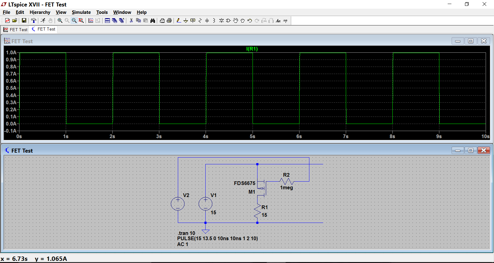

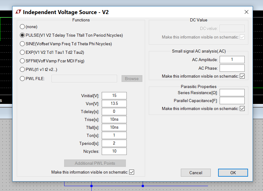

Something like this for the FET's. In simulation it doesn't actually matter if you pull 10 amps through a 100ma device. Its not going to burn a hole in the screen.
This shows a P channel FET switching 15 volts into 15 ohms, so we should see 1 amp flowing. The device here seems to work with 1.5Vgs. You might find an even better one. For N channel FET's just put a minus in front of all the voltages.

Well the FET asc did run OK in my copy of LT IV so the model is there (in Windows anyway) .
